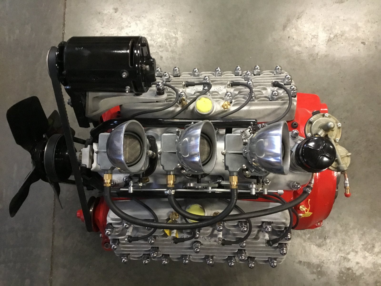

    You like that? The engine builder fired the motor on the center carb. Don’t know why he ran hose to the other carbs but I suppose he just wanted the ports closed off.

    With a bit of work I now have the T-5 mated to the motor. Time to drop it in the frame and get to work on the clutch linkage and measure driveshaft length. A3389E9C-7600-4360-8C67-6424AB846CE0.jpeg 7DDC3C36-BF37-4423-859C-29E5D3BF482B.jpeg 4EB88ADC-BD04-4322-9B53-372CFCF19951.jpeg

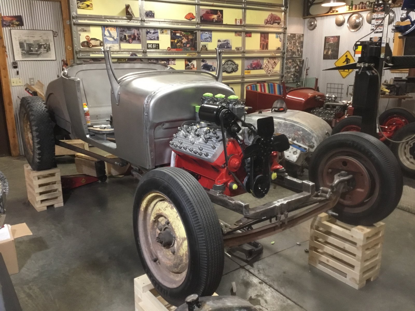

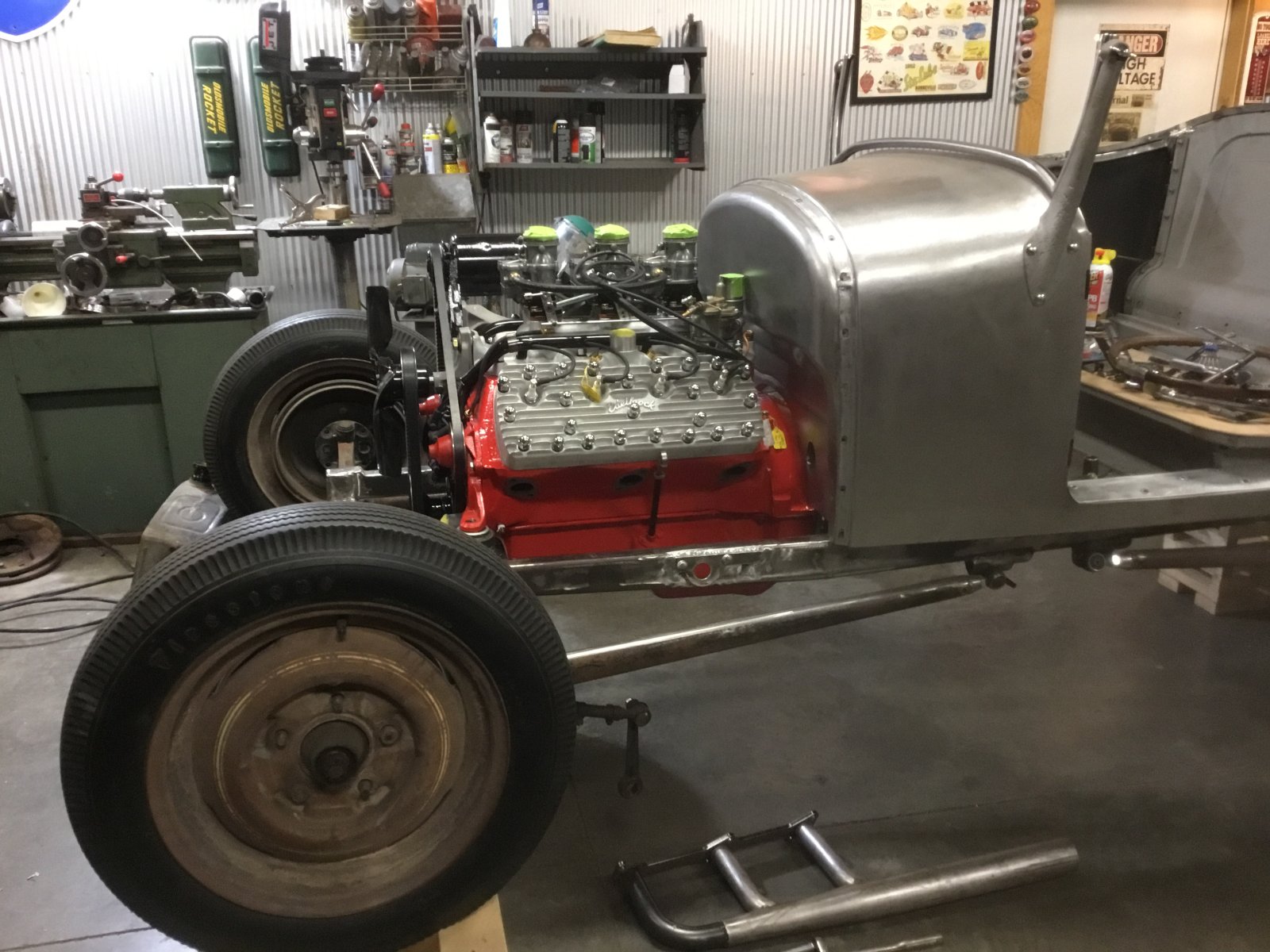

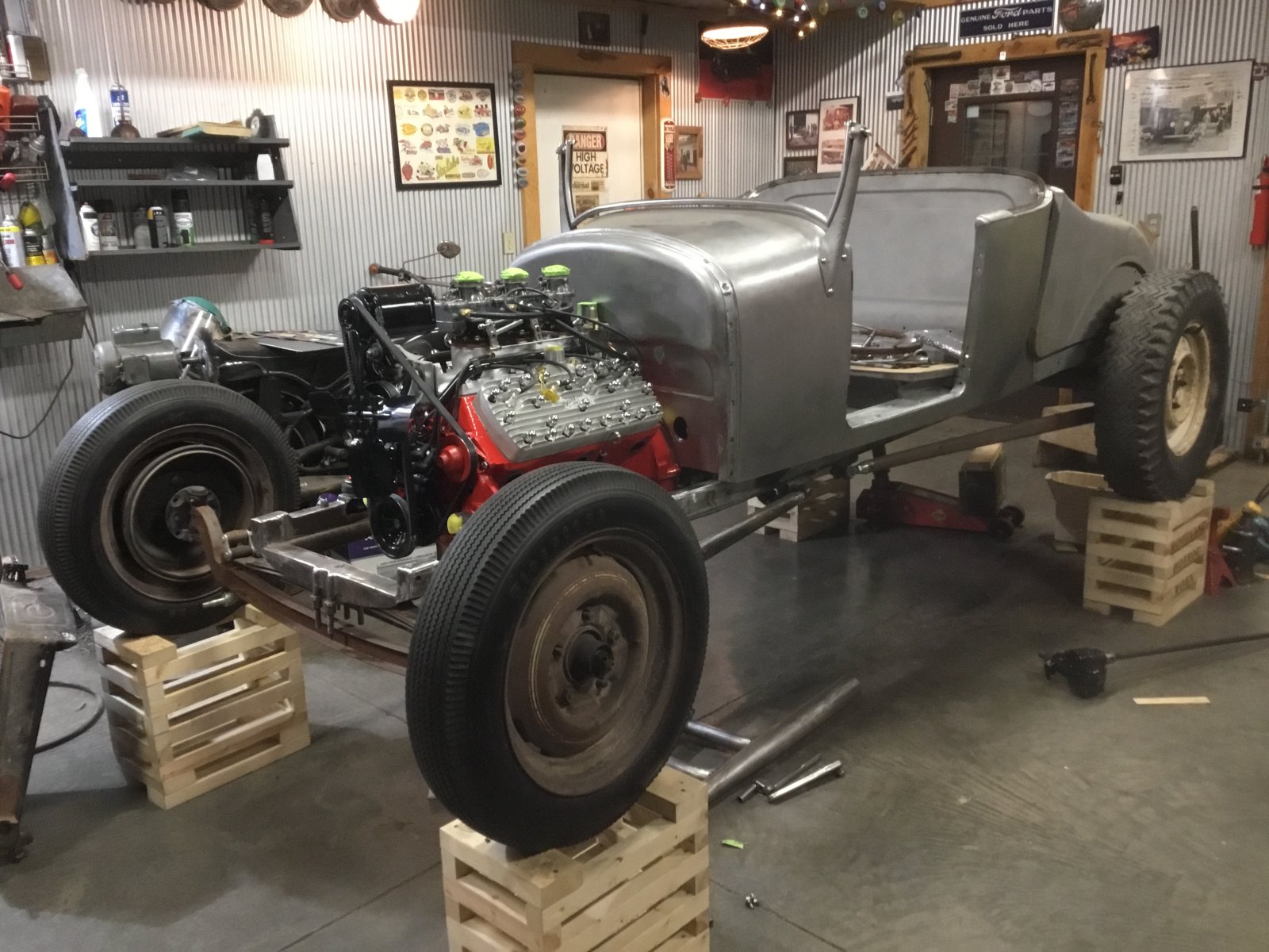

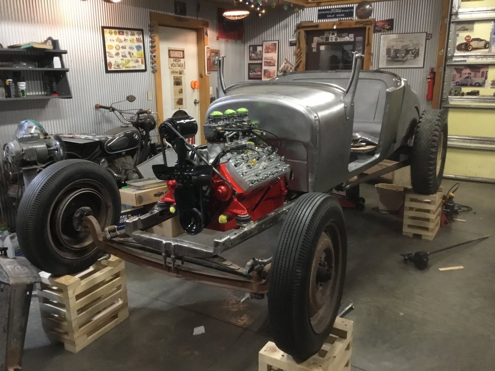

    The bullet is in the chamber. Now to fabricate the clutch linkage, measure driveshaft and mock-up a radiator model to send to br***works. 8F3C1F76-E425-4D89-BCB5-0328ED4D8F89.jpeg 76C27F60-89D7-4199-8097-AAEC728BF0CF.jpeg ED2DC72E-B006-4D87-9DB8-96D268FF65DC.jpeg 4DE6E0C1-F2D2-4E4F-9A0C-547A4FD466C7.jpeg 6C2FEDFA-611B-44A0-8F16-6964D1F24B05.jpeg

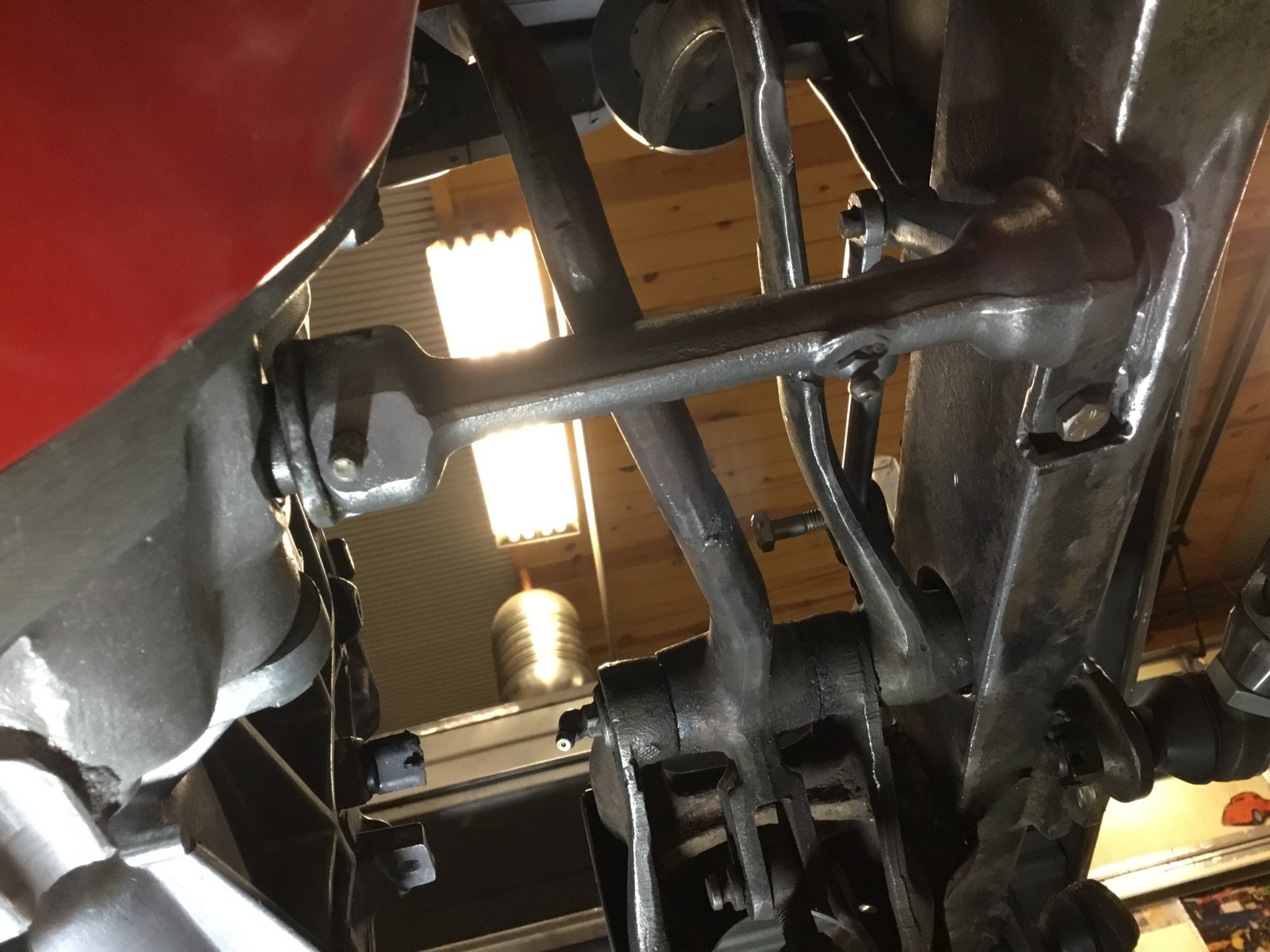

    I have the clutch ***embly all put together. A little more tweaking and bending and it should be done. 0B584213-56E0-428E-B130-8D167ADE0FF7.jpeg AD1F3CCC-C33C-41F7-AF23-417C19AAF6EC.jpeg

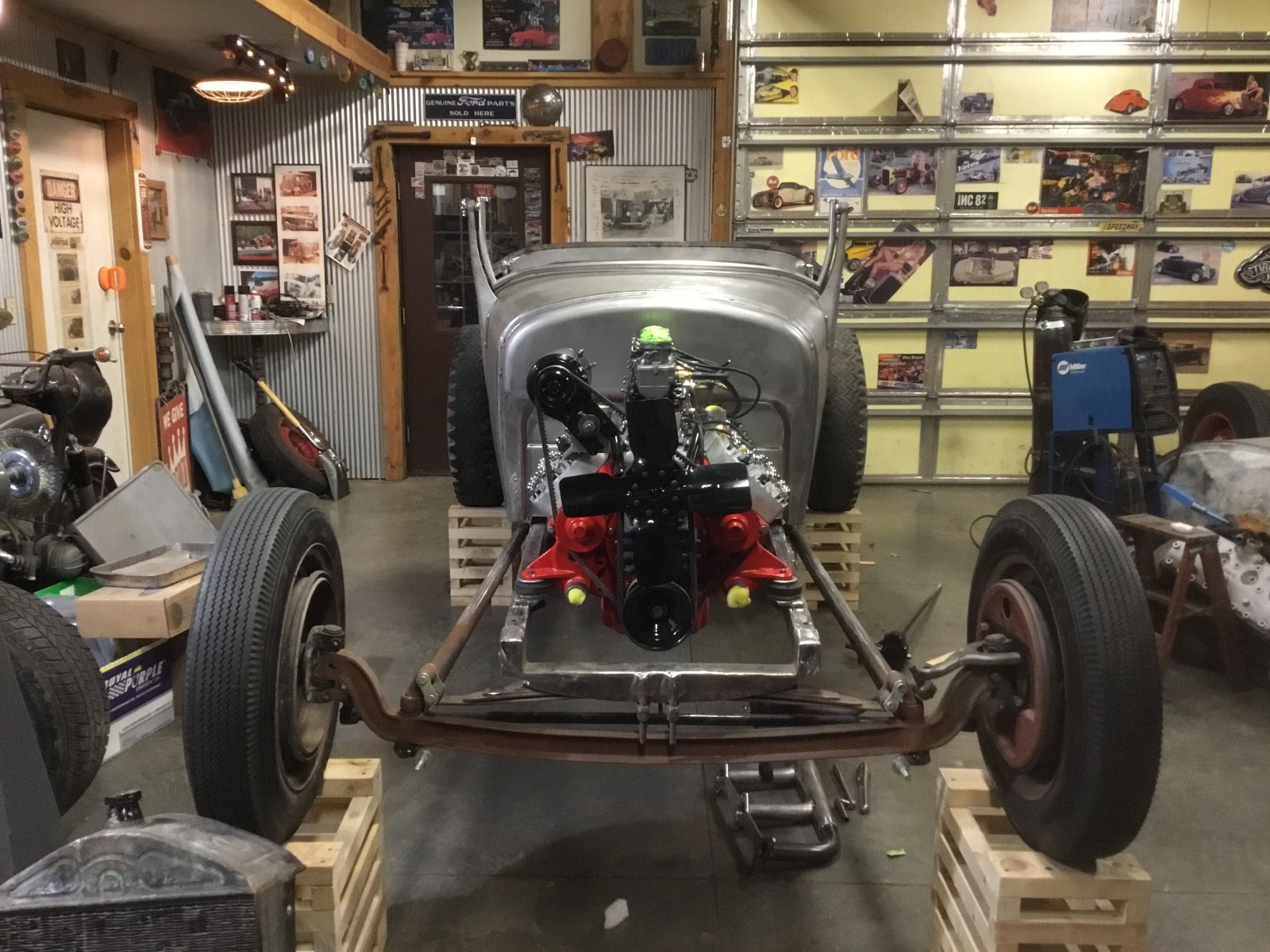

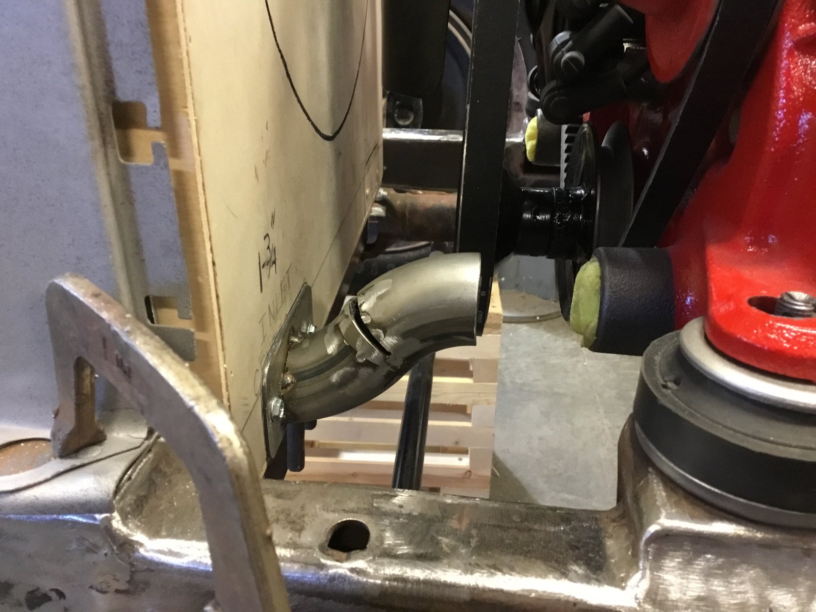

  11. rusty rocket
    Joined: Oct 30, 2011
    Posts: 5,262
    rusty rocket

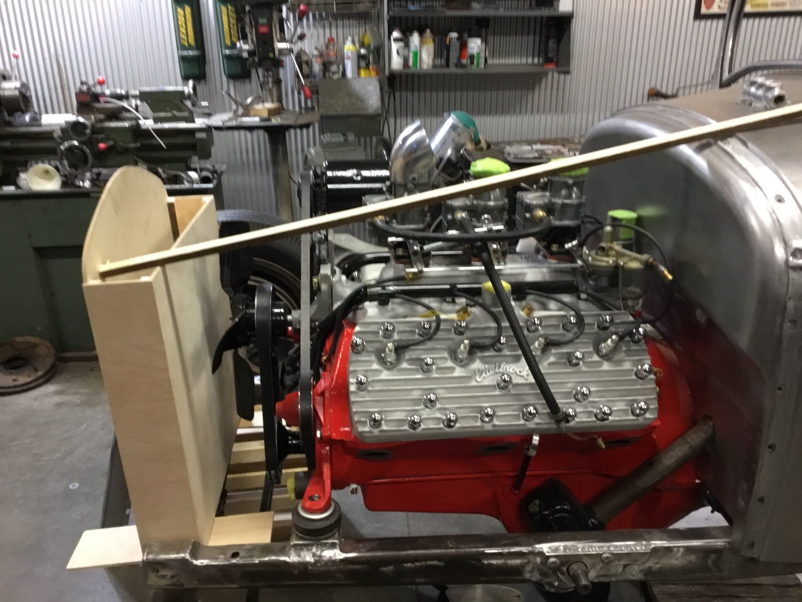

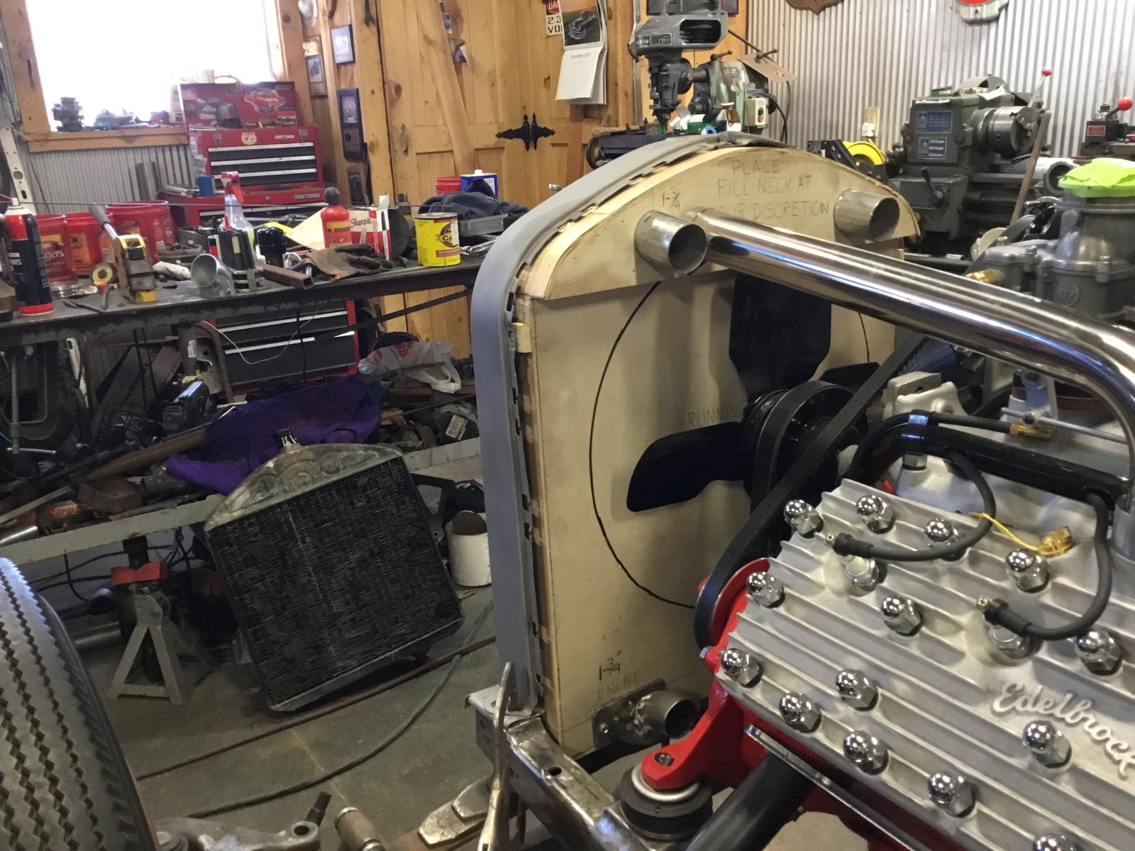

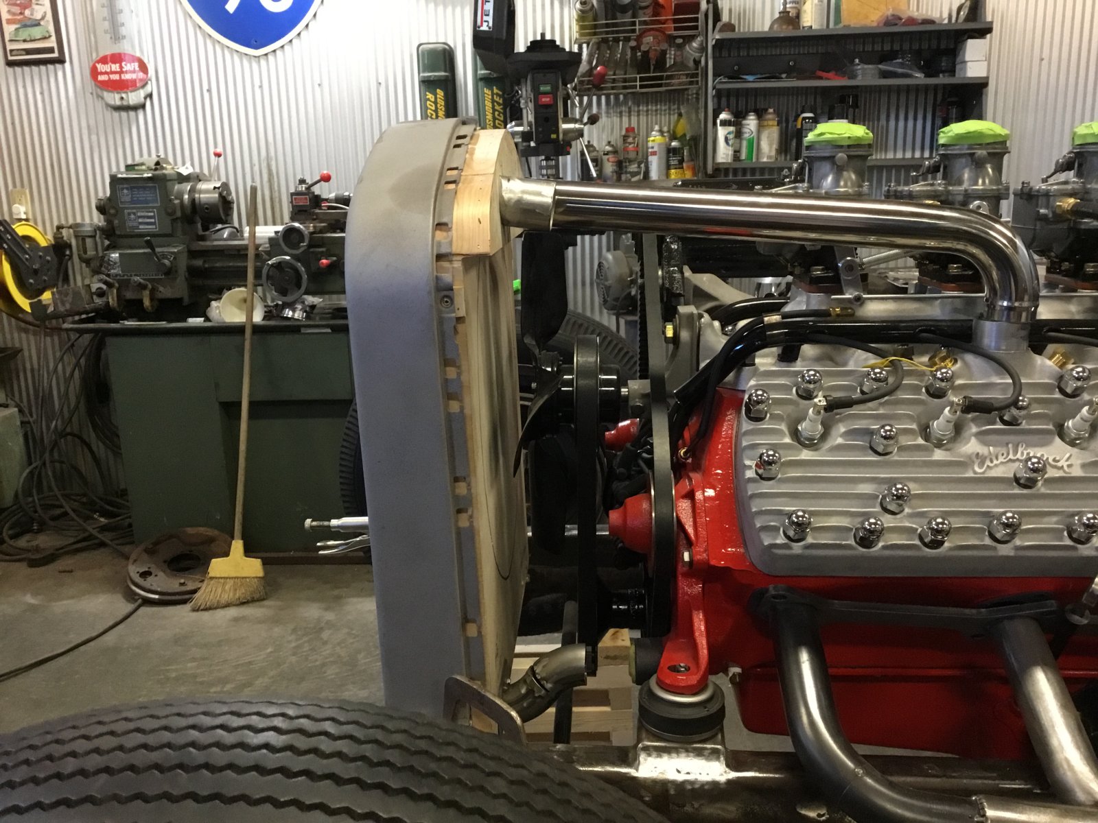

    Started building a radiator mock up to send to br***works. Since I built the front crossmember to get the stance I wanted I can’t use an out of the box T radiator. Br***works will make a custom unit for me but there lead time is 20 weeks so I had better get this thing finished and sent off. DBD3CF65-4D77-4224-8156-AD750CC9DA2B.jpeg C52229F7-3556-4317-AFC5-00274C8A2FB2.jpeg

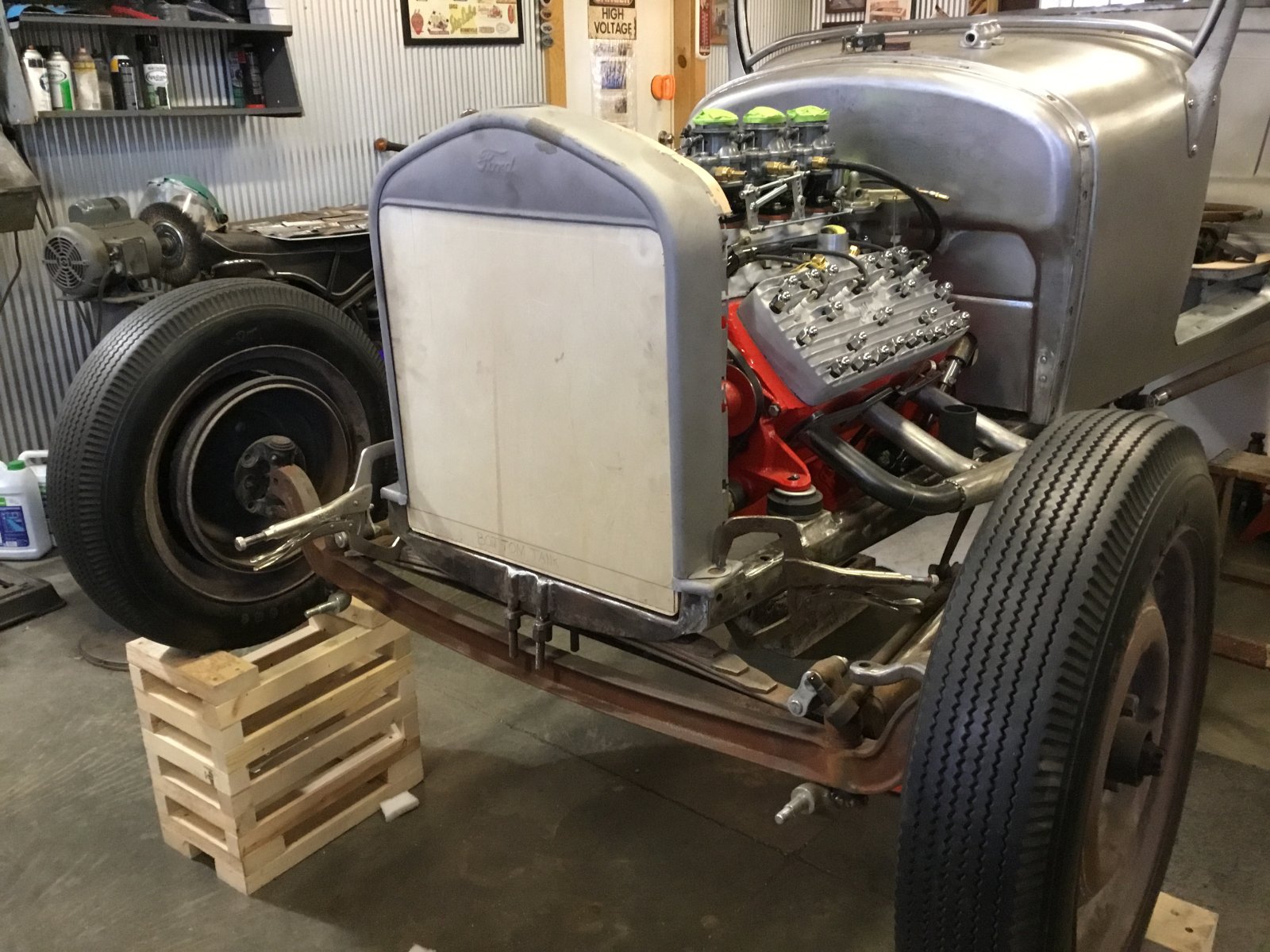

  12. rusty rocket
    Posts: 5,262
    rusty rocket
    Radiator model is done and ready to send to br***works. CF9DF38F-351B-44D9-BEDC-1B9730D937AB.jpeg E824B20E-B785-49A0-87DF-6BB9468F08AE.jpeg 807F2B7A-062E-4AE7-8FA2-CFE5A8925BEE.jpeg 9A0AD0AB-F6CC-4742-9304-F1E5AB0D94D6.jpeg 5C8FE865-6D83-42F5-A01A-6CCF48D3092D.jpeg
  13. Blake 27
    Joined: Apr 10, 2016
    Posts: 1,553
    Blake 27
    Looks good! 3 or 4 row?
    Stogy and Greenblade like this.

    Who did the engine for you?

  15. rusty rocket
    Posts: 5,262
    rusty rocket
    Lee at br***works said the core will be 3-1/2” thick. Enough to kool this flat motor.

    A guy up in sturgis did the ***embly. Block was sent to M***achusetts for machining and crack repair.

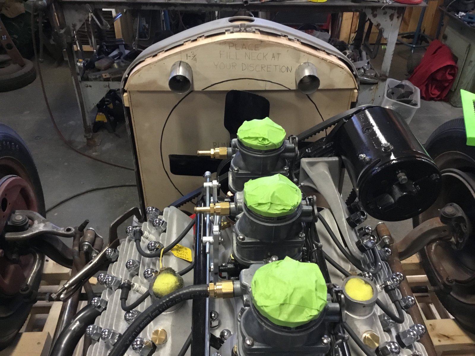

  17. rusty rocket
    Posts: 5,262
    rusty rocket
    Plywood radiator template is built, boxed and sent to br***works. A work order has been filed and the anticipation starts. Lot of other things to do in the twenty weeks of radiator build time. C8B3065F-EAF4-4F44-83C0-59CCFA35F266.jpeg

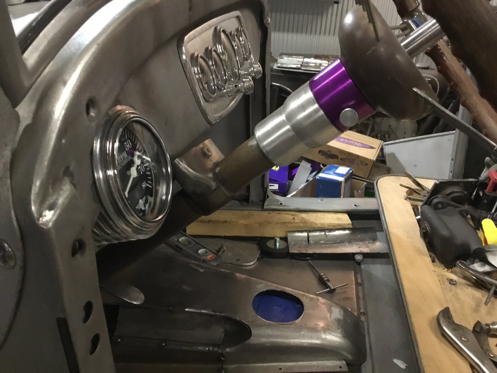

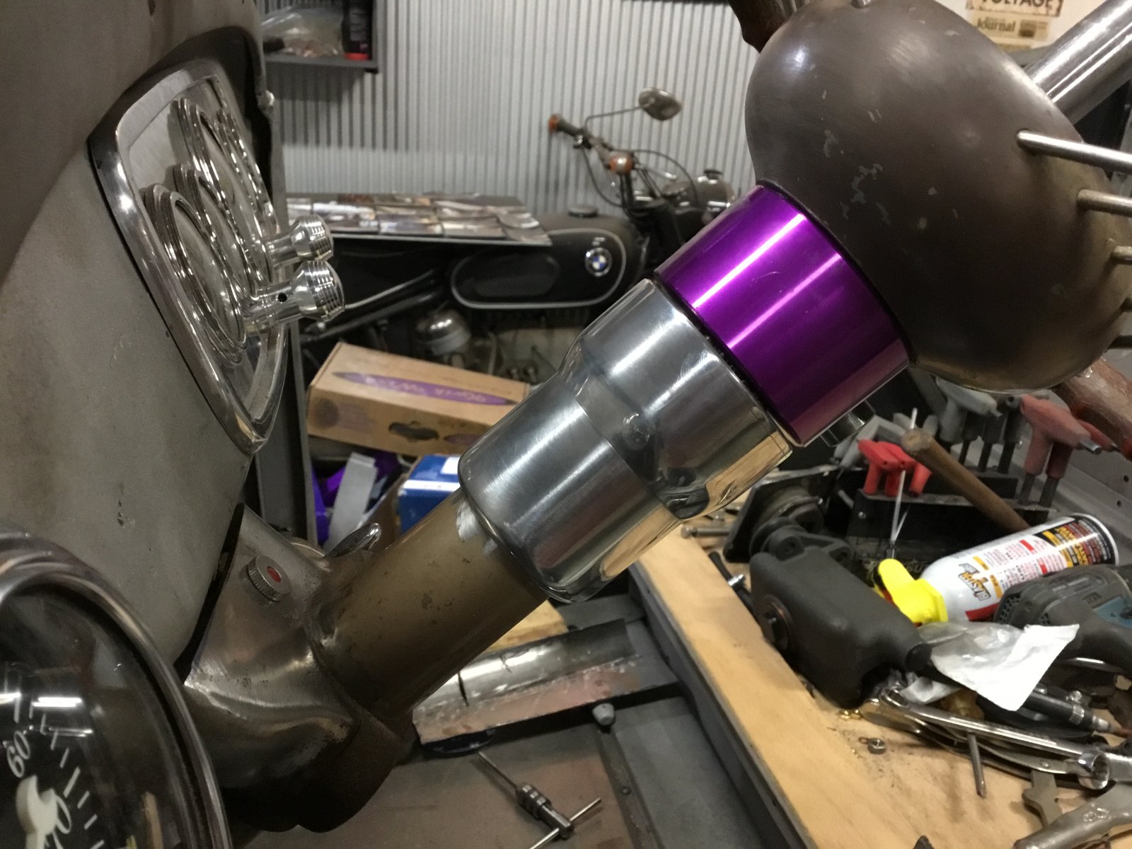

    My lathe motor blew up about a year and a half ago and I’ve been dragging my feet getting it up and running. Finally got a motor and wired up a few nights ago. Turned my fist piece in along time this afternoon, it’s a nice bell that transitions the steering wheel disconnect to the column. 6E697CDD-86C1-4DB7-A131-CAE199C91C8E.jpeg 0AF64CC2-372D-434D-A219-4F639F5A2A29.jpeg

    I'm definitely interested in any info you can post about your steering wheel quick disconnect. My '27 project will use an old Bell four spoke wheel that is 17" around, and fitting into the seat will be quite a maneuver. I don't want a quick disconnect that looks new, but if I need to buy a new one I'm sure I could make it look older. What brand is yours, and do you like it? Does it fit tight?
  22. rusty rocket
    Posts: 5,262
    rusty rocket
    This is a speedway motors disconnect. This is the second T I’ve built both are using this part. It does have a bit of play but I guess it doesn’t bug me. I’ll easy off the anodizing off and polish to match the bell.

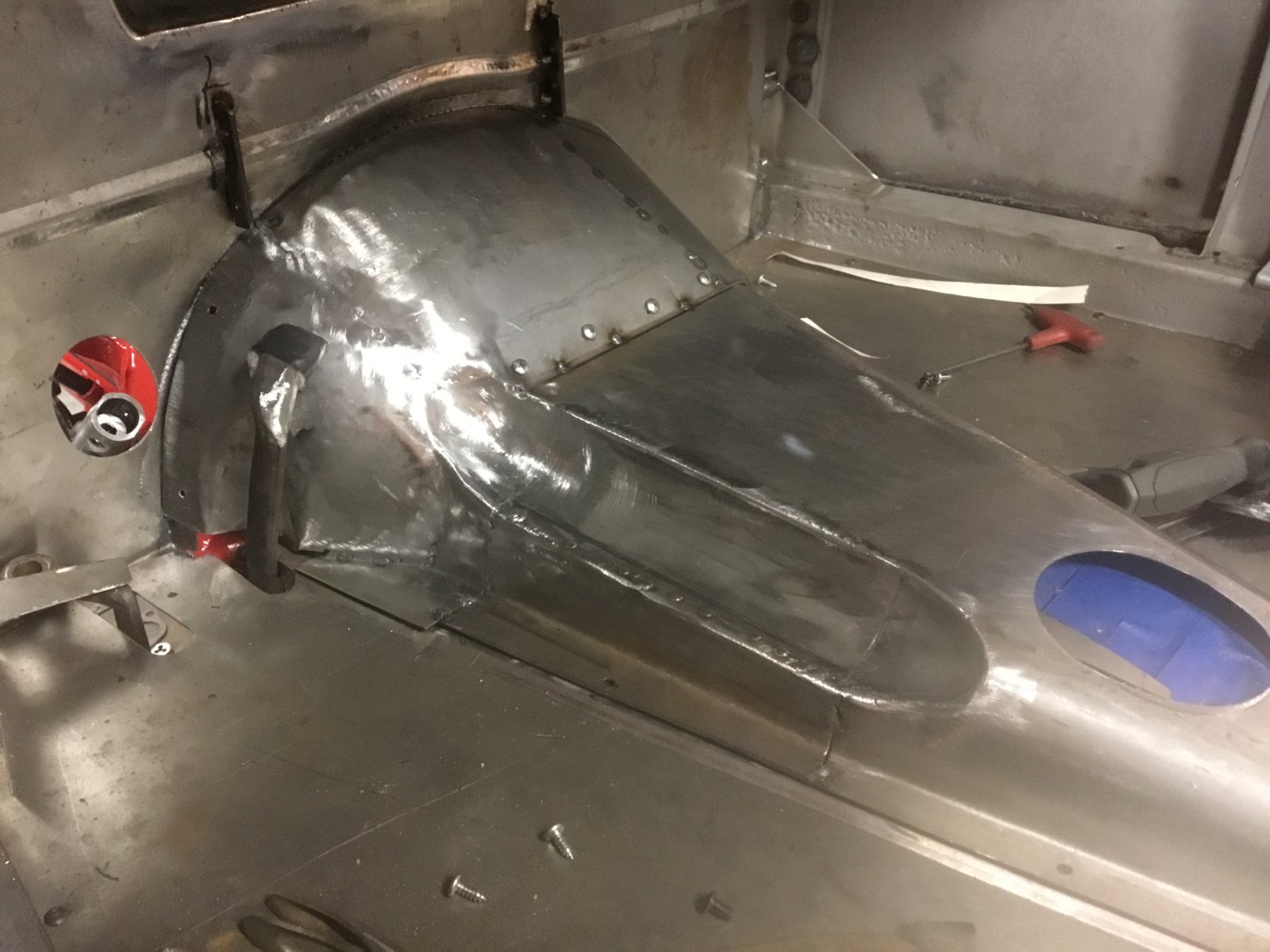

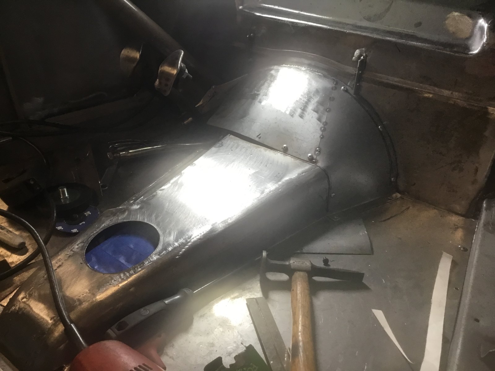

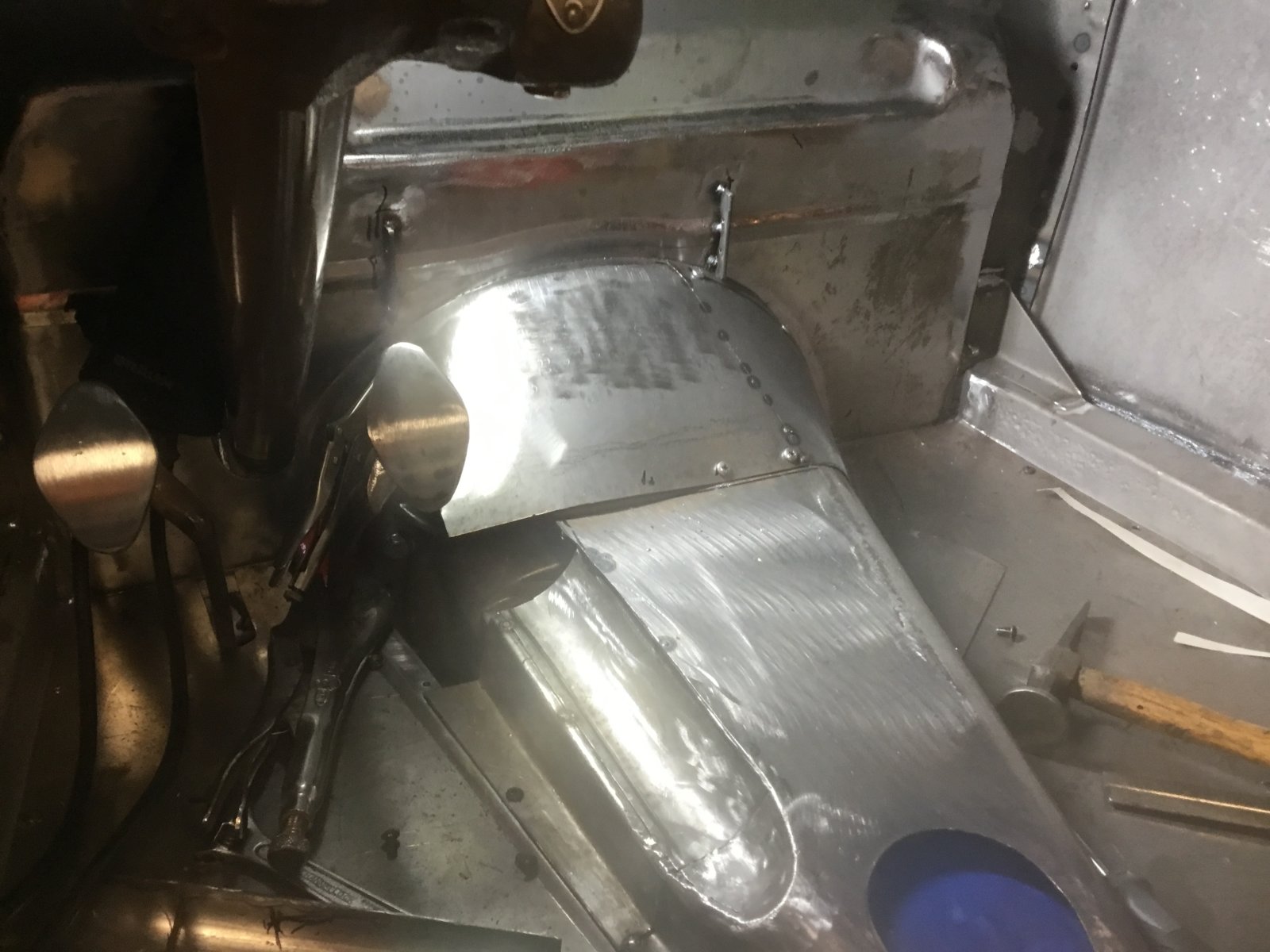

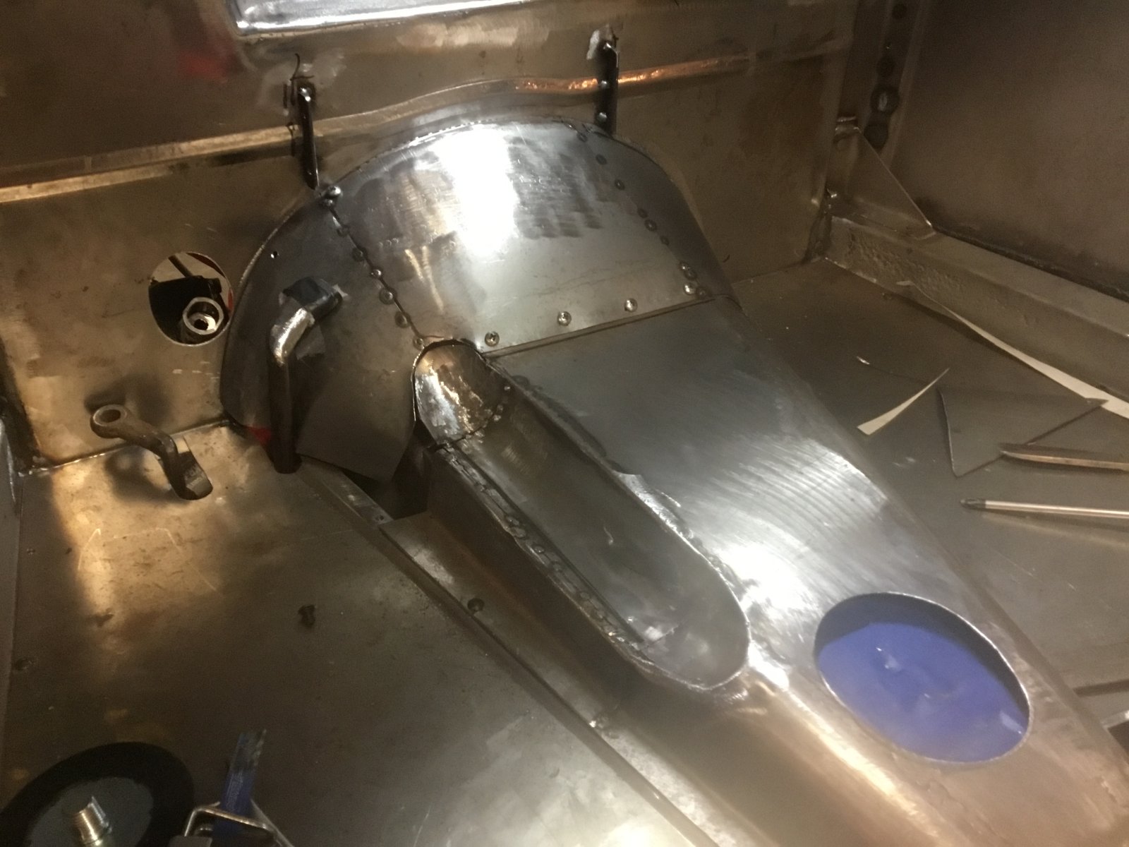

    Sheetmetal is not my forte but I told myself I’m going to try and build this transmission hump/cover. To be truthful it’s not turning out to bad. It’s going to be covered with some sort of floor covering anyways. 0190C6D1-33A3-4850-9E15-28723FDC997D.jpeg 28E37489-DF23-4333-8C7D-45631A66C6E2.jpeg B59922E8-E7D5-4A9F-BBB0-105E4B8509F3.jpeg
  24. Blake 27
    Posts: 1,553
    Blake 27
    Nice work, looks great!

  25. phat rat
    Joined: Mar 18, 2001
    Posts: 5,085
    phat rat
    The half round area for you right foot is a good idea
    Stogy likes this.
  26. rusty rocket
    Posts: 5,262
    rusty rocket
    It’s a must. It’s so damn tight in there even with the foot well there’s not much room. I wanted to make it lower but I’m almost on the transmission the way it is.
    Stogy likes this.

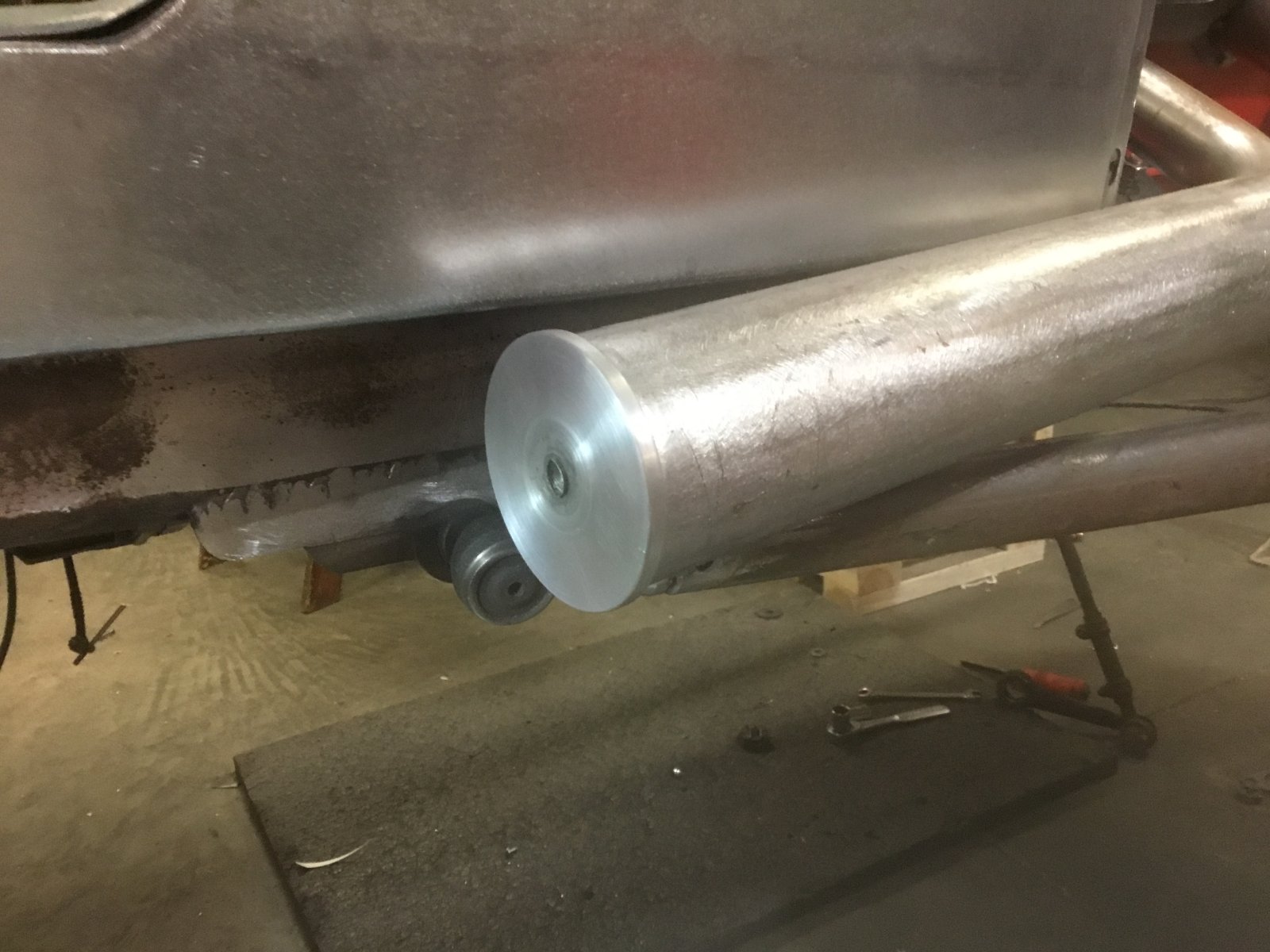

  27. rusty rocket
    Posts: 5,262
    rusty rocket
    Transmission cover is fabbed now to get it all welded up. Also turned some caps for the 35-6 driveshaft headers. C94F1F45-EF8E-4F43-A66D-D36420EDD9D6.jpeg 96D73710-5CB9-4025-89B8-5CB5D1E37455.jpeg BC14A687-2620-4D97-8EE6-03CB2BE33DE2.jpeg

    That tunnel looks great! Well done!

    I have three pedals now in this very tight space. Going to have to wear my chucks or vans because my boots are having a hell of a time fitting. 4CC74276-F2F0-451D-8178-74EB5FAAE819.jpeg 22FD1CD2-1F13-4383-9022-0A75E5F089F1.jpeg
