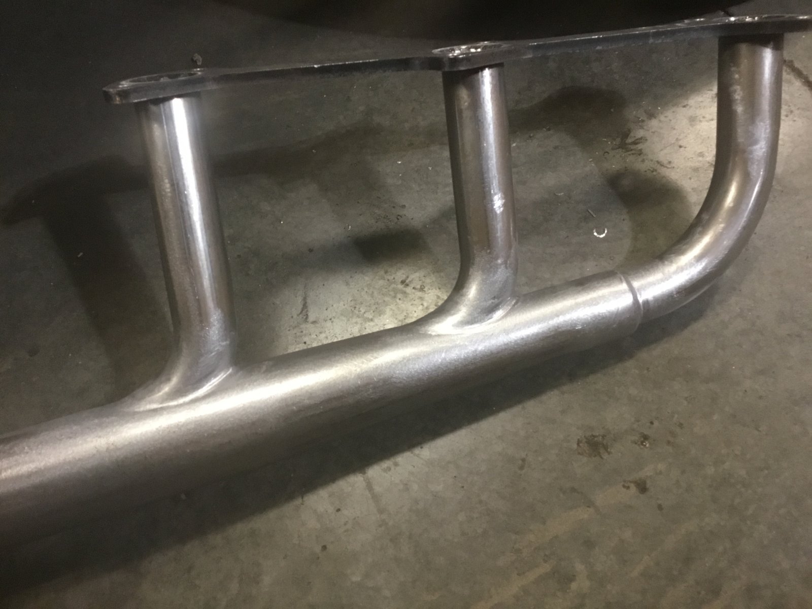

    Been jumping around like a fart in a fryn pan, doing a little bit here and a little bit there. I have the headers all fabricated and having a buddy tig them together so the welds look good and not my chicken **** welds.

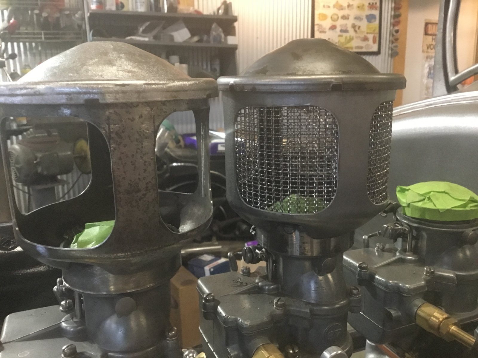

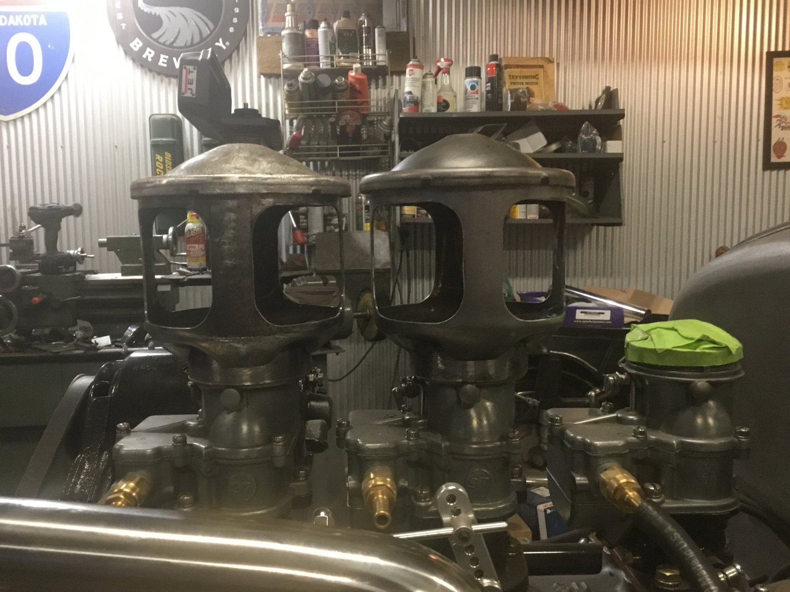

    I’ve been kicking around what kind of air cleaner to run. The other day I measured a flathead oil canister and it was a perfect size across so I did some cutting and fitting. I have to run it by pops to see what he thinks, if he likes it I will build two more. I ordered some stainless steel screen to fill the holes and probably powder coat the cleaner. 419CA6F0-639C-47F4-81AE-C996A680620A.jpeg D0B2C1EF-25DF-495E-9F2C-84EC1263471B.jpeg

    I have two built. My buddy has a bunch in his stash so I’ll grab one from him for the third. 3F9B92D0-BE75-4530-B88E-ABC989F9FD57.jpeg 99CB265A-DC49-4025-A895-4E5B71E90985.jpeg Had my buddy tig up my headers and blend them out. Now off for ceramic coating. C1D773D6-FD8A-4926-9D9E-0AFF6E5EDB15.jpeg

    Nope ! Using what I have.

    Those *would* look good chromed w/bronze screen...
    I like them.
    Although, w/the cut-outs, they remind me of old lanterns.

    Your air cleaners look fantastic, and have the perfect size for the carb/manifold spacing.
    Great inspiration, keep it up Rusty!

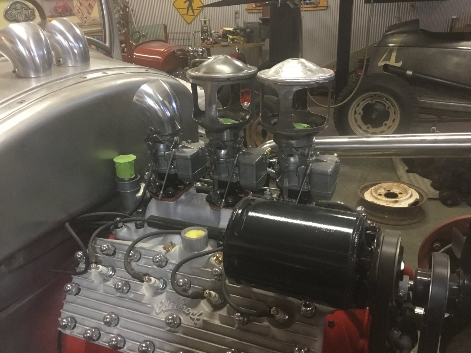

    Got some mesh in the mail. Now I need to find an air filter element to stick in it. 8E51D82A-BFBA-4597-892E-1EF2FAAE8CE9.jpeg

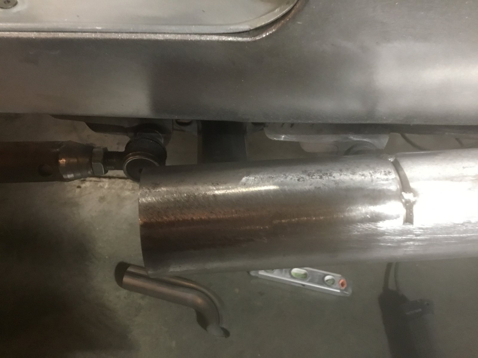

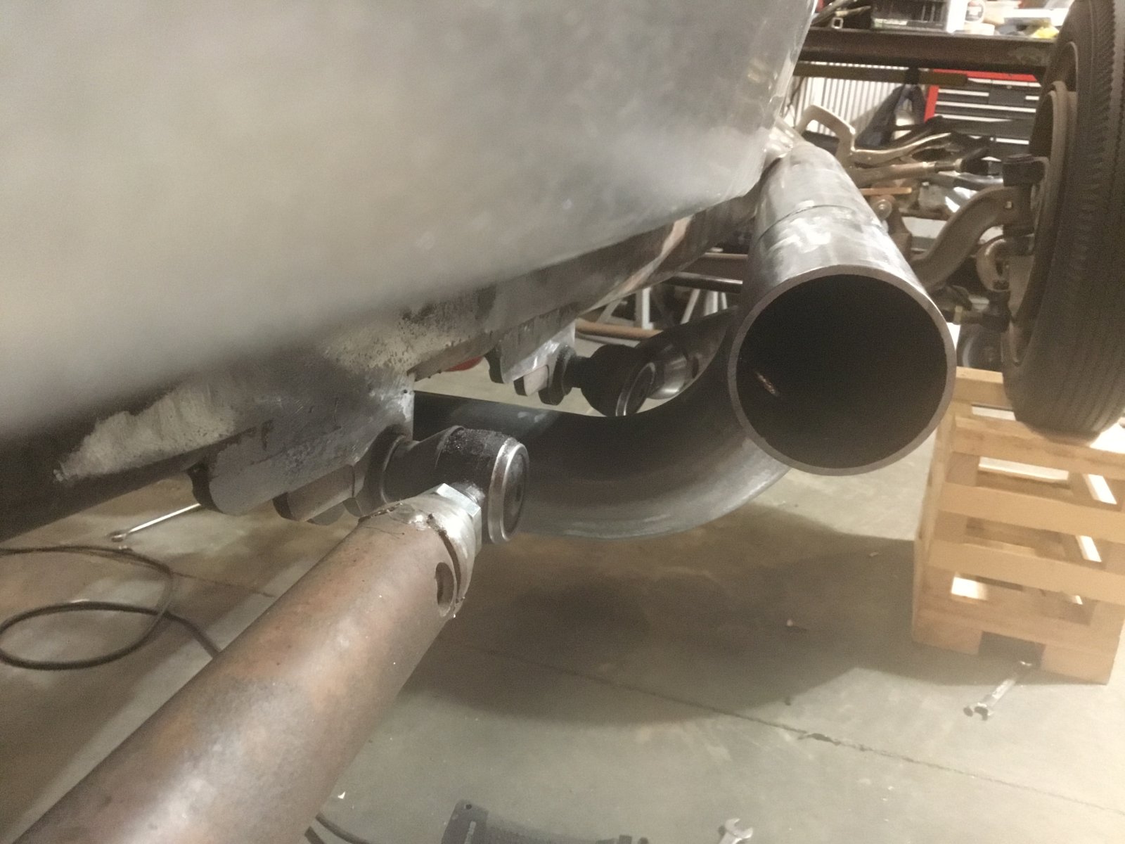

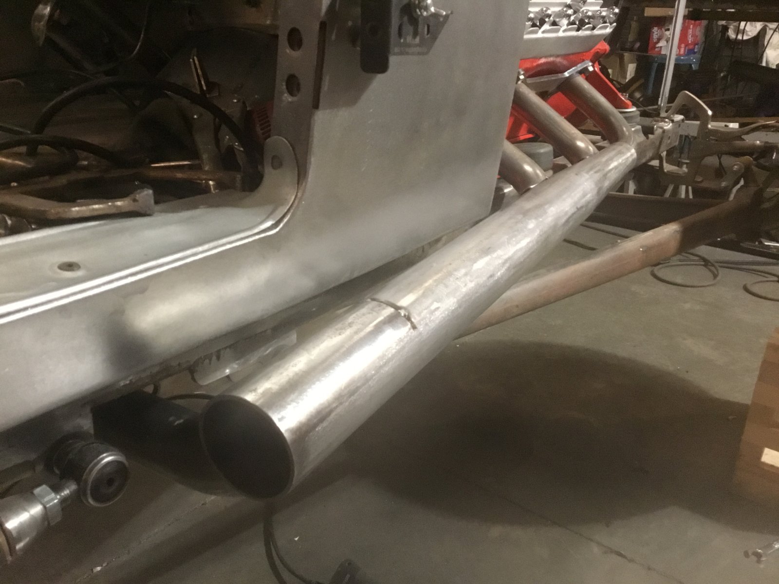

    I have the exhaust run. Still have sanding and some welding to do. 1357F718-F269-410F-AEB2-84925FA68F1C.jpeg 044E6454-19CE-4B23-930D-9DAC60113125.jpeg 8F1CCCBC-F710-4B7D-BD2B-BE14ABD09131.jpeg

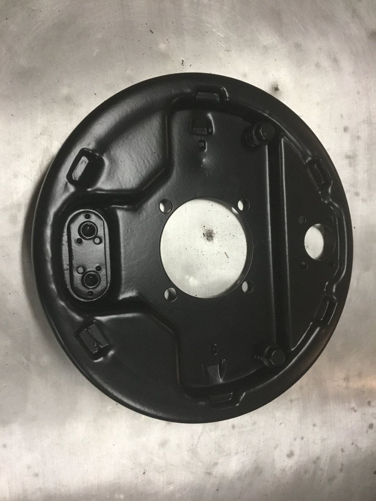

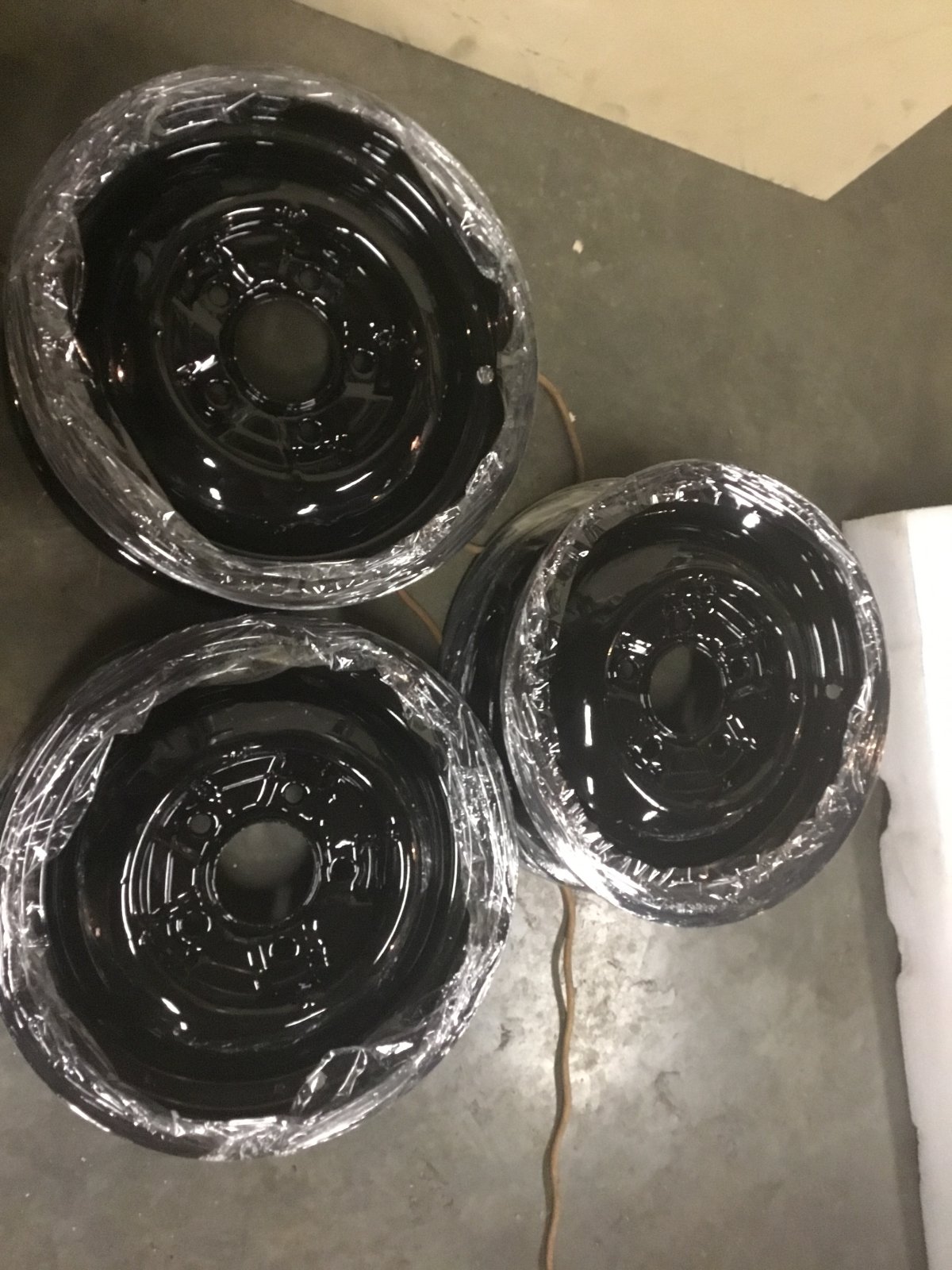

    Got my wheels, backing plates and drums back from the powder coater. 8F4DA5DE-FDEF-46A3-A6ED-091D1174EFAF.jpeg 9CDAD0CB-0020-4AD6-831C-7CC4B62EF4BD.jpeg
