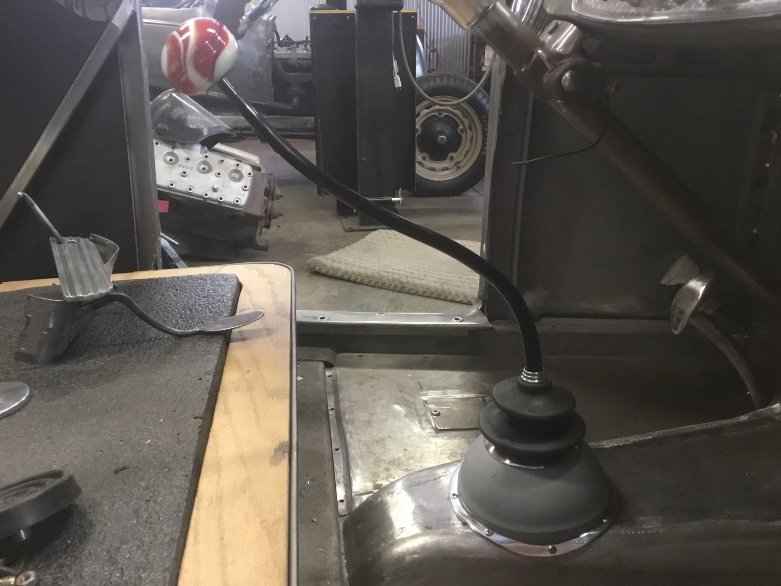

    Air cleaners are powder coated and done. Also built a shift lever from an old 37 toploader, had it coated and capped with an old coal slag shift knob. 2E13FA7A-5524-4E5E-8FE9-E2601D6882FA.jpeg EB0D001F-003F-4B64-852B-E05211142D0C.jpeg F937A03E-8A6B-4F8F-9608-77CAEF53A4BD.jpeg 82D8AEF0-28FF-4C87-8136-5793DDC1A677.jpeg

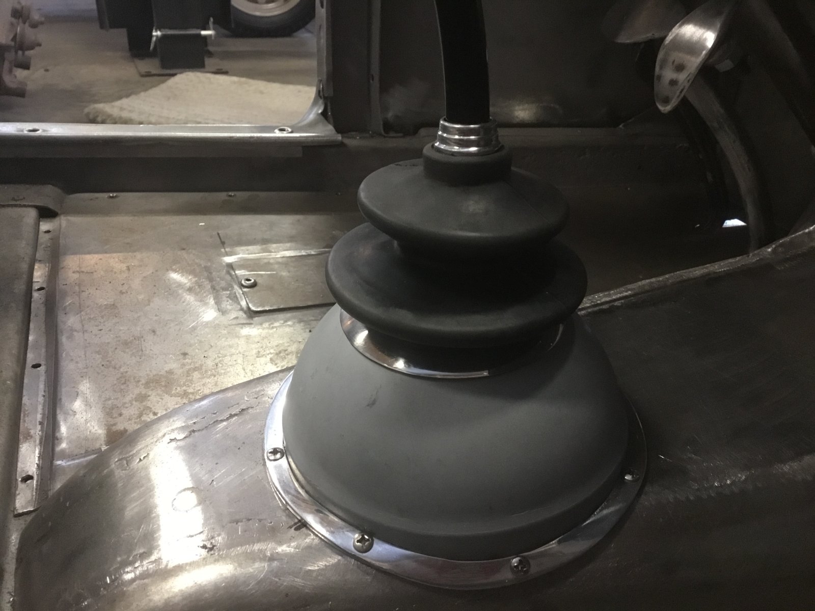

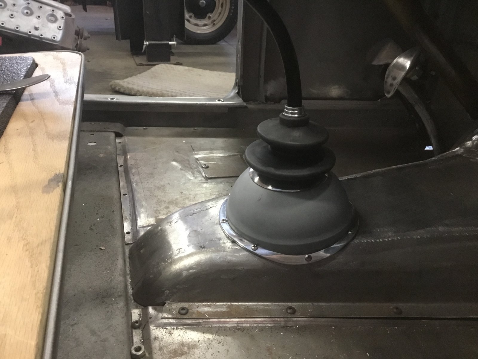

    I added a short throw shifter and needed to cover what’s coming up thru the floor. I had an old 50’s era horn laying around so I took the tin cover off it and made an aluminum ring for the floor. I went junking at the local salvage yard and found a rubber boot from an old Datsun truck but the hole for the shifter was bigger than my swan neck shifter so I turned an aluminum piece to mate the two together. BAC8A485-3ACA-4A03-B14C-F20A58AF01AF.jpeg 5F933EEB-C6C3-4260-A5C8-6D1D3FC554E7.jpeg E6AB75E0-608D-4941-ADD9-2214FD77E5C5.jpeg

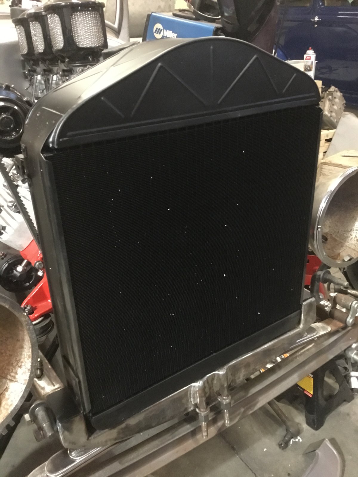

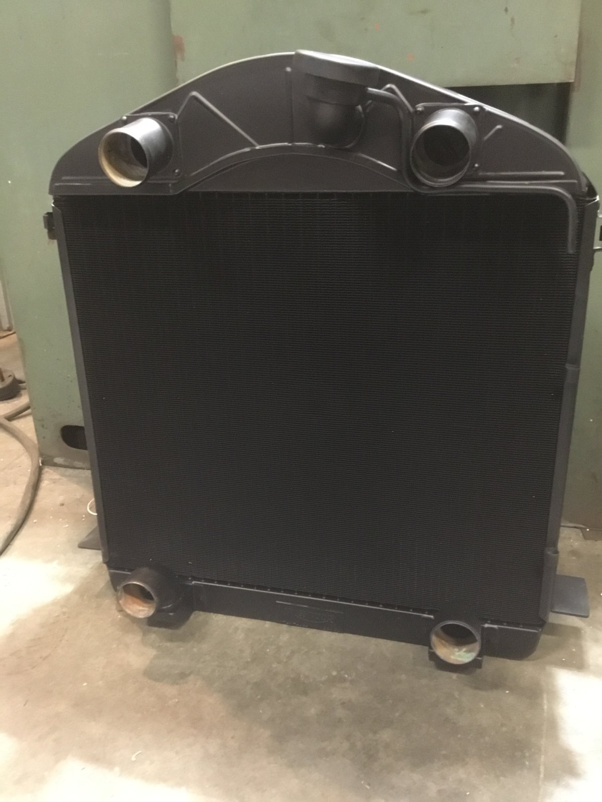

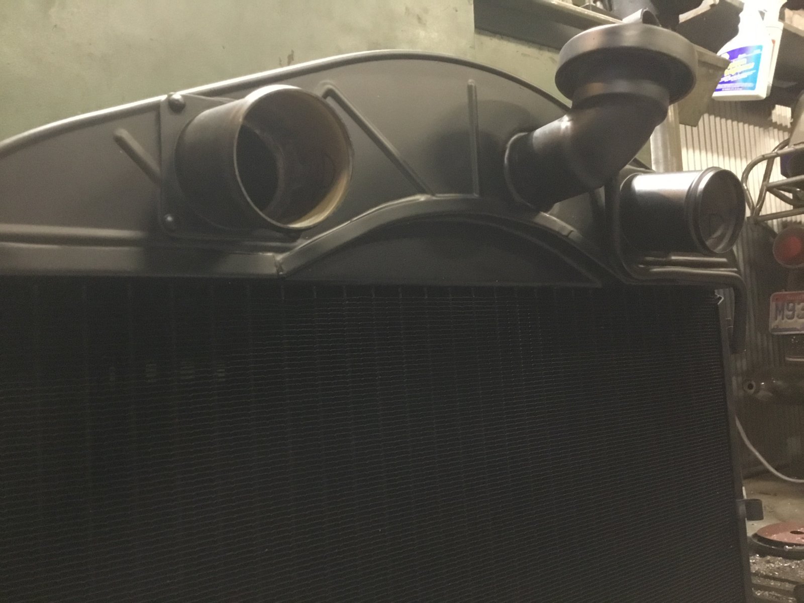

    After talking with br*** works, making a physical model of what I needed and sent to California I was on a five month wait/ build schedule. Today the wait was over and the radiator was delivered. It’s a damn fine work of art. 2F1C1DC8-10ED-4967-8DAB-F69034AC4565.jpeg C414C871-0E1F-4D9E-A8D2-7F5791A4C395.jpeg DB9BC4F2-3D5E-4853-A7F0-88B73DDAF17E.jpeg

    Are you planning to use springs or other cushioning mounts?
  26. rusty rocket
    Joined: Oct 30, 2011
    Posts: 5,264
    rusty rocket
    Yep, using stock model T hardware. Got it mounted last night but didn’t take pictures yet.

    I got the radiator mounted and the tin hung on it. 4EF6A5FB-1A17-43DC-9947-1F5E991EAC40.jpeg
