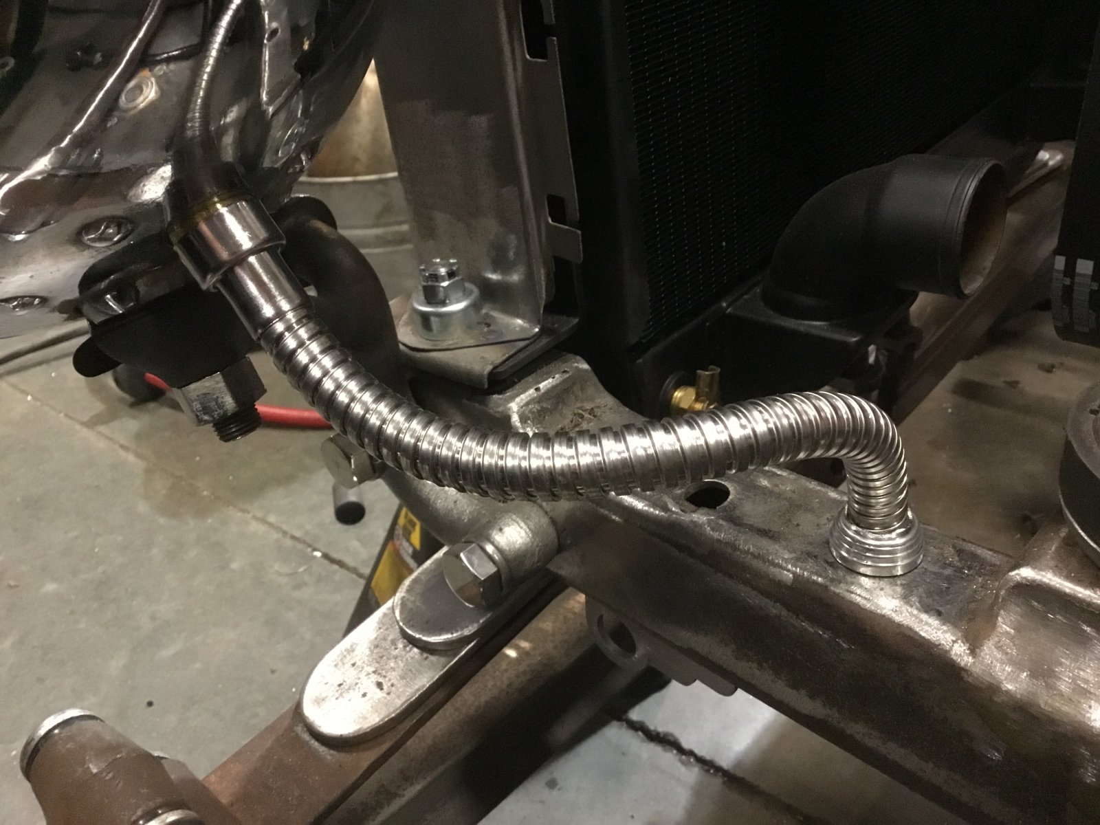

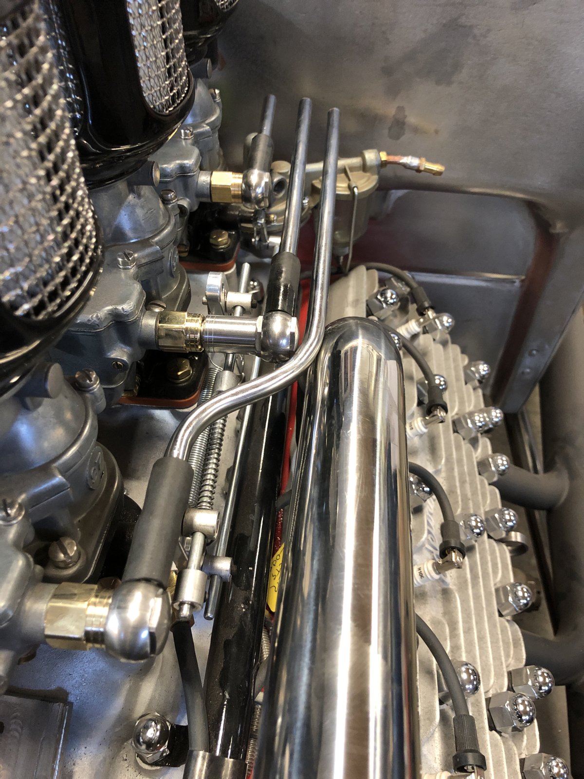

    I had to order stromberg Banjo fitting to get fuel lines routed around the radiator pipes. Bent up a few fuel lines to run to the old Weiand aluminum fuel block that I will mount on the firewall. 6DF1E2F4-A90F-43C0-8408-EA7E71823DD4.jpeg
  3. Hmmm, wonder where I saw that idea? ;)
    Still tight, thought of running them up on top of each other? Stacked?

    I saw those awhile ago but was asking if anyone had any other ideas before shelling out $115 for banjos.
  6. Hey man, always easier to spend YOUR money rather than mine! Whole car is looking good.

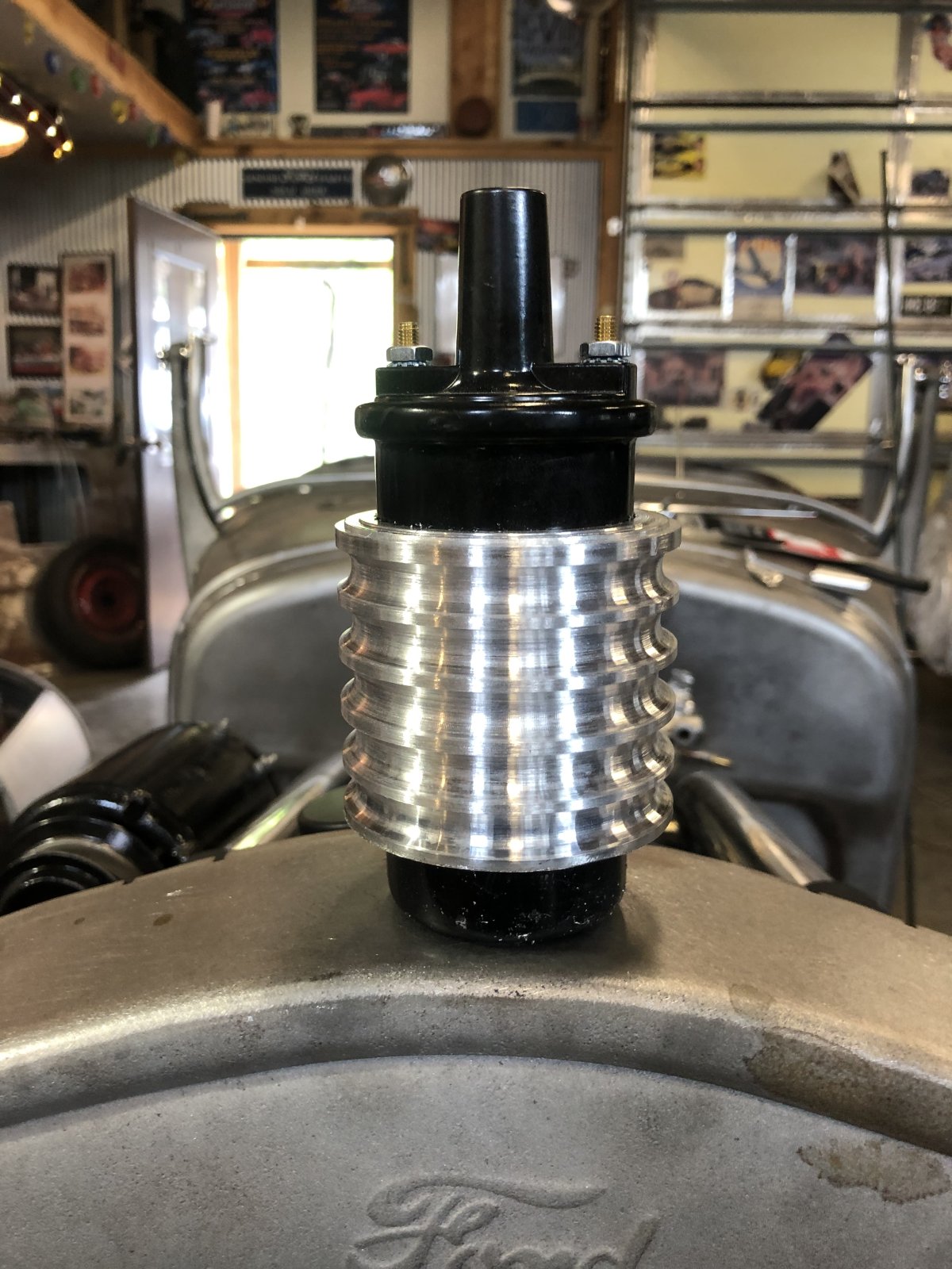

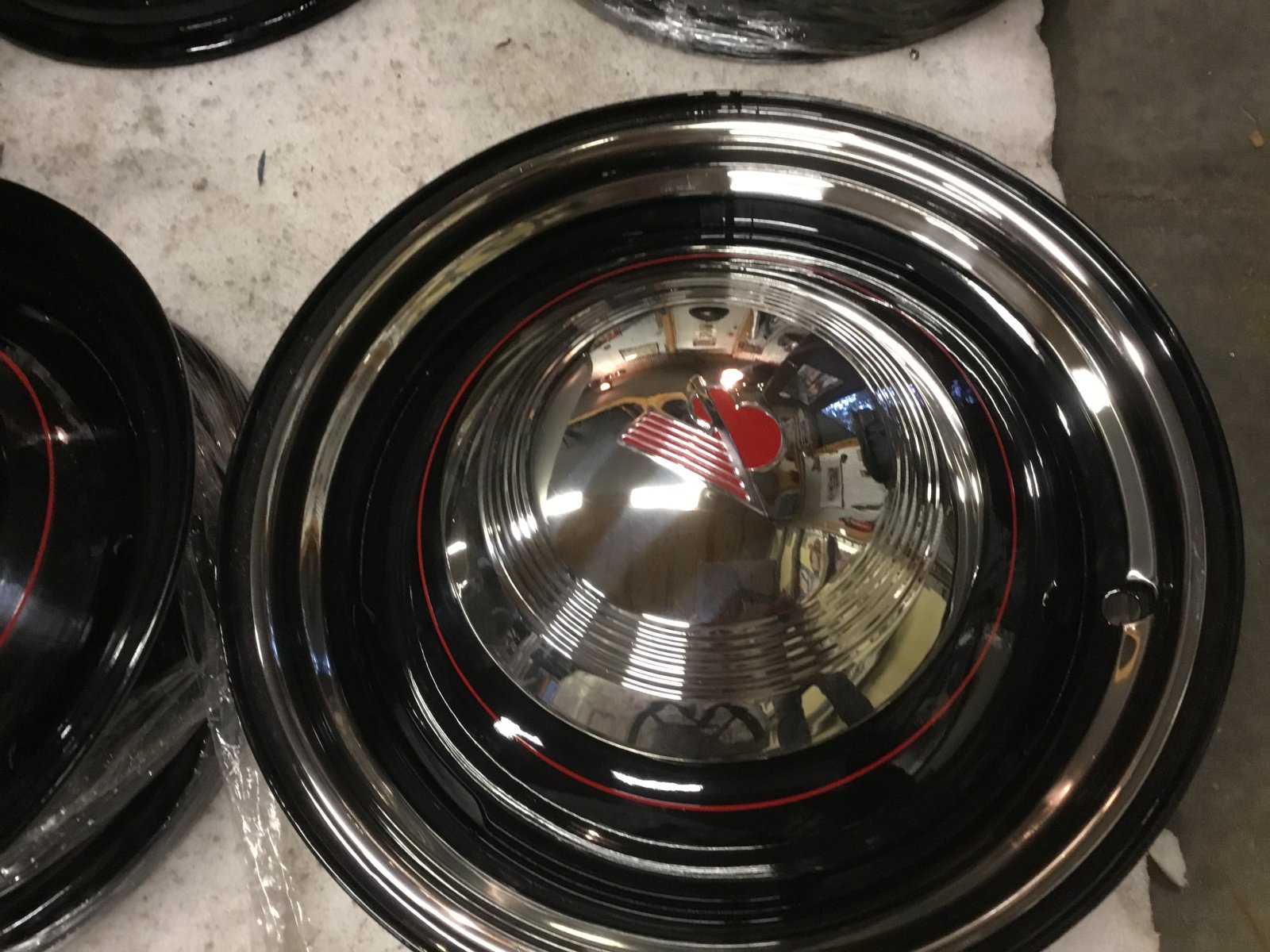

    Been plugging away with small stuff. Got the trunk floor welded in and the crossmember hump bolted down. 64A0B4B0-7232-4452-9271-43A32C532B56.jpeg E95B65B4-E2F0-4714-B243-F16130188402.jpeg Welded nut plates up in the sub rails so I can mount the trunk quarter down F12B8E29-EED3-4D11-AF2F-F7336692FAA4.jpeg Turned a few aluminum bungs to hold the headlight conduits on the frame. AA65B504-5DE7-4C1C-9F97-BBC3A297EFCE.jpeg And had my good friend Randy come up to the shop to help pinstripe the wheels. I had made a jig to hold my bugeler pinstripe tool but I couldn’t hold the tool and turn the wheel at the same time. They aren’t perfect but it looks damn fine. 0CB9CD30-1503-4A97-A342-45008EAD1EAD.jpeg 07A95D8D-5348-4708-9958-66D2571F48C3.jpeg
  8. tombstone
    Joined: Jan 15, 2006
    Posts: 550
    tombstone
    from sk.canada
    Looking good ….. those bungs are great ‼️

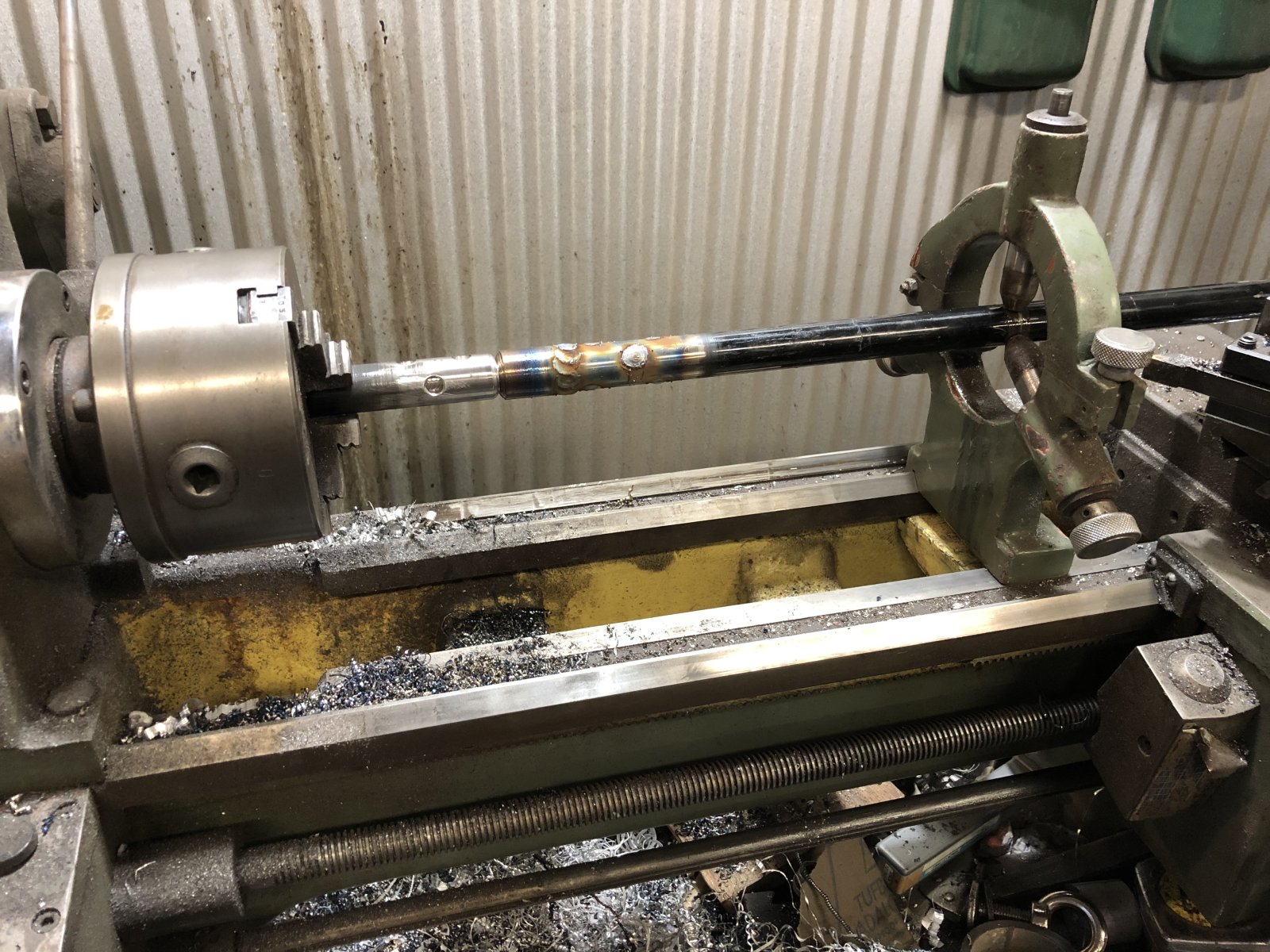

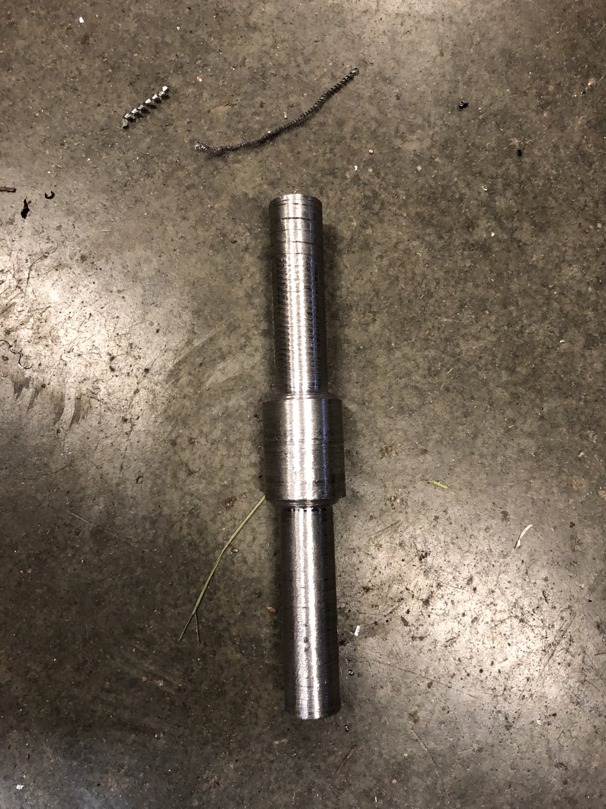

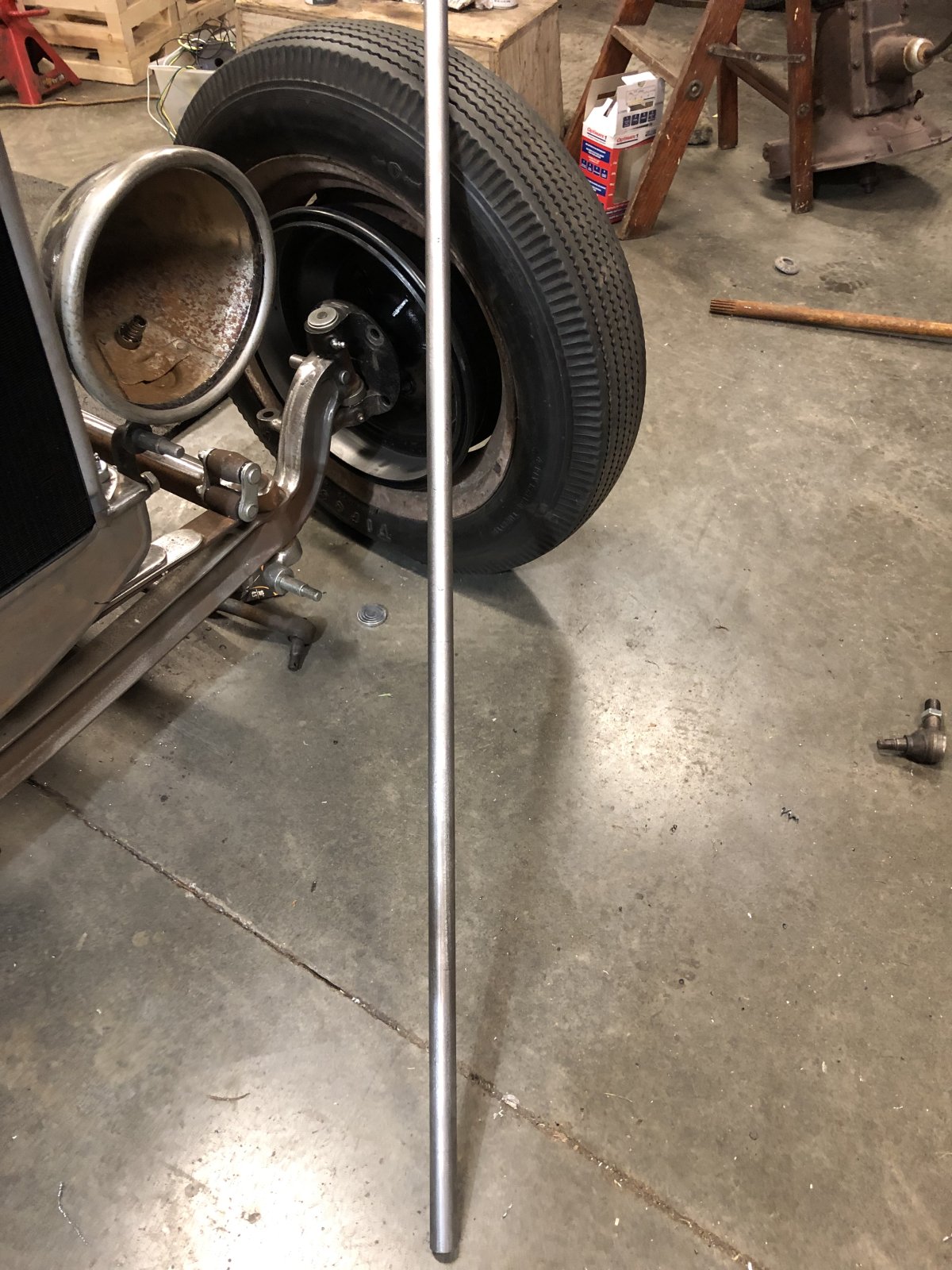

    66C9156D-899C-4959-BC06-E86881010132.jpeg D1EC8D85-C13A-4985-BF86-5DE35C21F57A.jpeg 3F07FF61-F44E-48E5-B918-20F8C7343CD6.jpeg A28D42B7-AE25-4F35-B7E4-F491734ABEE0.jpeg 92197DD0-2810-4257-B796-455F8C7C3B9F.jpeg So early on when I ordered my tierod from speedway I either misread there measurements or they sent me the wrong one, I’m guessing I misread.
    Today I cut it in half made a bung and lengthened it an 1-1/4”.

  10. Blake 27
    Joined: Apr 10, 2016
    Posts: 1,554
    Blake 27
    It's really good to see you back working on your project.
    The details mean so much on great build, keep up the good work!

  12. manyolcars
    Joined: Mar 30, 2001
    Posts: 9,609
    manyolcars
    Where do you get a piece of aluminum this big?
    Stogy likes this.
  13. Squablow
    Joined: Apr 26, 2005
    Posts: 18,544
    Squablow
    This quote is the story of my life!
    I like the pinstriping on the wheels too.

  14. rusty rocket
    Joined: Oct 30, 2011
    Posts: 5,264
    rusty rocket
    I’ve had this piece laying around for years but our local steel supplier has cut offs that a guy can buy small chunks.
    Stogy, Tim, brEad and 1 other person like this.
  15. rusty rocket

  16. atch
    Joined: Sep 3, 2002
    Posts: 6,437
    atch
    That invisible wheel is really cool.

  17. Mart
    Posts: 5,008
    Mart
    I like the lengthening job on the tie rod. Glad you did it near one end and not in the middle.

  18. rusty rocket
    Posts: 5,264
    rusty rocket
    I cut it right in the middle. The bung was a hammer it in fit so it will be plenty strong.

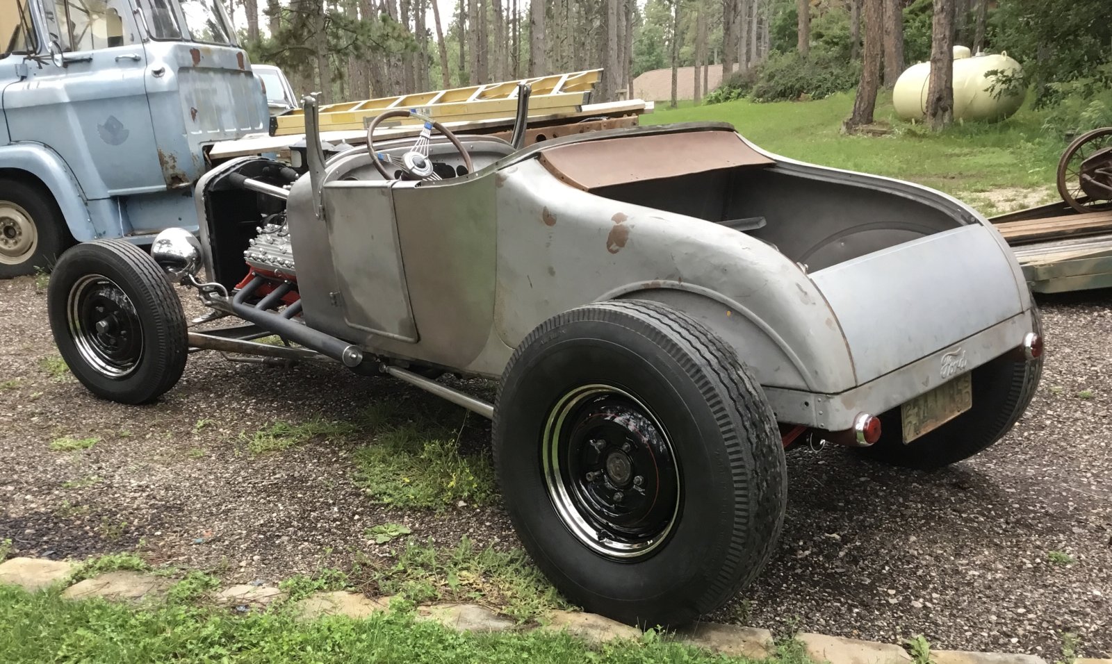

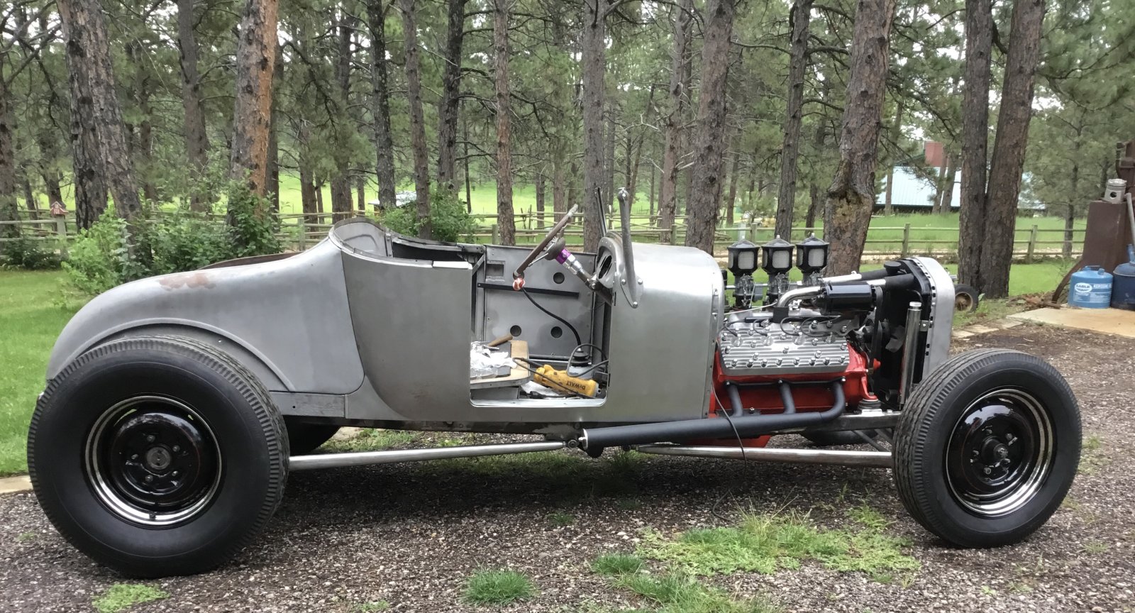

    The roadster hasn’t seen the light of day for quite sometime. 0307E99B-3F7E-4165-A4C5-FA5A7A0C7BFD.jpeg 4598333C-76D2-4F9C-A0A5-B9AEDDB332A8.jpeg 38E62A32-1414-49CB-BB8C-F86DBFAC5957.jpeg
  23. Blake 27
    Posts: 1,554
    Blake 27
    Wow, officially a roller!
    Maybe I missed it, did you ever resolve your fuel pump-throttle linkage issue?
    Stogy and Greenblade like this.

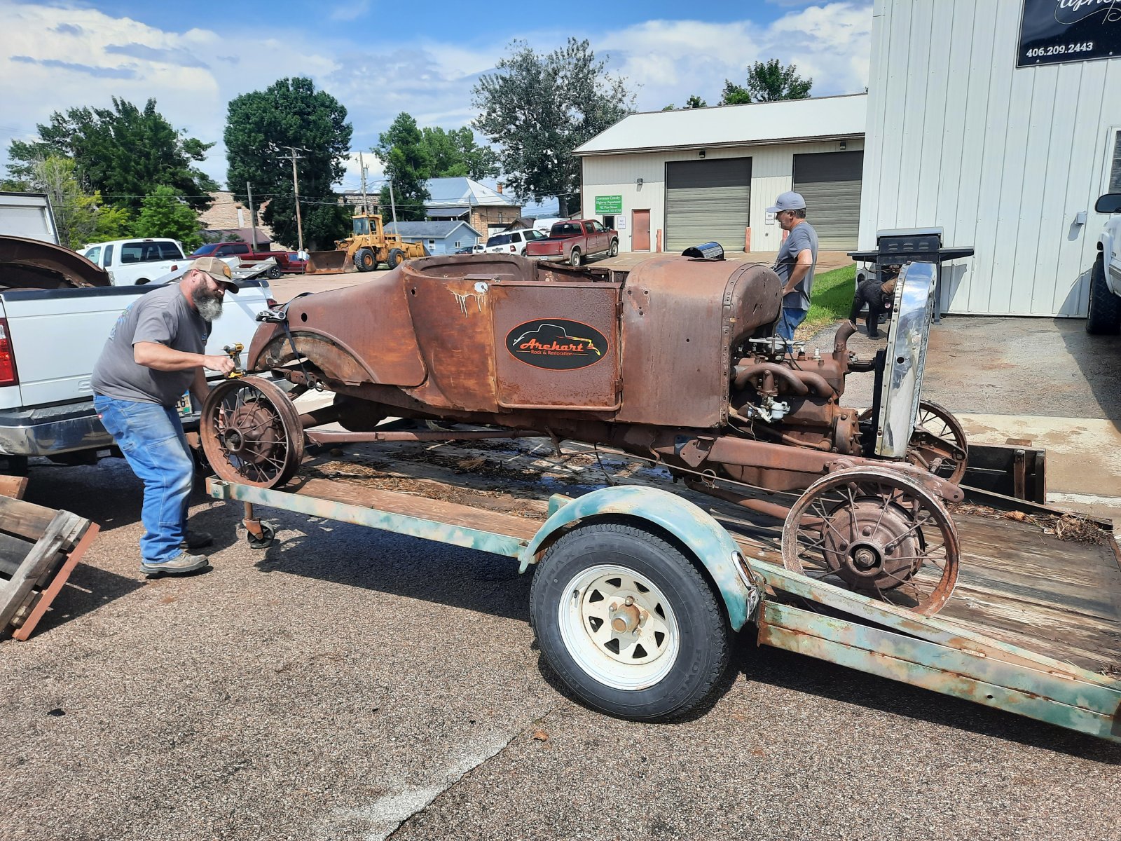

    I had forgot to post but my dad and I had bought a ruff 26 roadster on a model A frame. I was able to salvage the panel above the deck lid. Even though it need some holes filled and wiggles straightened it’s 100% better than the Howell sheetmetal panel that I wasted my money on. 7A98CD95-3F7E-42BD-A939-7138CA947FE7.jpeg
    E31C5A46-277D-4C46-AF3C-298B6DF10040.jpeg 71BCF8ED-4502-41DB-A231-32F90DE4B755.jpeg
    roadwarrior84, Stogy, Tim and 5 others like this.
