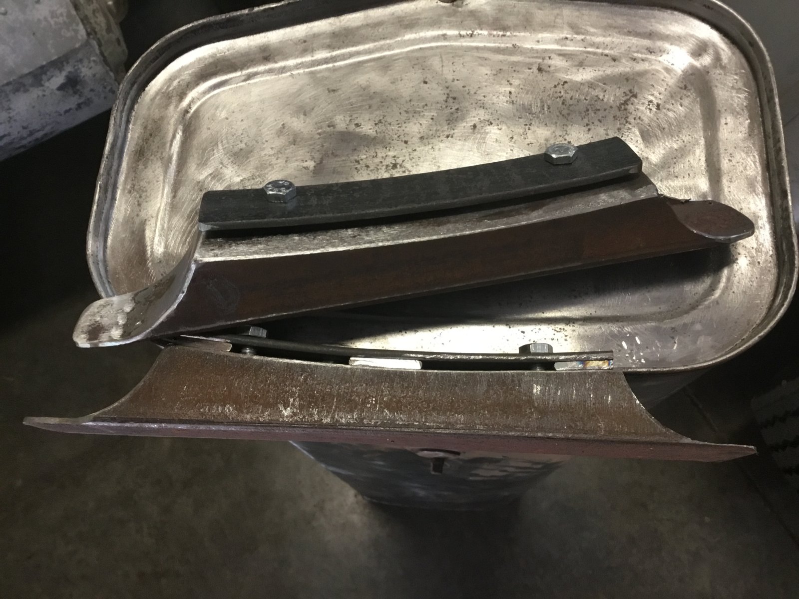

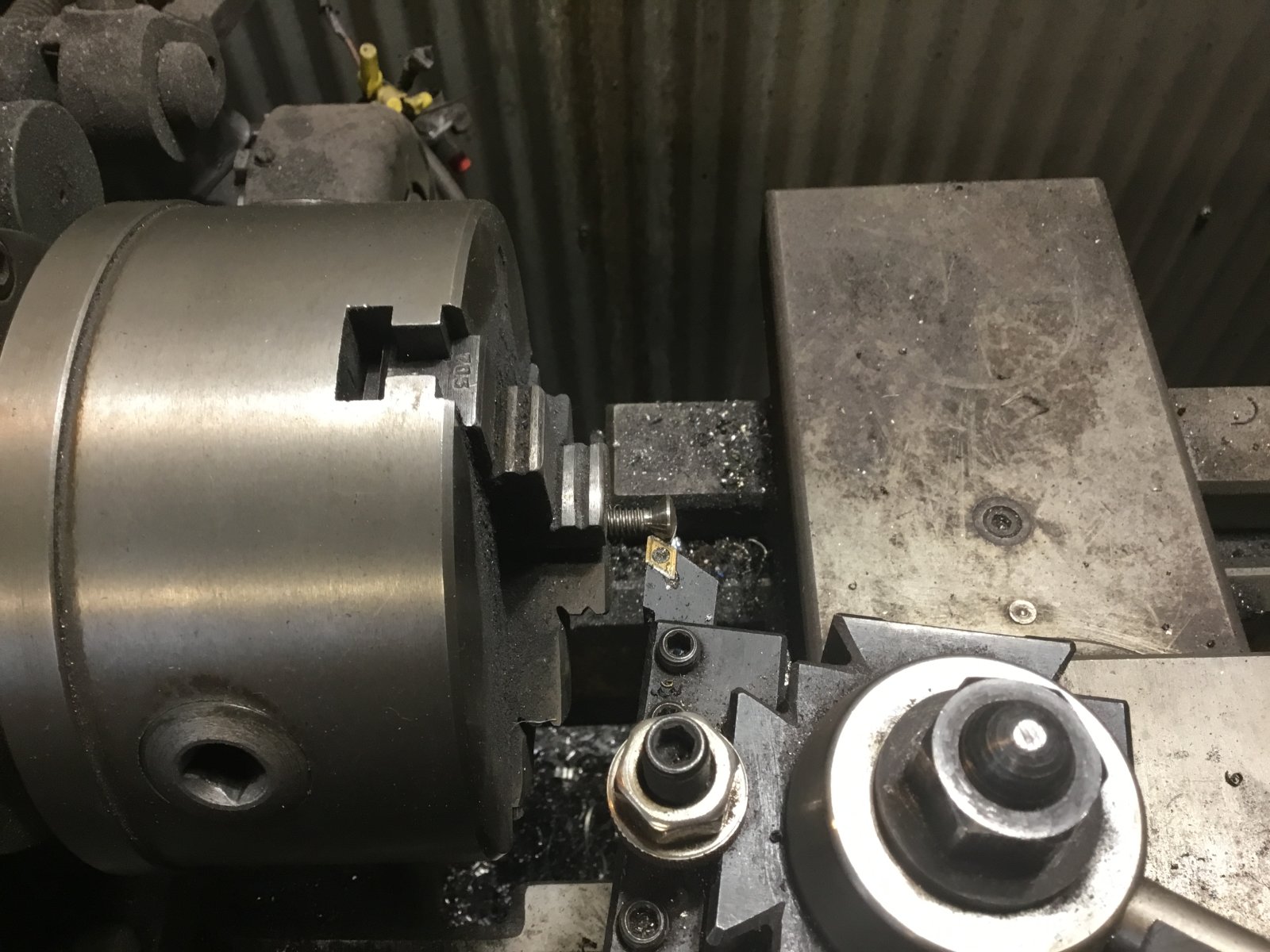

    I have both doors on and swinging and latching. It was quite a process. I found the special countersunk washers in stainless that hold the hinge to the body and hinge to door but damned if I could find stainless slotted hinge bolts. Im pretty sure Ford used a 12-32 bolt but all I could find was 1/4”-20 bolts. I ended up chucking all the bolts in my lathe and turning the head down to #12 size to fit inside the countersunk washers. 65C7858F-7285-475C-83E0-E016497A36D4.jpeg BD27B120-3B0C-48A7-A0BD-82D7F9EFF56E.jpeg DF7C7D7F-34ED-44C0-8F1F-486217B013DB.jpeg I also made some brackets to hold the 29 Chevy fuel tank. 3F8CAD6D-23AC-44EE-B33F-DBCC84060F69.jpeg

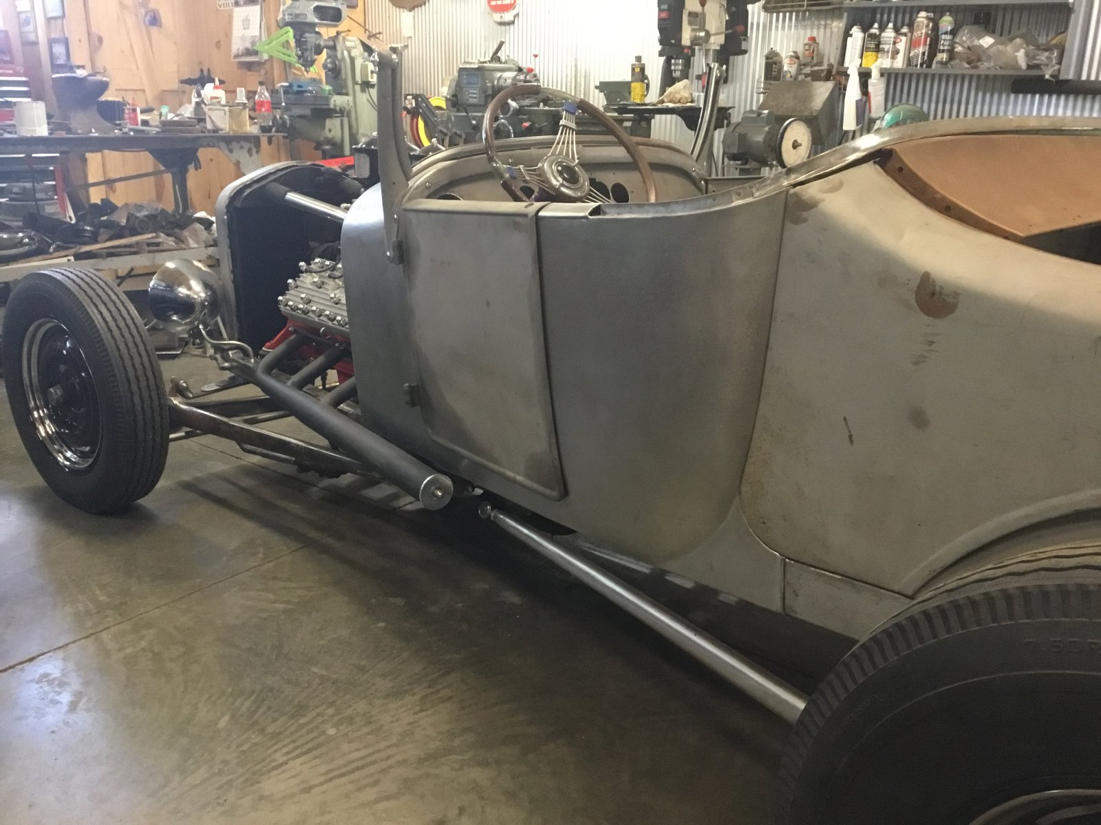

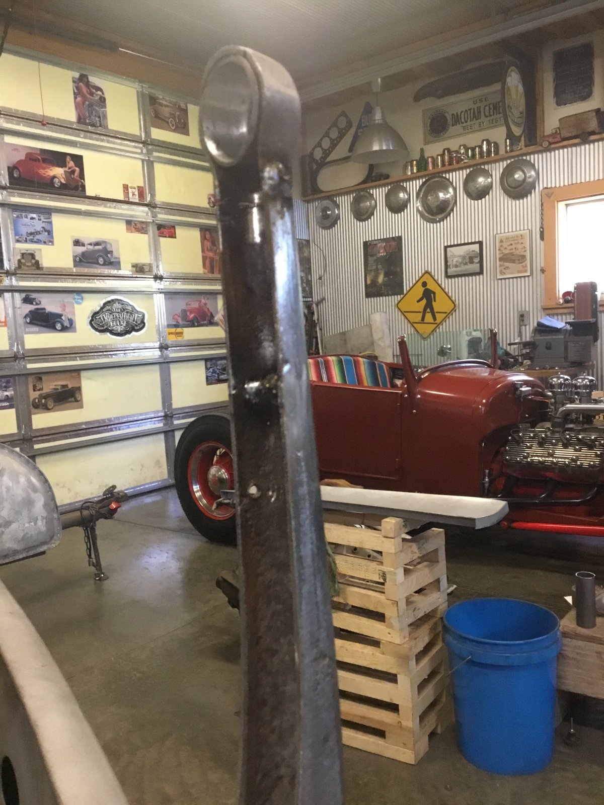

    Adding a bit of height to the windshield. When I built my 26 modified I just used the stock lower frame and capped the posts to clean things up but I look right over the top of the gl***. On this car I’m adding 2-3/8” to everything so I can be behind some gl***. 0A628072-3E82-408F-B234-046C894D02B2.jpeg 9525CC47-F680-495B-A331-7ADEB9EBC538.jpeg 2743CC59-8096-4FD6-BA92-0C595B90F127.jpeg

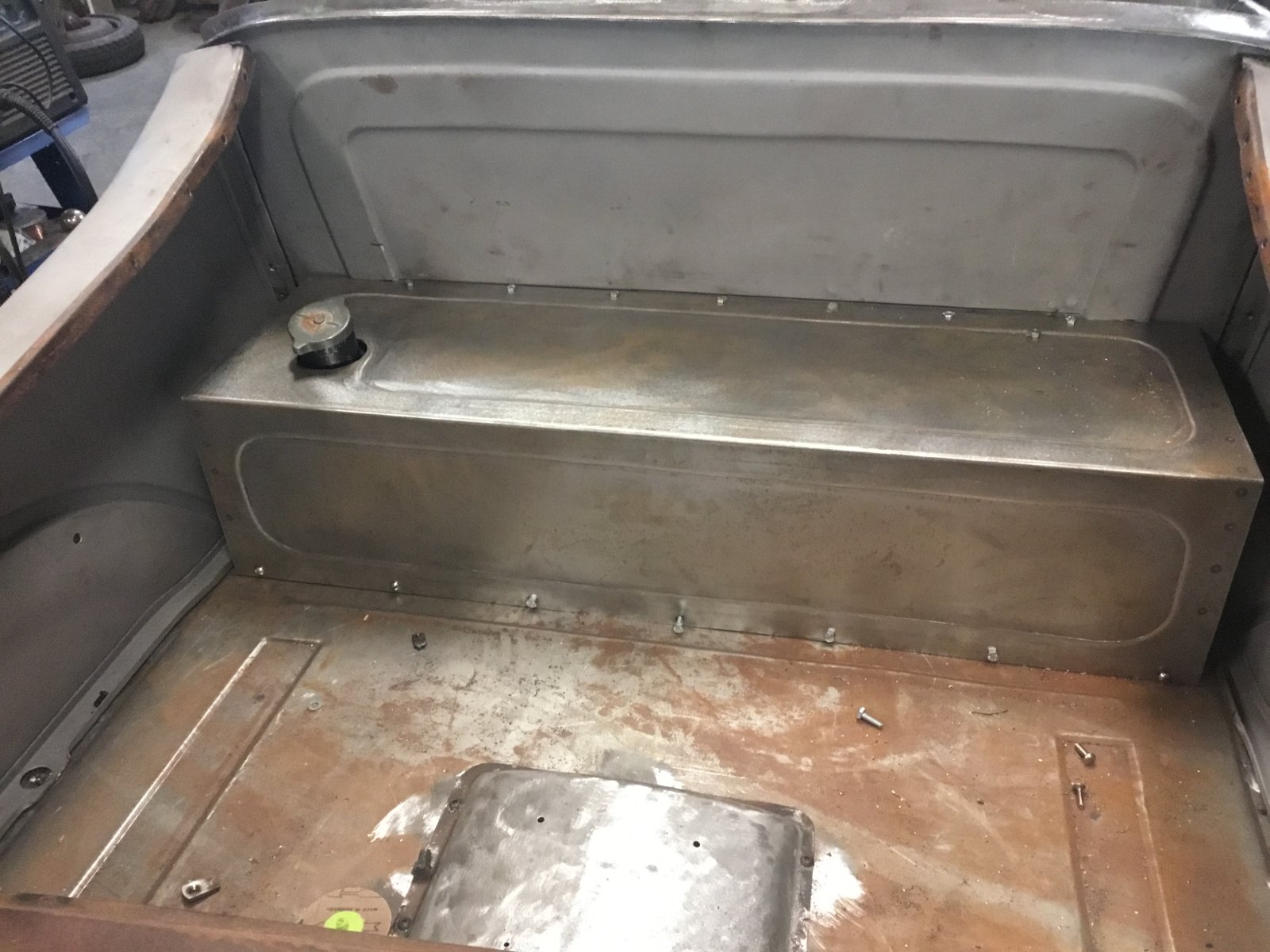

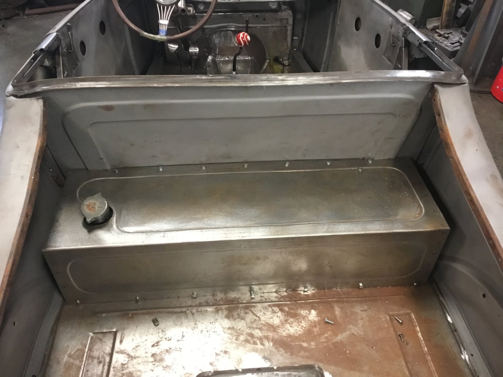

    Haven’t done much on the project lately but did make some gas tank mounts and mounted the old tank in the trunk. My tank is an old 28 thru I believe 30 Chevy and it had a few dents in it but it’s very clean and solid. I made a piece to cover it so I didn’t have to mess around pulling the dents and making the tank all pretty. 49841531-02B7-42E7-AEAE-4FD4873F5A3C.jpeg D1E12D8C-F45B-4C9E-A54B-A3B4AD3342BF.jpeg

    No fuel sender?

    It’s all under the cover.

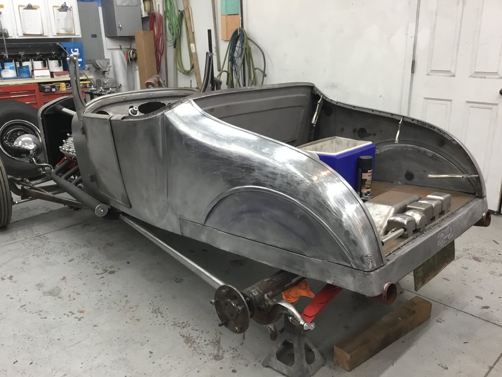

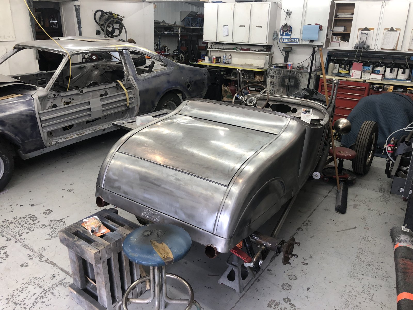

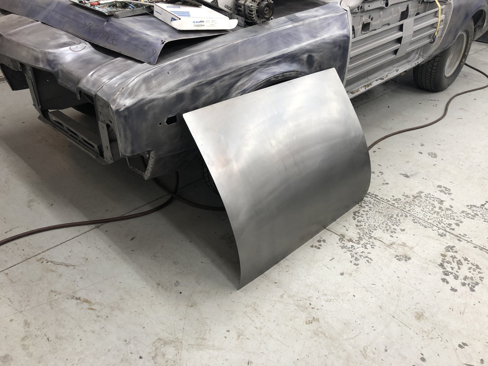

    After searching for two years for a decklid I finally gave up and am having my buddy Jamie at Rapid hot rods build one. First thing to do though is straighten up the bumpy quarter panels and get the upper and lower panel fit. Quarters are damn close after two days of banging away. 710F365F-BF01-4CF5-BEC1-594476490796.jpeg B15A83C4-3250-449F-984E-307FC42AFE85.jpeg 04F4B8C6-AA5B-4DB4-AA91-5B51B74CA572.jpeg 746F6CE7-B4AB-43B2-9B2A-CF42CDACC5F8.jpeg

    That sheetmetal looks NOS compared to my roadster body.

    Good western South Dakota sheetmetal that sat outside for 90 plus years! I got the last piece though so everyone else can look elsewhere! Hahaha!

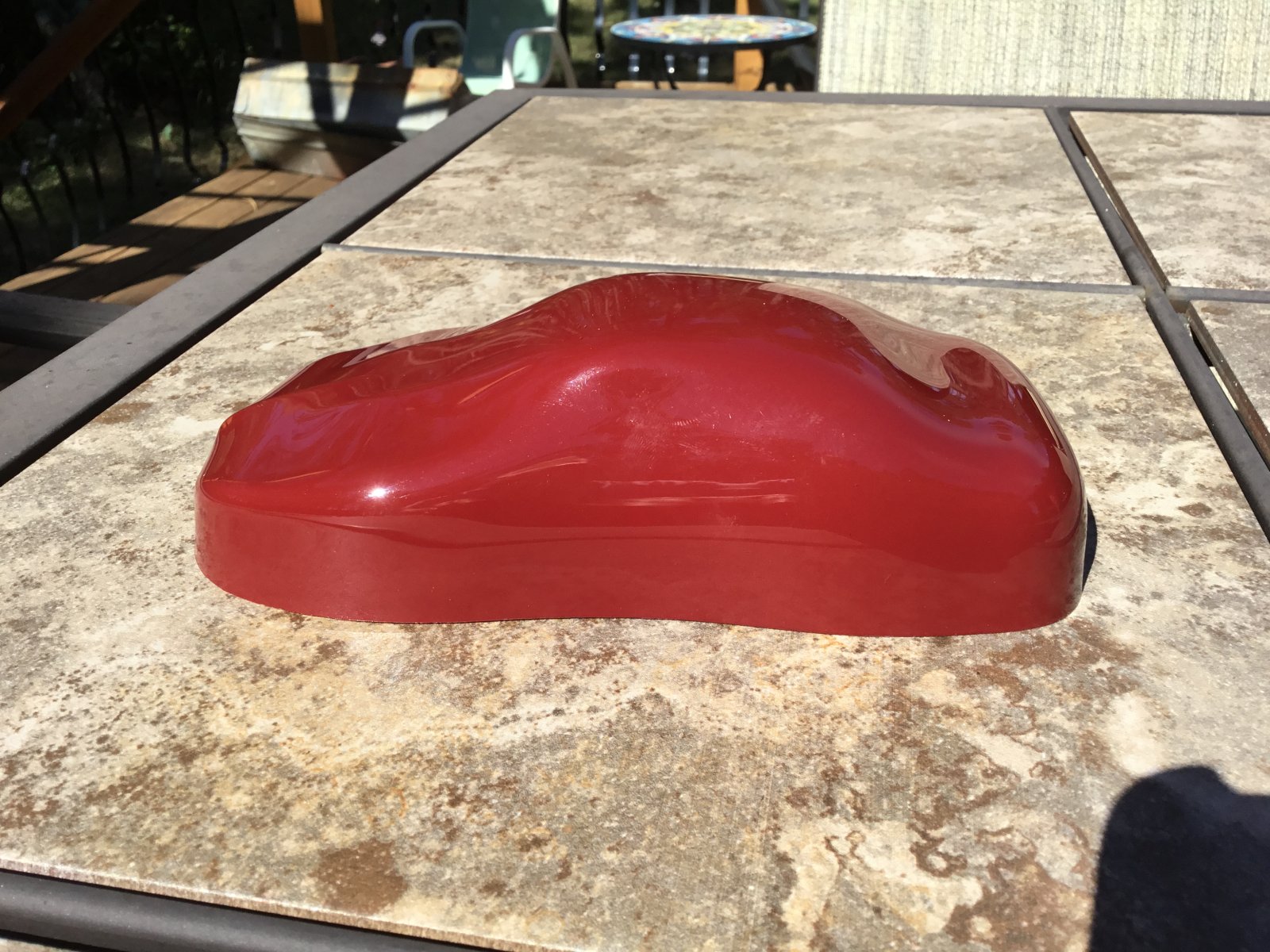

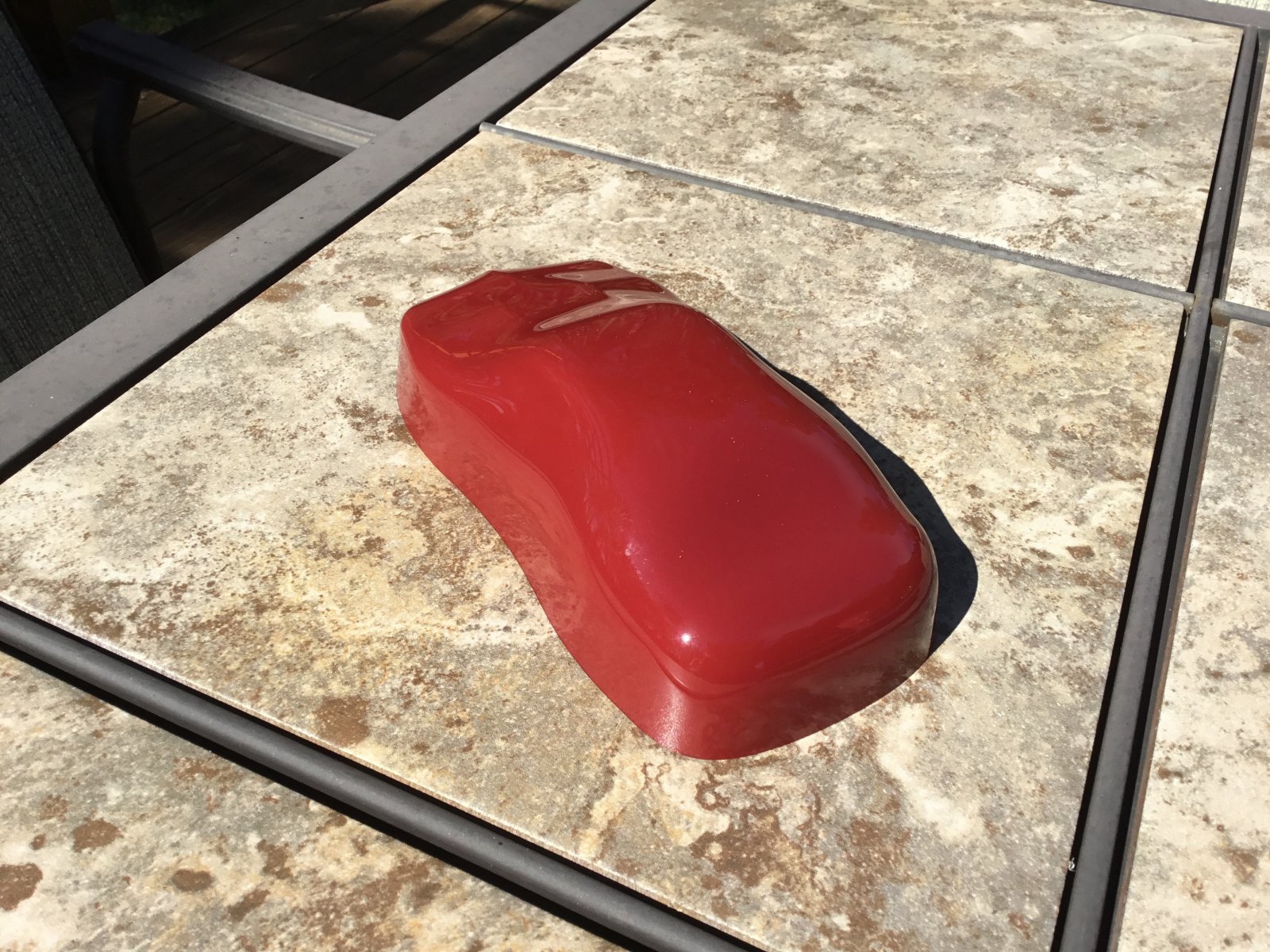

    Did a spray out of 1930’s Indian motorcycle Indian red. Have to run it by my pops to see what he thinks. I’m on the fence right now with the color. Of course photos really change the true color. DEC017E2-63FD-4393-AF5E-7B569C9946E2.jpeg CBC52C16-7D49-47CE-AC31-3BAE3AE9C8BC.jpeg

    You do like the Indian colors. How did you get started down that path?

    Hahaha! Well when I built the 32 I was bound determined it was going to be Washington blue. After some research I found that there are several shades of Washington blue and then I started thinking there are a lot of Washington blue cars out there and I didn’t want to be a follower. Around that time my wife and I went to a motorcycle show and there was a 37 Indian painted Navajo blue and I knew immediately that that was the color. I’ve seen several 30’s-40’s Indians painted Indian red and thought that’s a really nice traditional color. So you are correct I like the colors mostly because they are traditional colors just not car related.

    Getting closer to having a deck lid. The upper panel proved to be a chore. It has the original framework underneath and and a new skin on top. Next week I’m hoping there’s a lid. FD1959EC-B2F8-49CA-83A0-3C8DA218516C.jpeg

    Well since it’s not yours I don’t think you have a choice. By the way the color is called Indian red but it’s actually a dark maroon.

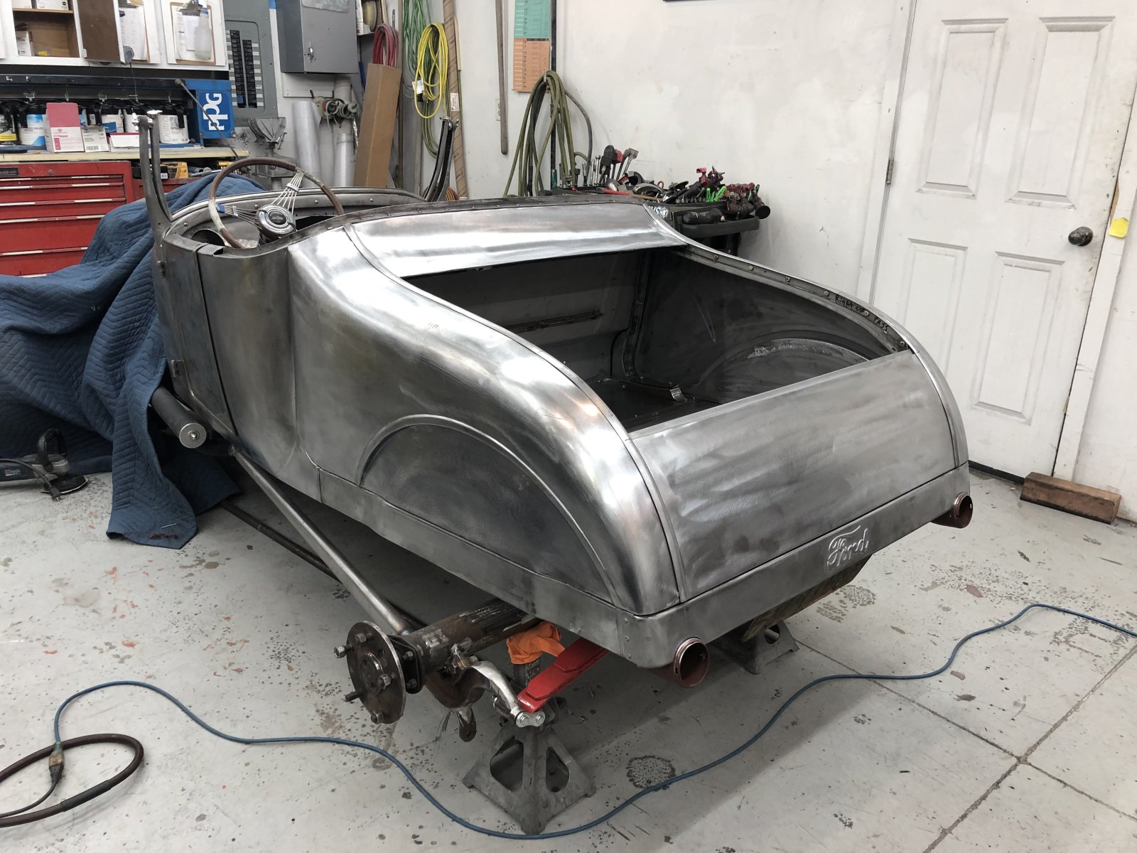

    Skin has been powerhammered out and the inner structure is looking like a work of art thanks Jason at Rapid hotrods. 6250C4FE-B966-42EF-9D35-C1DACD4A57CF.jpeg B8DE975F-D3A3-4E93-8062-6FC90EF2EC83.jpeg

    There’s a decklid in the hole after 2 years of searching. Still needs some adjustments and the hinges figured out. I’m so stoked!!! 733EEC4B-B594-4F13-9C78-FA488656CEFB.jpeg D1F90A61-6068-4113-BCB3-AB0FCFC237BB.jpeg
