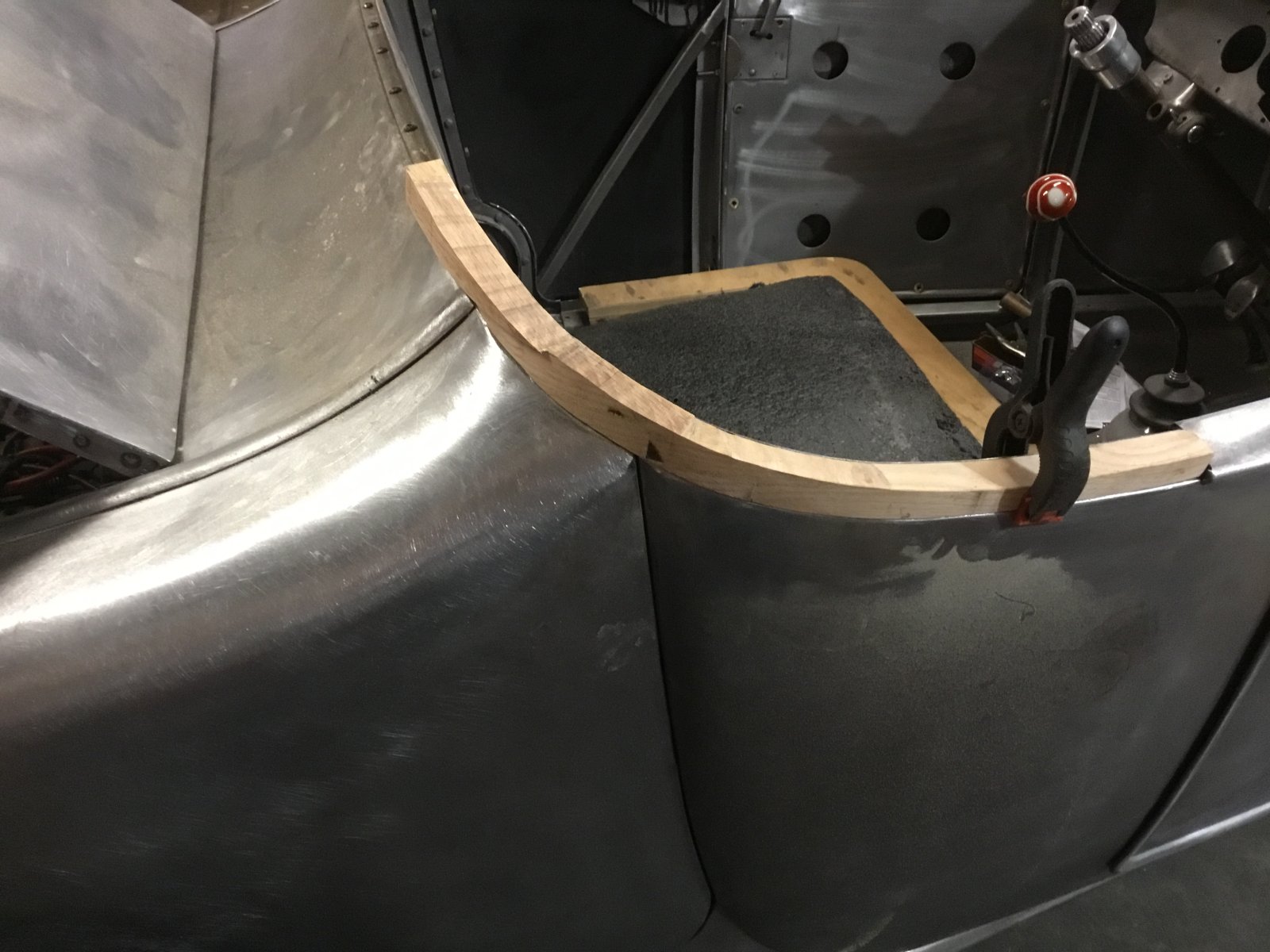

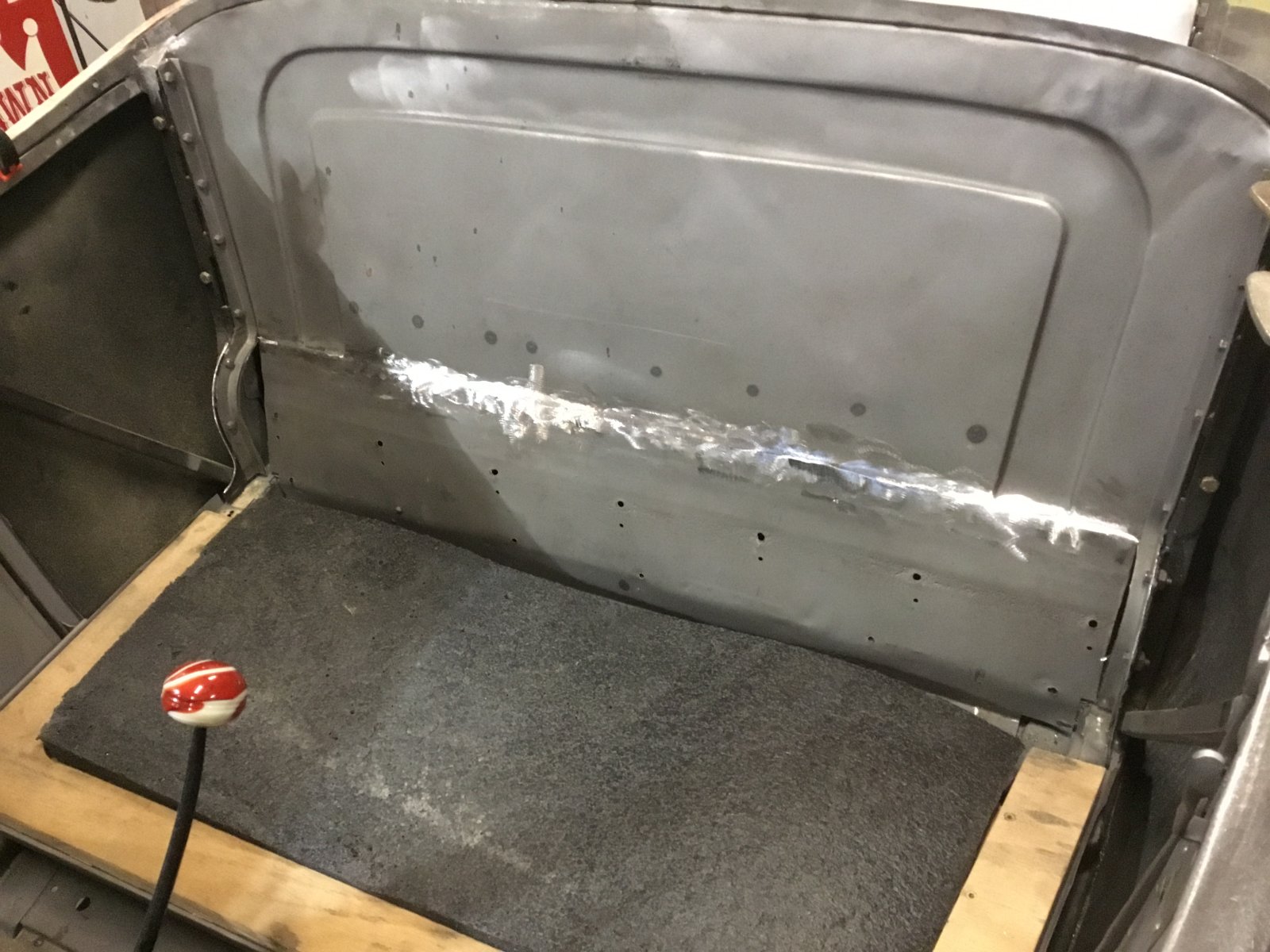

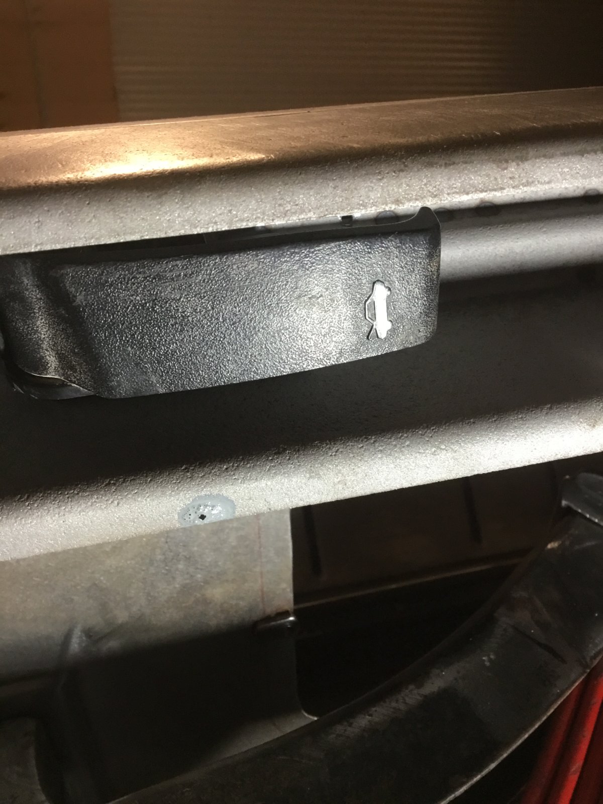

    I’ve been busy doing things that take forever and it doesn’t look like you’ve done nothing. The fuel lines are all bent and installed.

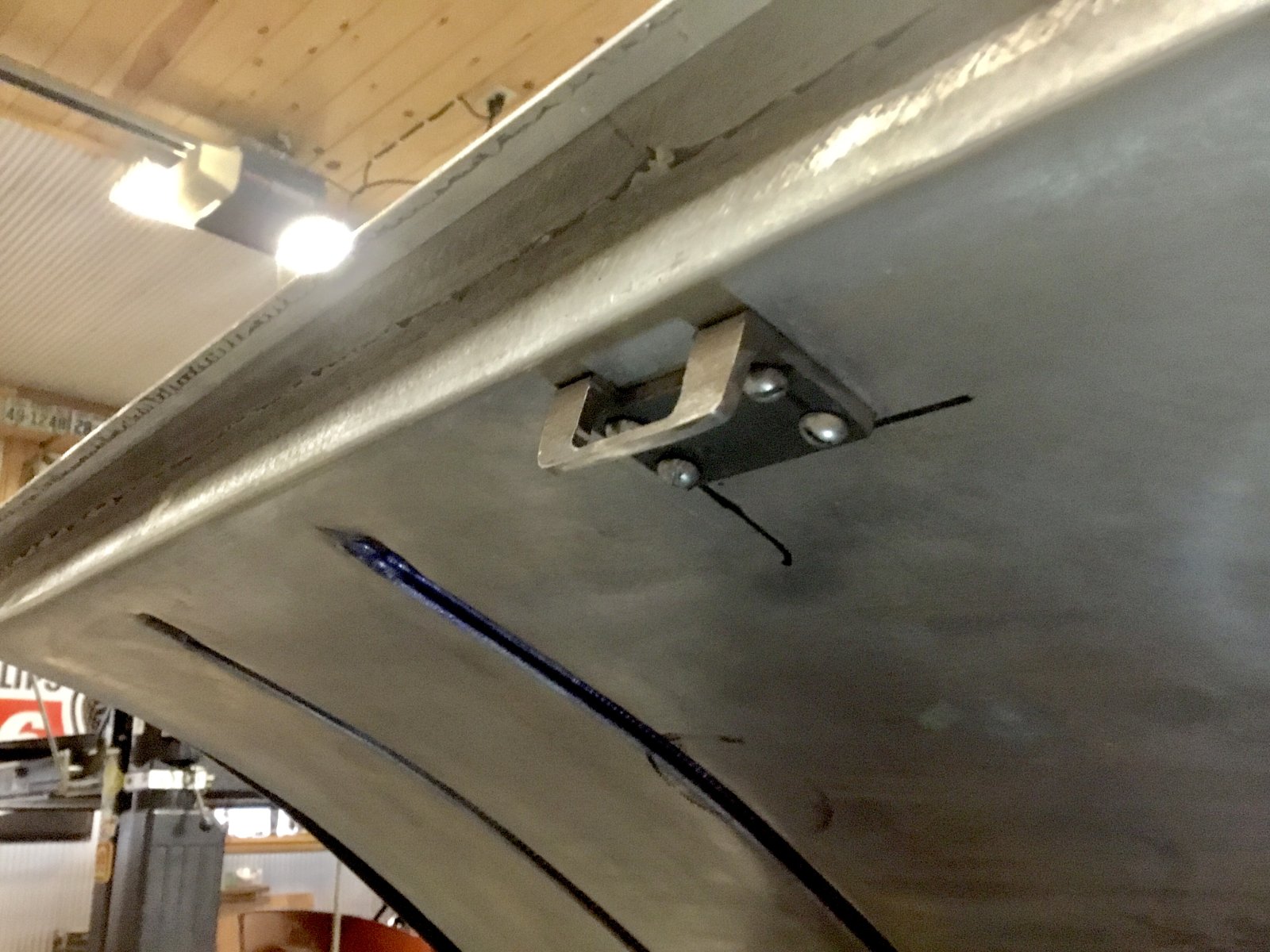

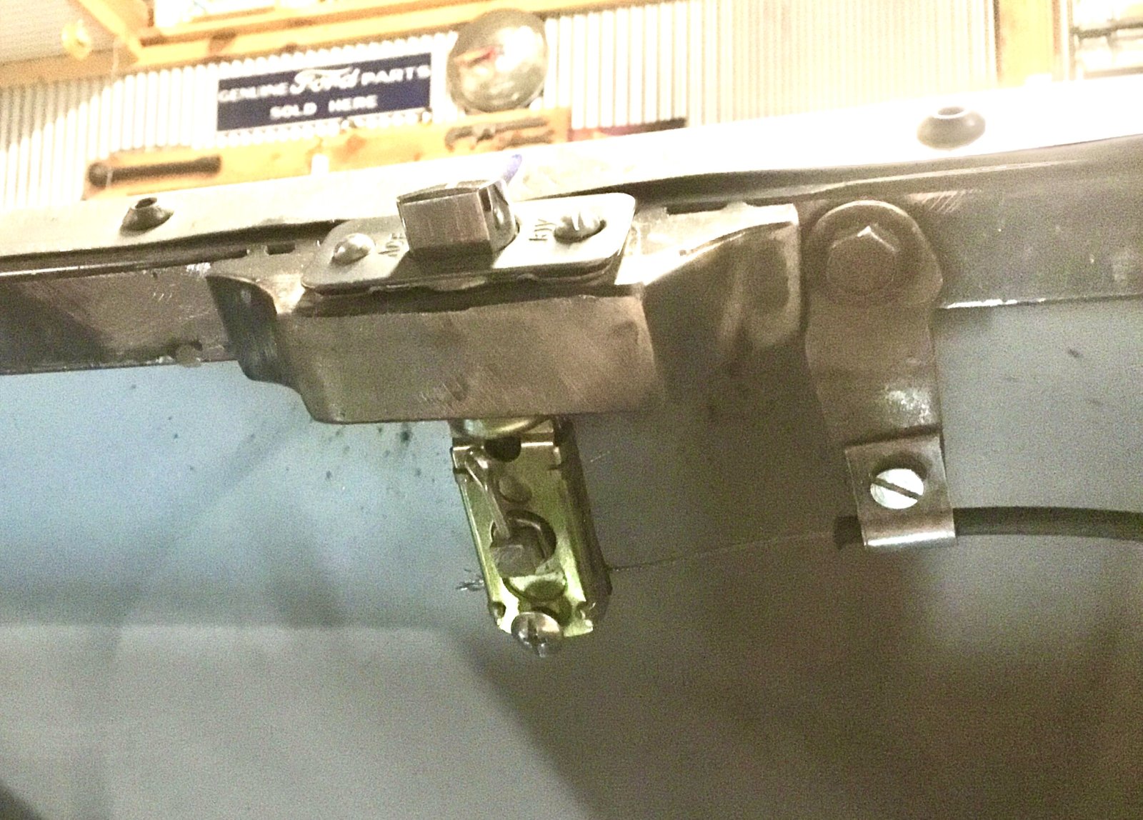

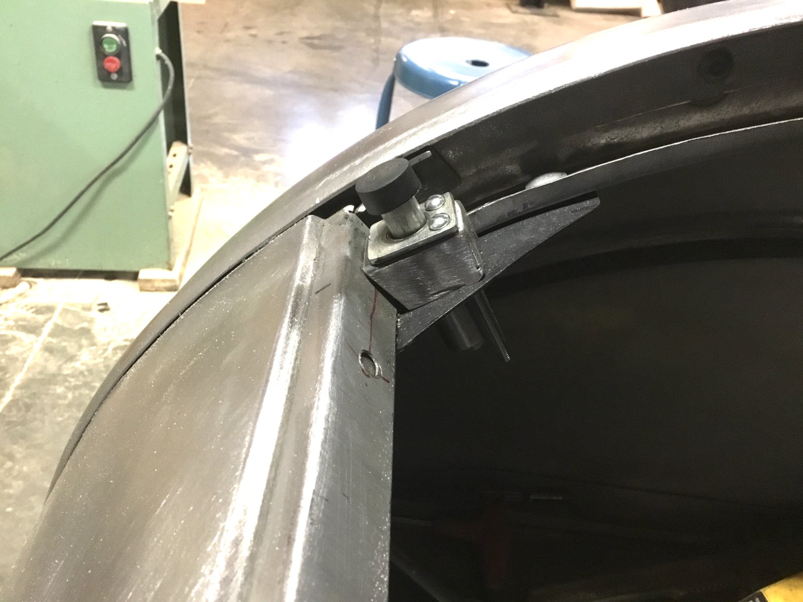

    I cut the hump out of the seat back and made it flat to gain a bit more leg room. 6A264B38-7EB7-4D99-82DC-DF22041F1331.jpeg 3C9E9503-1FD6-4DF6-BDA7-31A3E805C069.jpeg I’ve started building the wood perimeter for the interior to tack to. F7DD0CA6-29A4-429C-8049-7E556042CC56.jpeg And I built a trunk latch from an interior door backset. I milled a piece of square stock and welded an arm on it for the cable to pull on. BB127F28-48E3-4766-A202-2EC6E04CE316.jpeg I milled a piece of angle iron for the catch. 7131E7A4-BDC5-4665-8E34-AD5C898A3F46.jpeg Years ago I bought two door poppers for cheap so I’m using these as the trunk stops and they pop the decklid open when the cable is pulled. 8F0E69A8-39D2-4A6F-8548-20BD3B6A22CA.jpeg I was parting out 2007 Chevy pick up so I took the hood release Handle and cable to pull the backset down. Lots of little things done that take time but doesn’t show it. 9FF2D2A7-AACC-46C8-AAEB-CFBCB28A8C0B.jpeg

    Yeah goldmountains latch got me thinking. I’m a carpenter by trade and guess what. I have doorknobs laying around! I just went about it a bit different. Power of the HAMB!!!

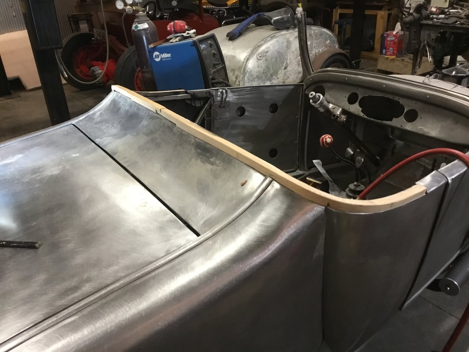

    Tack strip is oh so close just a few more small pieces to add, sand, finish and cover it up with interior, never to be seen again. I bet I have 20 plus hours in building this damn thing. AE46F2AB-5867-4654-9196-1DE5AC6E08D8.jpeg

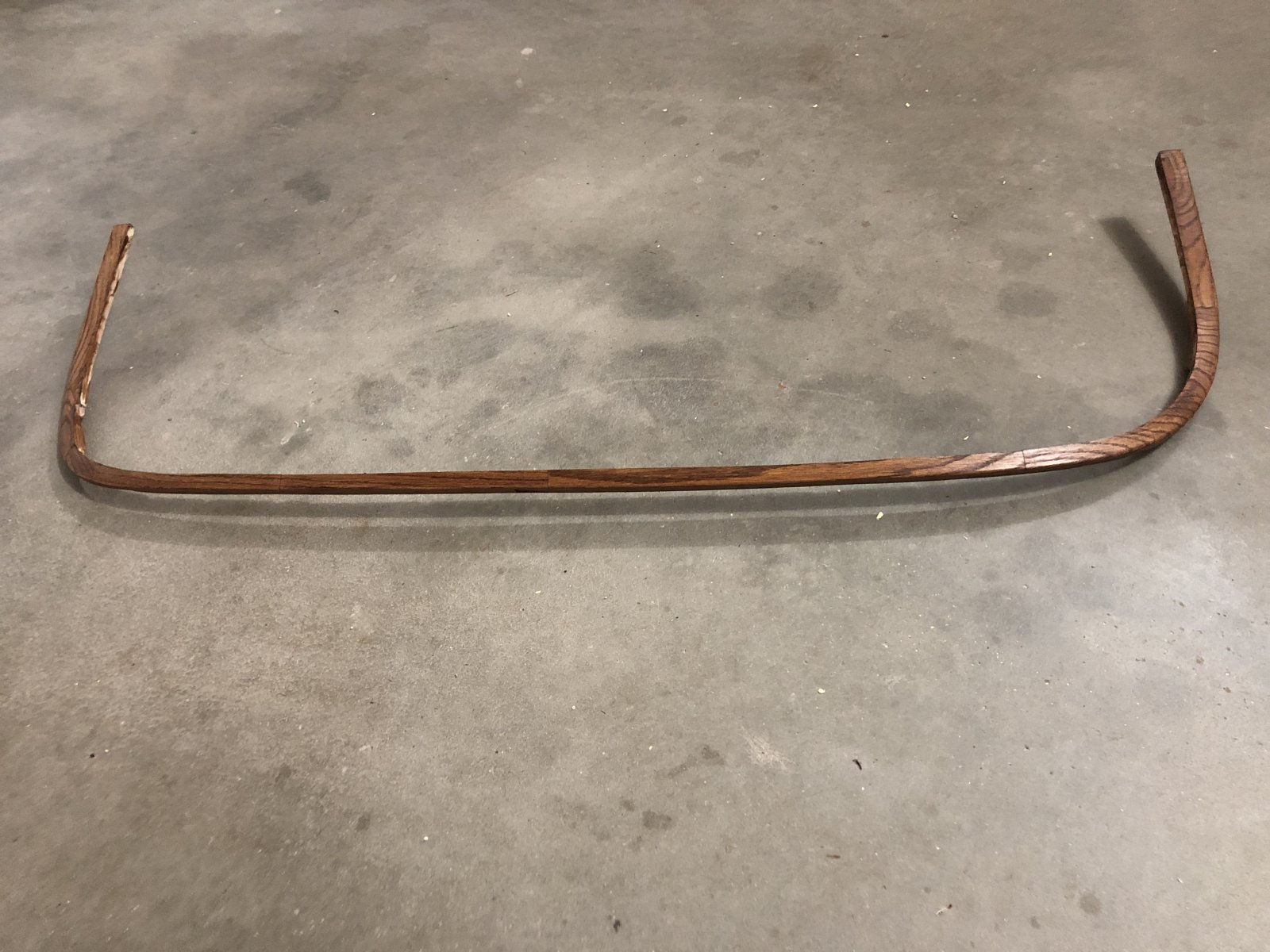

    Is that made without steaming or laminating, Rusty...pieced and lap joints only?...I know it's your specialty, Carpentry...good job Hamber...

    It’s all pieced together stogy. Lots of glued up little pieces. Just waiting on a few coats of spar varnish and it will be done. Check one more thing off the list. BAFF9813-70F7-4195-ABA0-417E0DCA6006.jpeg

    Probably no worse than the pieces you buy from a catalogue that don’t fit for ****. The upholsterer I am using is a personal friend and I trust he will do a good job. It’s screwed from the inside every 3” so If it cracks it can’t move and it will be covered. Oh and it will not have a top so we don’t have to worry about snaps.
