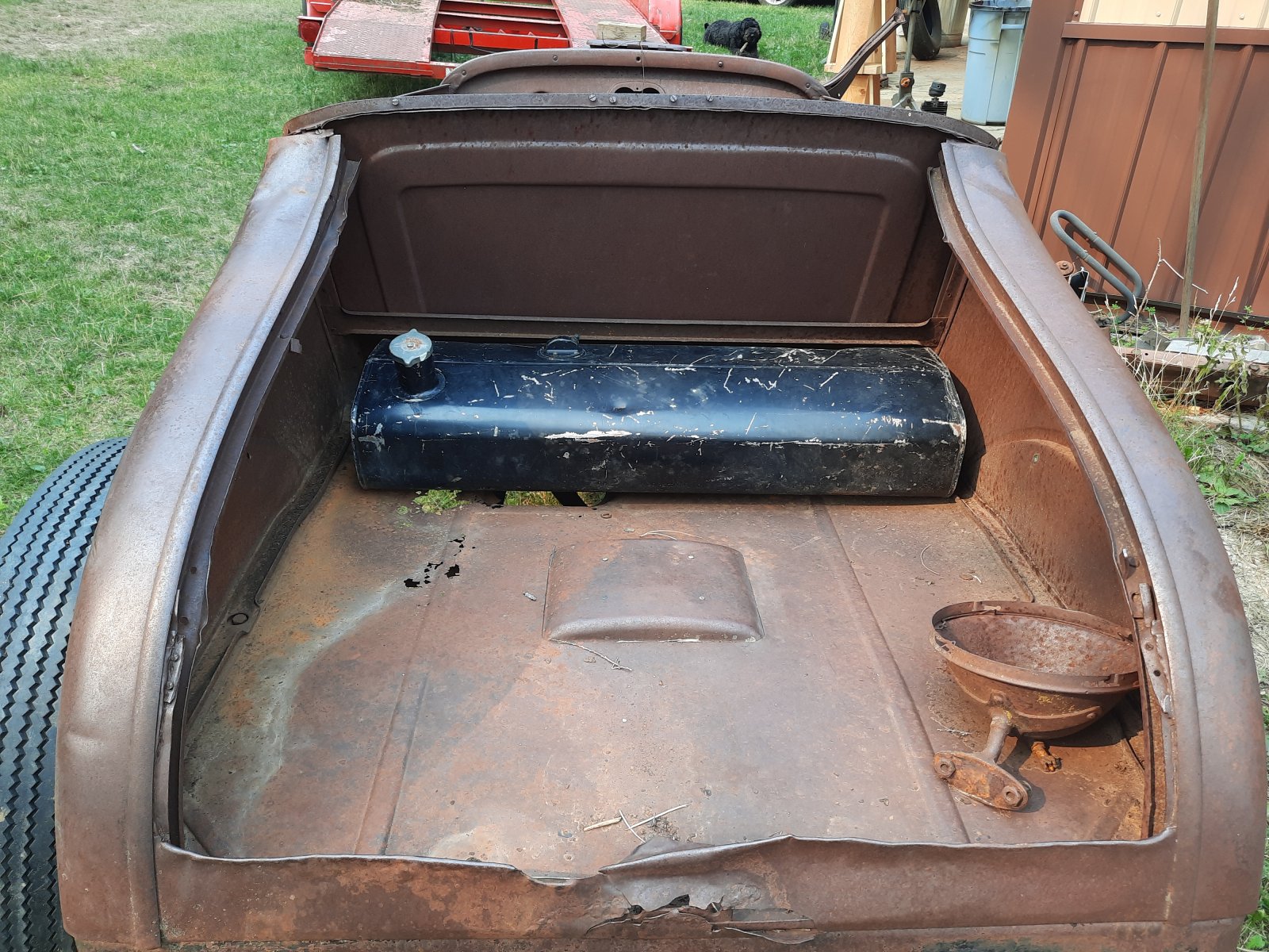

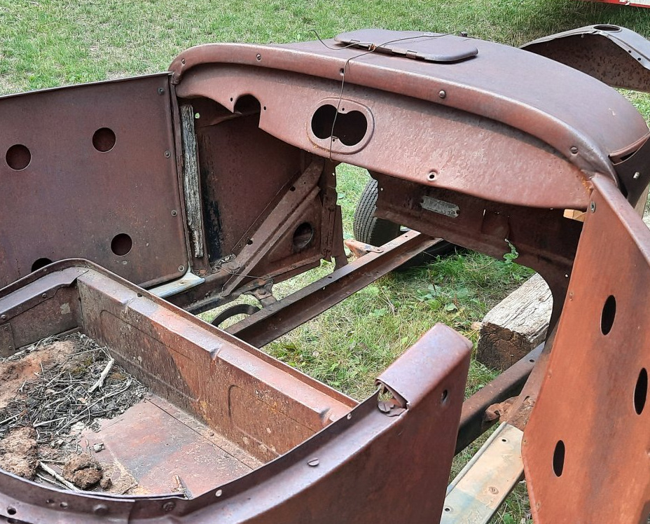

Hot Rods Rusty has a new project- father son build , 26 T roadster!
Discussion in 'The Hokey Ass Message Board' started by rusty rocket, Jul 26, 2021.

    For being dug out of a creek bed and sitting all those years, that body's really nice! Glad you folks found it to breath life back into it!

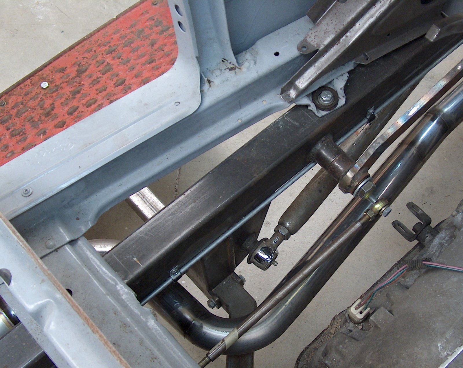

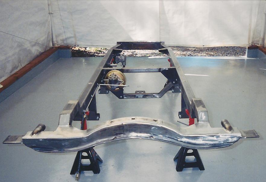

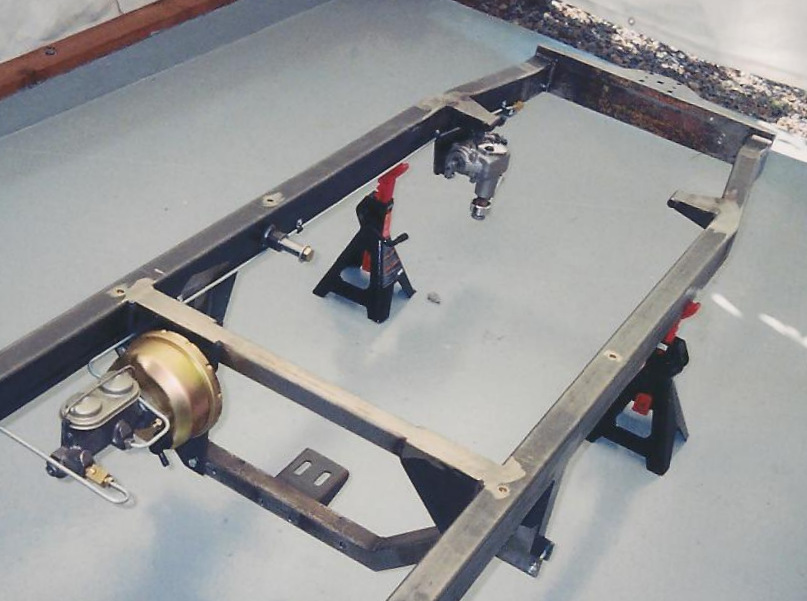

    Rusty, A couple thoughts about using a T frame.
    Boxed, probably plenty strong, but really narrow. We widened mine to make more room and give a little more support. Here's a few 20210831_152020.jpg HPIM01881.JPG 2004(Oct)-5 0011.jpg 2004(Oct)-5 0031.jpg pics to maybe give you some ideas.

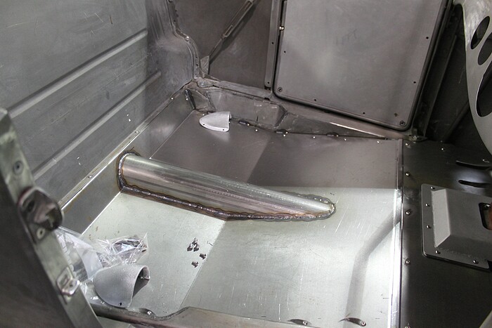

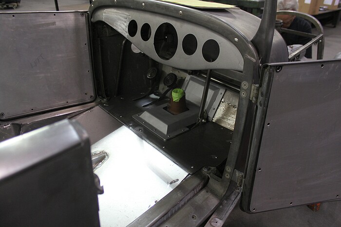

    A couple shots of the John Mumford AMBR winning 27. img_26_std.jpg img_27_std.jpg
  19. Blake 27
    Joined: Apr 10, 2016
    Posts: 1,553
    Blake 27
    AMBR.jpg img_32_std.jpg The Mumford T is channeled, but he was able to get the seat base nice and low by keeping the frame rails
    contoured to the outside of the body. It's got a rolled body pan, but I can picture a frame in it's place.ATTACH=full]5186588[/ATTACH]

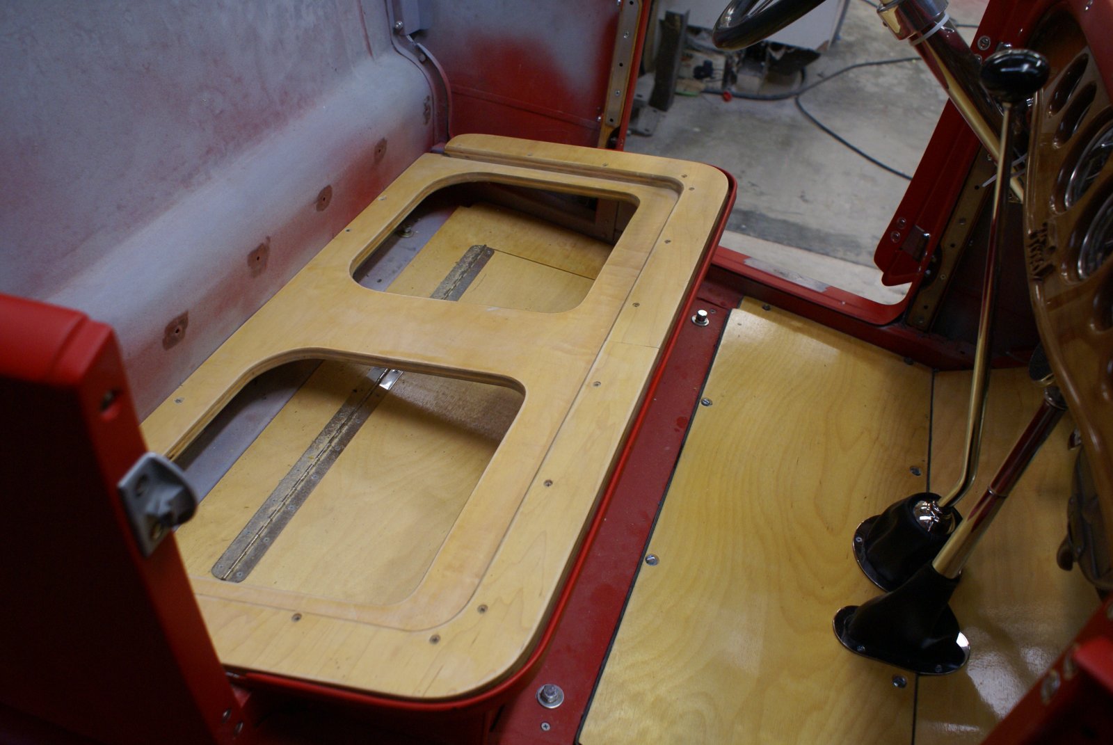

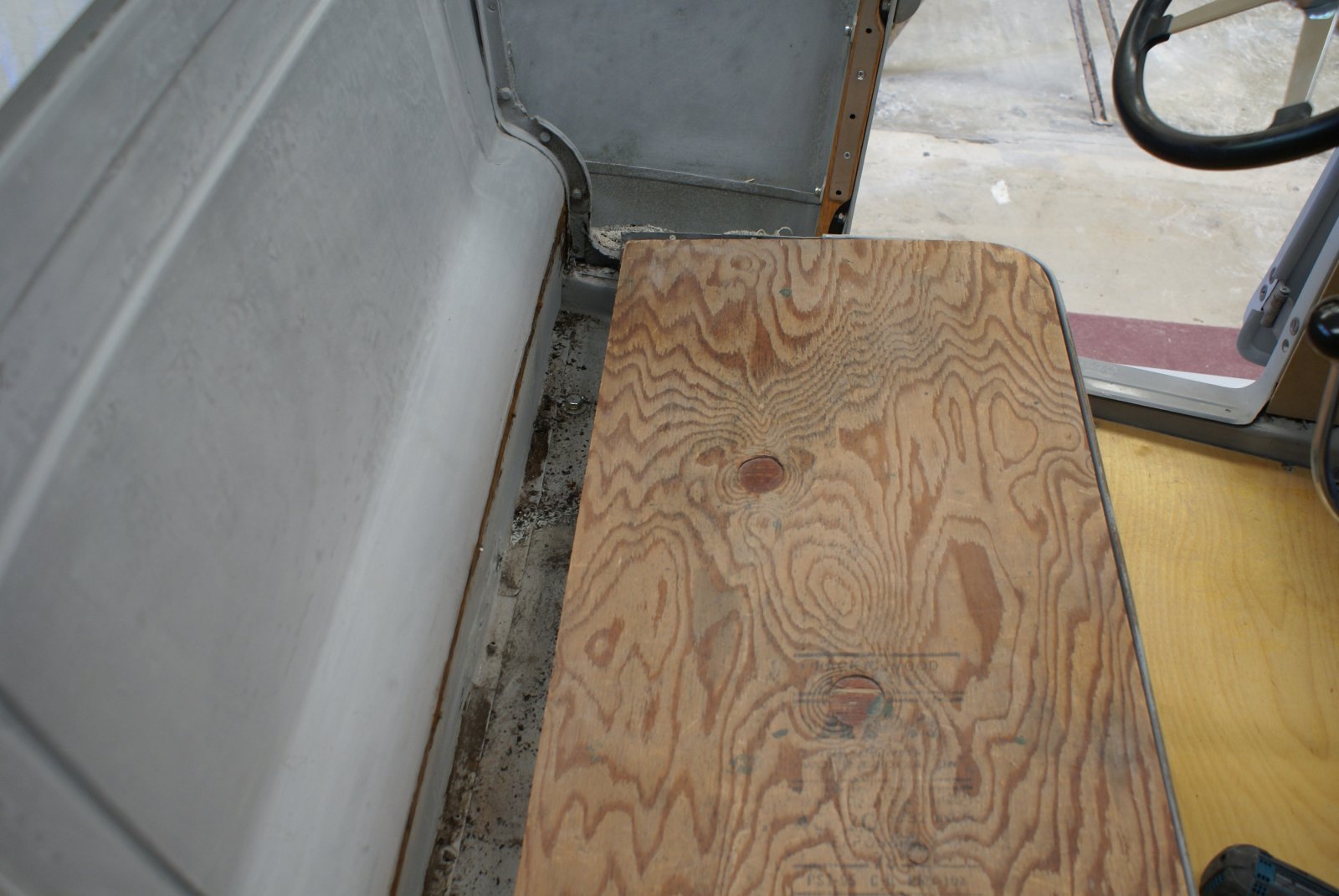

    If you need to lower your seat a little more (or just thicker padding) you could do something like this. DSC02597.JPG

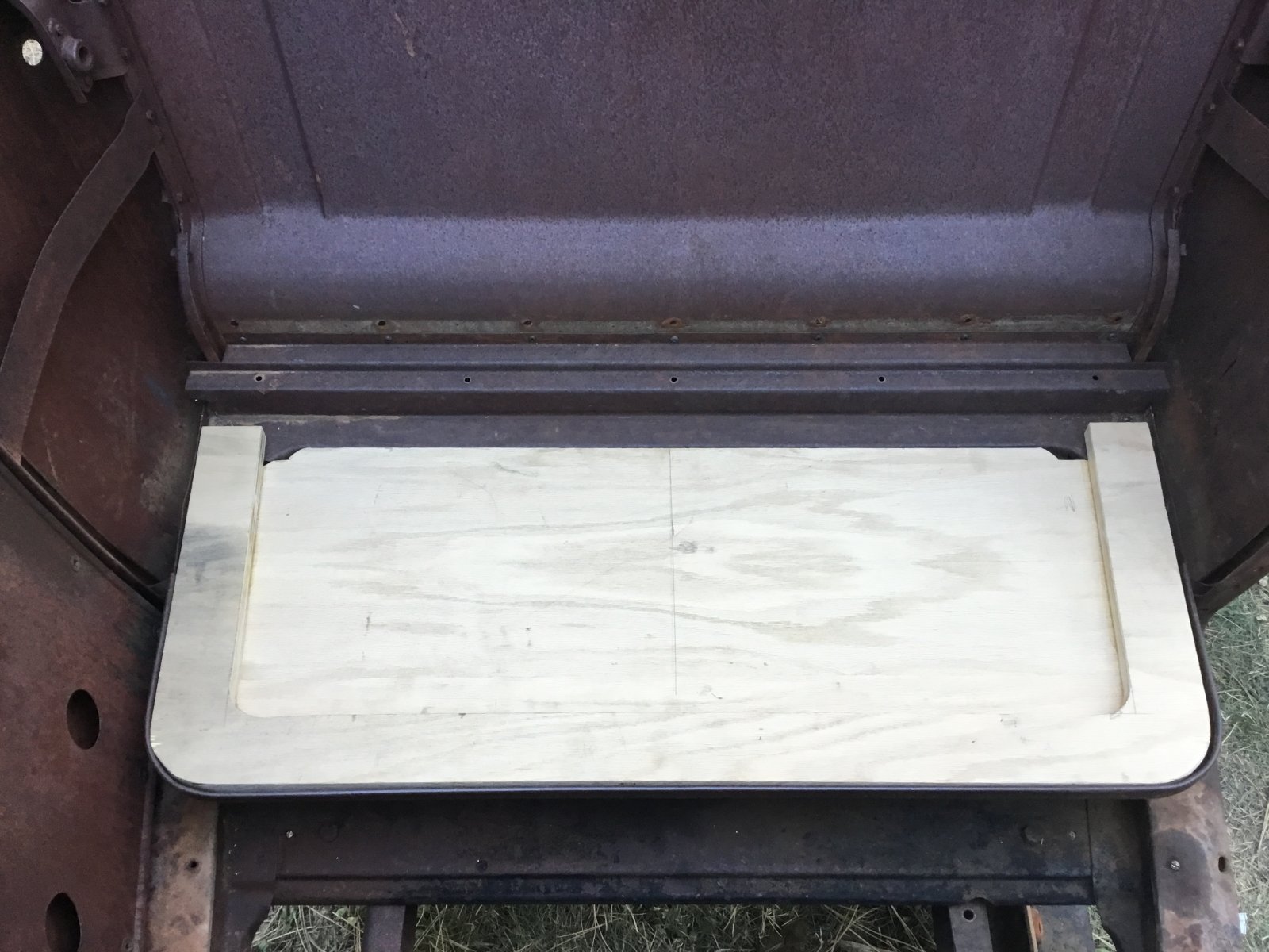

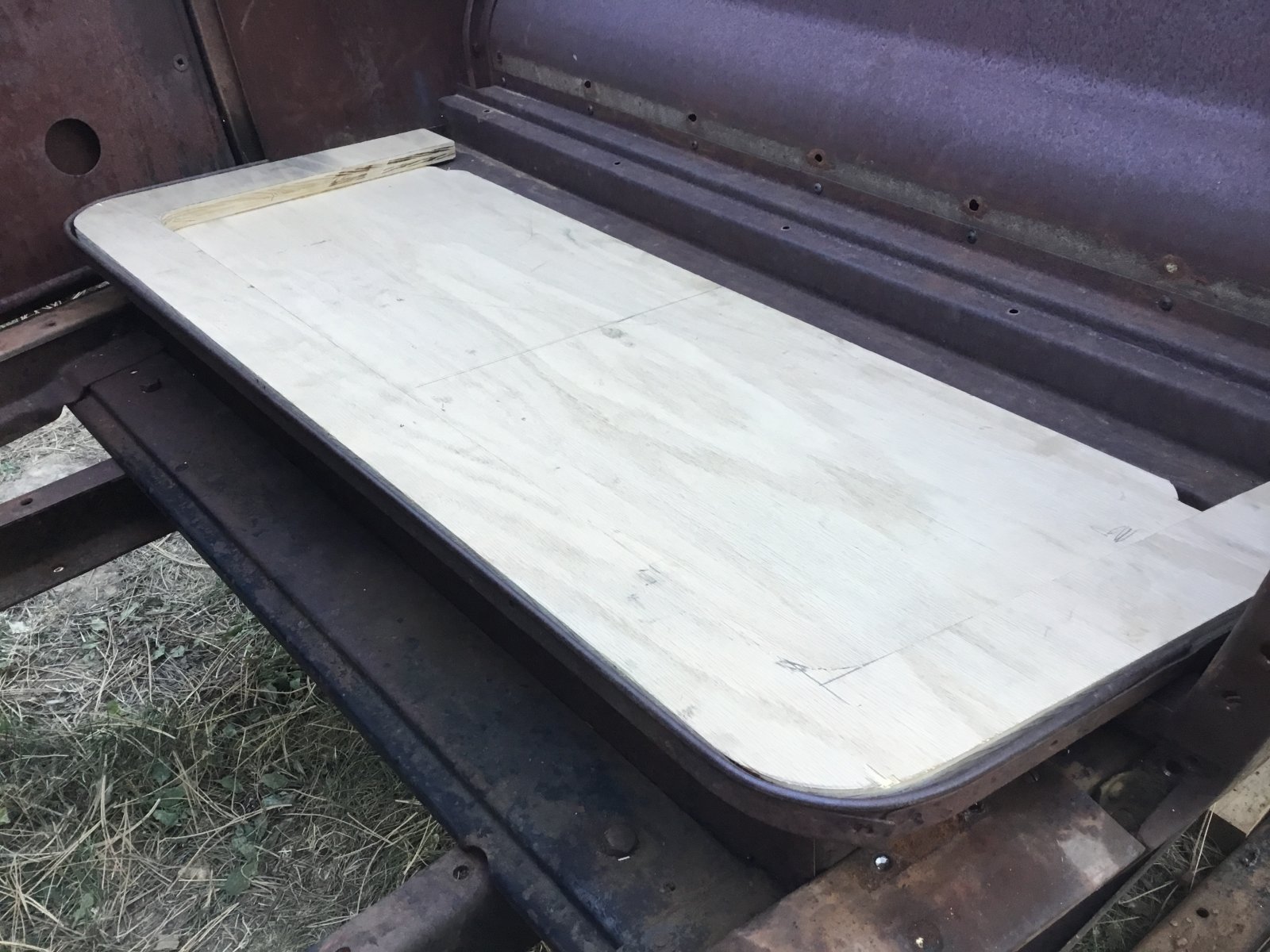

    Getting the cart ahead of the horse but what the heck, I ruffed out a seat base so I can sit in the car and make engine noises. 3F040283-02C5-4490-A0A6-B59BA6FCF88B.jpeg FAD4D20D-1BF1-4410-AE29-565976851C33.jpeg

    That's actually one of the first things I think should be done when starting a build! Ergonomics and inspiration are critical!

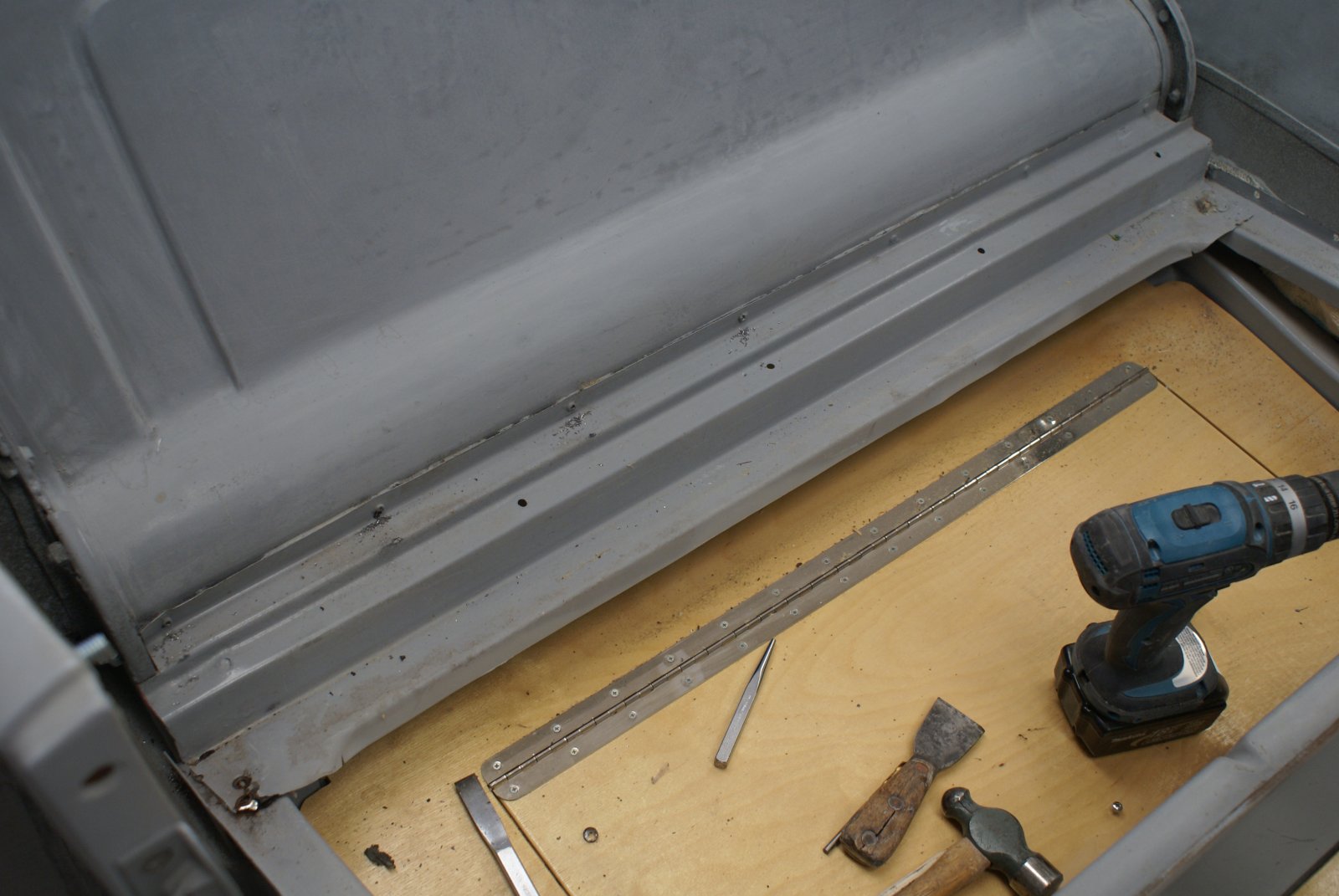

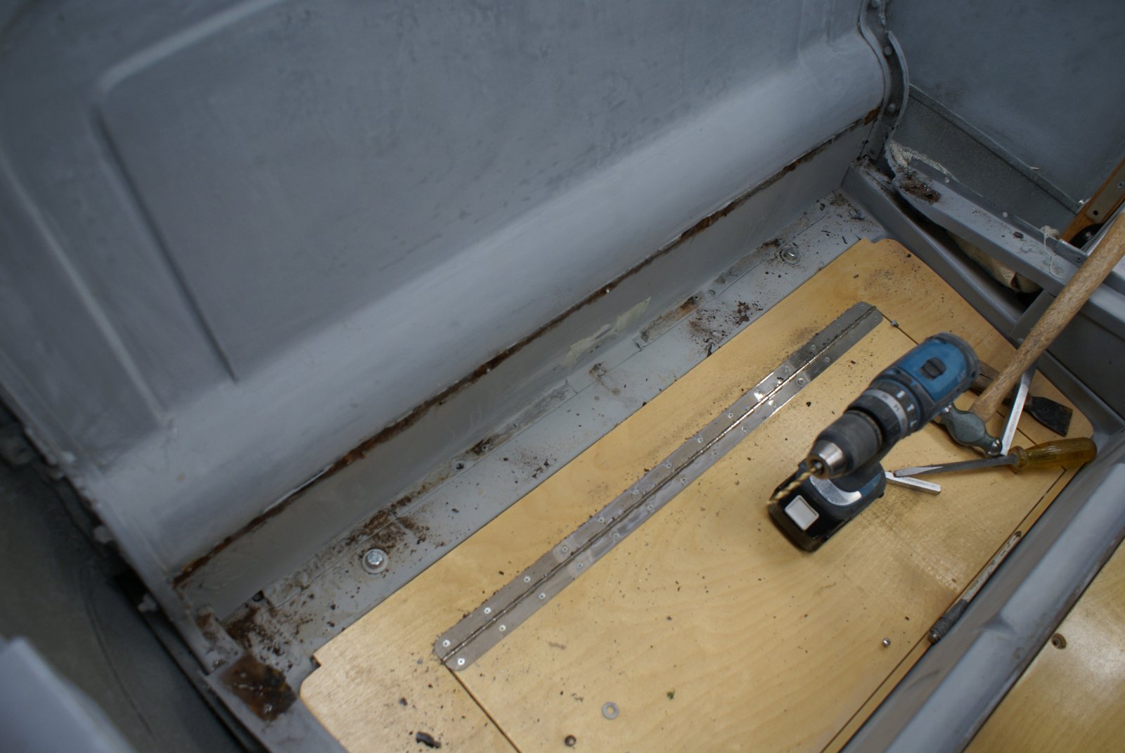

  27. Blake 27
    Posts: 1,553
    Blake 27
    You can easily gain a little more leg room by removing the panel behind the seat base...Varoom-Varoom DSC00585.JPG DSC00587.JPG DSC00588.JPG

    Thanks Blake, I mocked it up with the panel but I could easily remove it and add wood to the back of the seat frame. I’m only 5’10” on a good day and pops is 5’6” so it might stay.
    T’s are definitely made for short folks.
