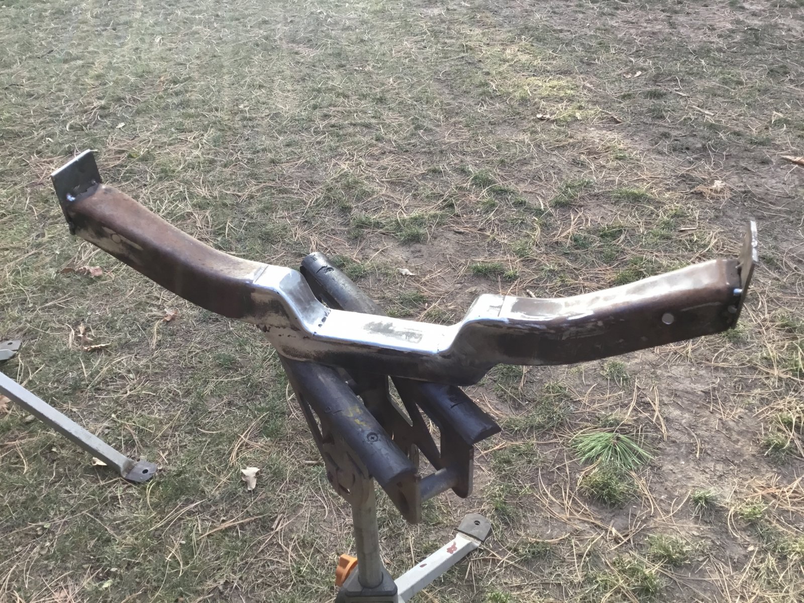

    Started building a front crossmember today. 7BD757D1-A9D2-4958-8E36-2C5D42CCCEB4.jpeg 41AF3E8B-C743-4930-BD1E-4845066C6132.jpeg

    Built and tacked together. It’s 1-1/2” higher than a stock T crossmember. Running a T radiator and shell sort of throws a curve at ya when it comes to crossmember height. DBCD8632-82FF-4553-8DFF-FA719227C471.jpeg

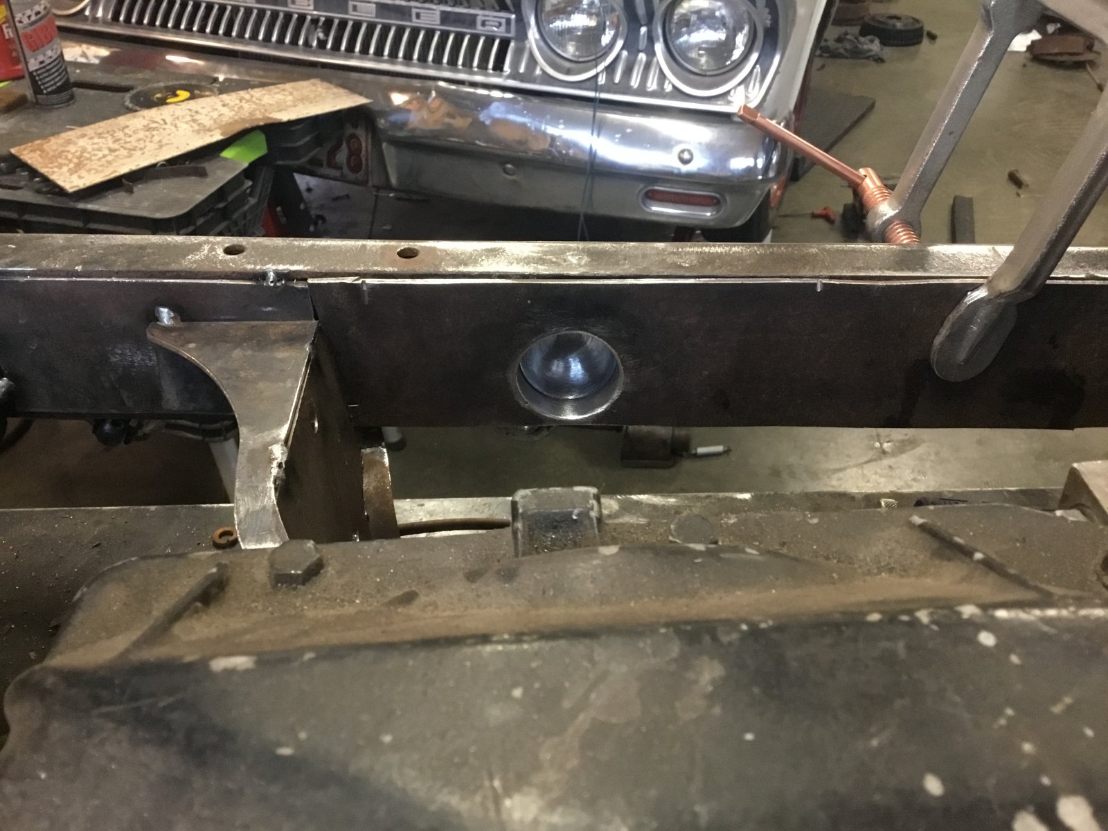

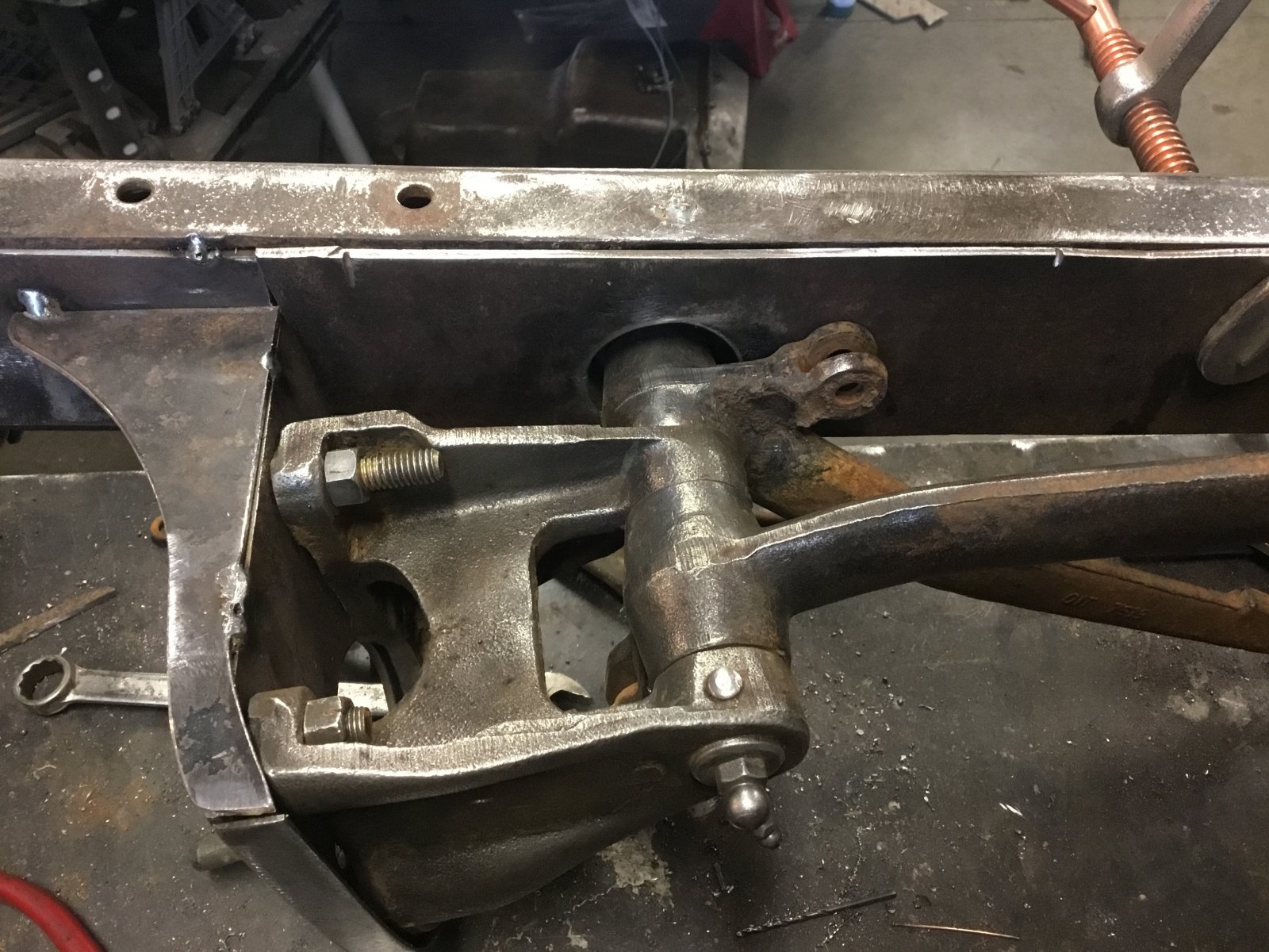

    Front suspension is rigged in so I could get my front wishbone mounts tacked on. 15A2D434-257B-445F-AB28-315F3BF54903.jpeg 7CFDE780-B9DC-456C-8D88-4F9A4F9F555B.jpeg 5C21EA25-EF7B-4461-AFEA-3982323A195C.jpeg

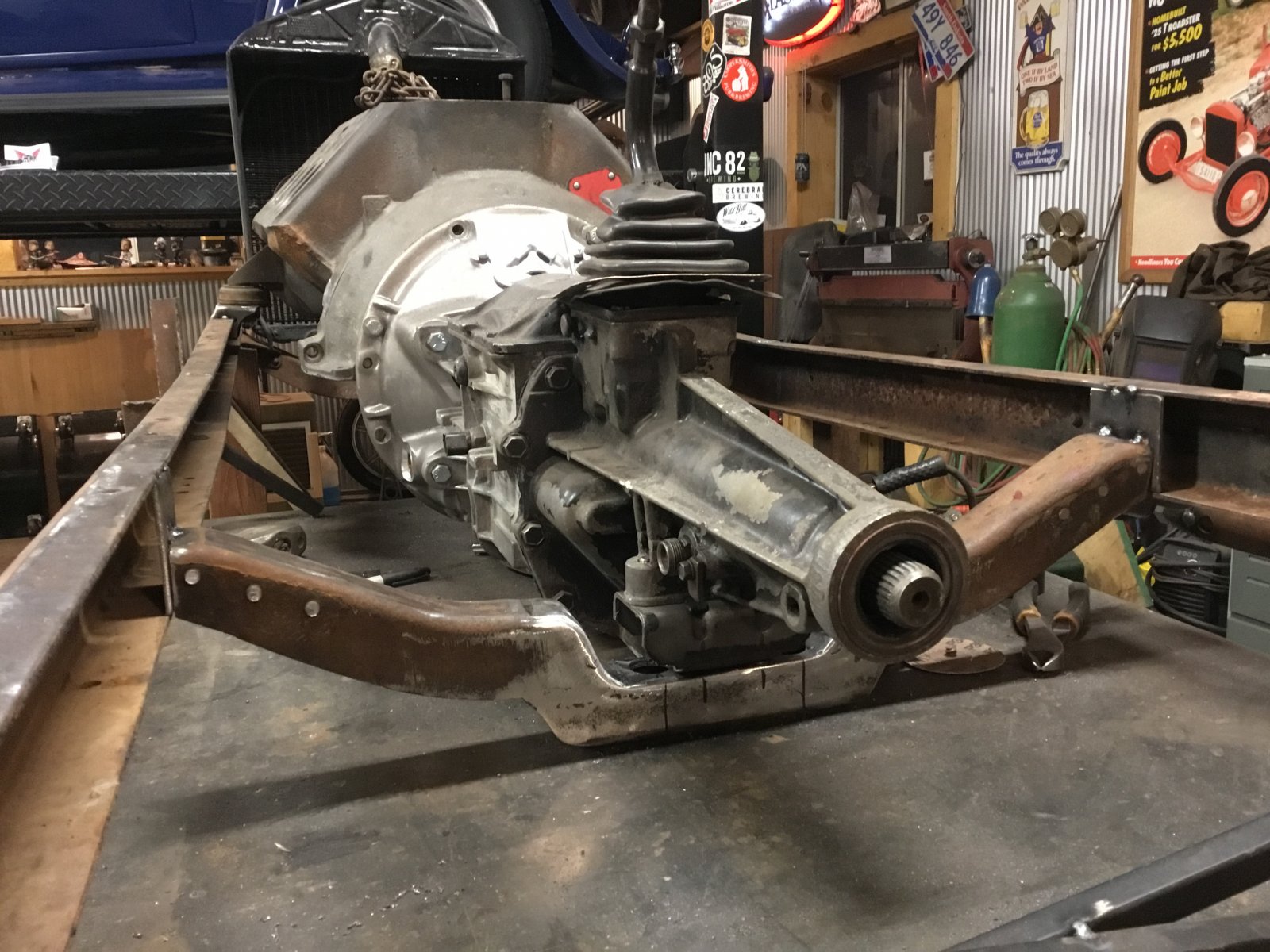

    Started mocking up the pedal ***embly, pops has a 46 ford dump truck that we took the ***embly from and the link to the transmission is from a 41 car. We will have to do some heating and bending on the arms but I think it should work. B378AD2D-8AD4-493C-B83B-F5C401A59AD6.jpeg 6694EA8F-04C5-4E62-9EE7-8A17AA504D73.jpeg E8F13137-08F0-4CD6-B673-E3BFBAD29A22.jpeg

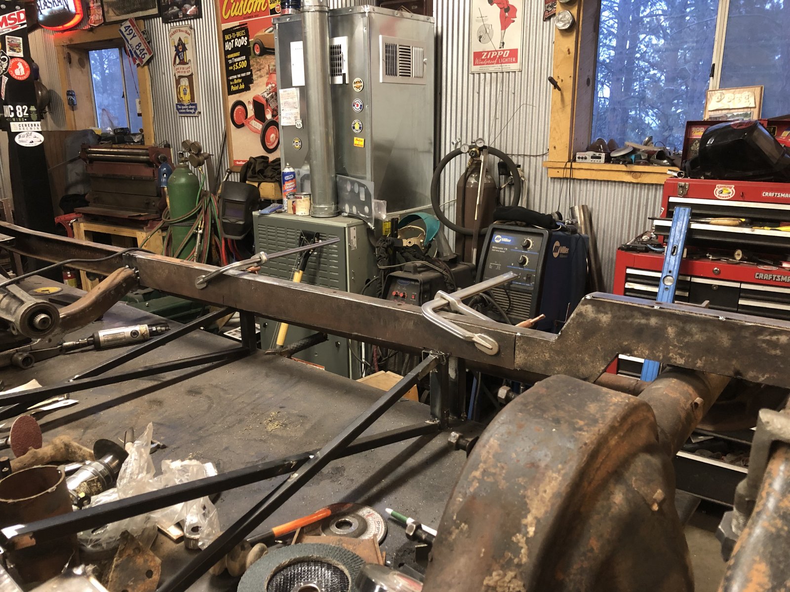

    Been making boxing plates but I don’t know if I’m getting the cart ahead of the horse. I probably should get some holes drilled for the body mount bolts before plates get tacked on. I’ve never used nutzerts would they work for bolting the body down? 4CAC7C56-9C06-4267-AB60-C9DB9934D78E.jpeg
  15. Hey buddy I would not use them if they let go and start to spin your screwed , I use the nuts that have the like washer built into them, tightening up the nuts and bolts and then weld the nuts in place,then take the bolts out set the body on and tighten them up. I use 23 wire to weld them in place since the washer part is thin so the smaller wire doesn't build up so much. Make sure you have clean metal to get the penetration. In fact I am doing the Willys frame right now. I got my nuts at Owen's but Fasaneal should be able to get bigger ones, depending on what you want to use. The Willys has 24 bolts that holed the floor and 4 half inch that hold the body and floor to the frame. Later buddy car is coming along great.
  16. tombstone
    Joined: Jan 15, 2006
    Posts: 550
    tombstone
    from sk.canada
    I’ve used nutserts in the past and never had much luck . I found welding small plates on the inside along the top edge Of the frame at specific points where your mounting holes will go , drilling and tapping works way better than nutserts. I use 1/4 or 3/8 plate , and tap for 3/8 fine thread .Then install boxing plate. Also my last frame I used the step box style which I really like when it comes to mounting lines, wiring .
    chryslerfan55, loudbang and Stogy like this.
  17. rusty rocket
    Joined: Oct 30, 2011
    Posts: 5,262
    rusty rocket
    I was going to step box it but I got lazy and just started boxing it the standard way. I’ll have to get pops up to help me set the body back on the frame so I can mark holes.
  18. rusty rocket
    Posts: 5,262
    rusty rocket
    Thanks Tony
  19. Stogy
    Joined: Feb 10, 2007
    Posts: 27,207
    Stogy
    Some drill right thru top and bottom insert a steel tube and weld it in and run long bolts...options so many options but nutserts not for such a critical load (even though they are like a rivet in a way)...these types of jobs are do it once do it right but picking options makes the head spin sometimes and our actions many times define and negate options available...
  20. MMM1693
    Joined: Feb 8, 2009
    Posts: 1,549
    MMM1693
    I agree with 38 2DR Sedan. I've never had much luck with nutserts either. I used the same method as 38 on my coupe and has worked out real well.
    Stogy, 38 2 DR Sedan and loudbang like this.
  21. Thanks back at you, hope things work out on mounting the body.
    chryslerfan55, Stogy and loudbang like this.
  22. For peace of mind I would just weld in some threaded bungs.
  23. rusty rocket
    Posts: 5,262
    rusty rocket
    Picked up a steering wheel yesterday from some friends of mine. It’s going to be a tight fit in the ****pit. 4A1D01FD-CF3D-4289-AB1D-FDDC2DC3FE2A.jpeg
  24. rusty rocket
    Posts: 5,262
    rusty rocket
    So I asked about nutserts a few posts ago and the consequences was don’t use them, this afternoon I cut pieces of 3/8” stock and welded it in for my body mount bolts. I will get the body back on mark, drill and tap into the 3/8s stock. F587002D-EFB2-43D6-9267-9D097BDAEC93.jpeg

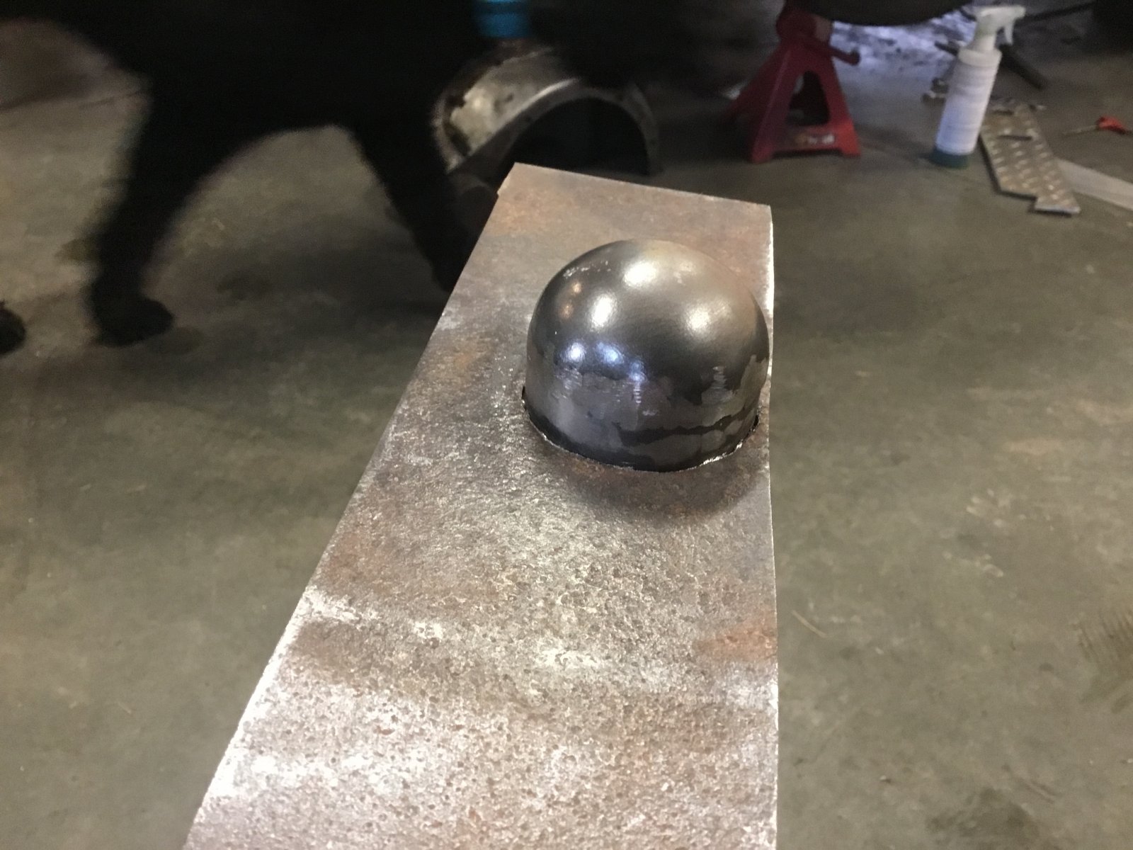

  29. rusty rocket
    Posts: 5,262
    rusty rocket

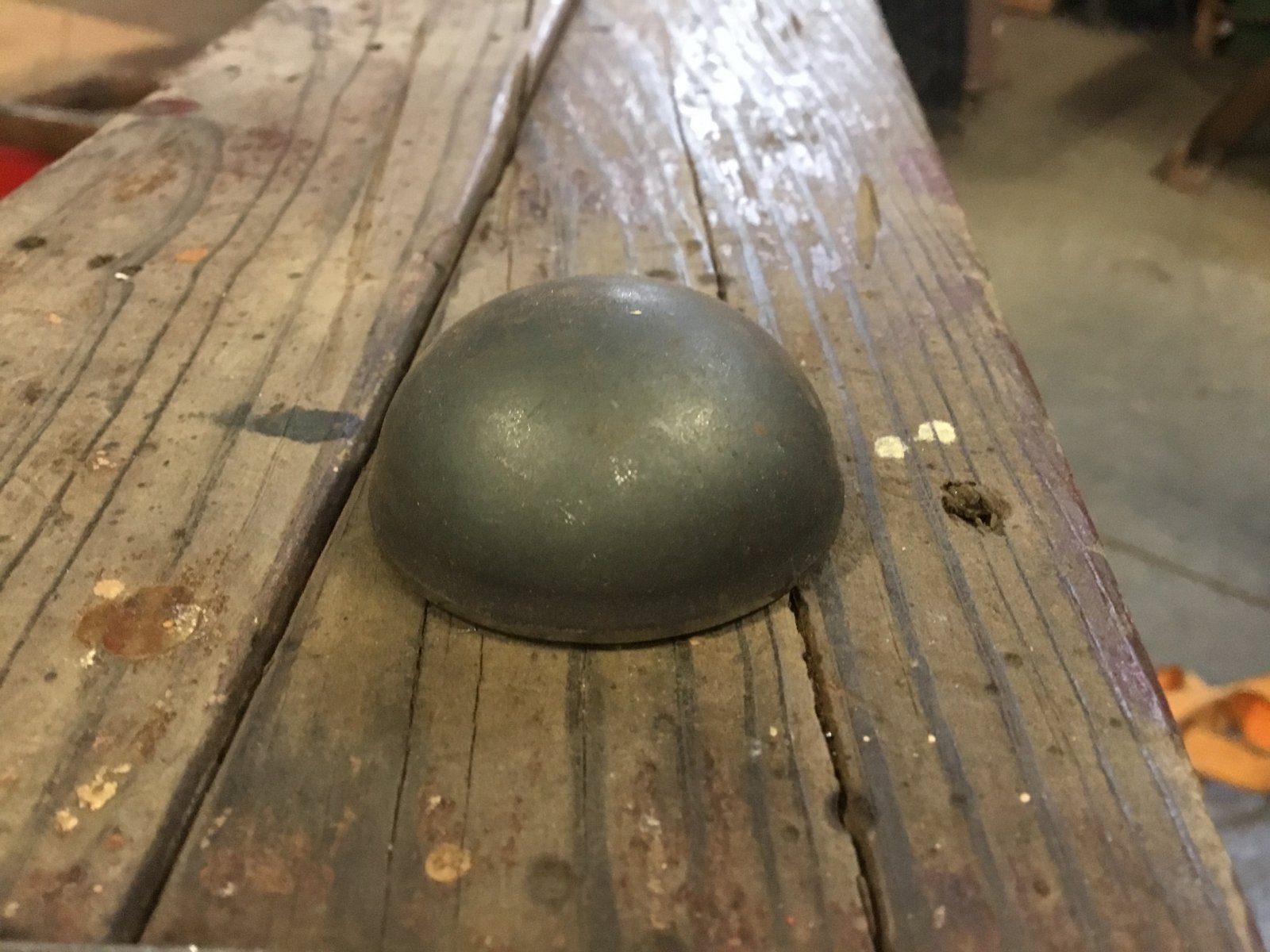

    Had to build a little well in the drivers side boxing plate for the pedal ***embly. I went to a local ranch store and bought a few sizes of bare steel domed caps that gets welded to the top of fence posts. I turned it around backwards and added a narrow ring to give it enough depth for the pedal shaft. 2CDF8E3C-0BF3-4020-860A-2184BE61242D.jpeg 1E386F59-7D49-4E4F-90FB-39C6A0EE94E4.jpeg 31167ED0-47E5-4C27-B814-CC7156AF9F4F.jpeg 58AF6C53-F55E-4EA0-9A04-78B12C1E475E.jpeg
  30. loudbang
    Posts: 40,346
    WHOA that is some original good thinking. :)
    deadbeat, Stogy, High test 63 and 2 others like this.
