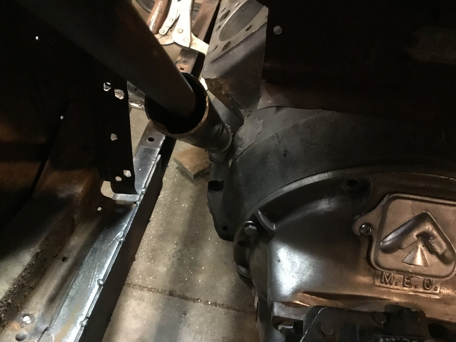

    Have our box location figured out, it’s a tight fit. 64BB5B5C-737A-4F1A-B082-10AED0A58A49.jpeg 7E1E60E2-017B-429C-8342-C09BA60EA8E7.jpeg BA2782D4-FA79-470C-B20B-E55C4FB98050.jpeg

    from So Cal
    Looks like you'll just have room for the center exhaust outlet.

    Center will not be a problem but he rear Will be dang close. We will build a kick *** set of headers so I’ll make them fit.

    To gain more room have you considered mounting the box on top of the rail ?

    Runs right into the side of the block.

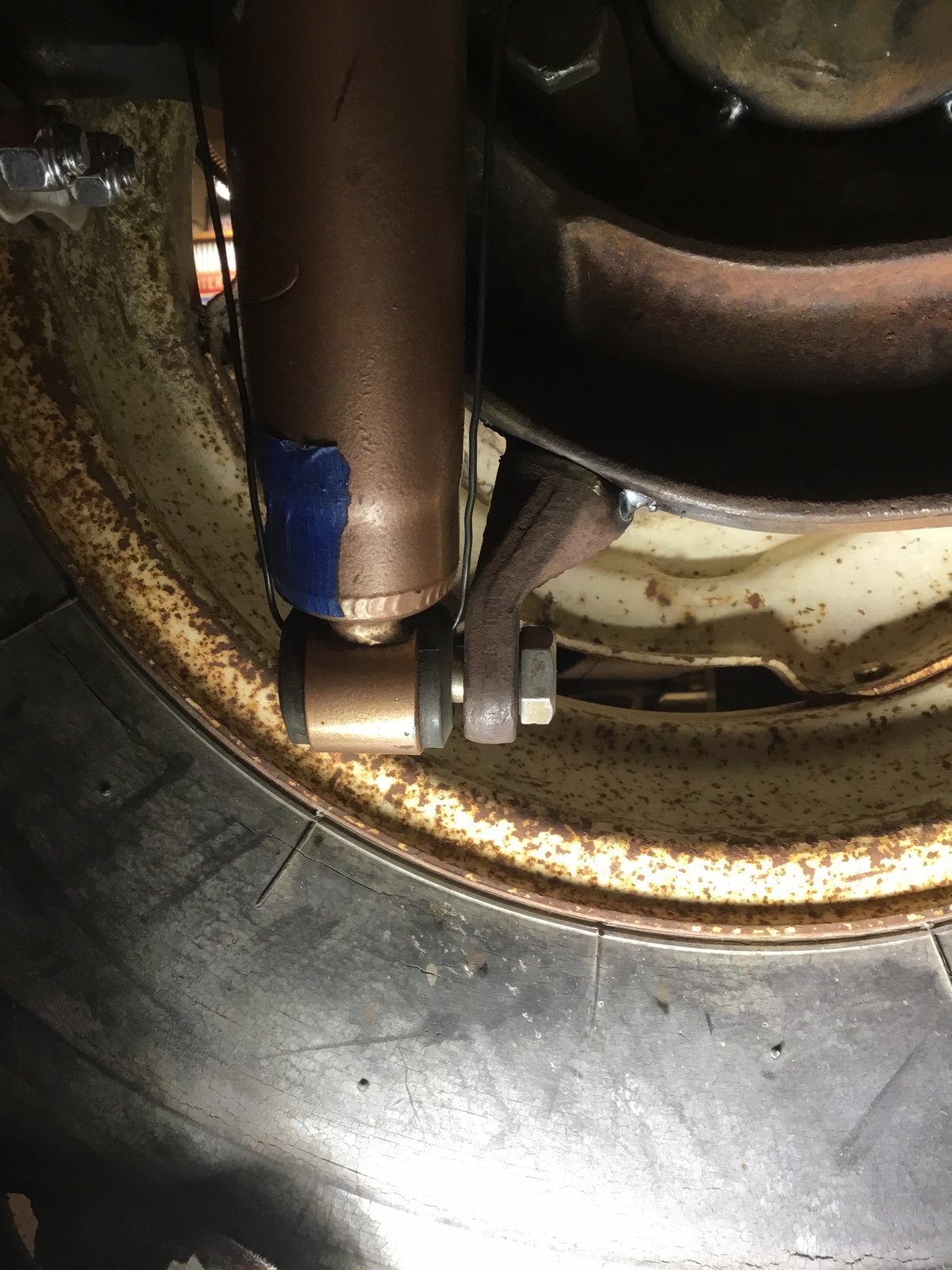

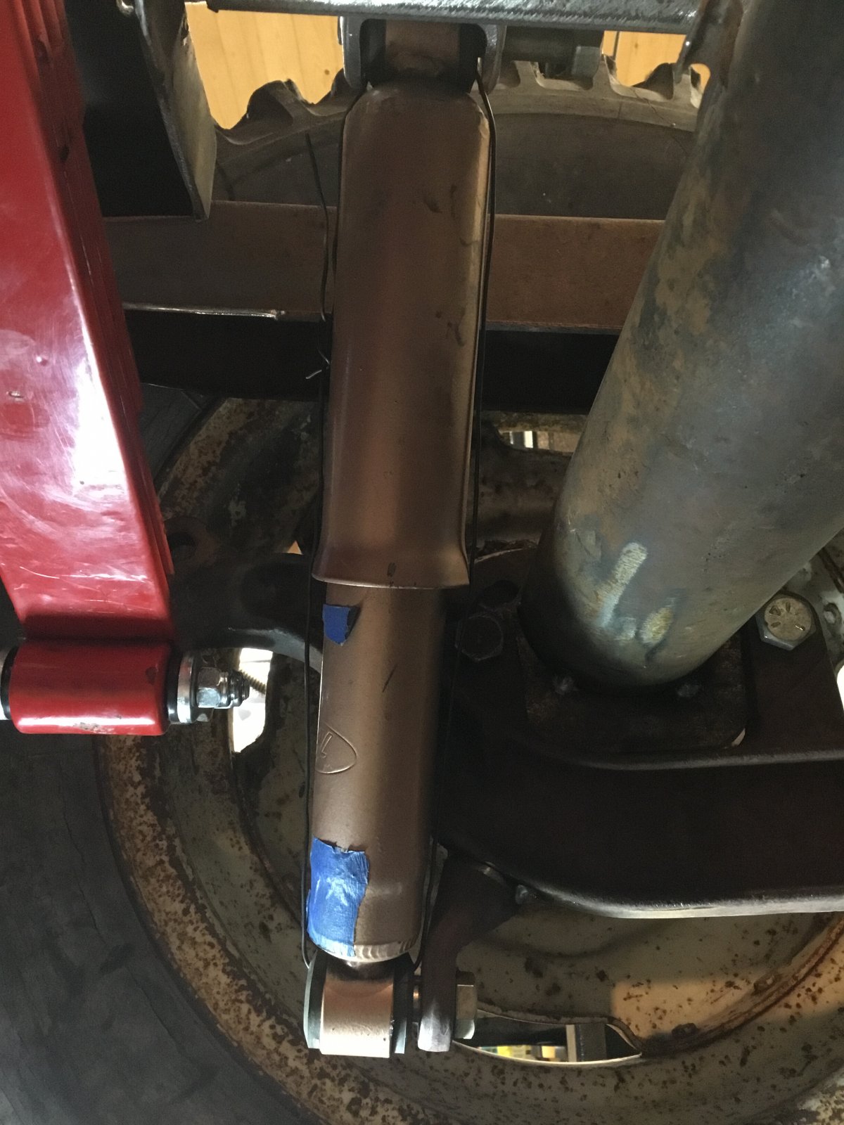

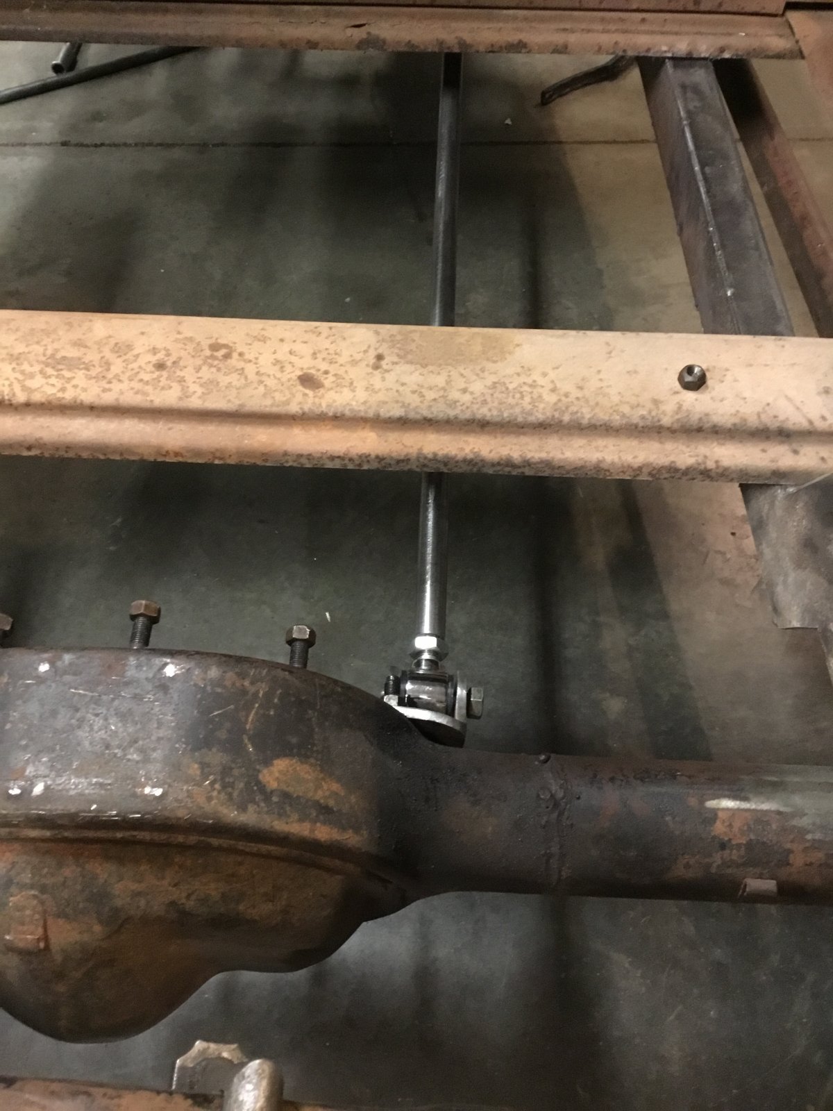

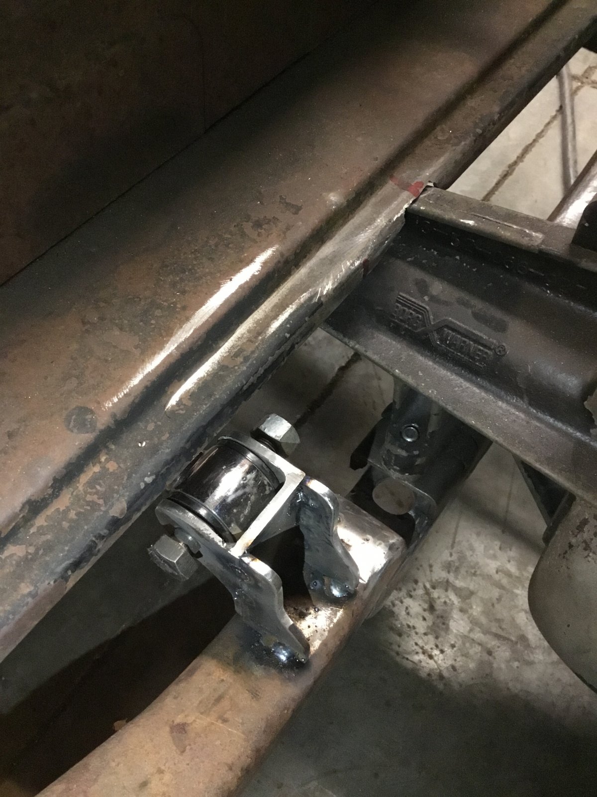

    Have our front shock/headlight mounts done on the front. F66C0D8B-5AB6-4668-9D4B-B4569AF9BF05.jpeg E840EFFC-EBF0-45BF-BAD2-B11957BC2651.jpeg DF72A656-F8F3-4501-9F3C-E39690DF32F2.jpeg Started working on the rear mounts. I had a chunk of heavy wall square tube that I cut for the top mount. D4C19B09-E868-45B4-9C5C-4DBCE5F7A8BA.jpeg The bottom mount will be the castoff part of the rear 35/6 bone. 99B0681D-907E-409A-A60F-F8B1D289AFC2.jpeg 6EFE61BD-D296-4891-A32B-9E2F48AB4993.jpeg

    Did this start out as an F-1 shock mount and part of a headlight bar?
  11. rusty rocket
    Joined: Oct 30, 2011
    Posts: 5,262
    rusty rocket
    It
    It sure is, shortened the f100 mount reclocked it to fit the frame and then used the ends of a model A headlight bar
  12. atch
    Joined: Sep 3, 2002
    Posts: 6,420
    atch
    Well done my friend...

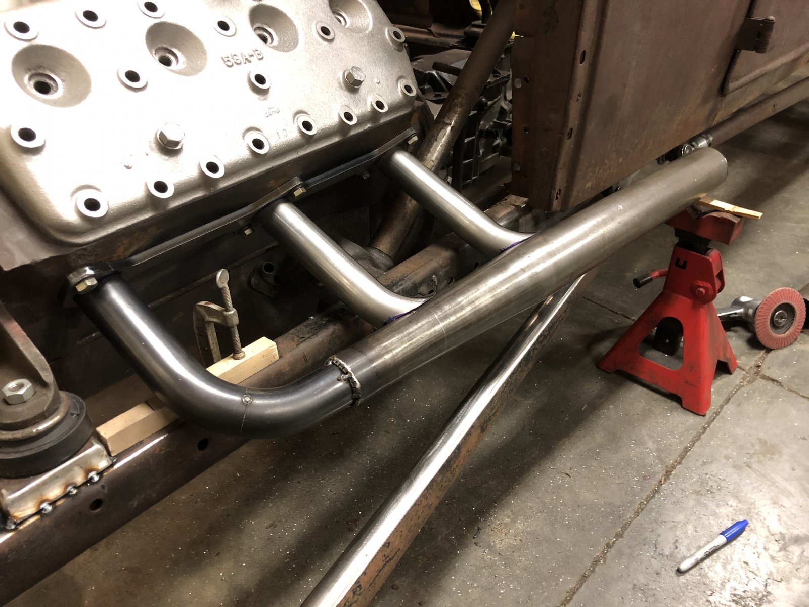

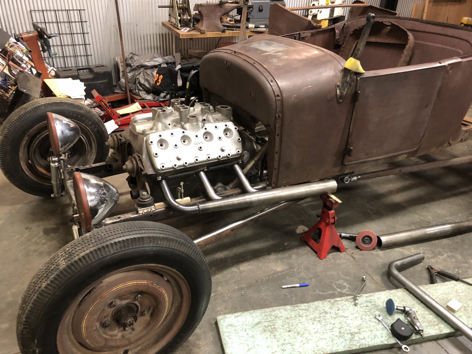

    I found a 35/6 inner drive shaft here on the hamb to build a set of lakes headers. Been brutally cold here but I did find a bit of time to warm up the shop and get the drivers side built and tacked together. E3D72ABC-9393-4E15-ACC6-40D476484098.jpeg E88D4969-67DE-4D2B-B6D6-F729D372D6AA.jpeg 79F04BFC-6FCB-4161-9BF7-8580E4BF61B3.jpeg

    Looks great!!. Wow. Nice job!! Inliner exhaust would be easier around the steering box. Just sayin

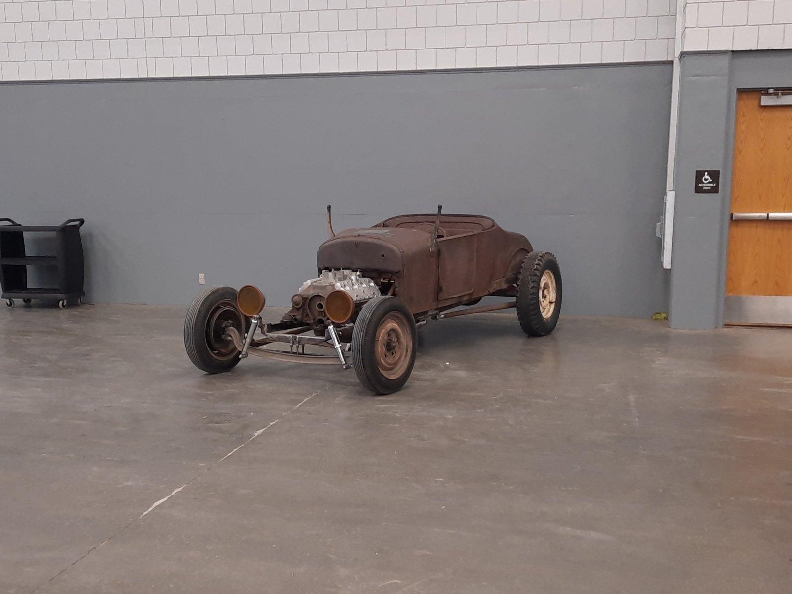

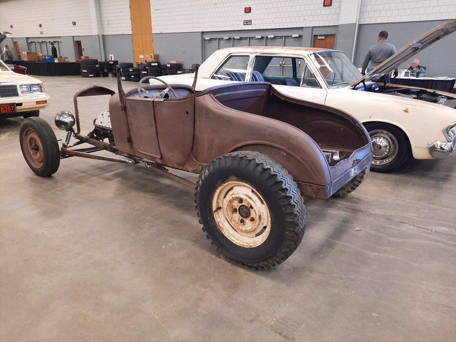

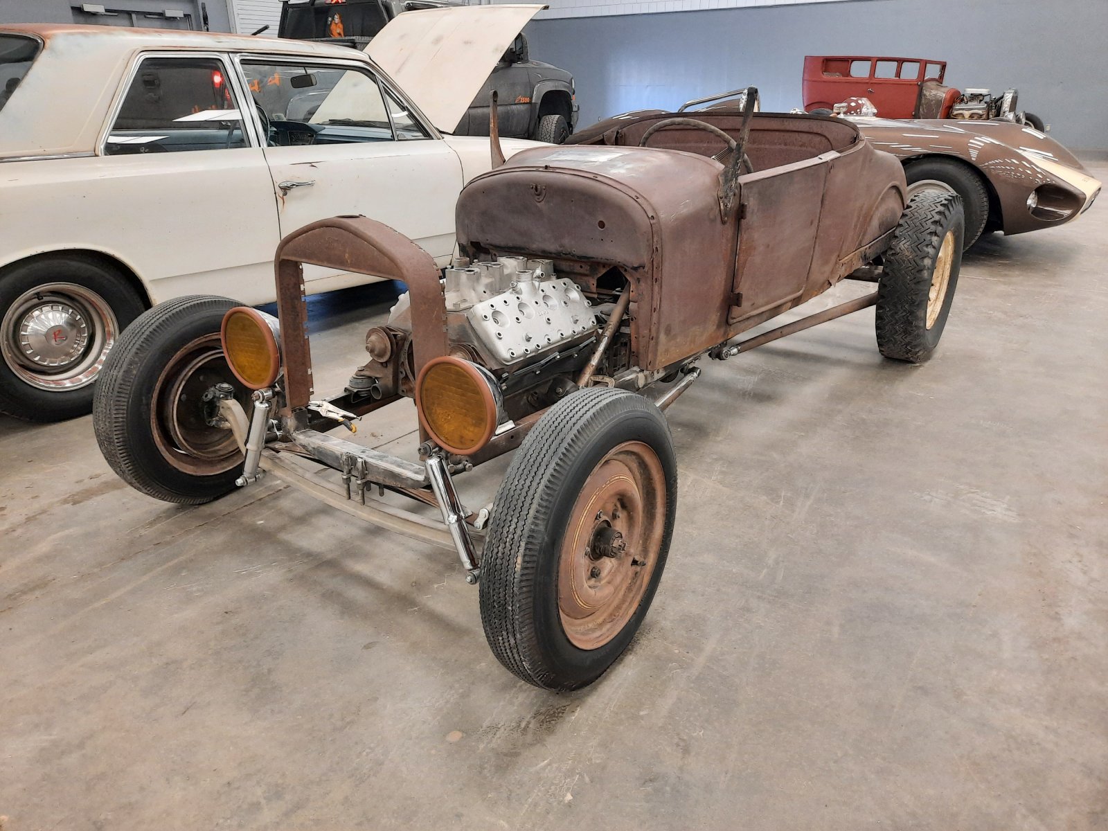

    Some pictures of the T at the 2022 counts car show; 20220217_143129.jpg 20220217_143152.jpg 20220217_143147.jpg 20220217_143139.jpg 20220220_161910.jpg

    Minus temperatures definitely **** but I have a decent furnace in the shop so if the doors stay shut it’s a very workable environment although the concrete is a bit cool.

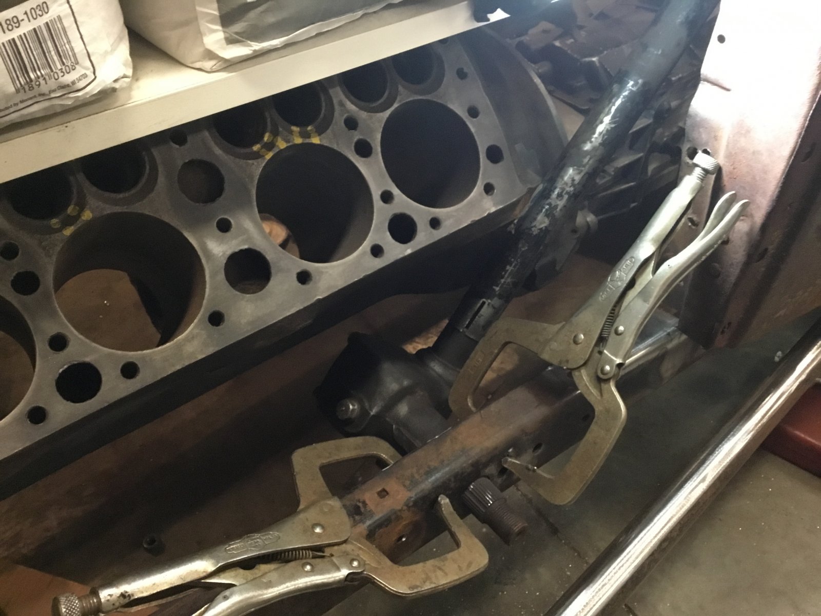

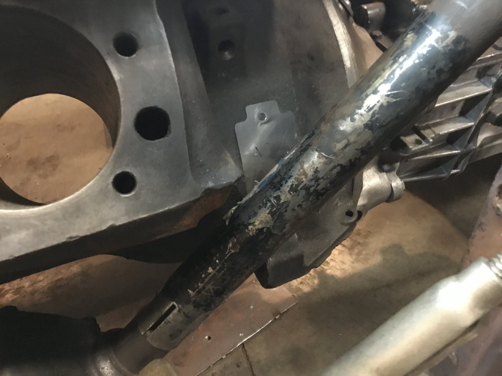

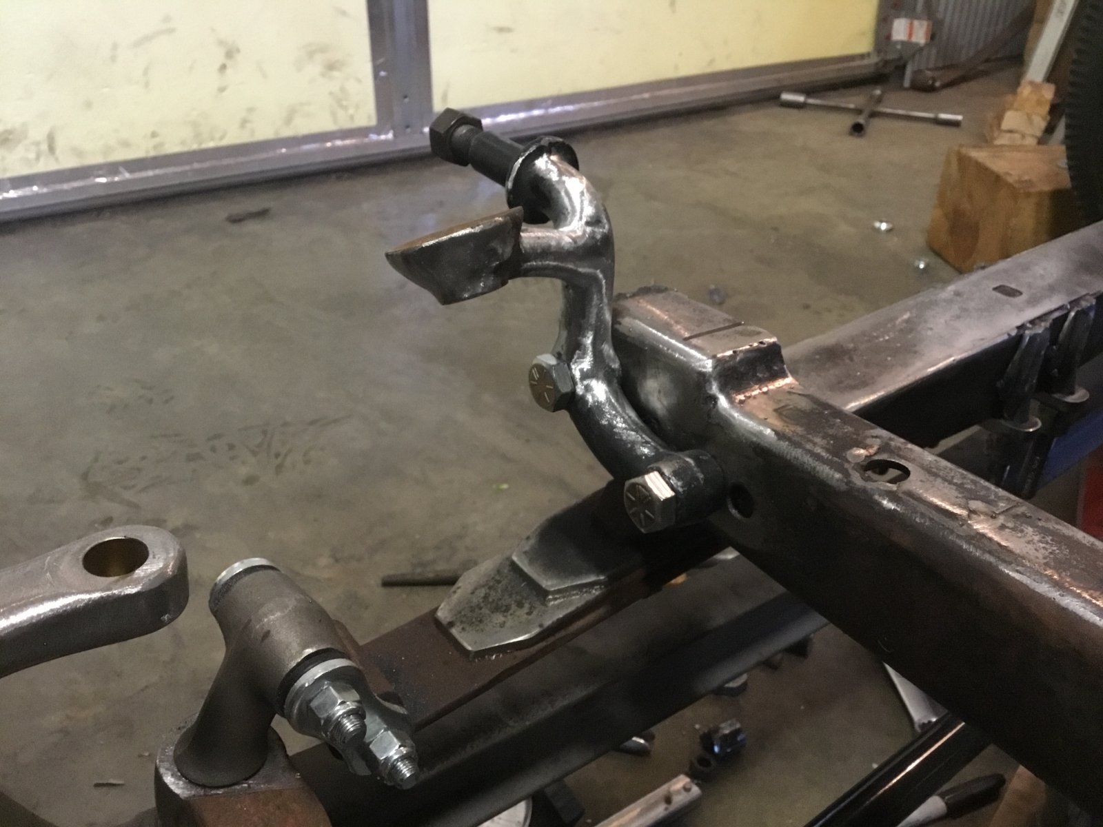

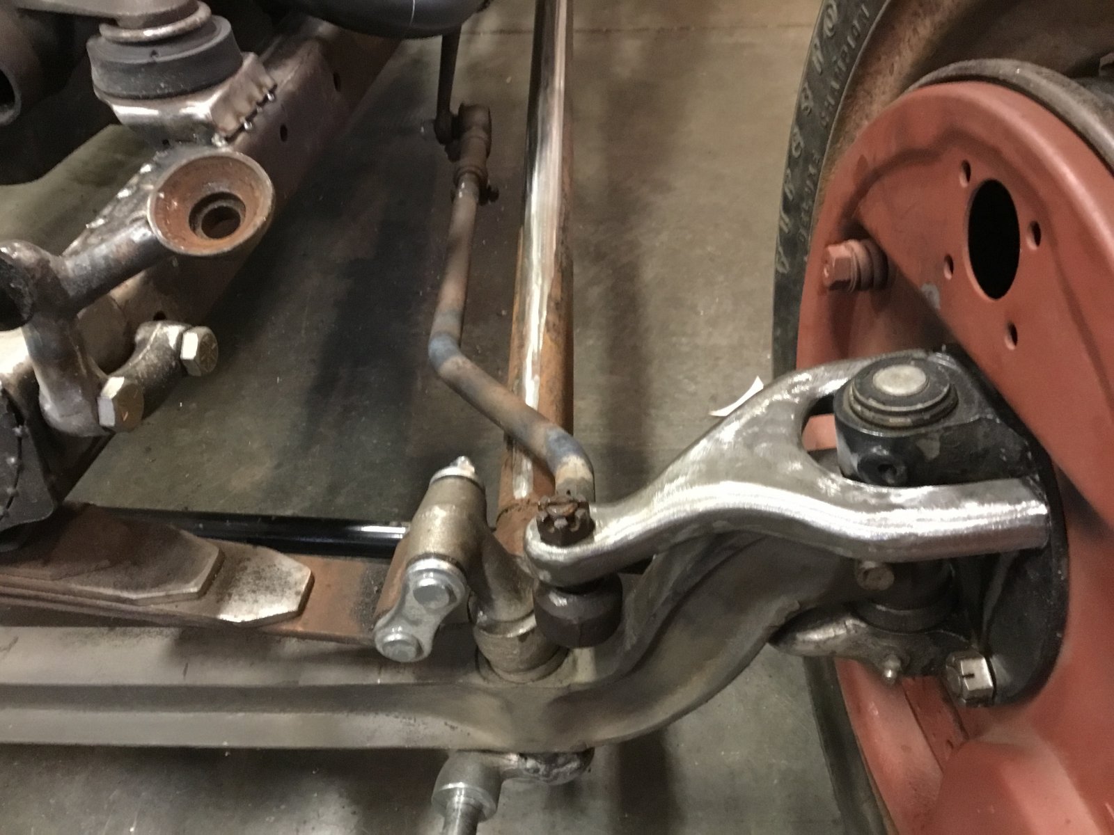

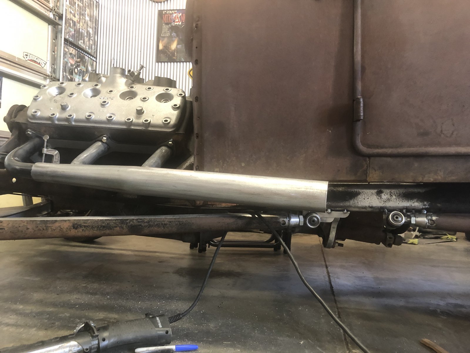

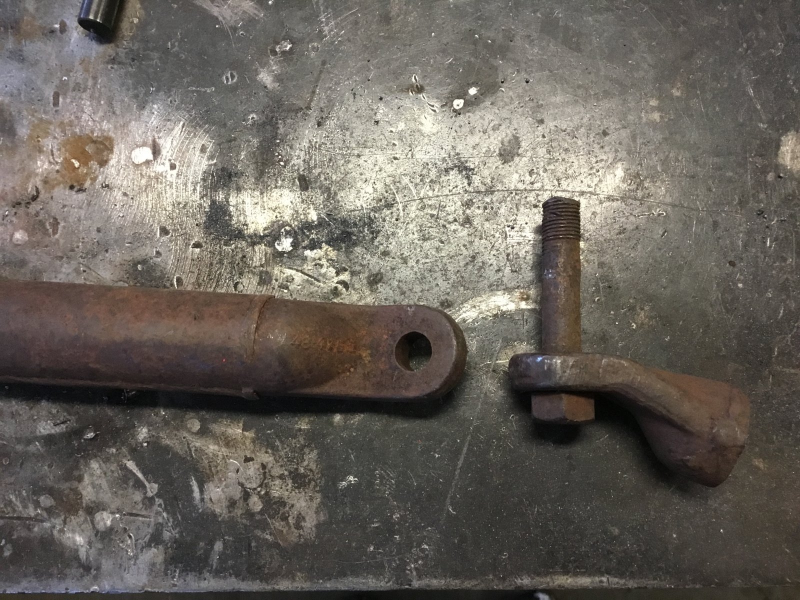

    Have both headers built and tacked together. I still need to add the dumps to route exhaust under the car. 0FFB9BBE-B901-40EF-84CE-39F7F5C4EB30.jpeg I’ve also got the steering box mounted to the frame. I had to bend the steering arm on the spindle down to get the draglink on a better plain. I also bent up an old 41 Ford drag link to work around the radius rod it will be replaced with a new one when we get a little further down the road. 99295ED9-B960-4BC6-B233-76D9B732288D.jpeg
