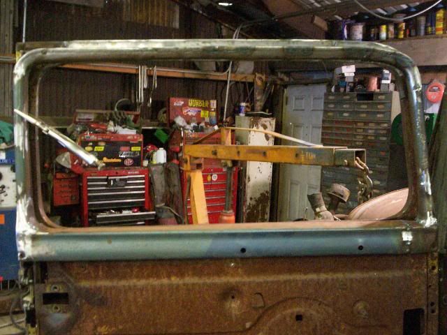

    I figured I would post an update of what Ive been up to just a bunch of random unfinished stuff.
    I was building the door garnish, I started with a 1953 4 door Imperial back door garnish, I dont know if they made a 2 door in that year but maybe. Then afther a bunch of cutting and welding I came up with this. It still needs some more work. I have to fill some holes, make filler pieces for the door to make it line up nice around the outside edge and some tabs to screw it to.

  12. The37Kid
    Joined: Apr 30, 2004
    Posts: 32,535
    The37Kid
    WOW! Lots of progress since the last time I checked in. I like all the subtile body changes. This is going to look great when it a roller.

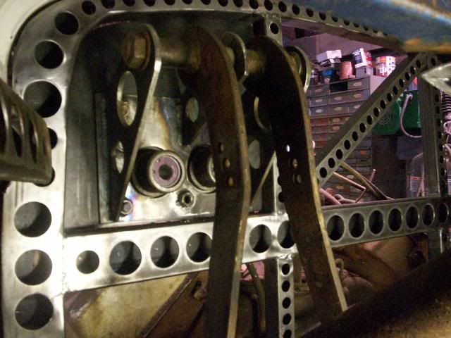

    I managed to get the firewall all finished and welded up. Lots of holes.
    I also made this column drop out of aluminum. I took the column and box from a '75 postal jeep. looks like everythings going to work great for cross steering. I wanted to use a F-1 or F-100 box but I just couldnt get it to fit with the starter on the drivers side.

    Its been awhile since Ive updated, sorta got busy with other things and wasnt working on the car but Ive still managed to get some stuff done.
    I got the swing pedals all rebuilt and mounted. I started with a old set of ansen swing pedals that were in rough shape. I had to rebuild the whole mount because it was cut for a different master cylinder and broken and brazed. But using it as a template and made my own.
    All welded together.
    Mounted in the car.
    I also got some of the floor laid out and tacked in. The plan is to used a colored lexan to make the front floor so you can still see all the holes. Then Im going to make an aluminum transmission hump.

    This build is awesome! I have a total FNG question, why all the holes? Besides looking sweet, does it serve a purpose such as weight reduction or anything? (Sorry if I missed the answer somewhere in the thread.)

    Thanks everybody, yea the holes are mostly for looks but I am saving all the knock outs from the holesaws to about how much weight I am actually saving. Its up to about 35 lbs so far. Its really hard to tell because all the small 1/2 holes are done with a regular drill bit so I lose all that weight, I dont save all the shavings. I should have weighed every piece before and after and it would I would know how much weight I really saved but its close to 35 lbs so far.
