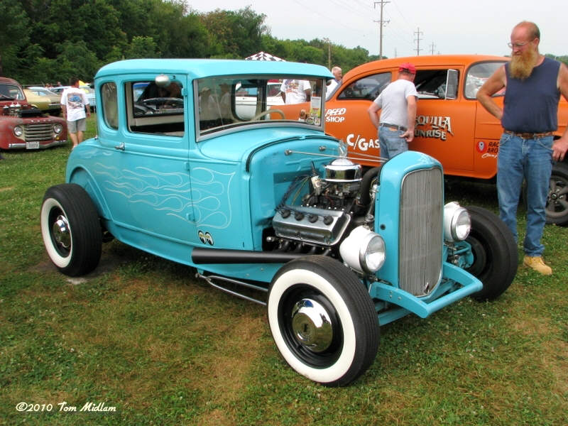

    here is mine....I don't know if it is any help, but ask me anything if you have a question....
