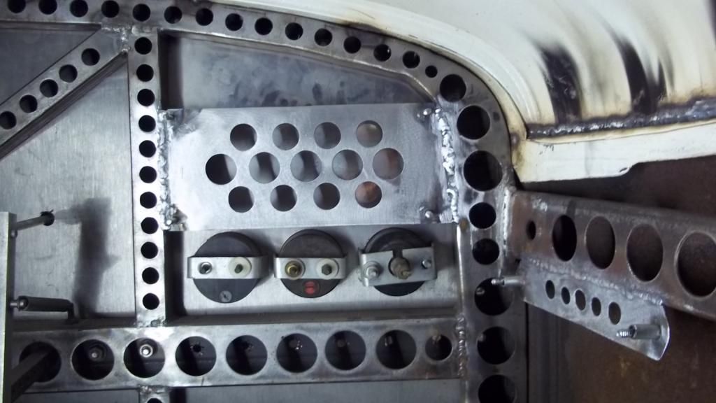

    I'll start by showing you how the metal piece that I sandblasted in the post above turned out in the car. I think it looks good for being out of a 48 ford truck. the piece above the window is from the same truck. its hard to see in the picture but it took alittle more work to get it to fit. I painted everything before I welded stuff in because I figured that was the only chance Id have to do so. I made the uprights and used some fake rivets to make it look neat.
    I also made some simple brackets to hold the MSD box and the tach box on the backside of the firewall. I tried to make them look decent with or without the boxes in place this way if I decide someday I dont want that stuff I wont have a ugly bracket to look at.
    I used some alum. fuel line to run the wires across the firewall. try to keep everything neat looking. Wiring seems to me one of the hardest things to do that with. and nothing looks worse than a birds nest of wires under a dash. I also am gonna run some wires across the back side of the dash to minimize the ones on the firewall.
    I got all the pieces and parts worked out and cut down for the grill shell finally. I think it came out pretty awesome for and old ford truck grill shell.
    I made a shroud out of some old alum. I aquired. Im real happy with the way it turned out. Should also really help the fan **** some air threw that mustang rad.

    I got my buick brakes back from the machine shop. I had him drill them for the small ford bolt pattern while he was at it because thats what my rear has. I think they came out great. Im using the buick backing plates. I just modded them to fit the ford spindle using some 1/8 plate.
    I finally was able to pick up a set of model A rear fenders at the swapmeet. ones I could afford anyways. They needed some work but thats what puts them in my price range plus I just wanted to cut them up anyways. I bobbed and opened up the wheelwell some then I used 3/16 brakeline to give it a bead around the edge.
