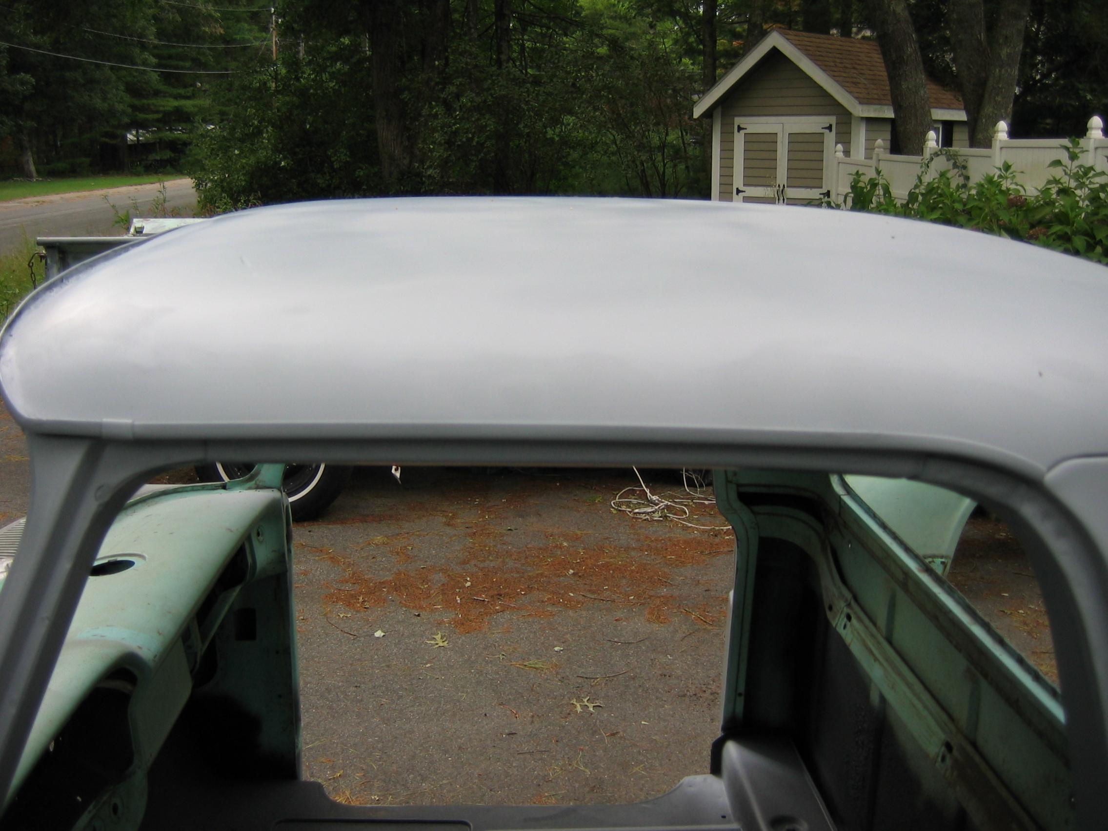

    Here's how,
    this is an abbreviated series of steps to to make a roof patch panel. I had to do three sides of my 62 F100. Make sure you are back to clean metal inside and out. Make sure you get some kind of rust coating under the patch, I used weld through primer on the back of the patch. And used Eastwood's Rust Encapsulator on the rusty inner structure after cleaning as best I could..
    Good luck...

    Really nice work
