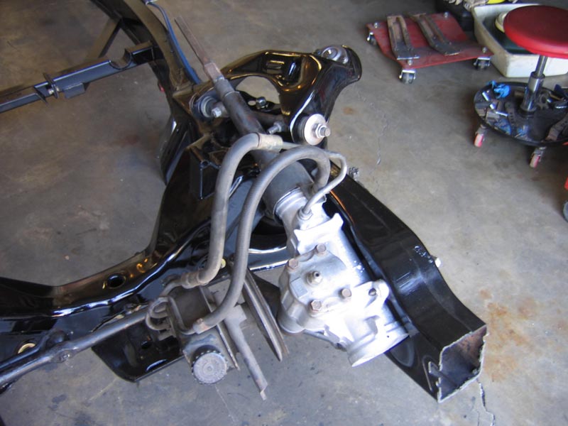

    I've been using the search feature on the H.A.M.B. and haven't really gotten the tech I'm looking for. I was wondering if any hambers have done one of these clips on a 54 chevy car or any early 50's chevy car or have any info/tech links on this subject. I'm gonna tackle this project myself and was looking for some tips and tricks other people have for this, or problems to avoid etc. , i appreciate your help, thanks:cool:

    and to avoid the "why don't you just use a mustang II?" question, I would if i could but the car i have already came with an early seventies chevy front clip,, and it looks really ****ty and slapped together. The S-10 clip i have was free and not junk, and there's plenty of airbag options for these trucks/clips,, thanks

    cool cool, so is narrow good? why the wheel spacers? cuz the wheels would be set too far in? hmm, and this clip the s-10 came off of was already running a v-8 so that part is done,, what kind of fab am i lookin towards? like,, where the ch***is meet? , thanks for the input

    check out www.chevytalk.com lots of info there on your car. lets see some pic's showing that front clip.
