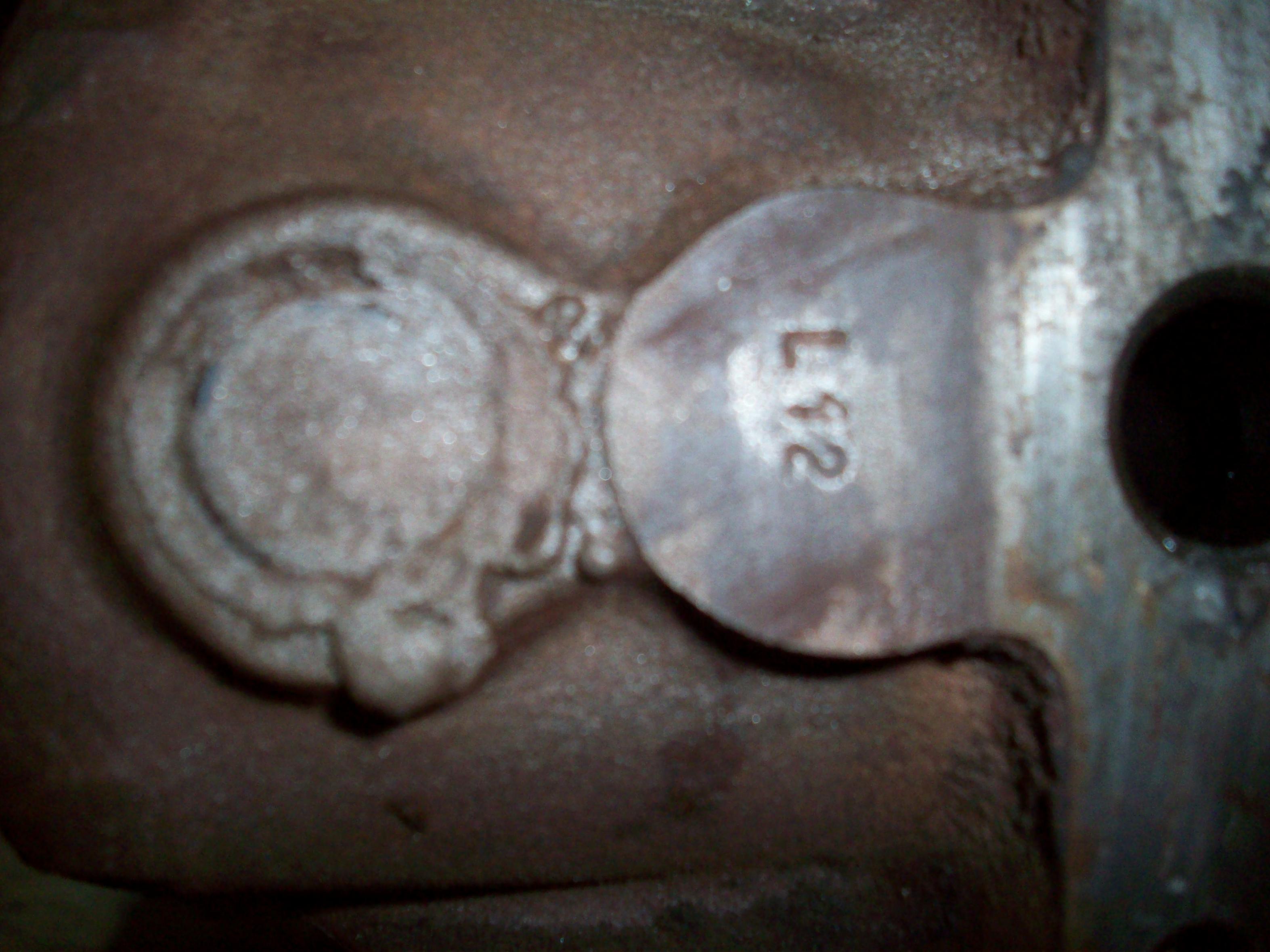

    Also just out side the rear cover on the gasket face (left) is stamped L12

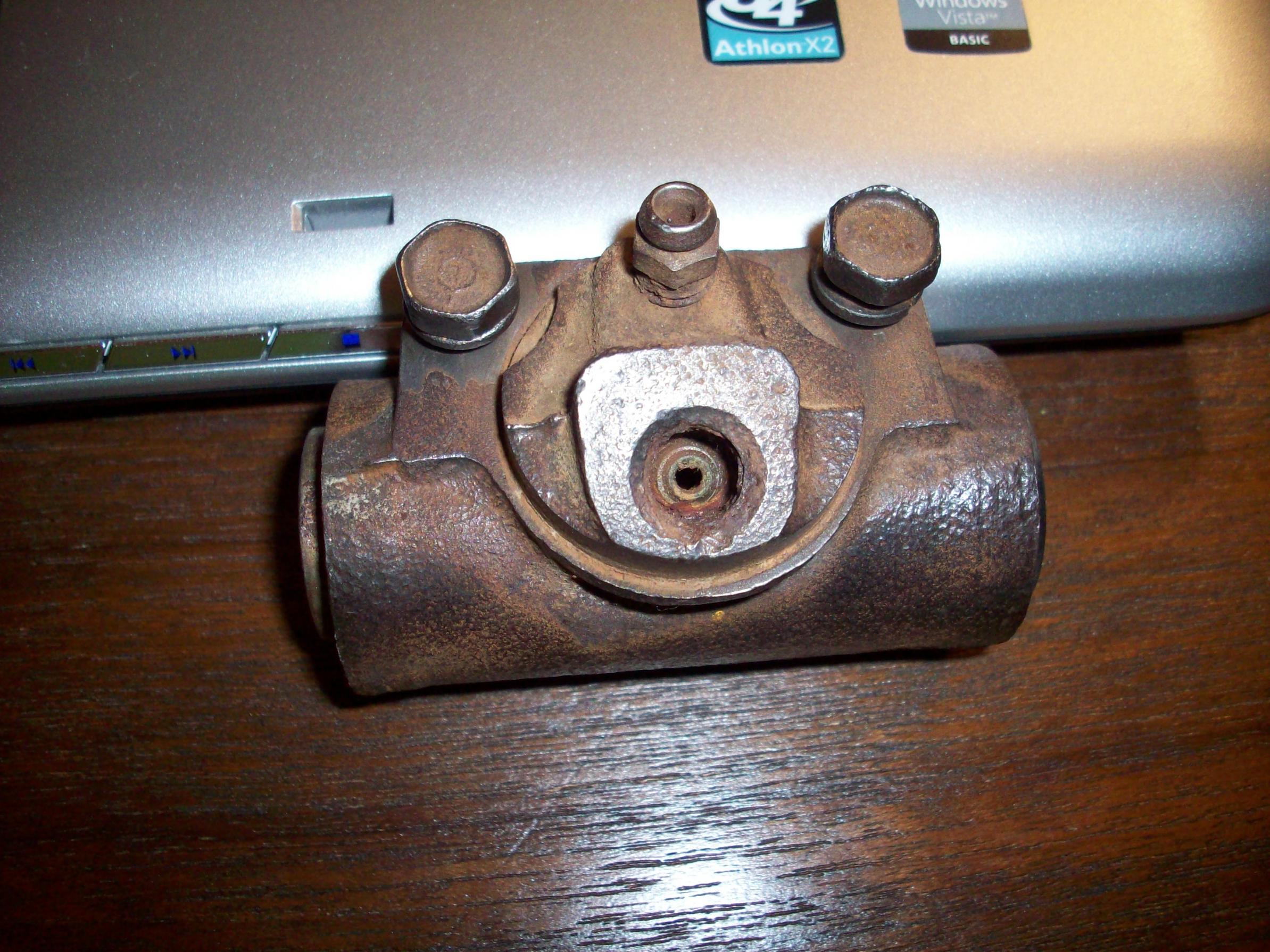

    Good info! So I was told wrong about the car when I bought it. Possibly not a S10 rear. I was trying to buy break cylinders for the rear and the closest someone was able to tell was to buy ones for a 73 chevelle. all looked good but the large hole in the backing plate was 1/8 too small to accept the new cylinder...

    Nope...Astre and Sunbird etc were all coil spring cars and this rearend had leaf pads.
    The wheel cylinder should be held to the backing plate with a large round clip with 2 tabs if it were an early S10.

    thanks Bill....as you can see mine has 2cap bolts to hold the cylinder in
