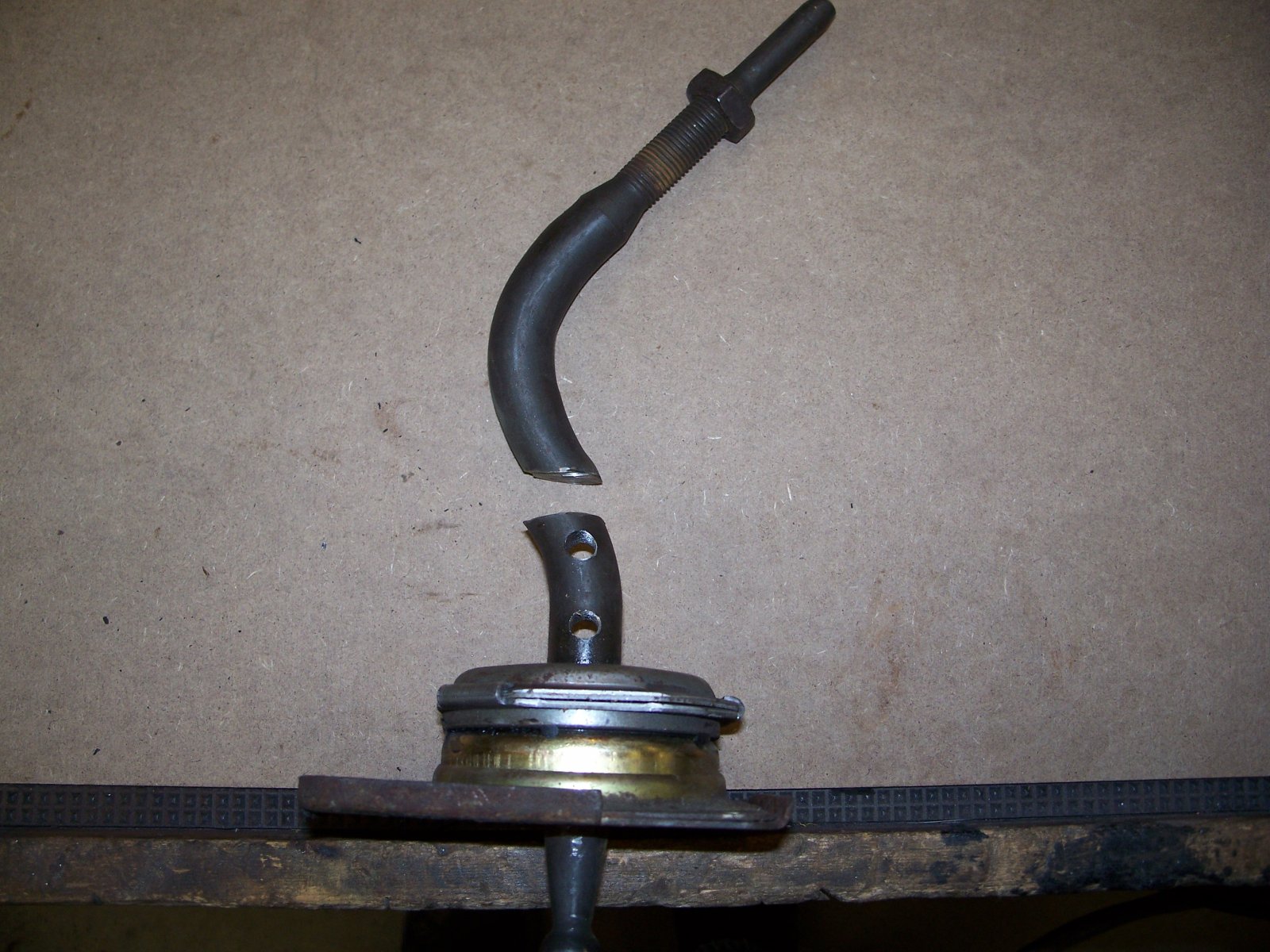

    T5 install 014.JPG T5 install 017.JPG T5 install 021.JPG Here's one I made...

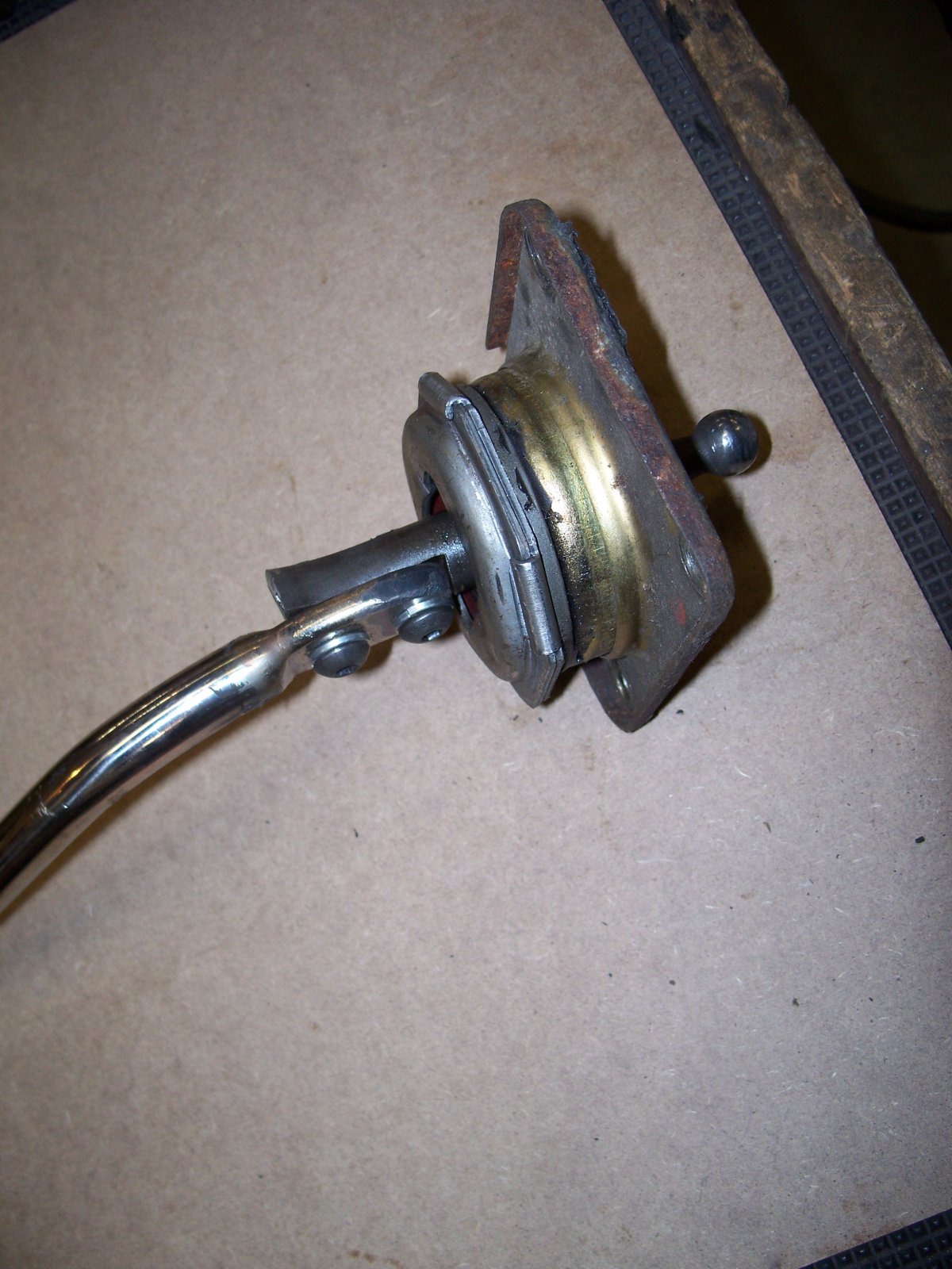

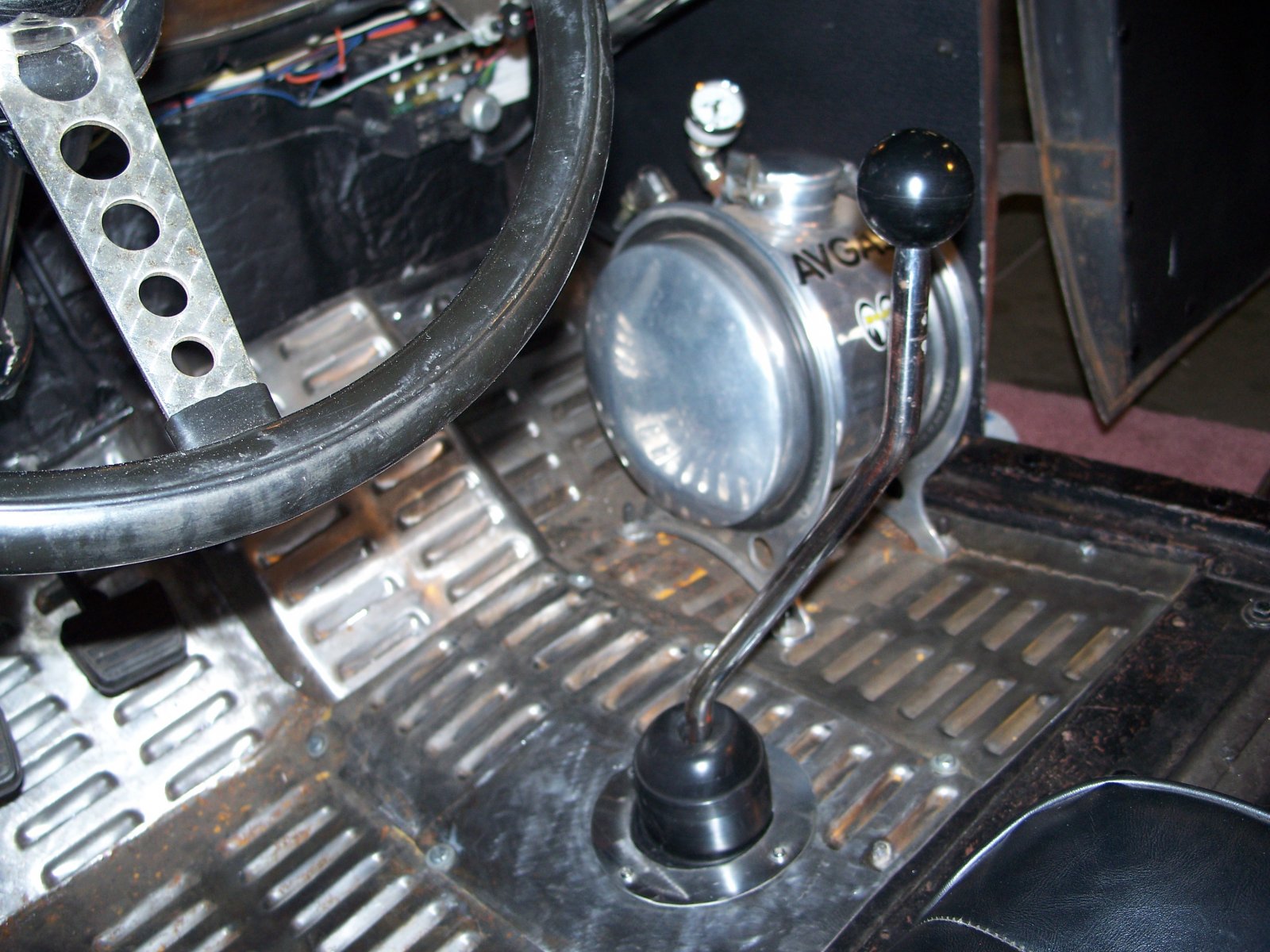

    Not a great picture but this is a Hurst style adapter I bought on ebay as Hurst no longer sells them. I have actually purchase three of them for different cars. They bolt right on the T-5 and work great, I did have to modify the lo-car shift handle as the threaded blot holes in the adapter are larger diameter than the shifter bar, just opened the holes up in the handle and milled it a bit so the hex cap bolts would set inside the bar properly. Nice result I think.

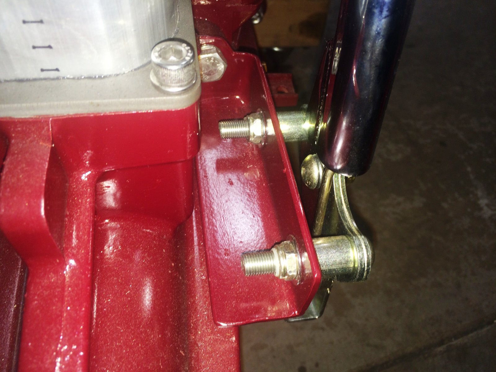

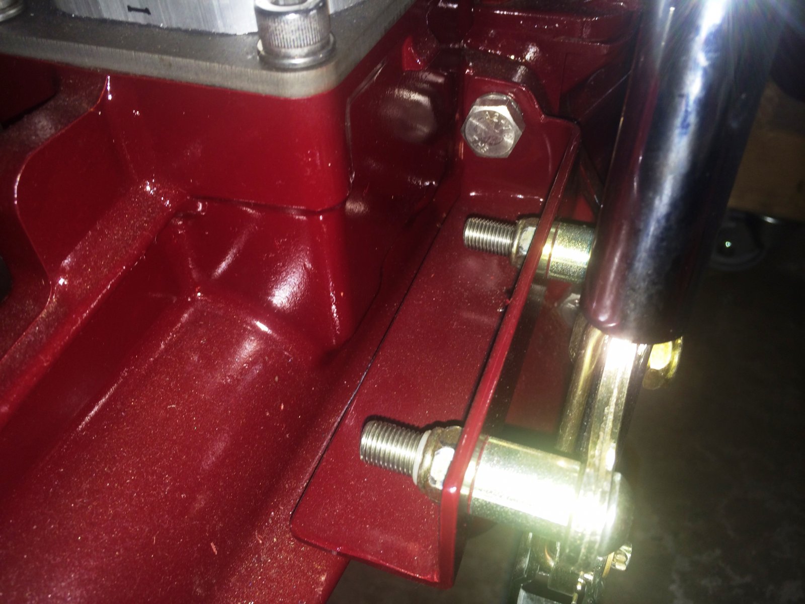

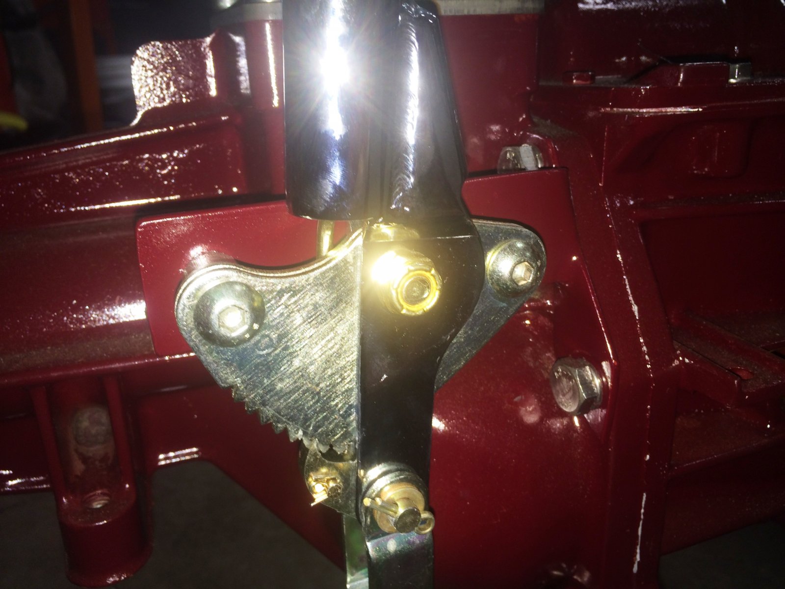

    Hey Pat, I like the traditional look of the e=brake handle next to the shifter handle and I couldn't find anything like it available so I built it. I ran out and took a few photos for you, the bracket is painted to match the trans so may be hard to discern but it hangs from 2 of the rear bolts on the case.
    I made it from simple angle so the offset would allow for easy removal even with the body on
    you can see to top bolt I used on the trans from this angle
    and here you can see the lower bolt I used. I built a cardboard template of the mounting flange, transferred it to steel and then welded the angle piece to it. I bit of grinding and paint and it looks right at home and it is very stable. I used the long e brake handle so it would compliment the long double s bend shifter bar. A bit overkill maybe on the material but I don't like things breaking.
