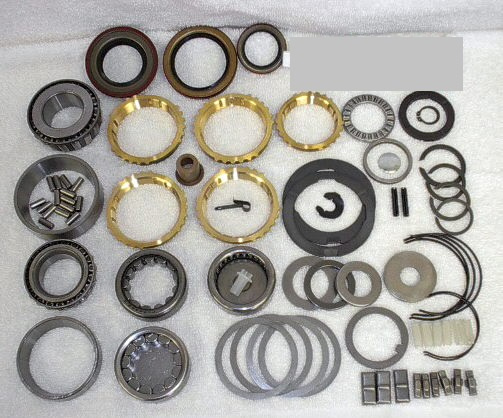

    Find out what synchros were used, br*** use gear oil, fiber use Dexron.
    If the gears were upgraded to 'WC' type then they use caged needle bearings which need Dexron.

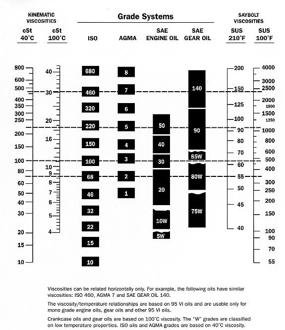

    Well Gimpy, you may be a engineer at GM, I'm an engineer at the 3rd largest lubricants company in the world, though to be open I work with Commercial lubricants, or Heavy Duty lubes; not P***enger car lubes, which are light duty. T5's are not my specialty; Allison's, Macks/Volvo's & Road Rangers are. However, I do have access to the OEM recommendations, and for S10/S15 pickups, w/ manual shift transmission the recommendations are: model years 70 - 87 - 80W or 80W-90 GL-5; Post 87 the recommendation is Dexron III spec ATF (which as I posted above is an obsolete specification, but still widely available), with some exceptions (82 - 83 model years within a specific serial number range, the recommendation is GM part #1052951, which appears to be an obsolete part # and I haven't found a cross reference to it yet. Though I did find some for sale on eBay, cheep too: https://www.ebay.com/itm/ORIGINAL-G...ART-1052951-6X-1-Liter-CASE-NOS-/183265190353
    But that's neither here nor there.
    Re the OP's trans, the recommendation is GL-5 spec oil, in 80W, or 80W-90 viscosity grade.
    Now, straight grade SAE 50 oils have been used in manual shift transmissions for many years, heavy duty trucks made that change many years ago, and the viscosity for the newer automated manual shift transmissions is even lower at SAE 40.
    But now we're talking 2 different ways of grading oil viscosity. The SAE is the body that sets the official grades for viscosity of automotive lubricants (The ISO sets the viscosity standards for Industrial lubricants). You can see a comparison of Engine Oil to Gear Oil viscosity grades here: https://www.bobistheoilguy.com/viscosity-charts/
    So from that you can see that a 50 grade engine oil falls within the viscosity range of a 90 gear oil. So a 80W-90 gear oil is pretty much the same as an SAE 50 motor oil. The big difference is in the additive's used, with GL-5 gear oil having EP or "extreme pressure" additives not present in the 50 grade trans fluids like the Mobil product you linked to. What the heavy duty market found was that the heavy EP additives were not necessary in manual shift transmissions, and that they actually can cause some damage to any yellow metals present, which many (most?) manual shift transmissions have, such as the synchros. Which makes me wonder why GM recommends GL-5 for that transmission. Like I said, those are not my area of specialty, anyone who has experience with the T5 trans may be able to answer it, but I would ***ume the transmission is under a heavy load that they want the EP additives to protect the gears, and that it doesn't use much in the way of yellow metals. With @Montana1 talking abut putting the trans behind a 600 horse power plant, well, some EP additives may be called for. What's the typical failure mode in a T5 transmission? Is it gear failure?

    [​IMG] So based on this chart 50 weight engine oils the same viscosity as as 90 w gear oil. So far the recommendations have been all over the map from many sources. MTF Synchromesh from various manufactures, ATF, 50 w Modil, 70 w gear oil, 90 w gear oil, and some other fancy stuff. I appreciate all the help just the same. Looks like they'll work with anything so I'm going with Olive Oil.
