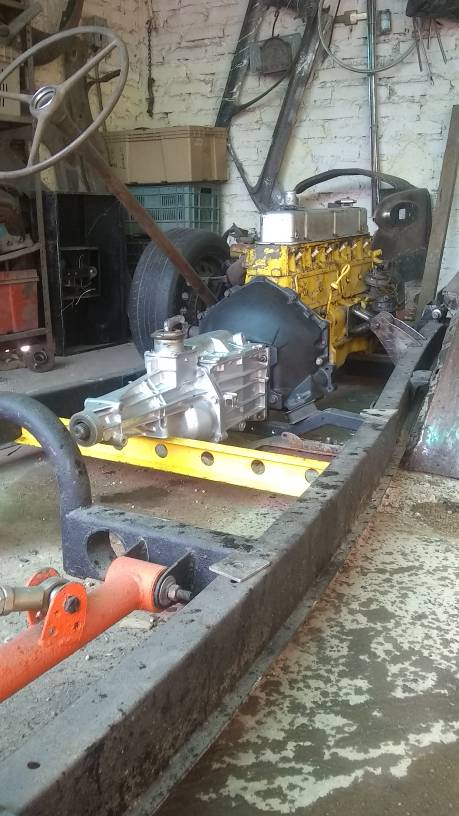

    Today I bought a Borg Warner T5 manual transmission for a one day swap into my 36 Ford Coupe with an 8BA Flathead. The tag on the case says 1352-042.
    I found it on Craigslist about 100 miles away for $260.00. I bought it the same day as is. The numbers tell me it is from a 1984-85 S10 with a 2.8 V6 and a 5 speed. It has a mechanical speedometer. Here is my question. I think it was a great buy but do they have any common problems?? It shifts great and feels tight. I’m not sure I will rebuild it. Anyone been down this road??

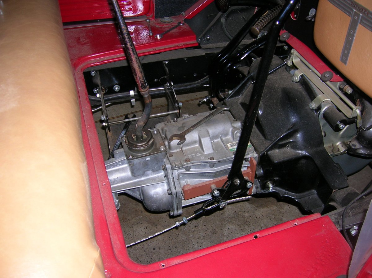

    Stick a tail shaft seal in it while it's on the bench...
    Then stick it in and and run it.
    I installed mine in a couple hours...

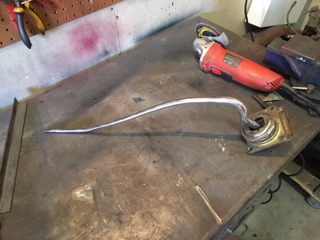

  7. 1st gear is pretty low.I start in 2nd with ease.They make shifters that give them a smaller shift pattern.I made my shifter lever from a shot out Enfield rifle barrel.Its marked 1917.It has a nice taper.I put the shift knob on a 6 inch piece of all thread,and pushed it in the bore. Looks like a 1930 shifter. While its out cut the "fin" off the bottom of the case for clearance.

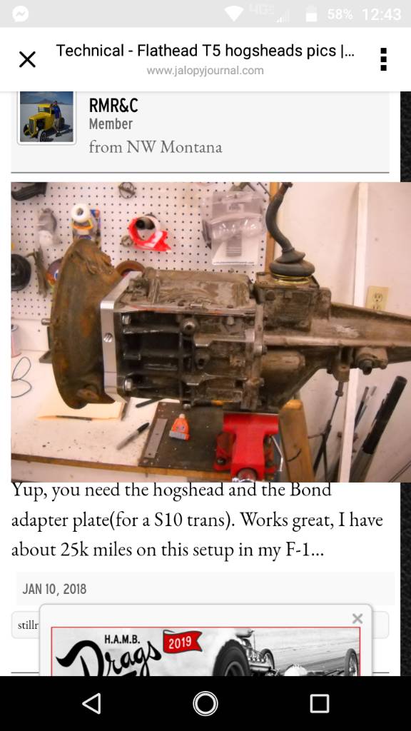

  11. RMR&C
    Joined: Dec 26, 2009
    Posts: 4,999
    RMR&C
    from NW Montana

    Put one in my 39 Plymouth pickup behind the original flathead. Shifts like a dream! DSCN2015.JPG

    I like the E-brake bracket.

    You will need an adapter plate and truck hog's head to bolt it all up.

    I sacrificed a swan neck shifter and pinned/welded it to the S-10 base so it look stock and used stock sift knob.
