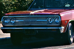

    upload_2024-5-22_2-10-3.png Our 327 powered 1940 Ford Sedan Delivery
    Hello,
    A new radiator cap, new fan belt and new thermostat solved the overheating problem and no more liquid dripping on the concrete floor. In our carport or elsewhere. After months of trouble free driving, our 327 powered sedan delivery started to overheat. so, the first thing was a thermostat change. Ok for several runs to the local surf spot, but then overheating.
    In the same carport, a similar exchange in our trusty 65 El Camino was done, too. We were thinking about selling the 65 El Camino and moving on to the next car purchase. The trusty El Camino had given us 120k miles of trouble free road trips, long vacations all over So Cal and up into the Northern California coastal cruises and as far inland near the tall ridgeline running North/South in Central California.
    So, in our minds, it was listening while sitting in the carport and decided to cause some concern for reliable driving around. No temperature rising until we started our uphill climb on a normally narrow road. By the time we got to our carport, it was bubbling stuff on the concrete floor. So, it was paying us back for even thinking about selling…even after all of those years of trouble free service since new in 1964 fall season.
    Jnaki
    We started off with a new thermostat. Then a new upper hose and finally a new cap. Finally, the local mechanic said we probably needed a new water pump, despite not making any noises during operation in normal and long distance driving. So, a new water pump was installed, too. Now, with those items new and replaced, it fired up and another long distance road trip to Baja Mexico was taken. No sense in babying the reliable road warrior. It was ready as usual and no leaks, overheating or problems in coastal Baja roads and cliff area driving.
    5000 miles later and many weeks of So Cal driving, it ran fine. Then, one day, it was an offer I could not refuse, to sell the red El Camino to a local kid from Dana Point. He was going to use is as his surf vehicle and tow a small sailboat behind. The last time I saw it was going down PCH in Laguna Beach and it was painted blue.
