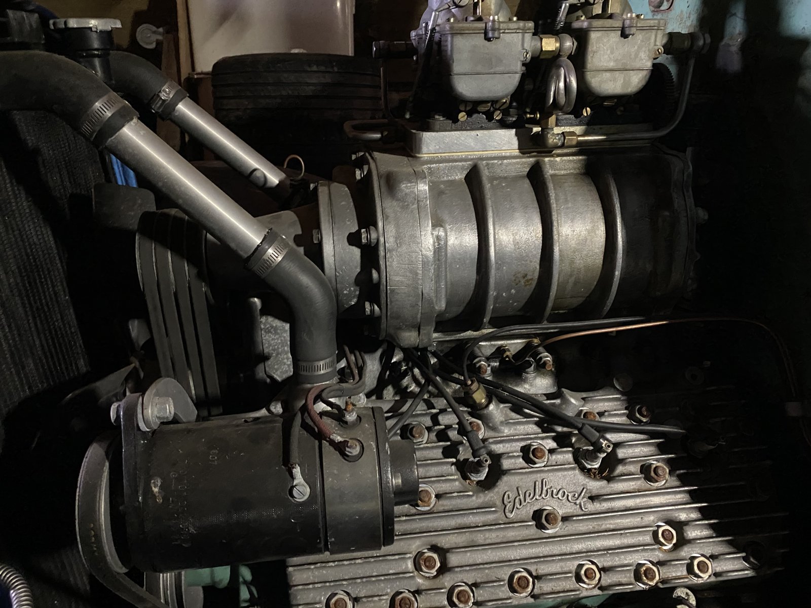

    Here is a friend to me I visit today and look at his awsome work on his A-Ford coupe with FH and his hours on the intake and a 4/71, plus the belt and fan solution.
    This is fantastic hot rod.
    -We discussed why they ( or some in late 40’s ) machined the GMC blowers this way, but in his case its just the ’look’, but why did Navarro do it ?
    Few in racing invest time on look better.
    Ideas ?

  6. One of the reasons is the blower manifold that Barney made (for flatheads) has a real small opening, so there was no real reason to have that big ole' square flange on the blower (looks aside). The same holds true for the Austin (now H&H) Ardun blower manifolds - very small opening.
    Also, with that wide flange, there would be interference issues with 37 - 48 center water outlet heads (same with the later Ardun heads). Getting rid of the flange opened up room for the water outlets and obviously in this application, it looks a heck of a lot better.
    Now on a big-*** 392/426 Hemi or modern OHV- one doesn't even notice the wide footprint of the blower and ALL GMC X-71 blower manifolds for modern OHV engines are designed for that specific GMC flange footprint and bolt pattern.

    Barney could use the later heads with inlet in front but maybe they came out 48, plus he used his own head.
    But I always thought the aluminium was never made any HP, just the look but thats another story.

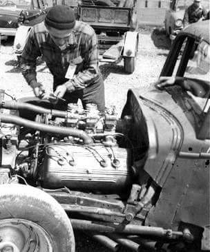

    3W, here are my observations built up from the time I was a teenager in the mid 1970s fascinated for some unknown reason with Arduns. Most if not all Arduns built for the street either had carbs. attached to modified Ardun intake manifolds or welded up log manifolds as Bored and Stroked pictured. Race engines that were successful were equipped with Hilborn fuel injectors. Very few race engines of the period were blown. I believe that Crower u-fab log manifolds were somewhat common. Over the years my observation os that if a set of Arduns were found or made it to a swap meet, and they were complete with an induction set up, it most likely was a set of Hilborns. The engine in my race car that was built in 1955 has Hilborns. The set I hope to use someday that I think came from a street driven car has a log that looks identical to Bored and Stroked picture. If I wanted to ***emble an Ardun with appearance from the time period when they king it would never have a big Scott. The maim reason is that almost 100% of the engines put together with Don F. heads also feature one of his big Scotts. They are ubiquitous and so common as to be boring. They look good and run well but....

    V8RPU,
    Your engine looks a lot like mine before I got it. Mine was run hard and put away wet many times, it was not in good condition. The guy I got mine from sold the Hilborn for what he paid for the whole thing, kept the valve covers as wall hangers and put the mag on another engine he had. I got what was left.

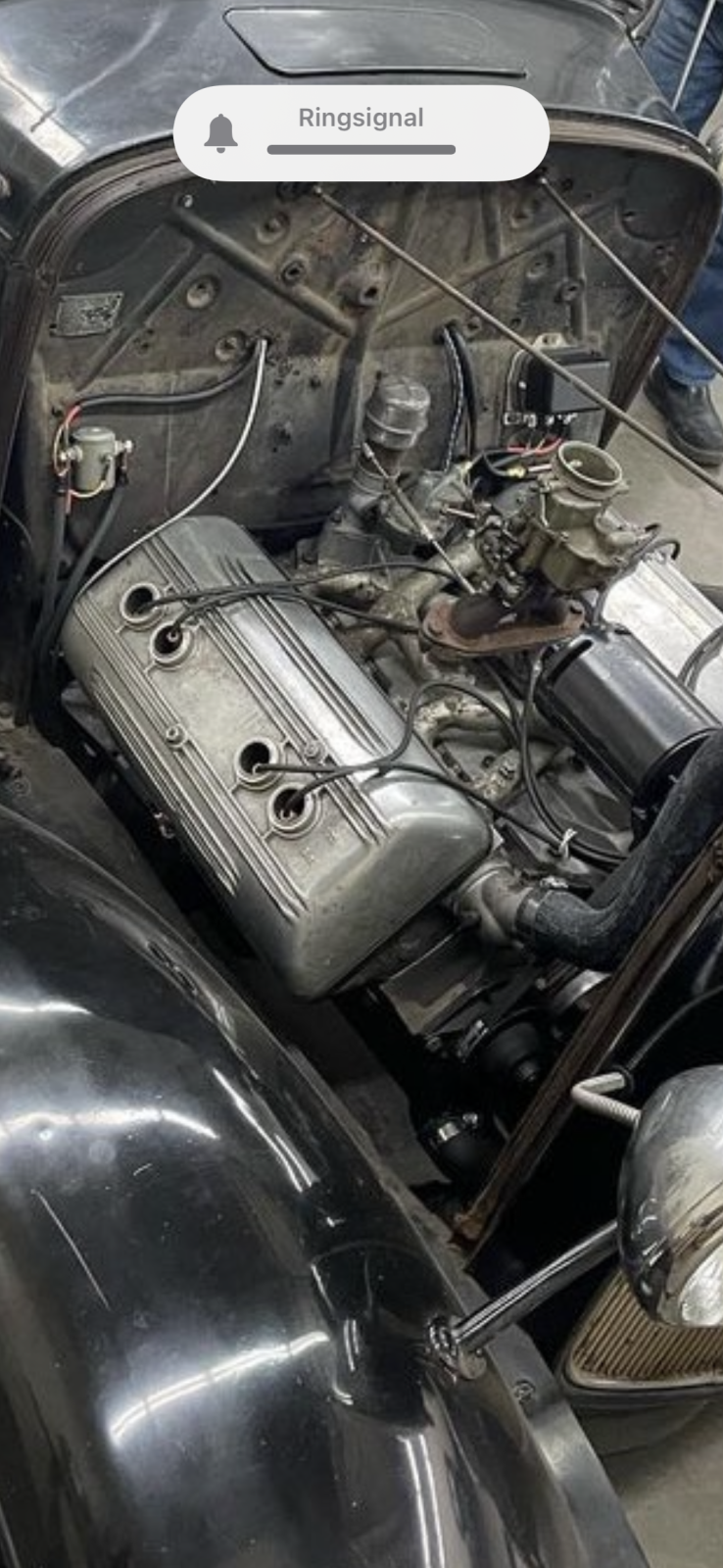

    Like this.

    that pic makes me think of those first hemis in the old sedans w/ a little 2 bbl perched on top!
