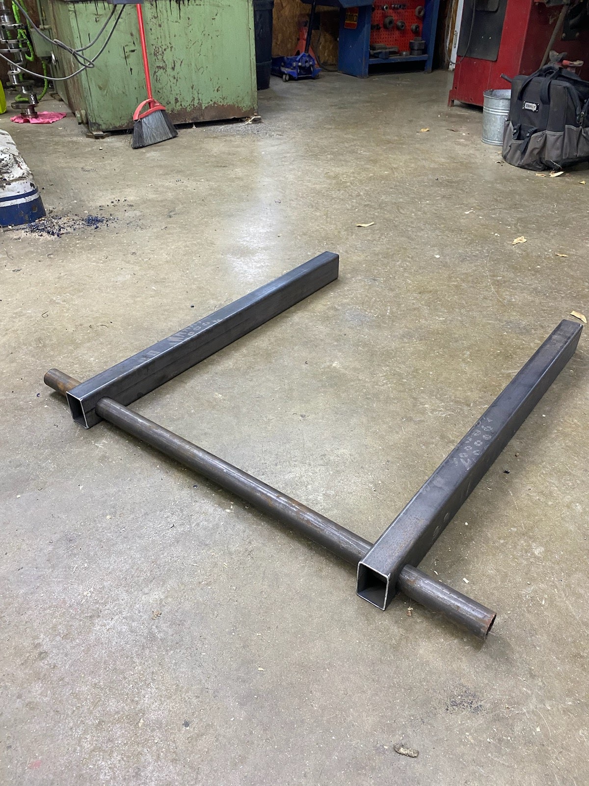

    1st thing was to get the car stripped down and ready to cut the frame for the straight axle front clip.
  4. Saturn V
    Joined: Oct 10, 2021
    Posts: 233
    Saturn V
    from Killen AL
    Front frame clip.

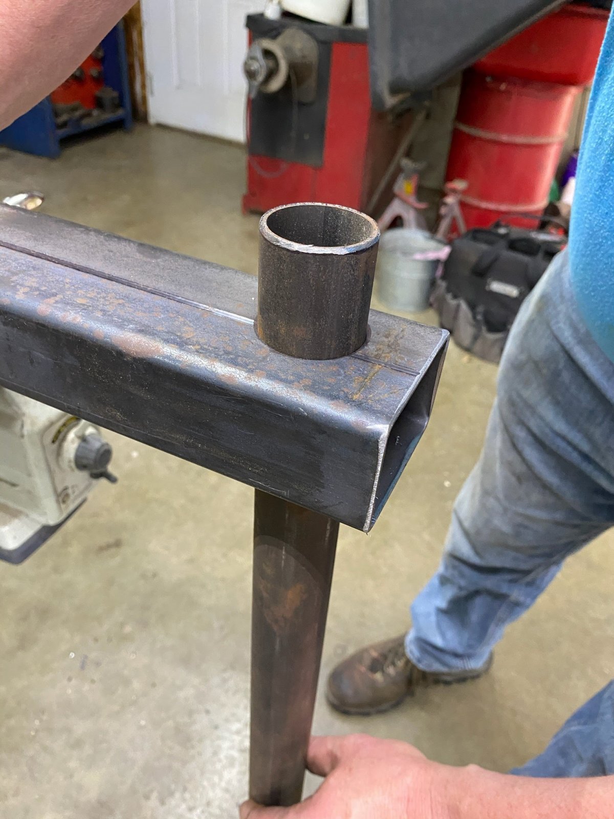

    Back to the front clip.

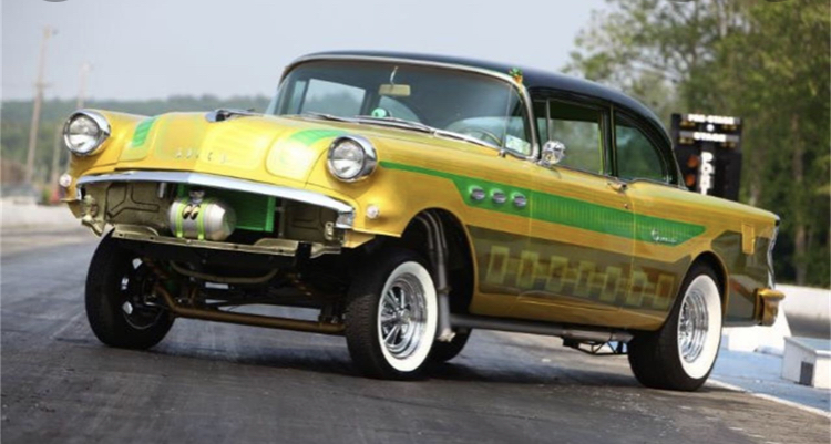

  11. Here’s ya a 55 doing some straight line fun
    aussie57wag, Outback, EVL401 and 8 others like this.

    These pictures show a nearly finished front suspension.
