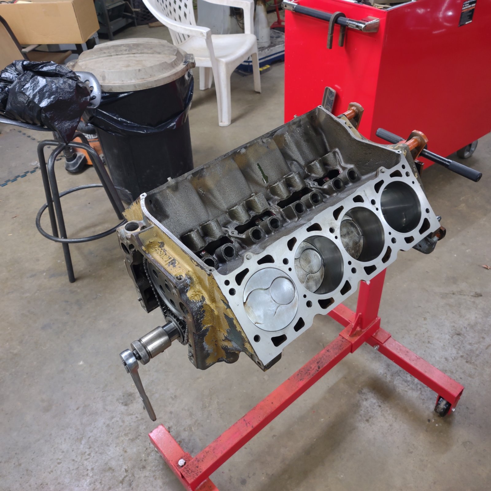

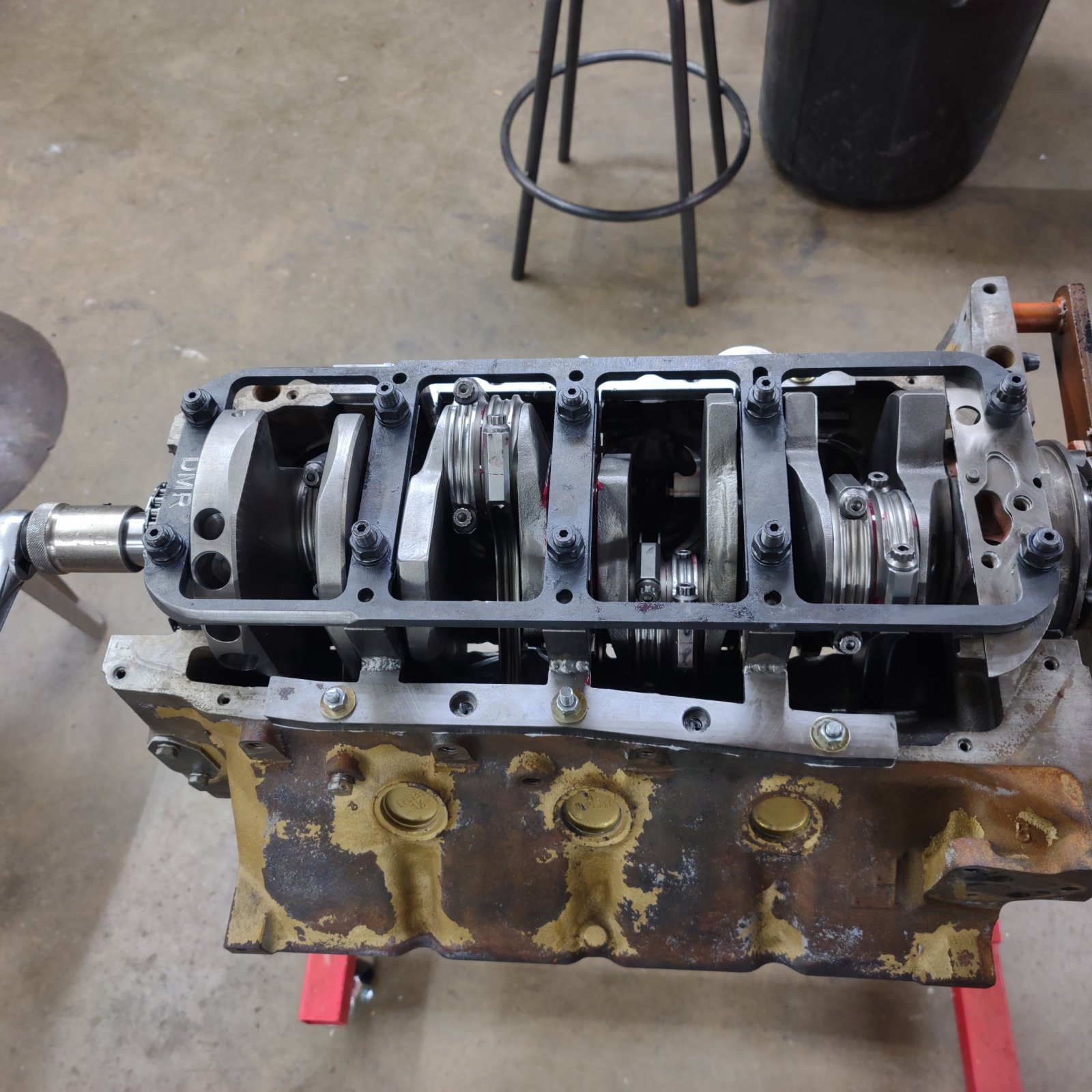

    I got to work on my engine this weekend. Was able to get the line bore and hone finished. IMG_20220813_093303536.jpg IMG_20220813_103636311.jpg

  8. That’s an interesting way of doing a girdle with the welded pan rail supports. Is that something you did or somebody else’s work. Haven’t seen welded before, always one piece or bolt together in the past. That also looks like maybe a 455, boat motor?

    ^^^ like silverjimmy says, curious to see oil pan welded up so no leaks at the step join over brace. ****ers always want to leak anyway

    The girdle set up is one of **** Miller's parts. It's not too bad a looking part. I'm curious to see how it works out!
