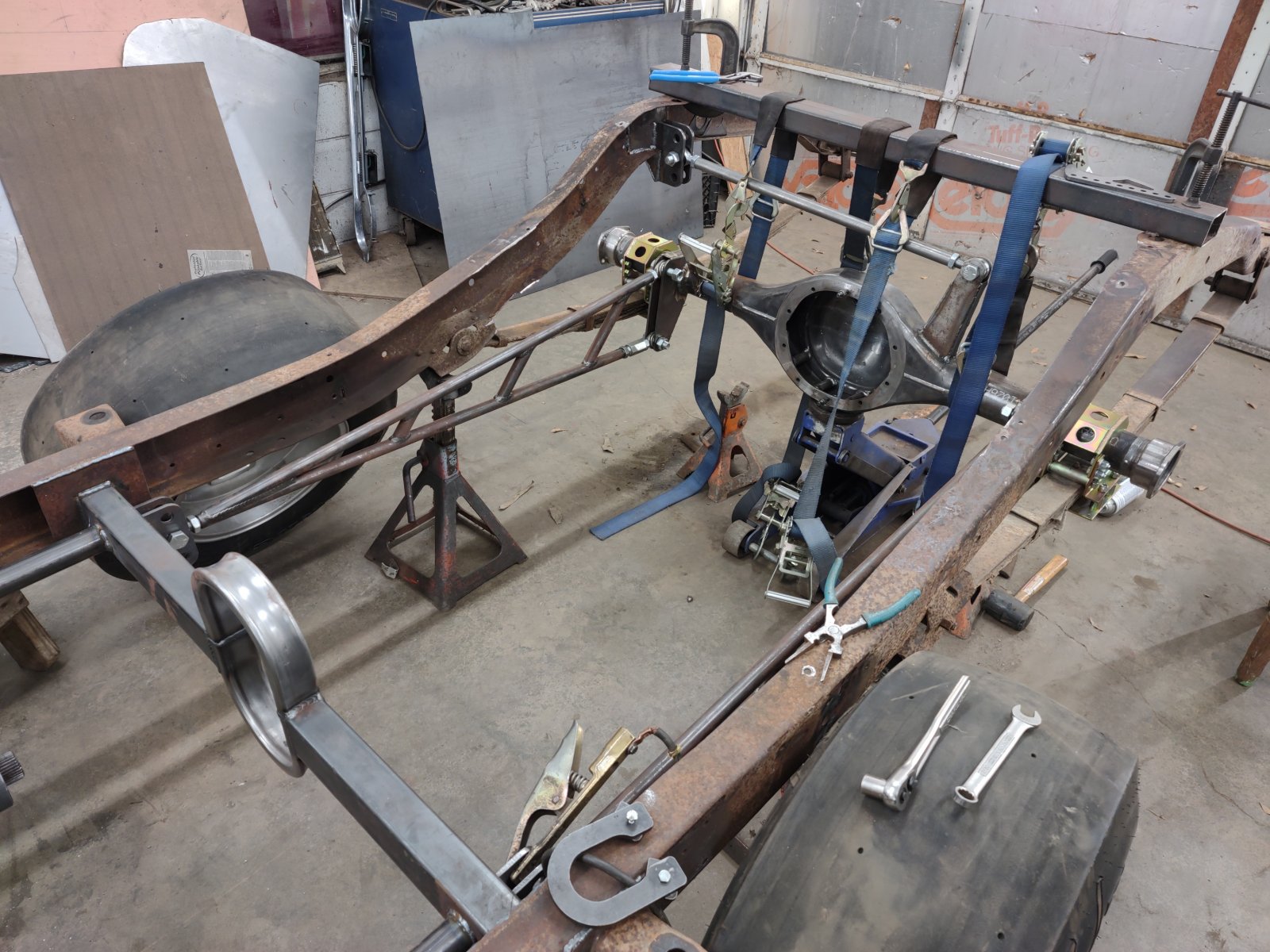

    Almost done with the rear suspension. Found out this era correct is harder than it sounds!!! IMG_20211129_183131845.jpg IMG_20211129_183131845.jpg IMG_20211129_183051947.jpg

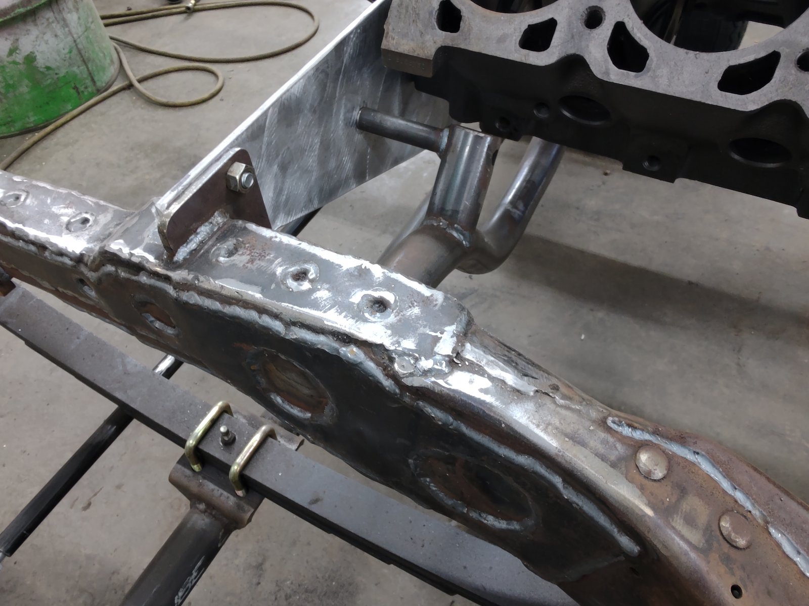

    did you use slugs or any extra sleeving where you joined at the kickup , reason i ask is have never done much car frame stuff an while i don't mind picking up small stuf that breaks off to old to pick up a front end :(

    We have plated the frame graft, along with several Rosetta welds along as cutting a hole in both frame rails for the crossmember. IMG_20211107_154403724.jpg
