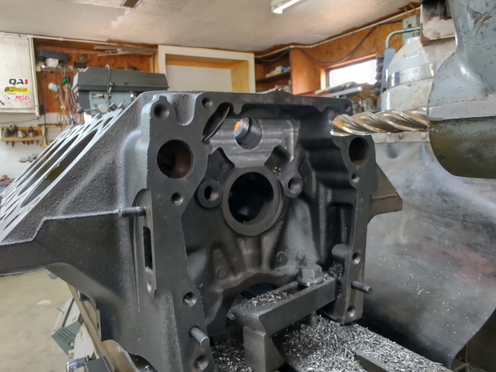

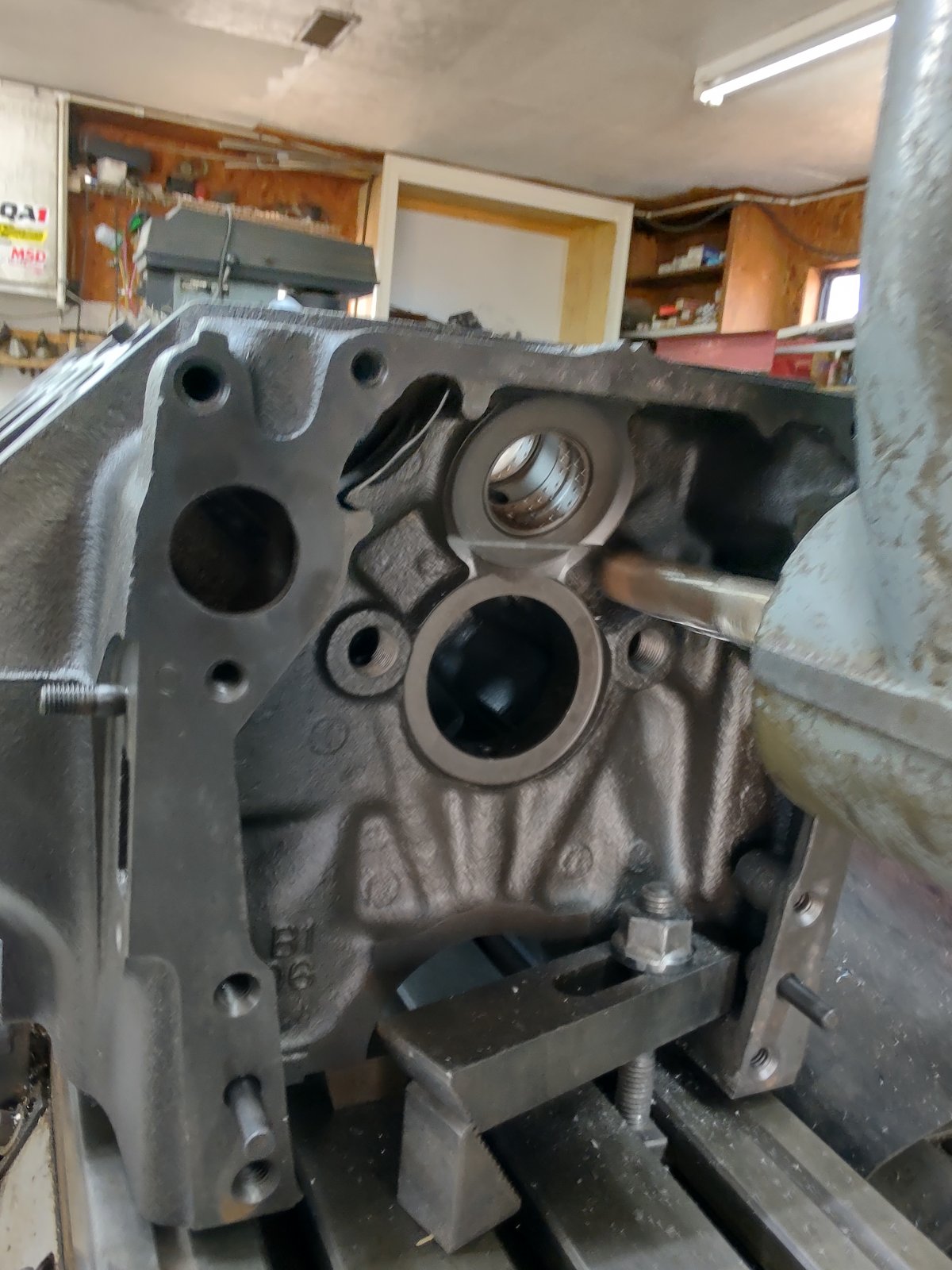

    1st step in turning a diesel into a hotrod gas burner!! IMG_20220326_144949424_HDR.jpg IMG_20220326_145916415_HDR.jpg
    OahuEli, brEad, chryslerfan55 and 5 others like this.

    I've got 5 more of these block to do,,,

  26. bobss396
    Joined: Aug 27, 2008
    Posts: 18,908
    bobss396
    Ballsy... I'd like a little more meat under the toe clamp. Is that a 90 degree attachment for a Bridgeport?
    Saturn V likes this.
  27. Saturn V
    Joined: Oct 10, 2021
    Posts: 233
    Saturn V
    from Killen AL
    Yes, it is. I have 2 machined bolts in the mains that fit snug in the t-slot groove. Only needed a light clamping to hold it tight to the table
    ottoman, chryslerfan55 and bobss396 like this.

    What I'm doing is machining the injector pump boss out. Having to make room for a good timing chain.
    It's a 78-85 5.7 GM diesel. If your going to make 650+ HP with a Olds. This is the block to use. The main webbing in the gas blocks are too weak to consistently contain those power levels.
