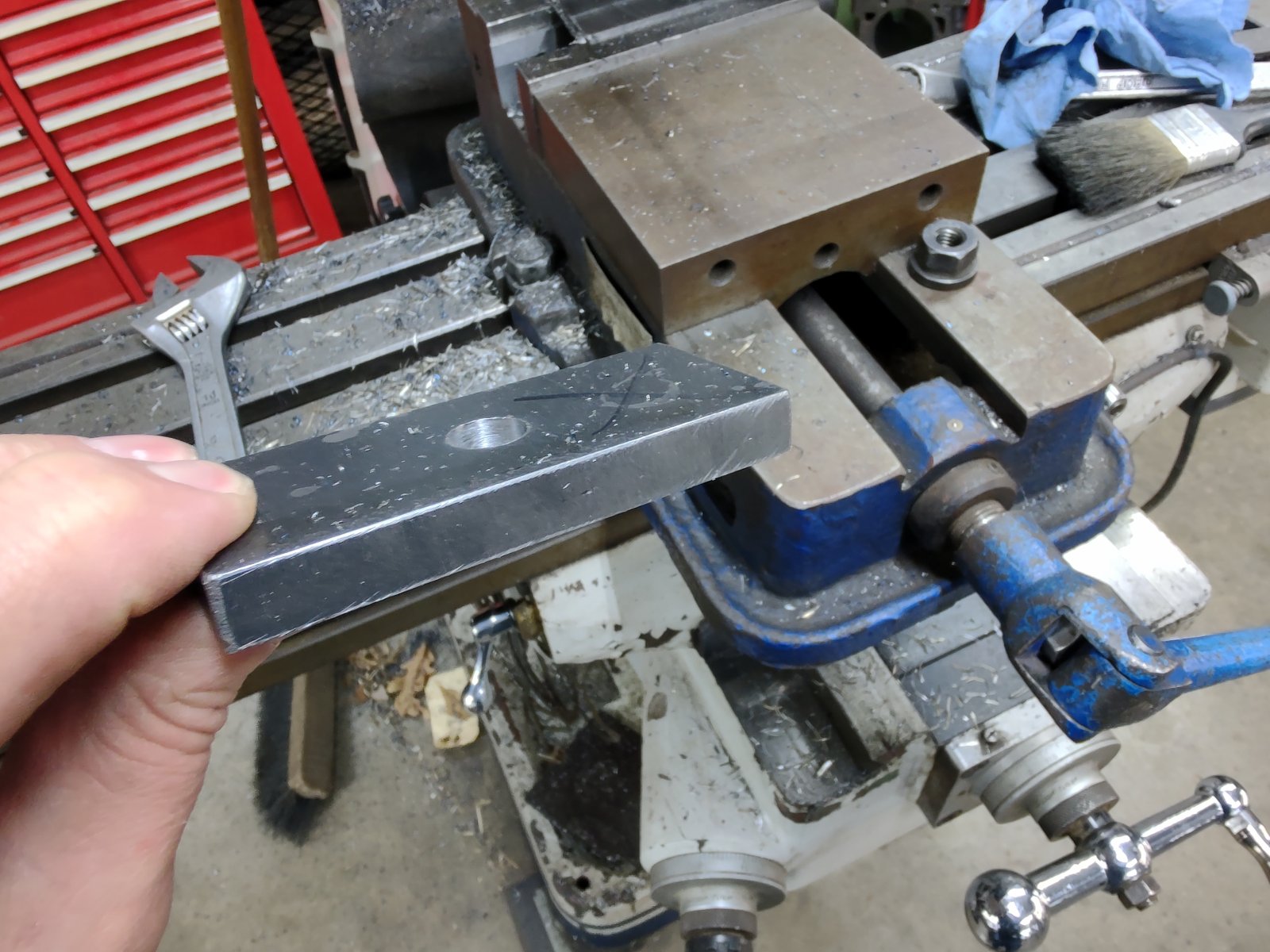

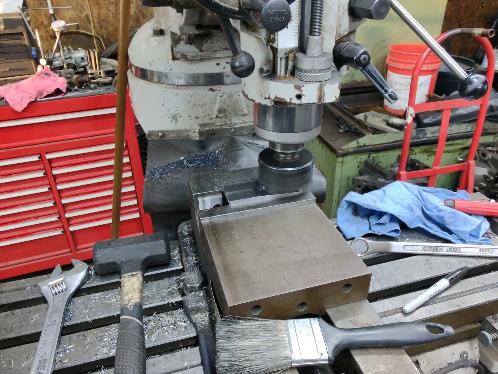

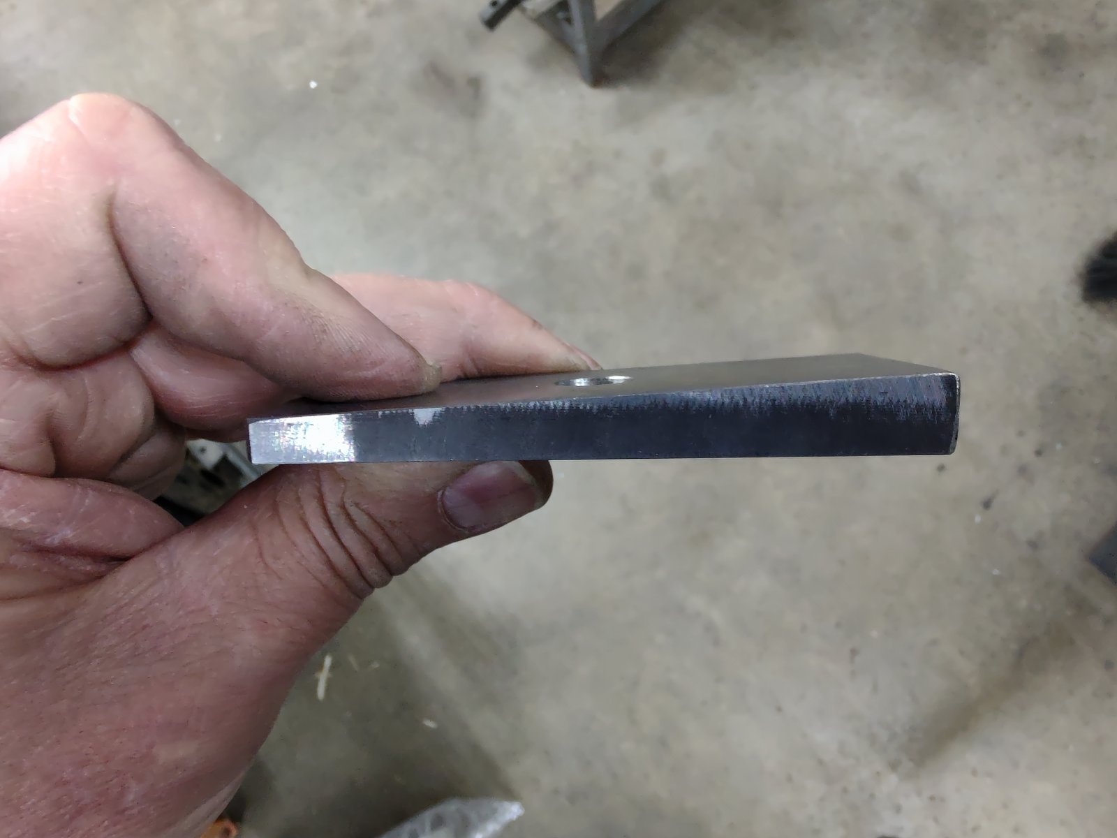

  22. Saturn V
    Joined: Oct 10, 2021
    Posts: 233
    Saturn V
    from Killen AL
    Some guys are body guys, some fabricators,,this is where I shine!!! I love being a machinist!! IMG_20220518_173945939.jpg IMG_20220518_181104386.jpg IMG_20220518_184244813.jpg IMG_20220518_184754410.jpg IMG_20220518_185655790.jpg
    catdad49, AHotRod, winr and 13 others like this.

  24. Saturn V
    Posts: 233
    Saturn V
    from Killen AL
    Thank you!! Hopefully it will be going to work with me in a couple of weeks for the line bore and hone.
