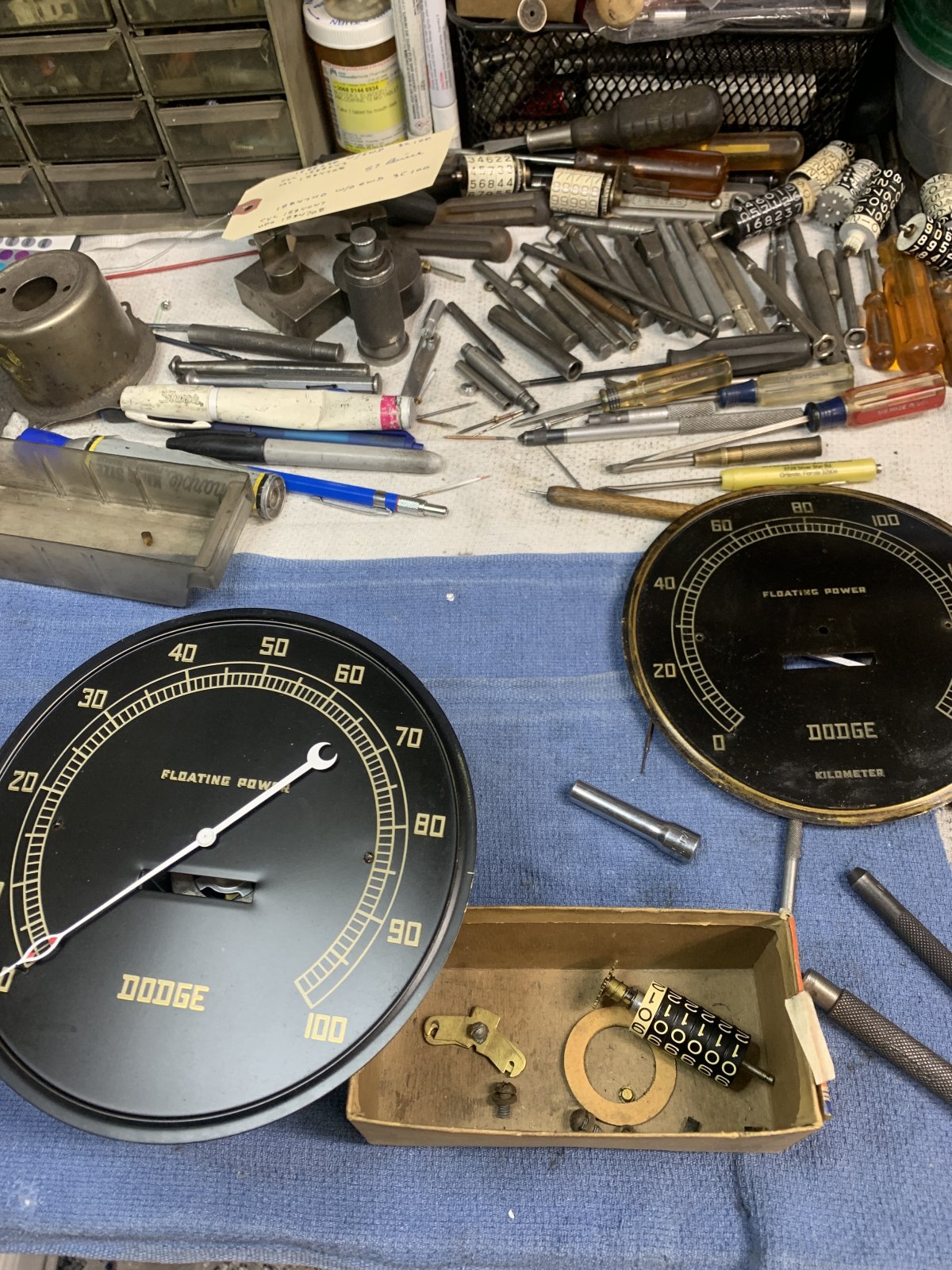

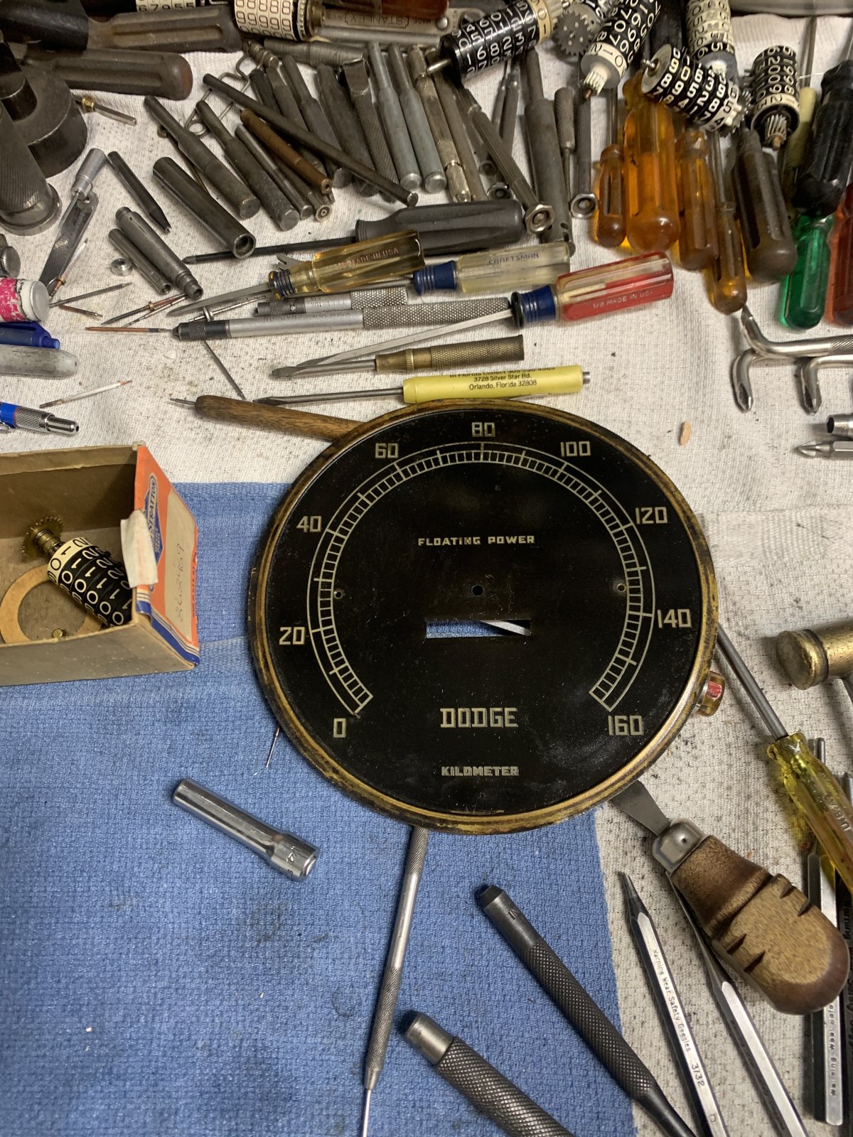

    0CC7BB8C-5DBA-4044-96A6-3DCBC8E35EEB.jpeg 2F2702F0-A5AC-46F8-ADCB-949353146820.jpeg I currently have two 1935 Dodge 6" Floating Power speedometers I’m working on, one 100mph and one 160kph. I currently I am converting the 160kph unit to 160mph by changing the odometer gears from kilometers to miles so that will read correctly, then recalibrating the speed to mph. I am also having overlays printed of the kph dial replacing the Dodge and kph with mph for future conversions of the 100mph dial to 160mph for customers who want that done. Here are some pictures, I don’t have a picture of the new dial art yet as it is still being worked on. The current kph dial will be left as is as I don’t want to cover up a rare dial and it could be converted back to reading kph by changing back the odometer gears and recalibrating on the test bench.
    I know I’m walking the solicitation line here
    but both speedometers will be up for sale.
