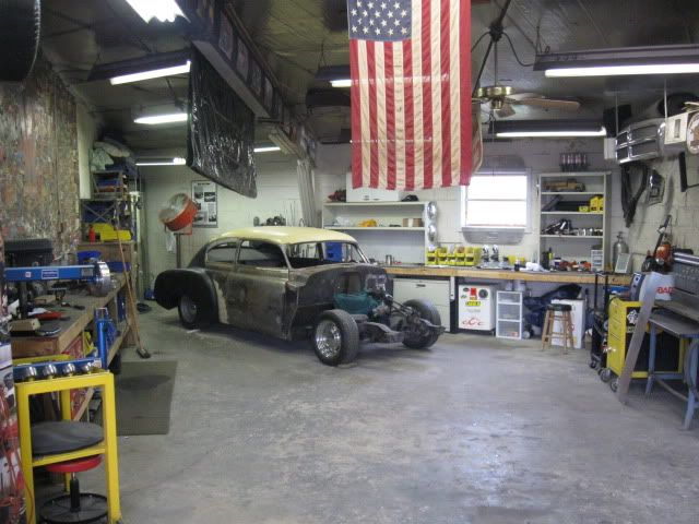

    Here is a picture of our 51 Fleetline. We added a mid 80's S-10 clip to a frame made from some of the original frame with a custom rear clip. We went with everything at stock ride height so we could drop the entire body 6 inches over the frame. It was not a true channel job but rather a body drop. Hope this helps. There is an album on my profile called the Shavrolet Sleekline Story with a bunch of pics.

    Fitzee, I went back through some pics of our S10 frontended Fleetline and found this front on shot. We cut 1 1/2 coils off the stock springs. You can see the lower A arms are pretty much level and they sit pretty low.

    Very nice! Did you level the upper a arms or the lower a arms? Dont they sit at diff angles?

    I leveled the lower arms and they sit at the same angle.

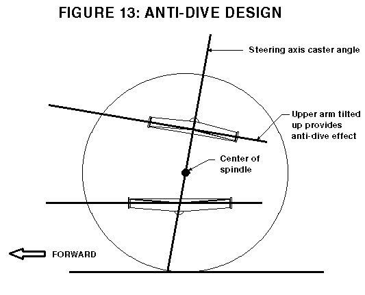

    I'm looking to do the same to my shoebox. So, those that have done this, you leveled the lower arm, which should have given you the proper anti-dive angle on the upper arm. Has anyone measured what this upper arm angle ended up being once installed? I've read it should be 7-10 degrees. Does this sound correct to you?
