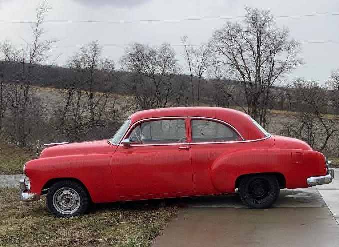

    Thank you,sorry for the confusion,at first(before I actually took possession of the car) I was told it was a 52, but since I have learned that it is in fact a 1950 Belair. I have an S10 4x4 rear end for it.I guess I will have to either look into a mustang lol front end or rebuild the original front suspension. I'm really not a fan of drum brakes,so a disc brake conversion will come soon..time to do more research on it. I have posted pics...let me know what you think. The ***le says 1950 Chevy..was told it's a Belair due to the 3 piece rear window.

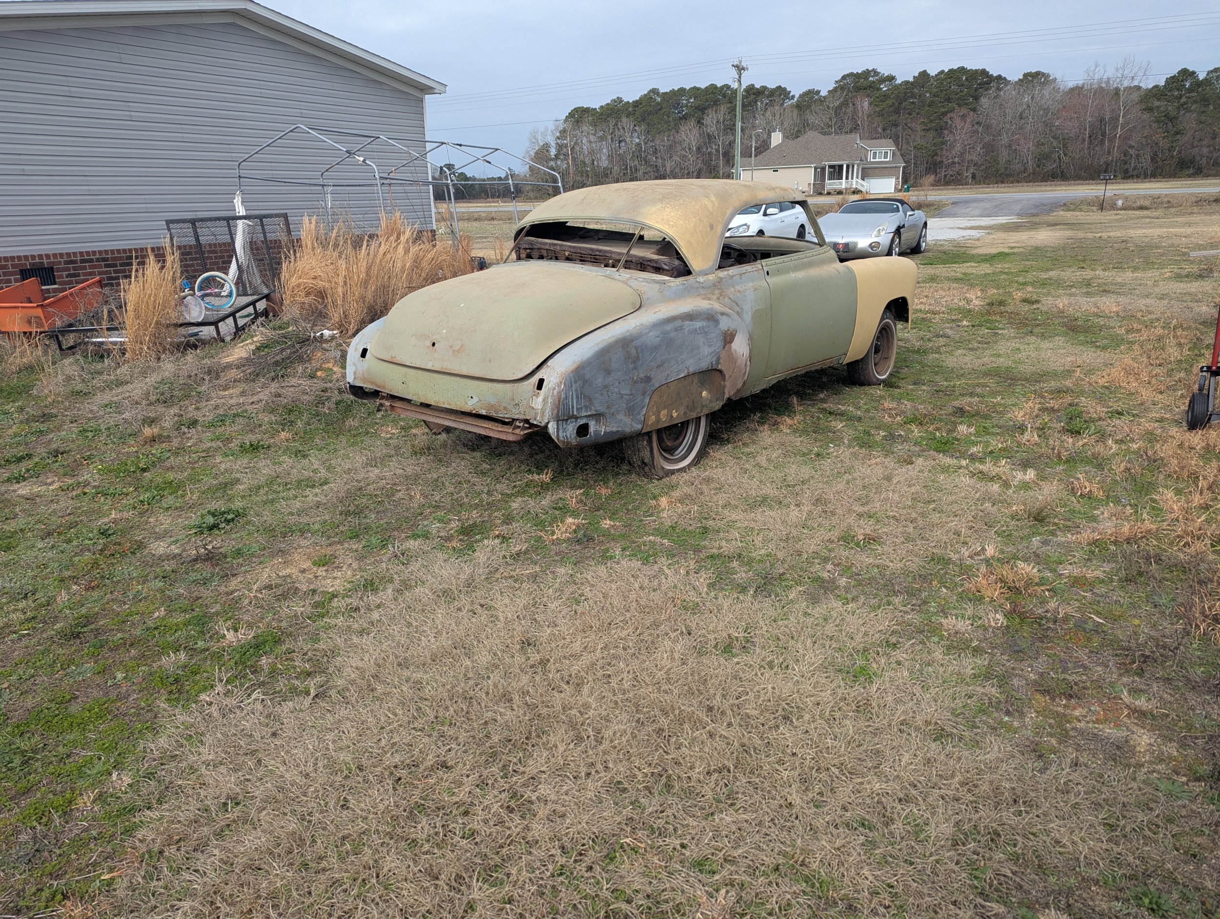

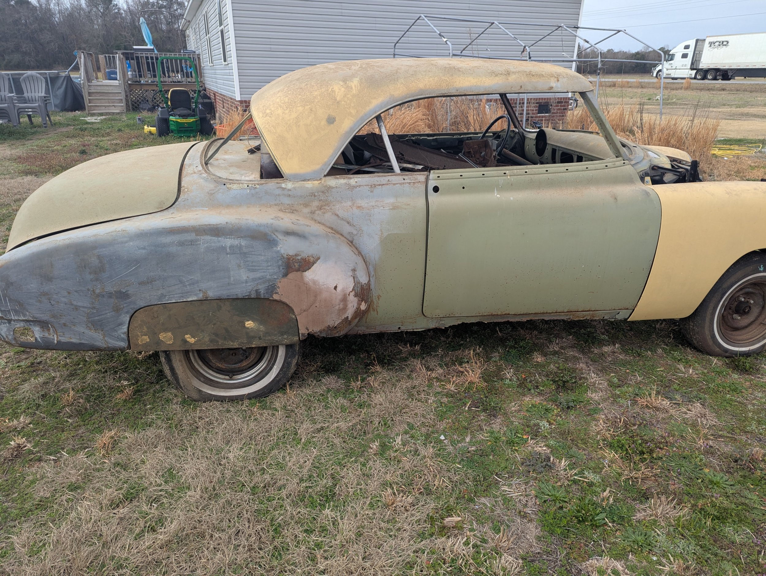

    I don't think the 3-piece rear window was exclusive to Belairs. I have seen Style line photos with the same back window. I can tell you that your car is a coupe by the shorter rear quarter windows and longer trunk. Your hood has been filled (the center seam welded and filled). Hopefully it was welded and not just filled. The 50 grill you show does not appear to be original to the front fenders. There are differences between 50 and 51 fenders. Those fenders look like the fenders on my 51. To know exactly what the car was here is a VIN identification page for reference. 1946 - 1954 Chevrolet Model Identification

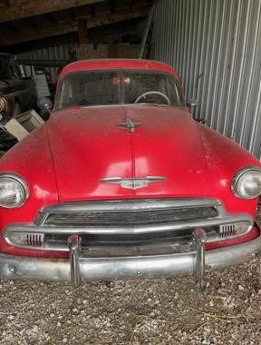

    Here is a side and front view of my 51 Styleline deluxe sedan. You can see the hood seam trim and badges that have been removed on yours. That is a very common modification. The squarer rear fenders was a change in 51. You can also see the longer rear quarter window and shorter trunk that differentiates between coupe and sedan. upload_2025-4-19_11-20-22.jpeg upload_2025-4-19_11-21-46.jpeg
    Overall, your project looks like a great start. Welcome to the madness (it's not an addiction as I can stop any time I want, but why would I ever want too?) and most importantly, have fun!

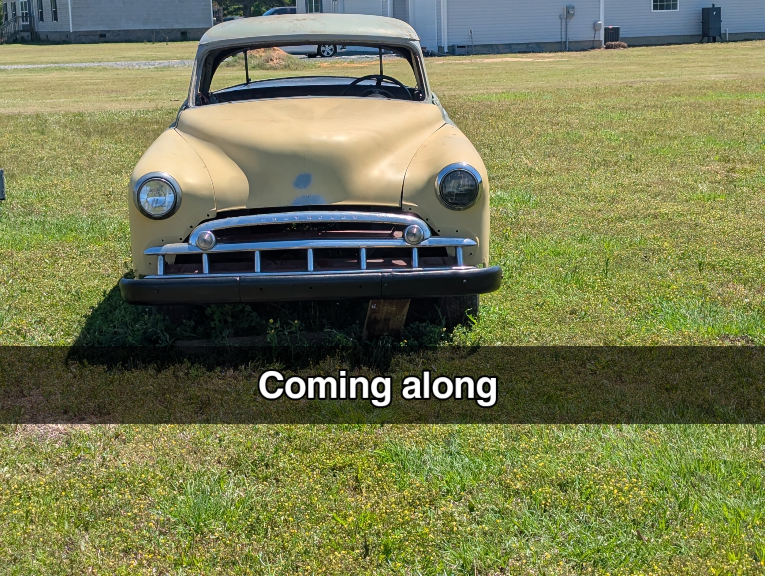

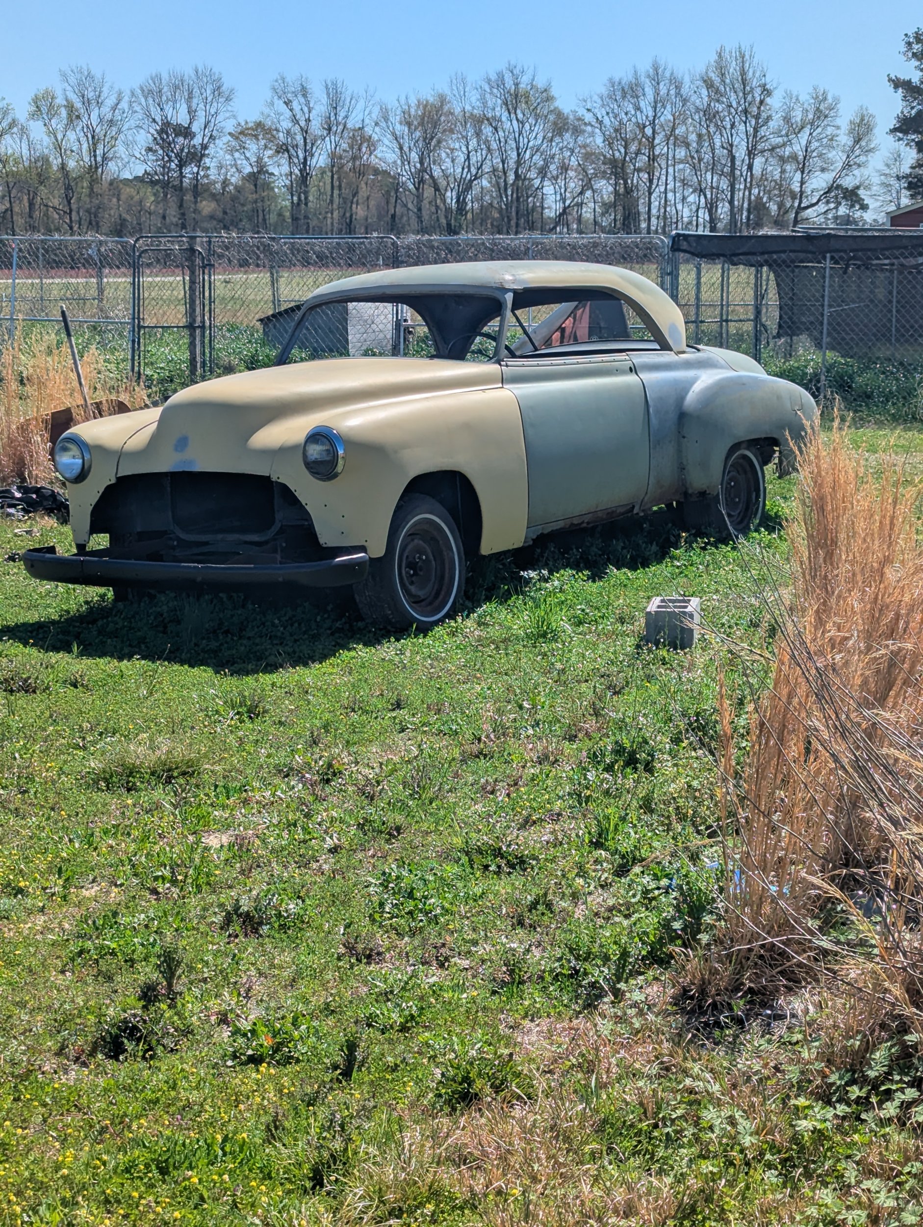

    Looks like ‘51-‘52 fenders and hood with ‘50 grill. I would just stick a ‘52 grill on it ( has teeth )
    As far as the frame/ suspension. It is literally Corvette suspension since it was used on the C1 Vettes. Upgrade to disc brakes with a kit from Speedway since you have the Huck brakes being a ‘50. Bendix drums from ‘51 on are much better.

    Yes the hood is welded, I'm glad to finally find someone that can help me to know what I have. I'm going into this blind,I have mostly all the original interior,got a decent 283 with a turbo 350. Gotta rebuild both .all the gl*** is in the trunk... The window gaskets are crazy expensive!! I also have a one piece windshield. Still need to figure out how to make it 12 v. And I have a brand new gas tank

    No sir,The Belair model started in 1950 I'm told.***le says 1950, it does have 51 fenders and hood but a 50 grill...kinda Frankenstein! Putting a 283/350 with a S10 4x4 rear end. Doing body work first,rockers and quarter panels

    the 51-2 fenders will not work with the 50 grille. the gravel pan between the bumper and the grille is different, and so are the front halves of the inner fenders, the part that is riveted on is different, the rest of the inner fenderwell is the same. there are only 2 reasons to keep the stock suspension, one, you are building it stock, and i can't think of the other one. they even make a bolt in MII front end if you are not a welder. I put a weld in MII in my 49 Coupe and it goes in pretty easy. it was one of the first big things I did to the car
    I had discs on the stock front end of my '49 sedan. even in good shape the steering ****s, and if you want to lower it you will probably bottom out the suspension on a regular basis. that was my experience anyway.
