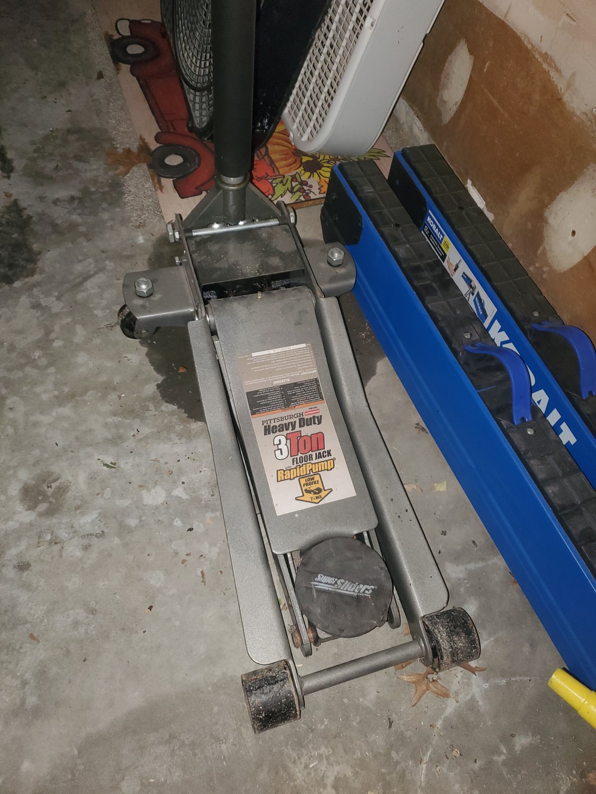

    Just for the hell of it, can you post up a picture of the type of jack that you have, that supposedly wont reach the differential housing, and when you post the picture, hit the ****on that says full image. I am curious, just to see what kind of jack you are trying to use.

    Here is the jack I am using. The image is a little too large since my phone takes those nice, high resolution pictures by default. Sorry about that.
    I should have mentioned, for context, that the car has been lowered in the back a few inches by a previous owner. That's the biggest part shutting me down I think, but if the frame crossmember in the rear is stout enough, I wanted to try and lift both rear wheels to keep from twisting the frame too much.

    I always lifted on the pumpkin and front cross member

    What I've been doing lately just for safety let's use the floor jack to go up just far enough so that you feel you're putting stress on the rear crossmember and then use two bottle jacks on the corners and Jack them alternately to get it up where you want and then stick jack stands next to the bottle jacks and let it down.. I usually leave the bottle Jack's in place

    If your car is really low you will need 2 jacks. One to raise the frame, the other to lift the rear.

    Not sure what your jack handle looks like, but I stick a bar in the end of mine if it won't clear the bumper. Works really well on pickup trucks.
    OldManBritton95 likes this.
  12. If the rear (bumper, etc.) is too low to get enough swing on the jack handle to get even a fraction of an inch of raise, these are a couple of 'tricks' you can try. The first one is a pair of 2 x 6 hunks about a foot long-ish. Lay those on the shop floor right in front of the rear tires and drive up on them. That usually gives you just enough swing to get 'er started up. The second thing that has worked for me is to roll the car with the tail end out of the shop/garage door with the tires not quite off the slab but close. The driveway is usually an inch or more lower than the slab. (In my case, the driveway has a slight slope so I have even more jack-handle clearance.)
    A third 'trick' is to jack up the bumper about 2 more inches and wedge enough blocks of 2 x 4 to just hold the bumper in the slightly raised position. Then reposition the floor jack under the diff. Again, you should have enough swing with the jack handle.
    Approach the task as "I can't raise the car so what can I raise so I can raise the car".
