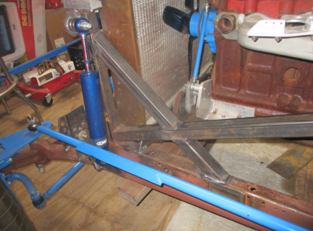

  13. I get to kill two birds with out stone...
    This the reinforce my draglink which would be similar to a tie rod reinforcement, I have seen built with rebar, solid stock, pipe etc...
    I had to reinforce mine because the longest piece of steel tie rod material Speedway sells was too short and I had to splice a couple together.
    I beveled the tie rod material, threaded a bolt in (sleeved) to tie them together T.I.G. welded them and cut and T.I.G.ed a piece of 2" angle to the outside.
    s.e.charles likes this.
