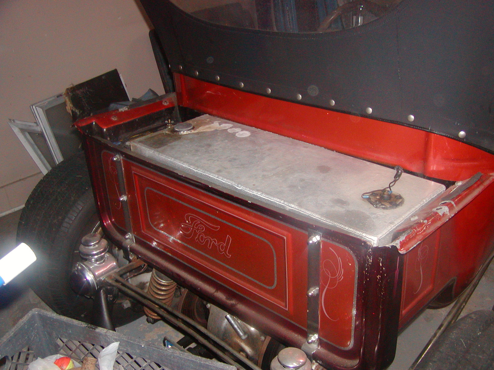

    I've thought about the safety issue while filling that 12 gallon spun aluminum tank sitting on the back of my T-Bucket.
    I currently have my T-Bucket torn down for new paint and interior. Although i love the looks of the spun aluminum fuel tank i'm replacing it with a fuel cell. Haven't decided if i'll make a pickup bed or go with a small flatbed. The battery will stay under the seat. I'll be replacing the electric fuel pump with a mechanical pump simply because i like the simplicity of a mechanical pump.
    I'll also extend the back of the frame to give the tank a little protection.
