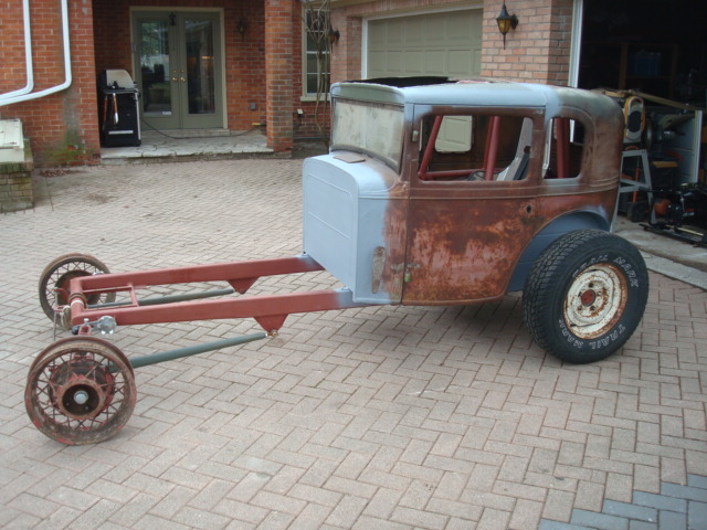

    I posted elsewhere that we are building a Bantam altered powered by a 261 six cylinder. We have followed threads regarding nostalgia dragsters, etc religiously and now I feel that perhaps this is the right place to ask some questions particularly involving safety gear. We want to be able to run at most legitimate tracks so meeting the NHRA safety rules seems to just about cover it. I have scoured their rule book and read what I could on-line, but every thing sounds like it was written by a team of lawyers and not necessarily pertaining to nostalgia racers running 12 seconds.
    Mention has been made about wearing street clothes only, is this true everywhere or is a race suit necessary?
    I currently have socks, gloves and a head sock. Are these sufficient?
    I have a new Bell open face helmet, do I need a face shield?
    The battery is mounted in a Taylor box secured to the frame behind the driver’s seat. Does this suffice in lieu of a firewall?
    We are running a 9” Ford with 11”x 2” brakes. Any opinion on stopping ability?
    We are using a Kirkey aluminum seat with head supports. The five point hitch holds you securely into the seat. The cage has areas to the left and right of the head supports that a helmet would fit through. The rule book talks of using a net in open areas, we were going to weld in cross braces, but I don’t want to. Are the head braces sufficient?
    Although the Bantam has an open roof and no windows, there is a windshield which I would like to run. Opinions?
    Warren

    There are no separate rules for nostalgia cars unless you're running in the NHRA Heritage Series. I Agree with Squirrel that you'd fall into the Sportsman ET Series as far as safety rules go.
    To your specific questions:
    If you have a sealed metal firewall and floor you don't need a complete firesuit. But since you are only running a windshield (no side windows) and open top you'll need a helmet w/face shield, gloves, at least an SFI-1 jacket, and arm restraints. Helmet needs to be a Snell 2010 or later. If the firewall/floor isn't sealed metal, you'll need at least a SFI-15 firesuit.
    Only if the Taylor box is metal and sealed.
    Won't be a problem. Plenty of stopping power.
    Not sufficient. You need 1" dia. horizontal helmet bars welded in.
    Some kind of wind deflector is required & the windshield would qualify, so I'd run it.
    I think your project looks good. The roll cage especially. I think with the "altered" style and Six Banger, you'll find the car a lot of fun.
    And remember, as typo4l noted, these are just the minimum safety rules. There isn't any reason you can't go further to make the car safer for you and everyone else at the track. Also, don't be surprised to have the car picked apart a little the first time you take it to the track. The tech officials are just looking out for your best interest.
    Have you been to your local dragstrip at all lately? You can always talk to the tech guys there too.

    Trust me guys, we are not cheaping out, if anything, I want to go beyond the basic rules, just having a bit of trouble understanding them. The Taylor box is metal and sealed. In a pinch, you can climb over the cage and get out the opening doors but I expect to climb in from the top. I have already talked to a company that makes approved firesuits and will get one that fits my figure. My partner is bending up the helmet bars, just didn't want to add any more weight then necessary. I will try to get ahold of someone at NHRA before we progress too far.
    Thanks for the input

    Go to NHRA.com and go to reunions. The rules for the Heritage series is in there. That's what I used to pass tech at Bowling Green Hot Rod reunion and it breezed right through tech. Make sure your dates are good on your safety equipment. Love to see the inline motor. Practice getting out of the roof blindfolded. When shit goes bad you can't be over prepared.

    I run the same basic car ( bantam coupe , 292 chev, open roof, etc) you have to have arm restraints because it is an open car,jacket only because I have floor boards covering the trans. you don`t say what trans so scattershield may be in order if it`s a manual one. even though I only run 11`s, I have hans, neck collar gloves and shoes so I can run up to 9.99 with no probs. you can`t go wrong over building the car

    Back to the original question, I see nothing wrong with the basic car except you will need helmet bars, cage padding( which has to be sfi stamped) battery disconnect and a tailite. My opinion you might think about adding two 1 3/8 .118 wall bars from firewall cage to front of frame. really stiffens the frame. The commercialy available roll bar padding can be formed by boiling in water Takes awhile

    Sounds like you will be running 11.99 and slower. So.. Snell rated helmet. If not running a winshield you will need eye protection.... , seat belt- in this case probably a harness since the car did not come with belts. Battery hold down and locate outside of drivers cockpit. and Battery cutoff switch, cooling system over flow can , drive shaft loop. Two wheel brakes are ok but 4 wheel are recommended.
    If this car has doors the inside of the doors should have some sheet metal as an inner panel . need approved fire jacket for et in this case Jegs or Summit sells theses all day long you are running and long pants jeans ok.
    You'll need a single tail light as well
    Attached are the general regs....
