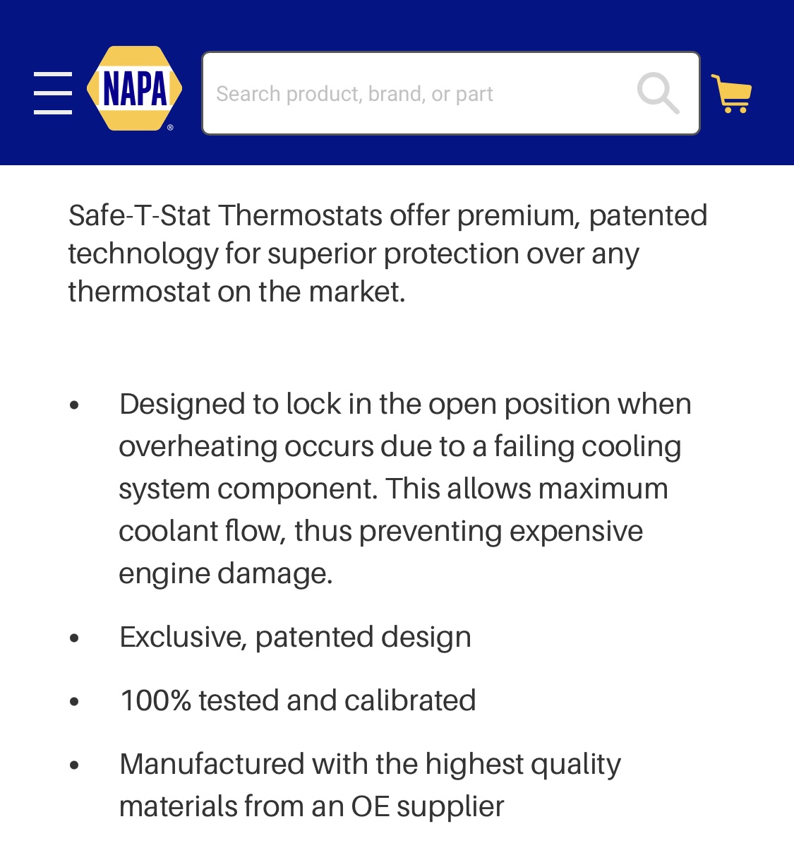

    Im in the process of putting my engine back together now that the oil pan has been put back, and id like to order the final few things from Napa so my question before ordering is, which is better a safety thermostat or standard thermostat. Its for a 1950 Cadillac 331 v8. Thanks, Joshua

    Safe-T-Stat is a brand name that NAPA sells

    When I put the new engine in my Ford, I installed a set of the thermostats that would open up if they fail (I believe there are versions that will fail closed). Is this what you mean? As I remember, these were a specialty item I had to order online.
    Anyway, that was in 2016 and I had forgotten all about it until now. They have performed flawlessly since.

    I think it maybe one that fails open? That’s was my thoughts reading the post.
    Maybe like Jim said, just what NAPA sells?

    yea thats it, I saw it and was also thinking what is this. I just didn't know if anyone felt these were better than a regular one
