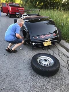

    On the way home a date late one night on a back road in our extremely rural county when I see s an E type Jag roadster sitting on three wheels on the shoulder. Stopped to offer help and the driver said they lost a knockoff. Found the wheel but still looking for the nut. Couldn't stay to help as I was already past my curfew. Don't know if the ever found it. Safety wire sounds like a good idea.

    Sure is. We were going out for supper, when I rolled up to the stop sign, the car made a funny "clunk" noise. My wife turned to me and said, "What was that?". At that moment, the back of the car dropped, and I said to her, "Probably that" as the wheel and tire p***ed us and bounced up over a curb into the cornfield about 50 yards. Jack? What jack? Lead hammer? What lead hammer? I kept both in the trunk after that...
