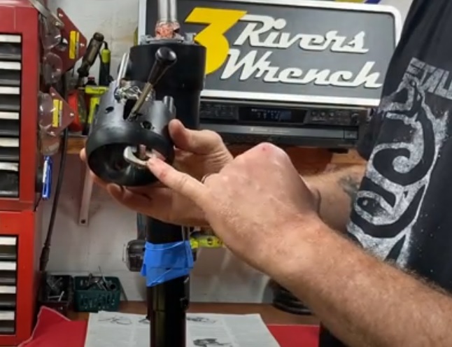

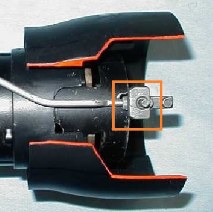

  8. johnfin
    Joined: Apr 11, 2008
    Posts: 286
    johnfin
    from Florida
    My ignition switch rod tip looks different then the one in the article. How does the rack actuator lock into the rod tip. Does tilt and pins have to come apart to connect the rod to the rack? Dormans sells the pot metal rack piece so i ***ume it is easy to replace.

  10. 19Eddy30
    Joined: Mar 27, 2011
    Posts: 4,483
    19Eddy30
    from VA
    Is that the Lock for steering wheel when ignition off key out?
    If so Yes , it's design to come in through the backside towards the steering wheel.
    I'm thinking the reason why making it harder for a person to steal the vehicle even if they remove the steering wheel

  12. johnfin
    Posts: 286
    johnfin
    from Florida
    Its not the steering wheel lock, its the rod for the ignition switch.

  15. johnfin
    Posts: 286
    johnfin
    from Florida
    In the ***embly video he shows the connection of the rack to rod. My rod came out ***embled so why cant it go back in ***embled? Be nice if the cover had an access cover or could be pulled back. Mine does not.

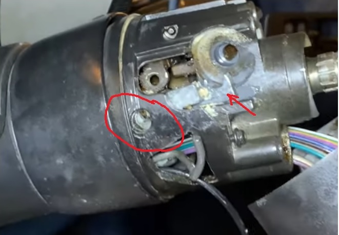

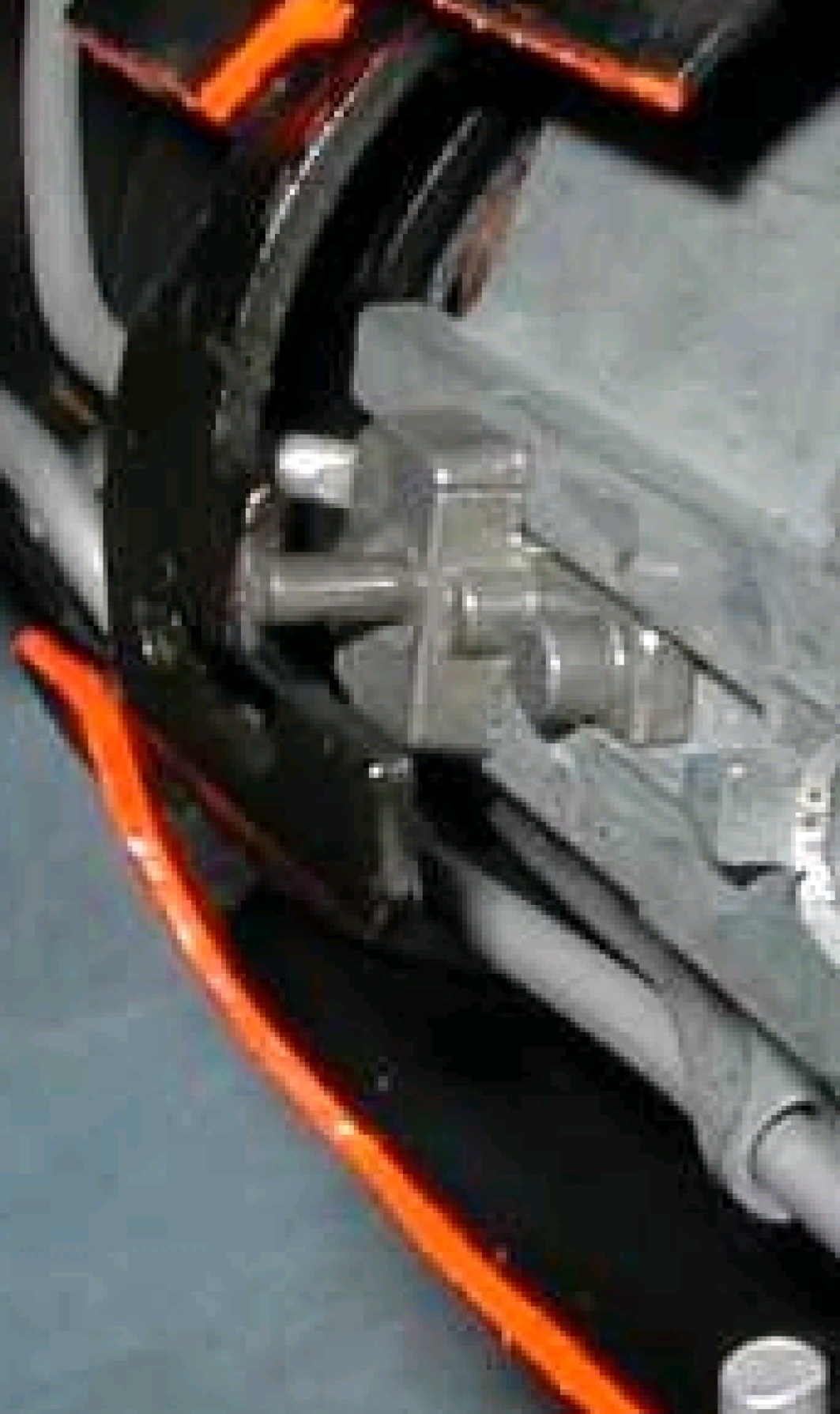

  16. johnfin
    Posts: 286
    johnfin
    from Florida
    Here is another pic from a video. Does the tilt pin go thru the rack piece?

  17. 19Eddy30
    Posts: 4,483
    19Eddy30
    from VA
    If tilt pin not Taped to jack out ,
    Center punch , then tap to #6 or #8
    Machine screw , My post #6 is how I pulled pins out,
    It took me 3hrs start to finish , column was in vehicle , took little time to look @ wear patterns to figure out how to install some of the parts

  20. johnfin
    Posts: 286
    johnfin
    from Florida
    I have noticed that there are different rod end. Some have a wing piece on the tip. Anyone notice this?
  21. justpassinthru
    Joined: Jul 23, 2010
    Posts: 643
    justpassinthru
    According to steeringcolumnservices.com, that is a mid 1980s column with that type of actuator rod.
    If you go to their website, every part has photos to identify what style you have, to get what you need to repair.
    Bill
