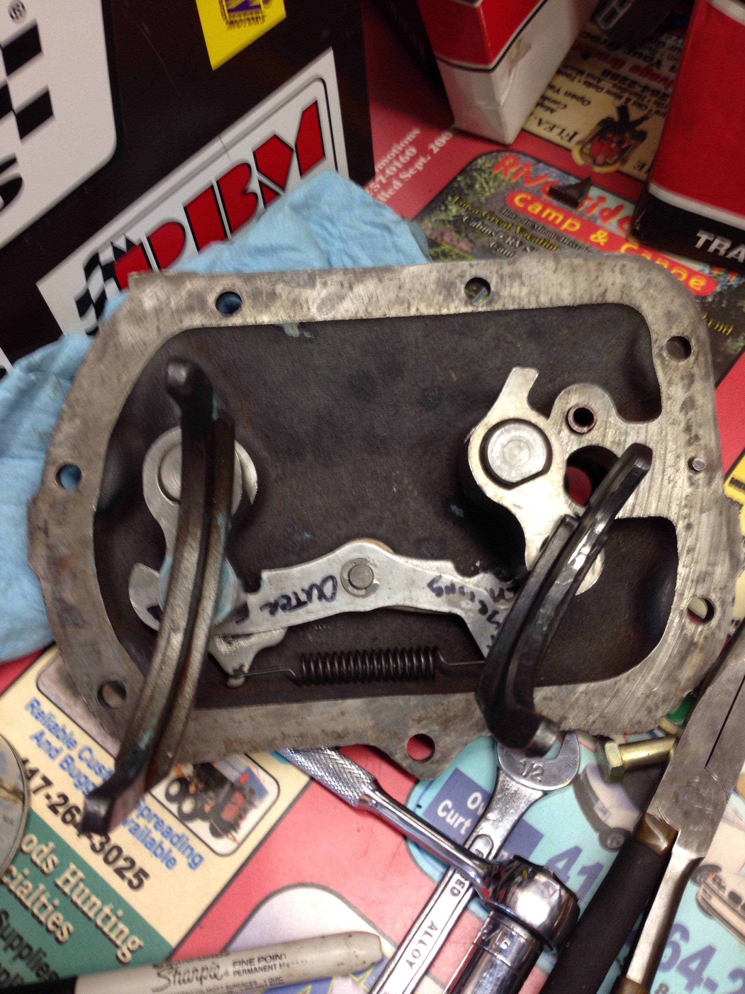

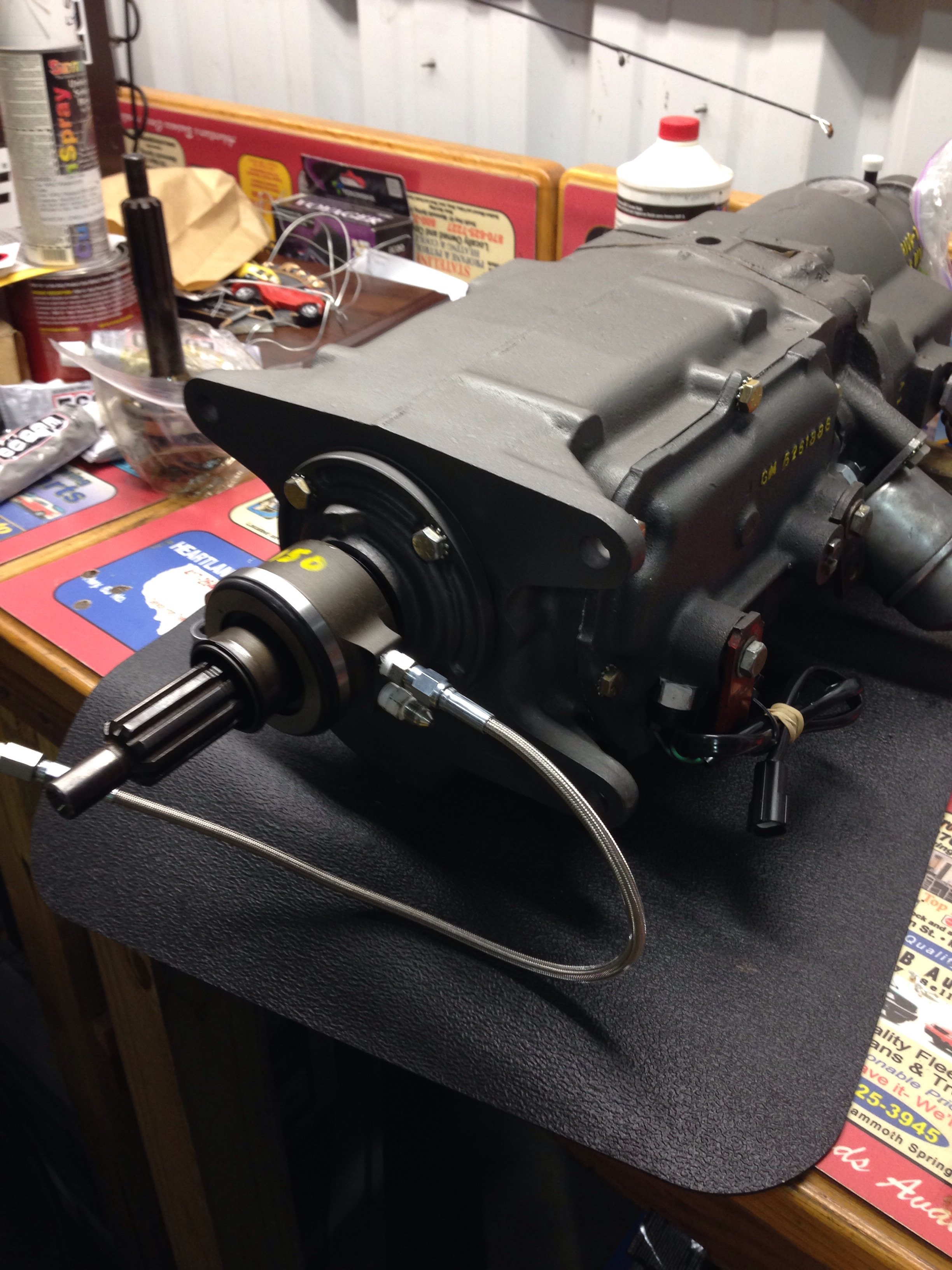

    The side cover on one I just converted to a 4 speed overdrive , used a screw in style back up switch too, it had a push type "ball" that Activates backup lights, but no rod, there are quite a few variations though, most the later 70's style 7 bolt side covers offer a neutral safety & back up switches. Be an easy & safe swap to gain a neutral safety switch to boot! Hope this helps. image.jpg

    very nice flux capacitor!
    but I need to stick with OEM. The car is low mileage and very, very original

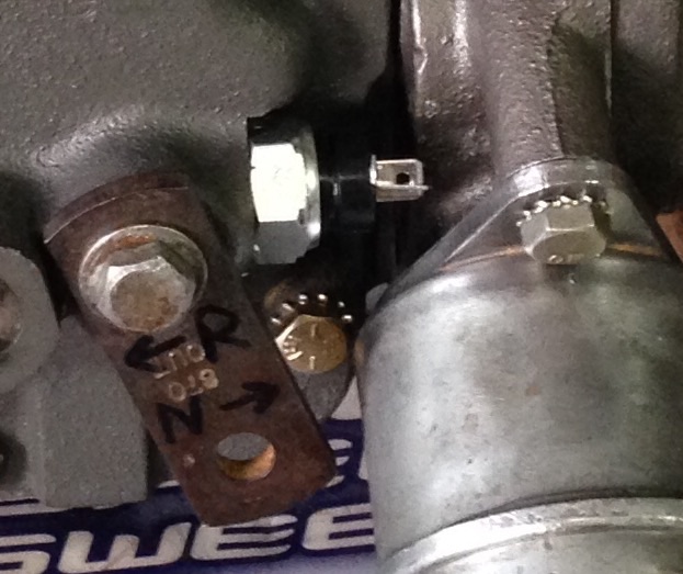

  5. here's a quick pick of an early trans....from a Motor's manual chevy 4 sp.jpg

    YES! that is the linkage I need.
    now to find it.
    I have searched long and hard all over the internet and in catalogs, but to no avail.

    Yeah that's one to make for sure. Got any old thin nickel stick weld rod? It won't rust under there. Looks like 1/8 by the picture. Have at it. Only your hair dresser will know for sure...

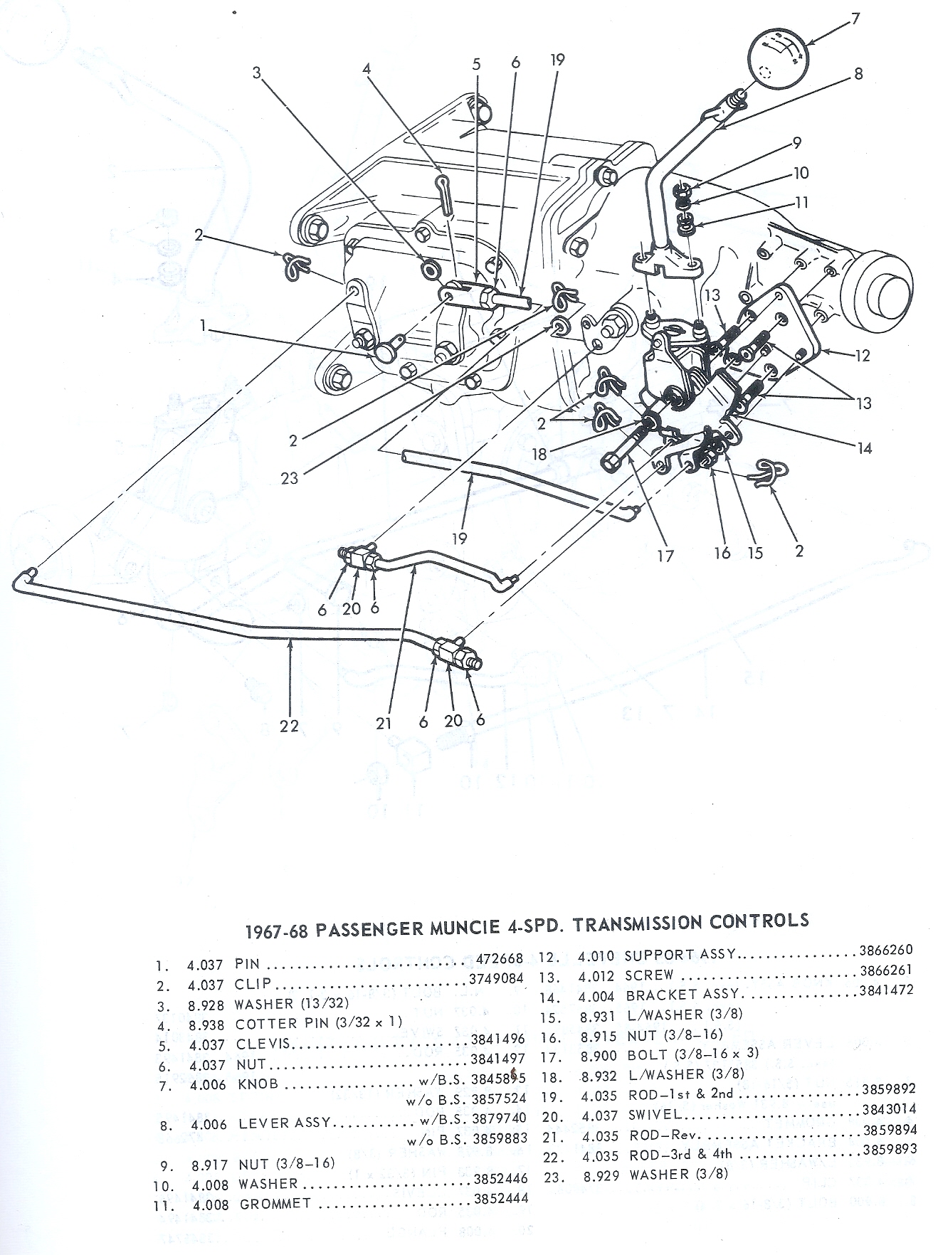

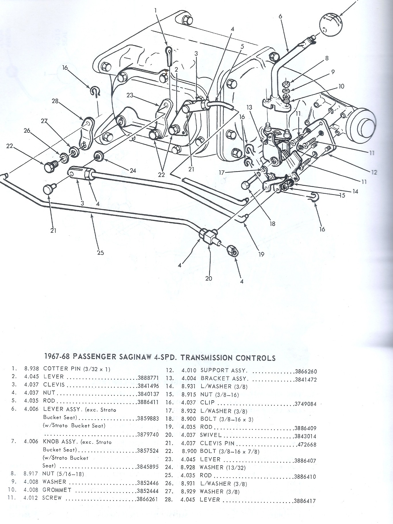

  17. my best factory manual doesn't even show it on any trans....you can see the hole in the shifter plate.... sag 4sp.jpg muncie 4 sp.jpg

    looks like we will have to fab one
