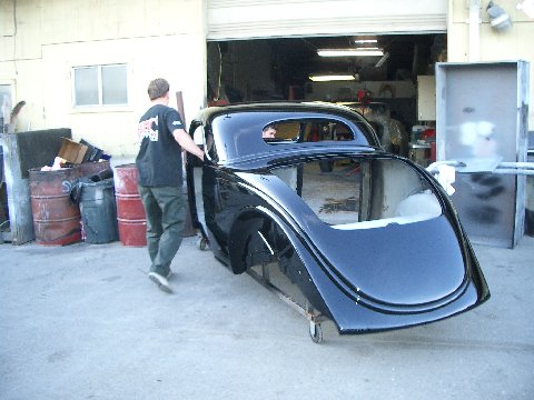

    Hammits 36 is Painted and going back together.
    We did all the prep work here and gave a few pieces at a time ready to paint (500 grit) to My Favorite painter Jessie Cruz who now works for Don Orosco's private shop about 10 miles from us.
    Orosco has been very cool to let us use his booth after Jessie's normal work days.
    After each part is brought back to our shop and the boy's and I Block it in 800,1200,1500,2000, then Buff.
    What alot of work doing such a little car, alot of surface area.
    We have had the chassis done and Body back on it for about a month, wiring and inner panels (0.50 aluminum) for upulstery and stereo shit going in too.
    Its going together pretty well and have finished grill,fenders, doors hung on our walls waiting till the smoke clears to bolt them on, Hard to wait but why stumble over painted stuff more then we have to.
