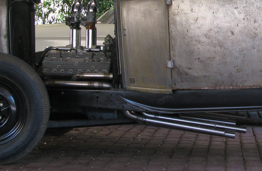

  9. Thanks for the kind words, its nice to know folk have been looking at the build up pages, not a lot lot of progress lately but its still moving along slowly.
    It took a lot of time and thought but its worked out real well. The bottom of the oval is flush with the bottom of the ch***is and the flexible "bellows" mean there should be no rattles.
    The whole system has come up good, full 3" all the way except for the oval section which should flow well anyway, and acts as a big balance pipe to help quieten it all down.

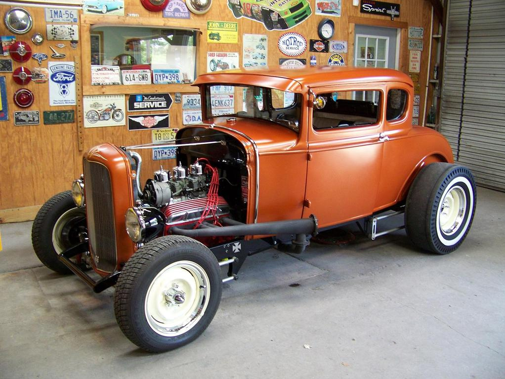

  12. Ok here we go...I just finsihed them up this evening. I will coat them with something siver in color and I would like to coat the tips in black. I want to thank everyone for posting pictures and comments. You guys here on the HAMB are a big help and true inspiration to me. Please leave comments good or bad...I can handle it. I think they look cool, my idea was to have something different than everyone else. I bought the speedway kit for a SBC I ordered extra cones and 4 turnouts from JEGS. I think I have around $300 in the whole set.[​IMG]

    those look great, good foresight to know they would look cool that way
