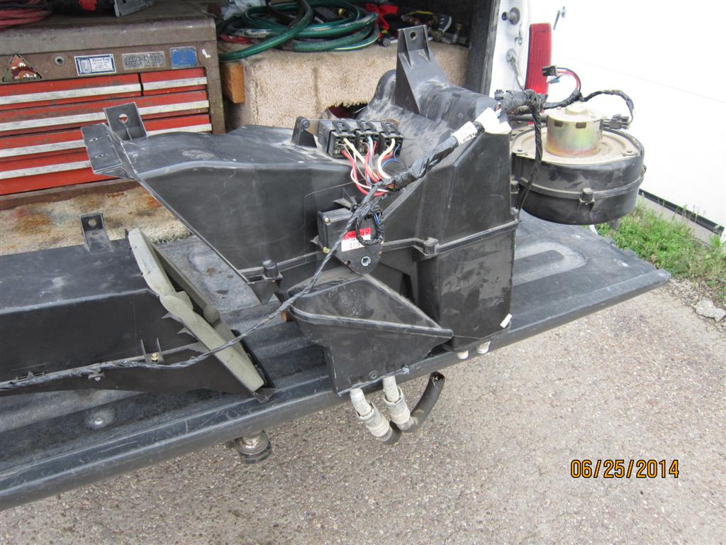

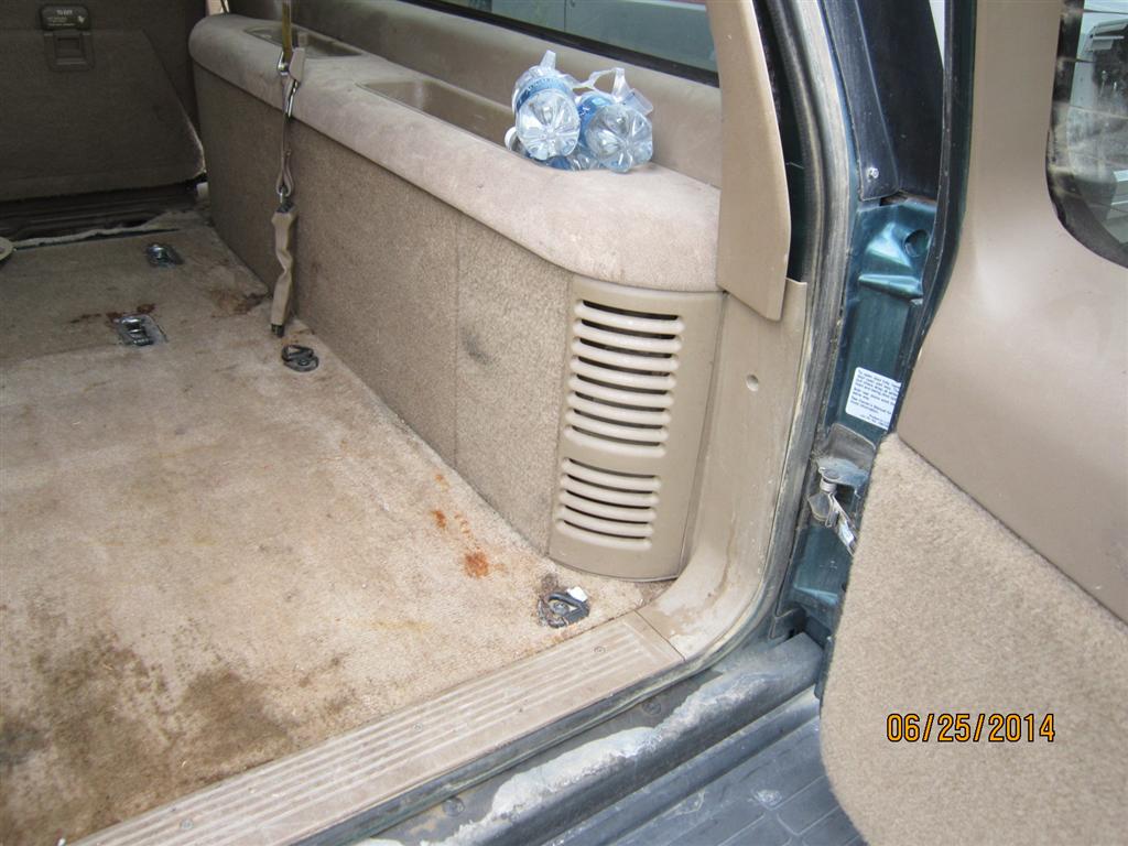

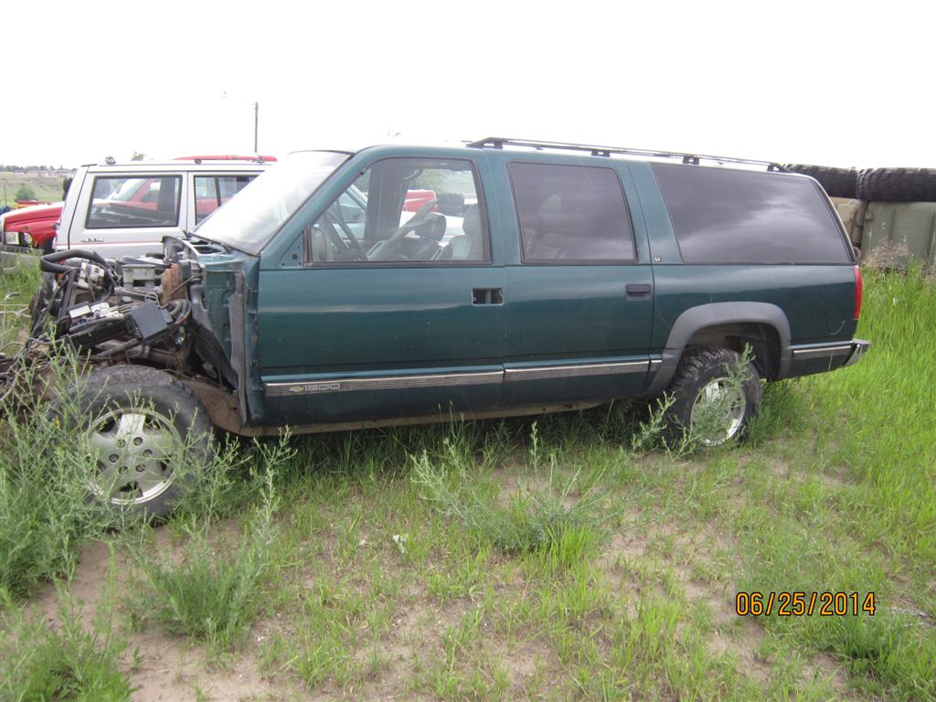

    Based on some of your great comments, I went out yesterday afternoon and removed the rear reciever/heater/blower unit from a '94 Suburban. This unit is not compact, but is very easy to remove. It has only one duct opening for shooting hot or cold air to the vents in the Suburban overhead. It appears to be well designed, but because the hoses and A/C lines point straight down, does not really lend itself to underdash installation. (Rotating the unit to re-orient the tubes and hoses would not work under the dash.)
    Since I have only parking meter money and an hour invested, there is no waste if I decide to use something else....but, it appears that the Suburban rear unit might work OK in the trunk of my shoebox. Last pic shows the unit sitting in the trunk of my '50 coupe. Stay tuned.
    (And keep the comments, experienced reports coming!!) Would appreciate a wiring diagram for this unit if someone knows this sort of stuff and how it works.

    This is the unit I took out of conversion van! $12
    Ago

    I think that's the same one I have.

    great idea to trunk mount the unit!
  23. daddio211
    Joined: Aug 26, 2008
    Posts: 6,012
    daddio211
    Ask @da34guy about trunk mounting. He tried it a few years back and it didn't work well at all. Can't remember the specifics, but it ended up being a waste of time and money.

    Yes , Gm used a solenoid that attached to the carb that was wired to the compressor circuit when the compressor turned on it pushed out a adjustable piece it looked exactly like the idle stop solenoid but on the front of the carb linkage , the GM BOPC cars had them in the 1970's its called a A/C fast idle servo , but you can buy a kit from Holley or edelbrock that includes the brackets( FAst idle solenoid)
  29. stimpy
    Joined: Apr 16, 2006
    Posts: 3,546
    stimpy
    and Pt cruisers as its the same driveline , wife had problems with hers loosing refridgerant all the time till they worked on it at the dealer . ( compressor and hoses were replaced )
  30. stimpy
    Posts: 3,546
    stimpy
    was he pulling the air from the trunk or pulling it from the cabin ?? as the trunk would be excessively hot as they are not insulated like the cabin is , also I think I would want to pull the air from the cabin as the trunk could see some Co infiltration from the exhaust
