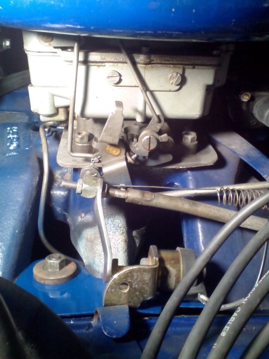

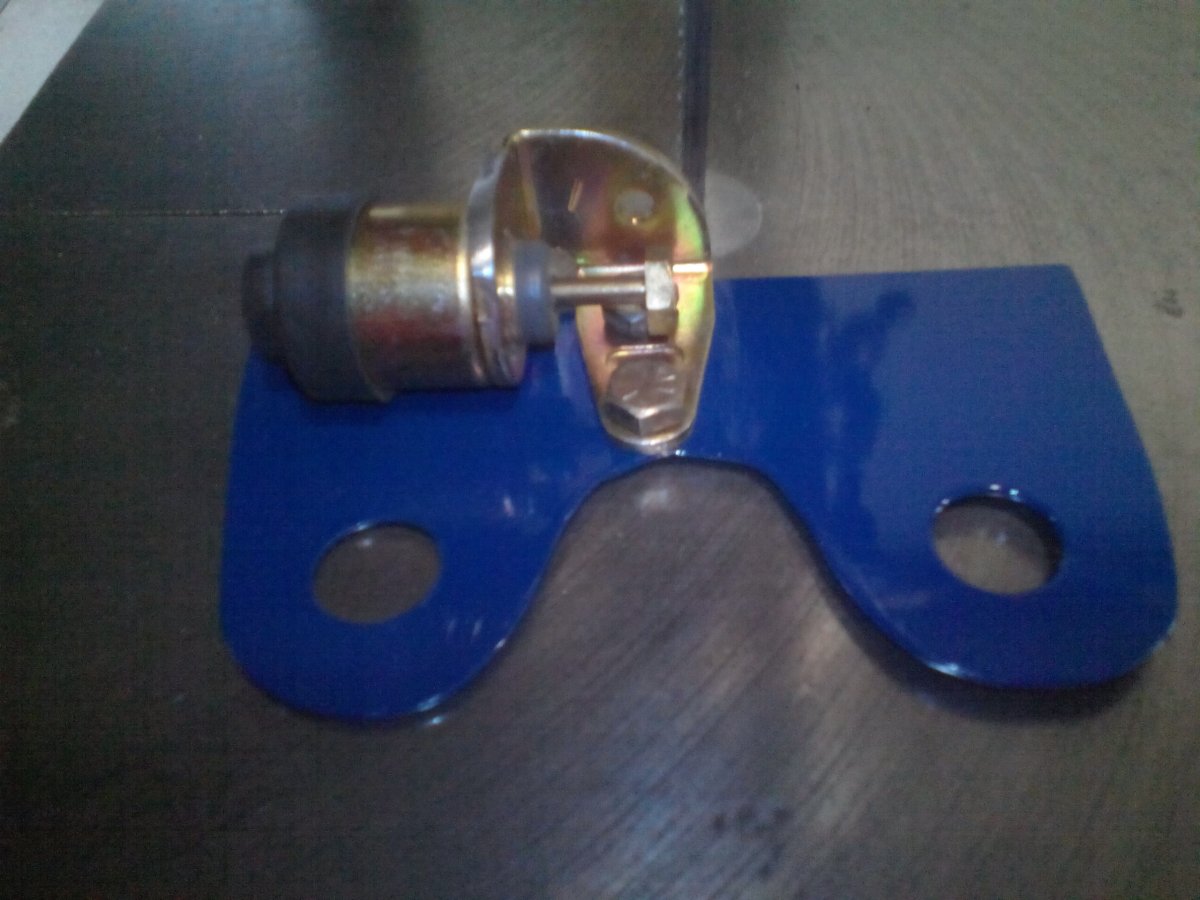

  24. DavidP
    Joined: Sep 6, 2008
    Posts: 53
    DavidP
    For anyone considering a similar solenoid installation to up the idle when the A/C kicks in ... this is the bracket and approach I used for a Carter WCFB carb ... with a lot of linkage in the way ... its tighter than it looks ...
