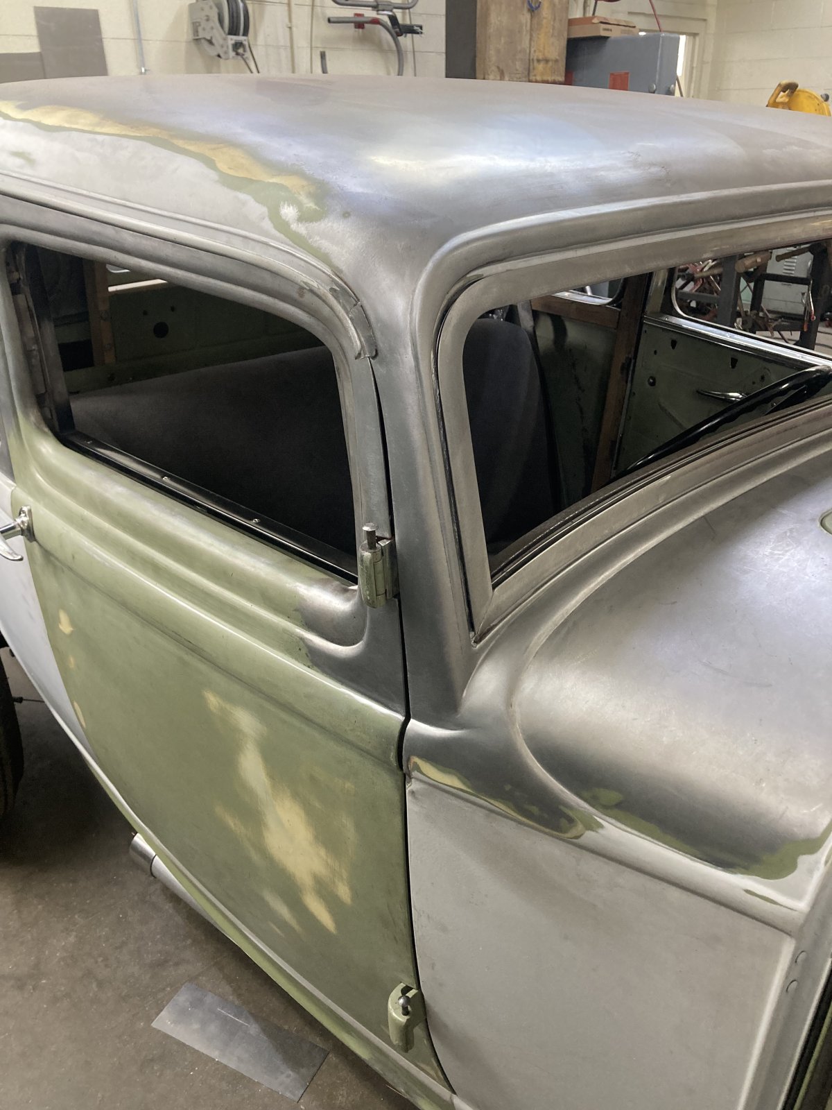

    Have spent ages going back and forth through this thread checking everything out but 32 5 windows always get my attention. I gather that's a hogshead bellhousing with a Dwight Bond style adapter up front of the T-5.
    Any details on the chop, using a Walden insert means the A pillar has to be leaned back?

    Correct on the bellhousing.
    The chop is around 3.5” in the front and 3” in the back. Maybe a little more. None of us at the shop are really fans of chops where the roof is stretched, so the a-pillars were slightly leaned back.

    I’ve looked at this coupe a hundred times and you’ve just nailed it. It doesn’t have “the look “ because of one thing but all the things.
    Wheel base, tire size, chop it just all works together to really nail that “big deuce “ model cl***ic look.
    The slightly laid back A pillars , it’s all just on the money.

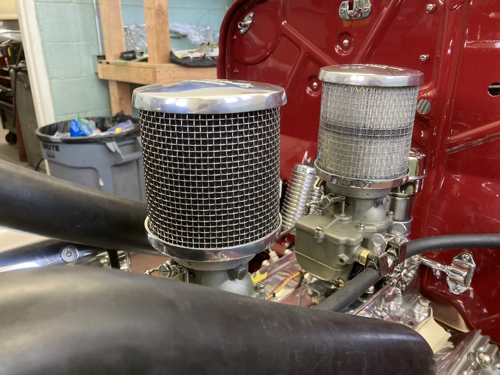

    There’s way more to this build than you let on. It’s hard to make something look
    simple, it’s so beautifully executed. How did you get the exhaust manifolds to seal
    to the block? I don’t see gaskets……Congrats on such a fine 32.

    Thank you! I believe we used the copper crush-style gaskets from Speedway.

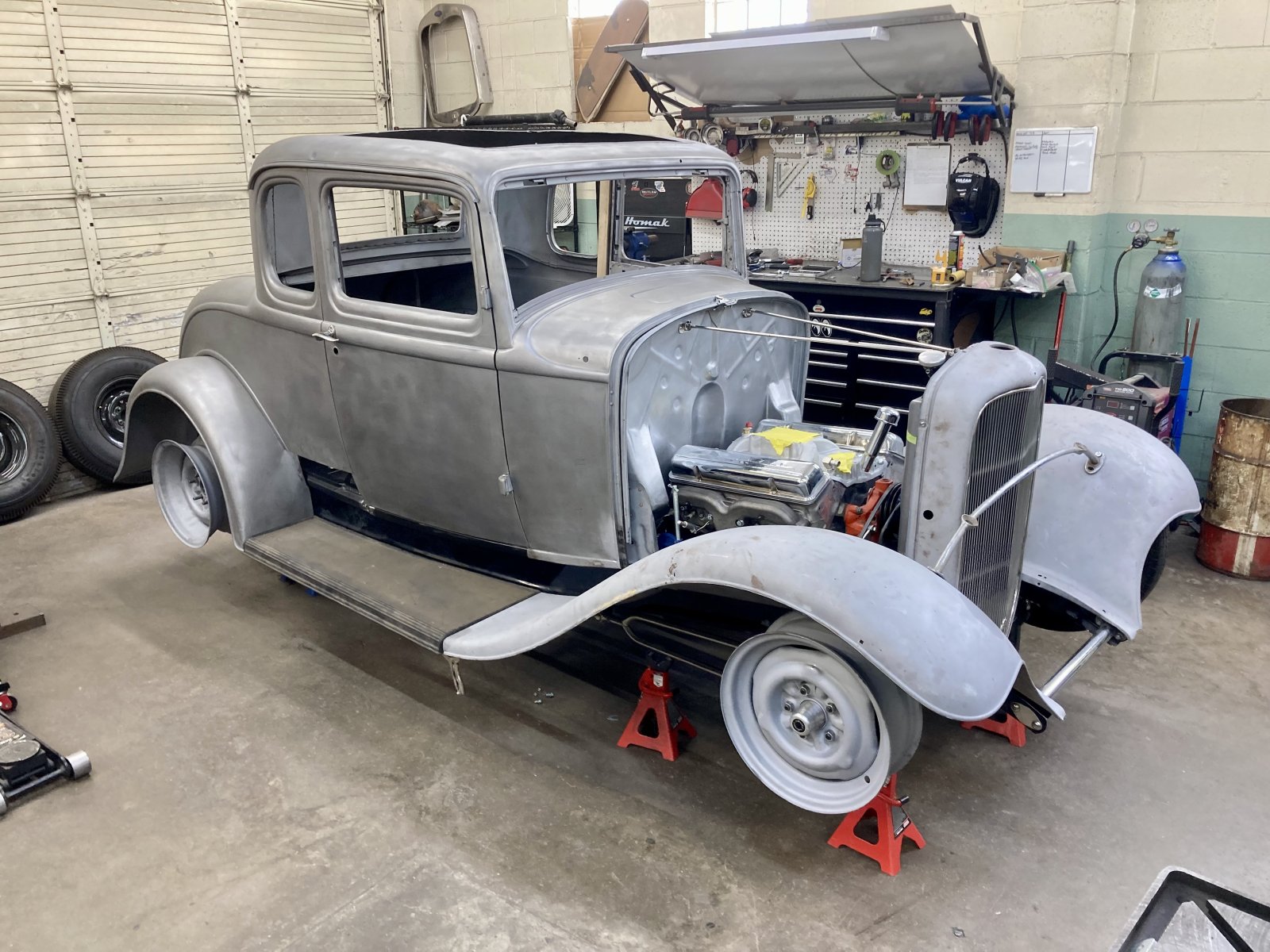

    We’re getting started on Sam’s second coupe too…which is actually his first, or third?
    Before the red car, he had another chopped 5w on a kinda home built P&J style ch***is. We did a little work on it here and there, but it was a “finished” car other than paint. Halfway through building the red one, Sam decided to get this one painted too. Once they stripped all of the primer and body filler off of it though, we found out how bad the sheetmetal was. Bad enough that we ended up finding him another body, in the form of a full fendered street rod from the ‘80’s. It had a horrible ch***is under it. So we now have the ch***is and drivetrain from that first car, with the body and fenders of the new car. That’s what’s happening in the picture on the first page with 3 coupes in a row. The other body and ch***is have been put to the side for now. We’ve put a floor and subrails in the new one and a couple patch panels. The fenders will need a little work too. It’s also going to get a chop, but we haven’t landed on how much just yet. And will be keeping the roof insert.

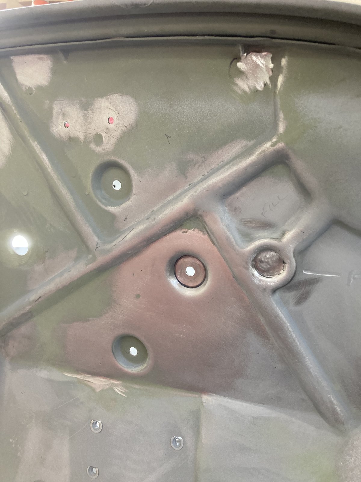

    Some fabrication stuff. This firewall wasn’t in horrible shape but had a lot of extra holes, and some factory ones we wouldn’t be using. It had a master cylinder bolted to the firewall at some point and this dimple was missing. It didn’t look right at all without it so we whipped up a simple die and made a new one.

    Some of our metal work on the chop. We’ve found it easier to cut the a-pillar skin off when chopping so we can weld up all the inner structure, then make a new skin that fits just right and gets rid of the factory leaded seam at the top.
