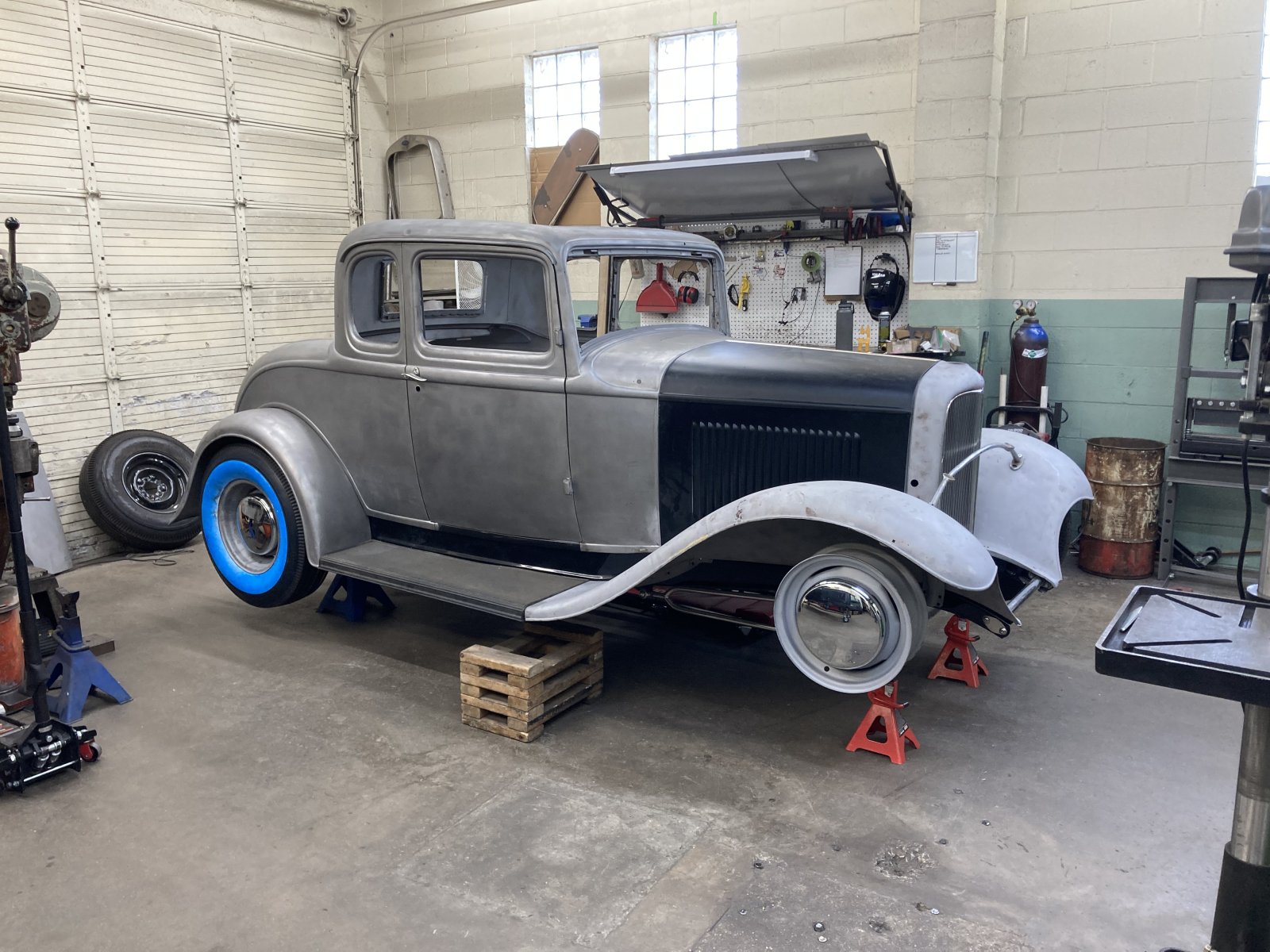

    We've gotten a lot of stuff done on coupe #2. Saving the chop for last.

  7. alchemy
    Joined: Sep 27, 2002
    Posts: 23,467
    alchemy
    Are those real live Buick rims on Merc centers?
    Anderson likes this.
  8. Anderson
    Joined: Jan 27, 2003
    Posts: 7,558
    Anderson
    This car was small Ford bolt pattern already and we’re not changing much on the ch***is. So we found some ‘60’s Ford wheels and used them as-is on the front, then did get Buick hoops for the back and reversed them on the later Ford centers. The rear end is pretty narrow, so they fit well under the fender. The caps are aftermarket made to fit these later wheels.

  9. alchemy
    Posts: 23,467
    alchemy
    Gives the cl***ic look.
