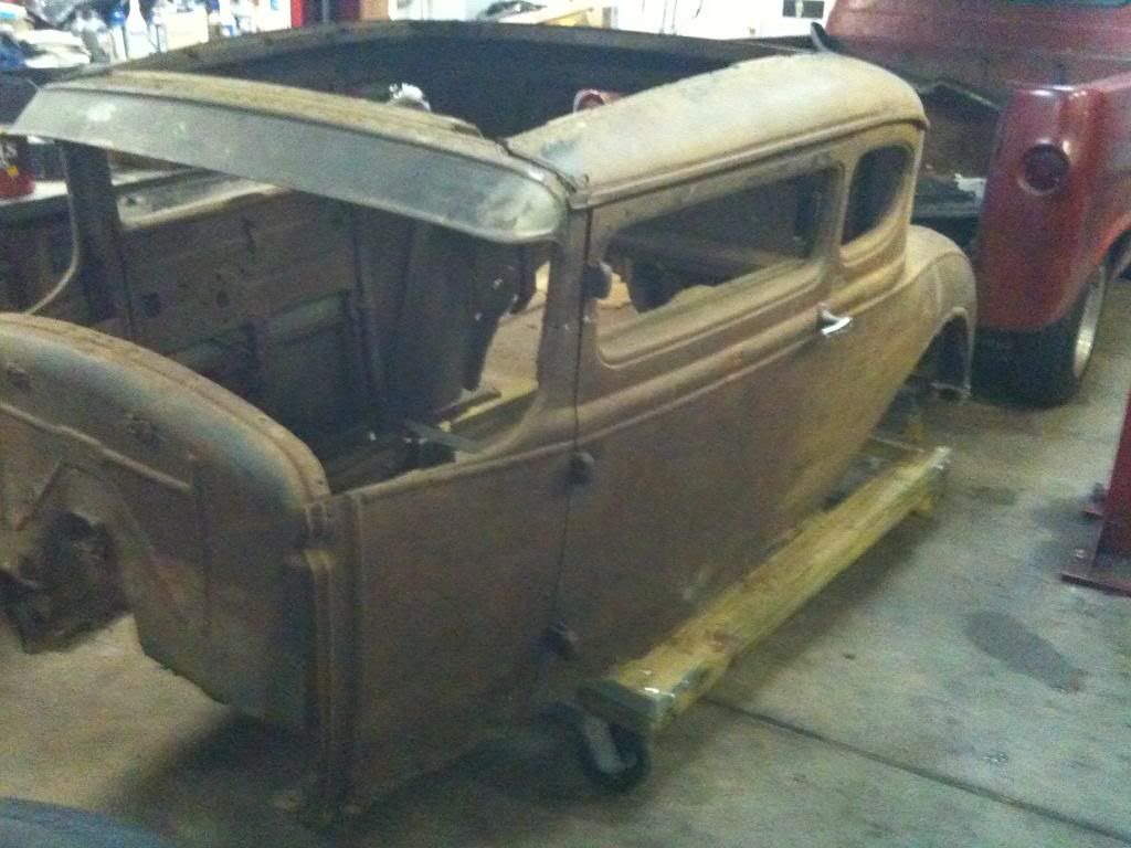

    I'm going to start blasting my '31 coupe as start to do patchs and fix the body but I have a few questions first
    -I know pressurized is the best kind of sand blaster but whats the best brand, best place to buy one and best deal as I'm not looking to spend a ton of money right now
    -how about the harbor freight 110lb sand blaster for $150, I dont like most of the harbor freight stuff but I did try their cheap $20 gravity feed blaster gun and that worked well but would take months to do the whole car so I want something that'll get the job done fairly quick
    thanks!
