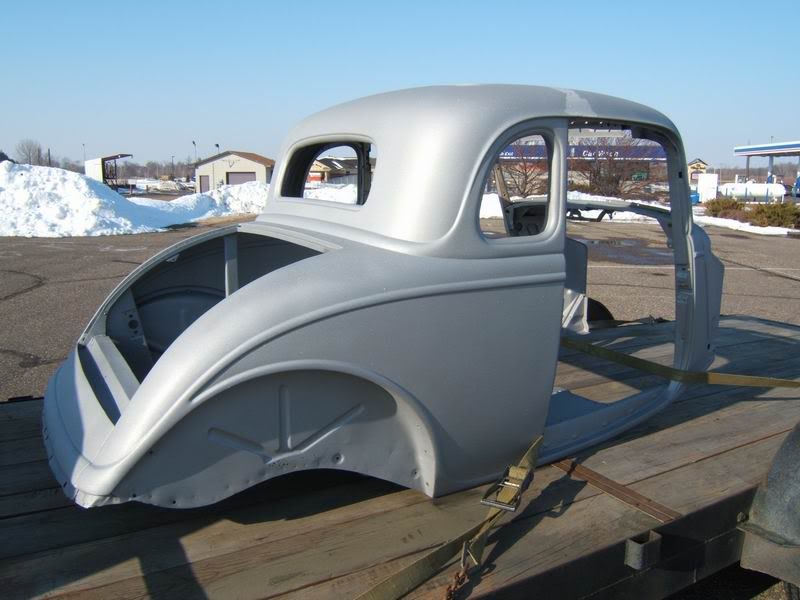

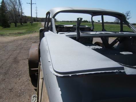

    I'm probably swimming upstream here.........but I've been blasting old car sheetmetal for years with silica sand. I have a pressure pot blaster set at about 110 psi. Have never warped anything except a Camaro hood with about an inch of paint on it. I do all my own bodywork after blasting, so I would know if it warped. I have lots of room to blast and do not recover the sand.....not saying this will work for everyone, but it is possible to do. I don't see a problem using sand if you use common sense.........wear a respirator and goggles...my 2 cents

    i dont know what you all are talking about with sand....... i paid 150 to have my entire coupe and frame sand blasted....... took the guy about an hour, i watched him do it too...... not a single panel was warped blown through or in any shape way or form harmed.......

    Harbor freight has a sale this week. I think the 100lb pot is $100.Works great and holds a full 100lb bag of sand. Use 30 grit, works great. Be careful on flat panels, you WILL warp them. One problem though, is you will have a beach wherever you blast....I still do 2 months later...Watch out for sand silicosis. You must wear a respirator or face health issues down the road..Go for it!!!!!!!!!!!!!!!! I blasted my car in 4 hours. Did the dash, jambs, firewall and all the gard to get areas. I left the outer areas to strip mechanically with a DA.....Later

    Don't waste your time or money buying small blasting equipment. Your risk of damaging panels goes up due to their smaller effective blast zone.
    Automotive blasting is a process that requires m***ive amounts of patience. Being a rookie is your worst enemy because your eye is trained to see forward progress, which will cause you to focus on certain areas for too long. Everything is stacked against you in this case with the smaller units. You will have days, maybe even weeks into it and it still won't be as good as a professional who has a few hours into it. Not to mention a huge mess in your work space and in your ears. :)
    Remember, good work isn't cheap and cheap work isn't good!
    Those chiming in to say they had their frames or bodies blasted for 100 bucks should be worthless information to you. I would be willing to bet they missed multiple areas. Some of those areas maybe not that important, but some would definitely be crucial.
    Find someone who specializes in automotive blasting. You'll be glad you did.

    Have you tried DuPont Starblast? No silica in it. Doesn't fracture and dust like sand, so if you're recycling it, it gives consistent results for many p***es thru your blaster. It gives a finer texture than sand, but perfect for primer.
    I'm not sure how the current price is. We bought a 40,000 lb trailer load of it in 100# bags 10 or 12 yrs ago for about $3/bag. Sent our own tractor trailer to pick it up, so there would be hauling charges on top of that $3 otherwise. Back at that time, the Starblast was twice what we were paying for crushed granite blasting sand in similar quan***ies. Never have bought another bag of sand since then, and wouldn't use it if somebody gave it to me.
    I've never used it, but there's another blast media that will give similar results, that's made from crushed olivine. Olivine is a mineral that comes out of the ground just like sand. Can't remember the trade name on the product but any blast media supplier would know what it is. The Starblast is also a mineral product called staurolite. Its mainly mined in Florida. Both products are way more affordable than any sort of man-made media.
    All said, I'd also strongly recommend the OP get someone that knows what they're doing for the blasting. We've got a couple Clemco blasters and all the equipment to go with them, as well as compressors up to 1600 cfm, from the time when we were in the contracting business. I've blasted car frames, rear end housings, truck wheels and so forth for various projects, but there's no way in hell I'd attack a car body unless I'd first gone thru the full drill on 2 or 3 junkers to get the technique down.
    One big problem with trying to blast a body with a small rig is that they don't have nozzles with the right shape. They're all straight bore, which tends to separate the bulk of the media from the airstream. A venturi nozzle gives a very even distribution of the blast media across the air pattern, which greatly reduces the time required to blast a given part using otherwise identical equipment and air pressures. The more time you have to spend with sand pounding the metal, the greater the chance of warping. Full venturi type nozzles are usually made from cubic boron nitride, and pretty much last forever, but the nozzle itself costs upward of $1000, so its not something that's practical unless you're in the business.
