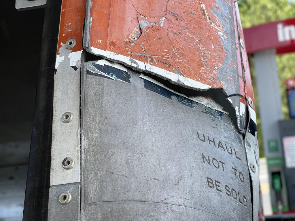

    I've been hunting for one of these vintage Uhaul rooftop boxes (or Car Top Carrier as Uhaul called them) for a few years now. I finally found one, and it's everything I hoped it would be:
    Except, broken. One of the corner pieces is cracked in half and bent badly. The four corners are all symmetrical, so I have two that could be used as patterns once the rivets are drilled out and the pieces removed.
    Originally these were die cast as one piece it looks like, but I'd be happy to do them in 2 or 3 pieces and weld/epoxy them together. I'm not going for concours perfection, just "good enough" from 10' away, and no aluminum HVAC tape, which is what's on there now.
    It seems like a pretty complex piece to sand cast, but I've done exactly zero sand casting before. I was hoping someone around here may have some input on the best way to go about it.

    form from aluminum sheet. 3003 .060 or .090. hammer on a bag to get close. Or make a wood buck since you need two, or just replace them all so they look the same. you'll find threads on forming metal bucks here. Fun project

    Current best idea is to cut off the mostly good ball corners and then just form a flat sheet to make the quarter round flat section, and rivet it all together.
