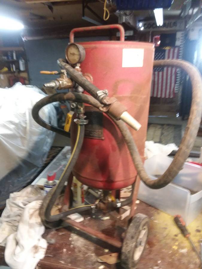

    Sorry I have to repopen this ten year old thread, because I have the same exact question.
    This is my "new" sandblaster, it's gravity fed as you can tell. However, it looks to be very heavy duty not just used for small parts.
    I'm reading through this thread that some would hate to sandblast an entire car with a gravity fed system. That is a pretty large hose, a lot of CFM. Worth restoring?

    don't push th feed hose on all the way, there is a small hole at the bottom of the tank where the feed hose goes on, it is meant to let some air into the feed hose, so the air moves the sand

    that is not a gravity feed blaster. that is a pressure pot. you could easily do a lot of rust removal with that. restore it, it is worth it.

    If you have a month of free time, by then you will quit the sandblasting. That compressor will run continuously and add moisture to the blaster, they are not meant to do what you are asking it to do. Look up the CFM on that compressor then what CFM you need to operate a pressure sandblaster.

    Not everyone has the room or money for a huge compressor so they have to do what they can do.
