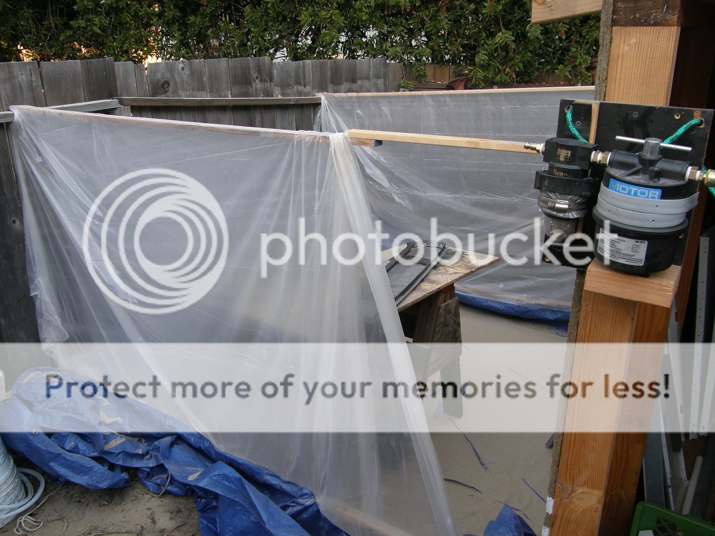

    The HF blast hood works fine for me. It's large enough that a respirator fits underneath. I wear coveralls and gloves and duct tape the sleeves and ankles. Keeps the sand out quite well.
    To cut down on the mess when blasting parts I just ran some strapping from the back of my tool shed to the fence. Stapled some of that cheap ($3 for 100' @ HD) painters bisquene to the strapping and layed a HF blue tarp on the ground. It keeps the sand pretty well confined. Sometimes I'll even scoop it up, filter it and reuse it. Anyhow, it works for me!
