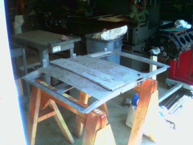

    All,
    Like the ***le states, how clean does the metal need to be for gray epoxy? Is this good enough?
    or does it need to be bare-bare....clean?
    Thanks!

    The great thing about sandblasting is it gets the rust out of the pits. Sandpaper just rides on the surface.
    Why would you do the job halfway? It seems you blasted the rust off the surface, but left it in the pits.

    That's like asking a surgeon, how sterile does the knife need to be to perform the operation?
    Failure to clean the rust will just mean you left behind the cancer you were hoping to remove.

    Yes.
    What I see is rusty.

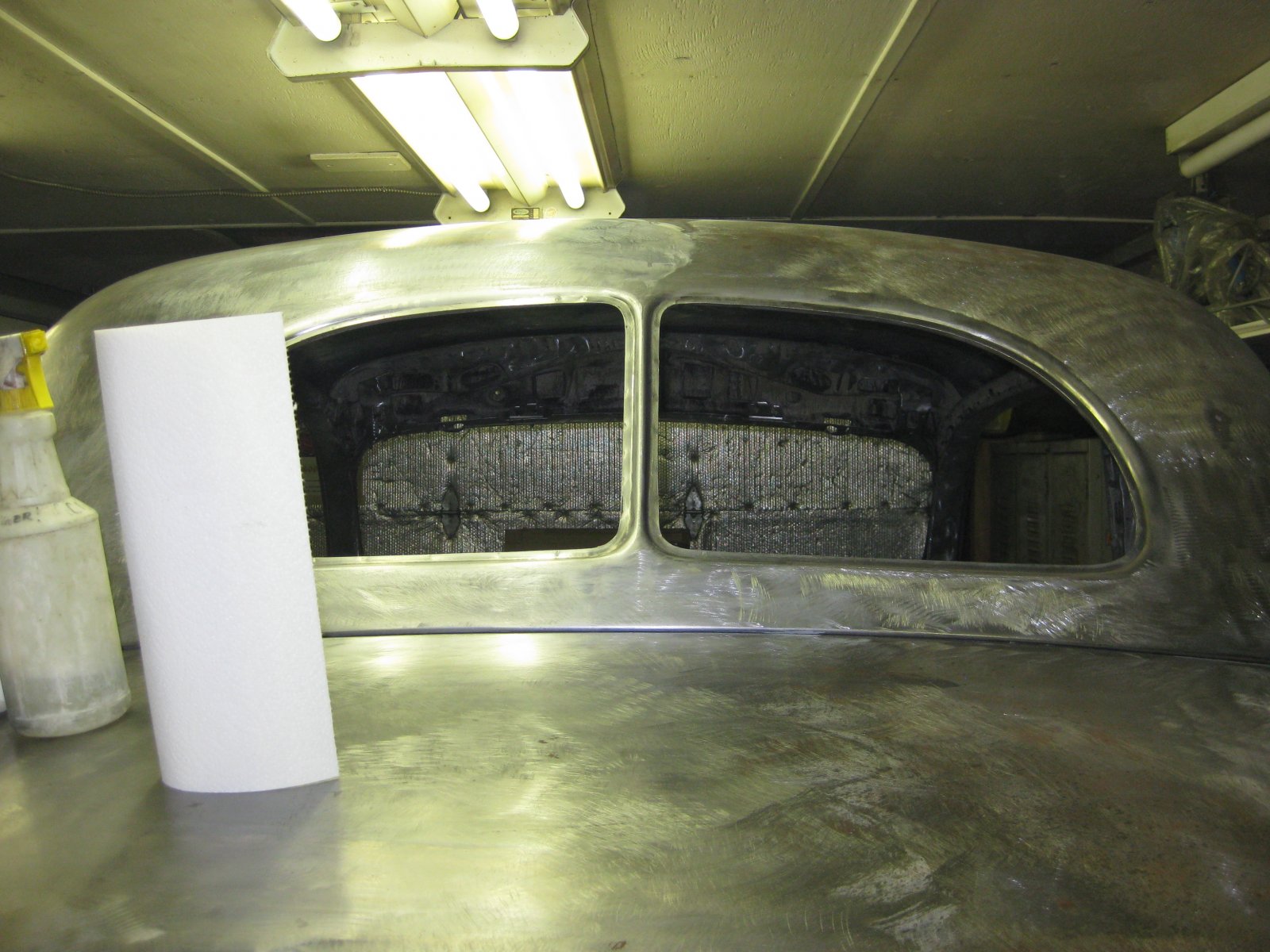

    when you blast steel, its meant to be perfectly clean, cleaner than you have (see that pic posted after yours), epoxied right away and not need ospho. 80 gritting it after blasting is a waste of time, its already keyed by the blasting material., again the exception of sanding the outside of panels and small easy to get to stuff obviously

  14. SwampLedge
    Joined: Jul 3, 2012
    Posts: 39
    SwampLedge
    That’s about what mine looked like after I blasted it. I blasted, did weld repairs, added body filler where needed to the bare metal, then applied epoxy primer. After that, primer surfacer, block sanding, etc before a seal coat of epoxy primer and single stage urethane. That was 3 years ago. Paint hasn’t fallen off yet. I know there’s some controversy about “what’s right,” and I’m not claiming I did it right, but it has worked for me so far.

    Looks like the OP may have used a siphon blaster or cheap HF pressure blaster. Both of which are inadequate. I stepped up to a 'Texas Blaster'. Not commercial quality but does a pretty good job. Bigger hose, much better nozzle, etc.
    Your metal needs to look something like this. Need to get all the rust out of the pits. Also, panel warpage isn't really an issue with the small home DIY units. I think 54chevkiwi is right on the money with his ****ysis.
