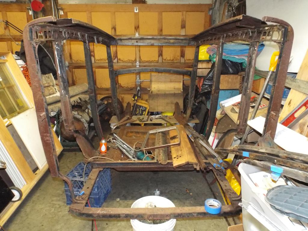

    Slant Window.jpg I don't think I'll have too much sand trapped in the Steelback, nothing left to cut away. Things will get well braced before it goes out to the local blaster. Bob
