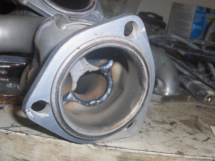

    Just asking why are the headers so rusted inside.I been running Sandersons zoomies for a year and still look good.

    Yeah I thought I should mention the rust. I had them repaired by Sanderson and at the same time I bought a new set of the CC4 so I set these on the bench out side of the back building not really caring what happened to them.

    I agree with the rust comment, you have waaaay too much rust in there. I think that is causing the problem.

    First as far as the rust I answered that earlier. This is a set the Sanderson repaired and at the same time I bought a new set of CC4's and never used the pictured ones again. Just set them on a bench outside by the back building.

  8. 350 forget all the tuning issue non sense, I would bet dollars to dougnuts, its a manufacturing issue. A couple of thousand pipes cut a little too short, the ends not prepped right, collector to pipe not a good fitment, worn out fixtures, are they using robotic welding? A simple program faupaw, and the welders dwelling to long in one spot. Again I'd bet some of Weasels cheap Hookers its manufacturing. Weasel, PM me and I'll tell you were you can send over 2 for my birthday, thanks buddy :D BDM

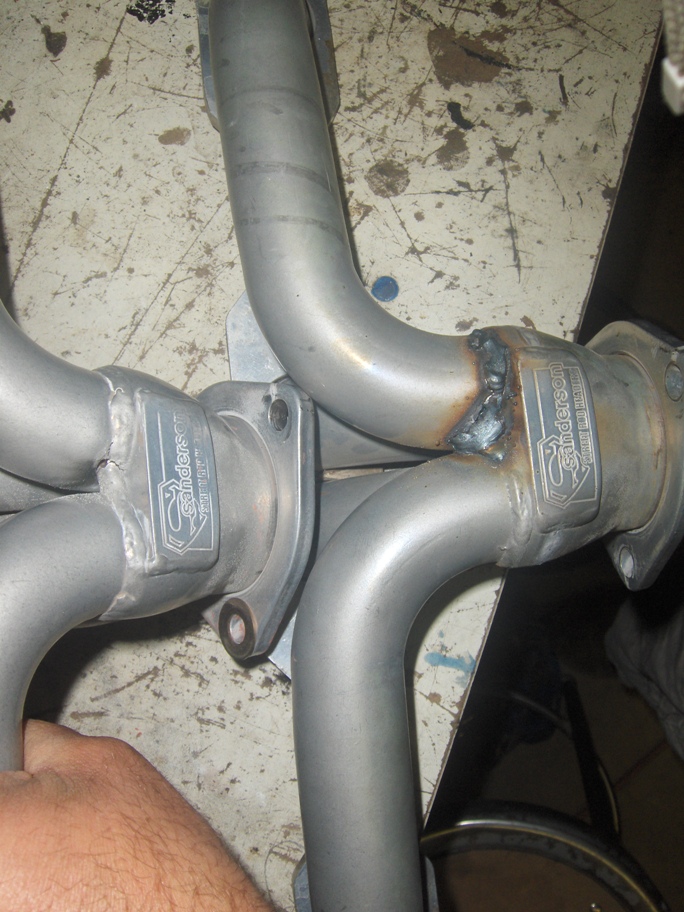

    $1200. for a set of custom Sanderson's & the flanges were upside down with the welds showing & one is an inch higher than the other at the collectors. Not good for a roadster.

    From the getgo I burned up set after set of plug wires boots nearest to the collector until I bought Wrench Rat Spark Arms (which are no longer listed on his website for some reason) .. this stopped burning up plug wire boots, but the exhaust leaks continued .. I always thought it was the collector gaskets...
    turns out my headers were cracked all over the place like the above post with the great pics...
    *** also has anyone else noticed they did not weld the tubes together in the collector??? it's some form of goop that emits noxious gas when you are trying to weld near it...
    I had my brother weld them and reinforce a few areas that weren't leaking and I installed them on my fresh 383, only to have the rim of the collector crack...
    for years I have fought these things. they cost me a premium, and were substandard from the getgo, I just didn't know it until it was too late.

    I have nothing but bad luck with Sanderson headers. I had a set with the Saginaw steering and they cracked as described. I did the repair and they are still working. I had a set of the cast headers and they cracked immediately. I was told it was my engine's fault. I threw them away and went with Rams horns which are still perfect. I don't disagree with engine tuning causing a hot spot but with other brands, on the same engine and no hot spots — makes it hard for me to believe it is not a quality problem. I still use Sanderson headers but I have problems that they never seem to admit to being theirs!!!

    I went through three sets of Sandersons on three different of my friend´s cars and all failed and cracked. I replaced one set of their block huggers for sbc with the cheapest set from summit ( I had aölready used them on my 34 Plymouth) , and guess what: the cheapy summit block huggers never leaked and are still good after 13 years and 80000 miles...maybe I just was lucky
